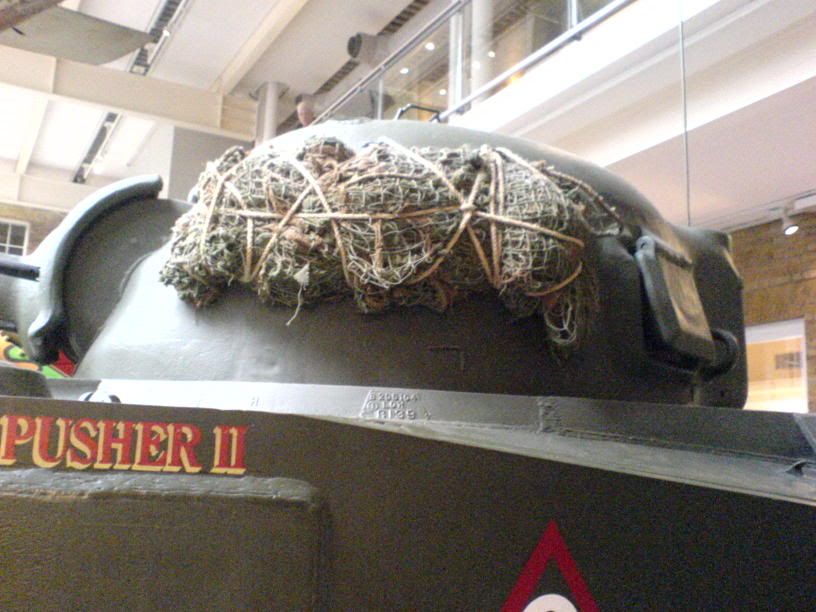

Hmmm, here is a pic showing weld seems on a Sherman:
Side aplique armor, weld seem along armor plate

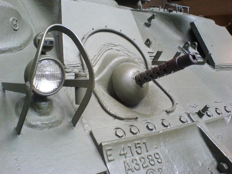

Front aplique armor, weld seem along armor plates

In serious doubt of this beeing 1:1, if it is a replica its very good [:P]

The teeth of the sprocket on the picture in question are elongated, unlike the photo of the real Sherman you cited.
I am familiar with the shape of the actual drive sprocket – the Tamiya 1/16 one had to stretch the tips to make it deal with the RC running system. Compare them closely.
Also, I am also aware that applique armor was applied to some Shermans. What I meant to point out is that all the visible applique is awkwardly placed and that I’ve never seen a slab of applique armor on the left side of the turret (it didn’t require it). I didn’t mention the hull plates because unusual repairs weren’t unheard of – but the turret slab was very noticeable.
Historically, applique was applied mid-war, to supplement “dry” ammo storage racks. Later models replaced the dry ammo racks with glycol-filled lockers. The 76mm tanks also moved the ammo to hull floor from the sponsons. No late war, HVSS tanks would have had applique armor like the earlier 75mm 60 degree hulls.

The applique was added to six areas on the Sherman. Some units added plates in front of the drivers’ areas. The right front “cheek” of the 75mm turrets were found to be deficient because an area on the inside of that area needed to be ground away to give clearance for some internal features (turret traverse or cannon trunnion – I forget which). The added “cheek” slab was to reinforce this thinned area.
Later 75mm turrets had a cast-in thickening of this cheek. The Tamiya M4A3 and M4A3 (105) turrets are needing this correction.
The hull had applique on three areas. One on the left side and two on the right side. These were welded directly over areas that held ammo bins in the sponson. These are often seen on mid production 60 degree hulls. This was done to supposedly make up for particularly vulnerable areas for the tank. Late into the production of the M4A1, these areas were also thickened with cast in armor in lieu of welded plates.
