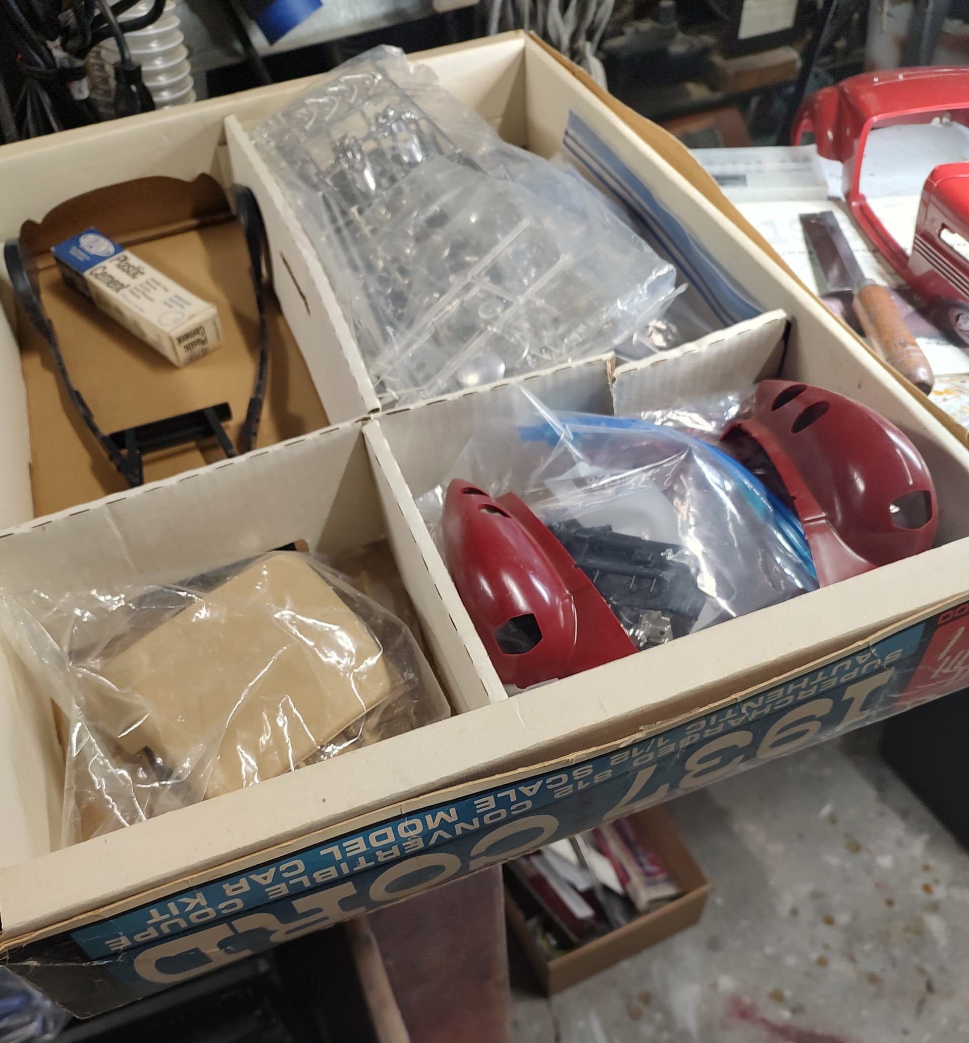

I started this project a long time ago. My life took a dive shortly thereafter; it took a long time for me to recover. But when I did, I no longer had a passion for this art. That took longer to recover from. Well, now I’m back. The kit is more than 3/4 unfinished. Along the way, I picked up a 1/12 scale kit from the 60s by AMT. One of the four classic cars I adore. The 1937 Cord.
