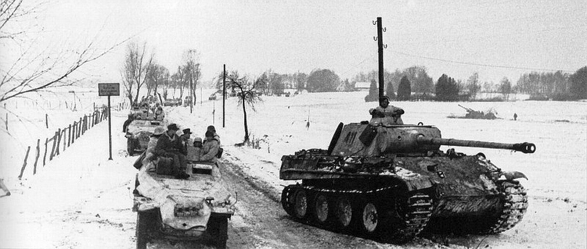

In a more isolated rural setting in Germany, where not many lines are being fed/carried, poles are gonna be the simple type like in these photos
stickpusher,you hit it dead on.Tha’t what I’m looking for.Been trying didderent size dowel rods,getting close? Haven’t figured out what to use for insulators yet.

As a guess, German poles are going to be 300 to 350mm diameter and about 10m above ground. Scaled down, that’s 10mm x 285mm, or 3/8" x 11 1/4" (you could get away with skinnier and a bit shorter, like as not).

The insulators on German poles in those days were usually made out of white porcelain and if I remember correctly, the sides of the insulators were straight up and down rather than tapered or dome-shaped, like many insulators in the United States.
