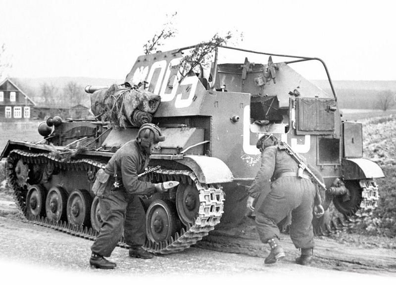

Looks like this SU-76 crew never rusted up their set of Friulmodel tracks. There’s proof for you.[:D]

WOW are those tracks right out of the box or what! They didn’t pre-drill. They are having a hard time with the wire.

It’s all so odd because them boys are Polish (white eagle before the number). Maybe that’s why the tracks are polished [:D]
