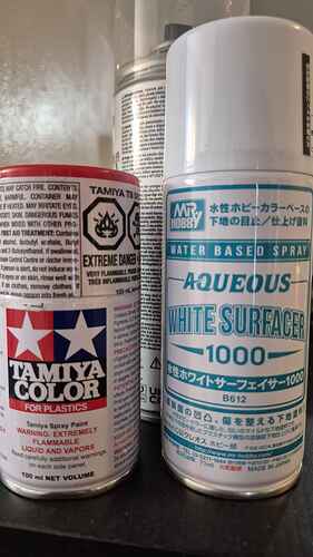

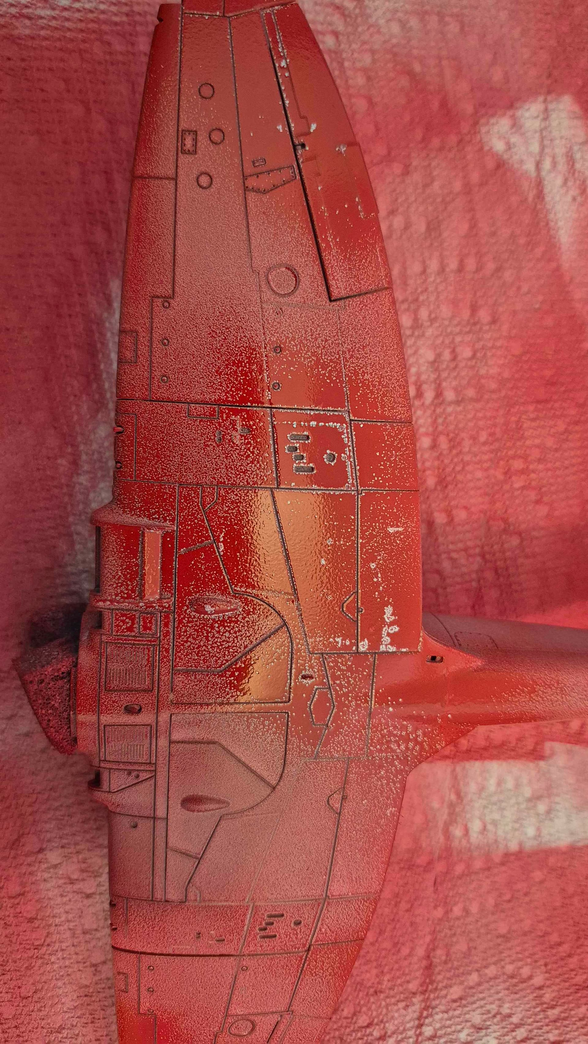

I’m getting a really ugly reaction when spraying Tamiya TS red over Mr Hobby aqueous white primer, anyone else run into this? Also, what’s the best way to strip the TS paint so I can start over?
I think you’re trying to spray lacquer over acrylic. The can says ‘TS SPS’.
I have good luck stripping paint with Super Clean. Its available at Walmart in the automotive dept. Comes in a one gallon container for not much money. Just submerge the parts you want to strip in a bath of the Super Clean. It should come off in a day or so, with light brushing occasionally. Doesn’t hurt plastic and should work on the water based primer too. You can re-use the cleaner repeatedly.
Some people use oven cleaner instead. Just put the parts to be stripped in a sealable baggie and spray the oven cleaner in there with the parts and seal it up.
Hope this helps. Good luck!
Agree with Peter - Super Clean is great for stripping paint and chrome off plastic!
You have sprayed a lacquer paint over a water based acrylic that’s what’s causing the problem. Tamiya paints are sometimes reactive to other paints , even if they are base paint. For instance you cannot use a Tamiya acrylic thinner with a AK acrylic paint because it will curdle or go lumpy you need to use distilled water or a AK acrylic thinner, because Tamiya acrylic is a alcohol based paint. Sometimes a quick google search will give you an answer if you want to combine different brands of paints.

Oh this is perfect, thanks :slight_smile: I’ll take another crack at my kit but I’ll try with an acrylic red instead.
I always use a lacquer or enamel base primer,gives a much better bite and adhesion for future coats and masking.Tamiya and Mr Surfacer work great.
I use SuperClean, too, and if you don’t want to immerse your model, you can apply it with a brush or with a paper towel. It just might take longer, with multiple applications, to remove the paint. I have used a small brush to apply SC on a figure and remove paint from a small area without having to strip the whole piece.
A big advantage of SuperClean over oven cleaner is that oven cleaner is once-and-done. You can’t really use a batch more that once. You can use a batch of SC multiple times. I use glass jars of various sizes, or old glass baking dishes, to make “baths” of SC to work on various pieces.
And it has household uses as a grease cleaner, so for the money, it has a lot of value.
