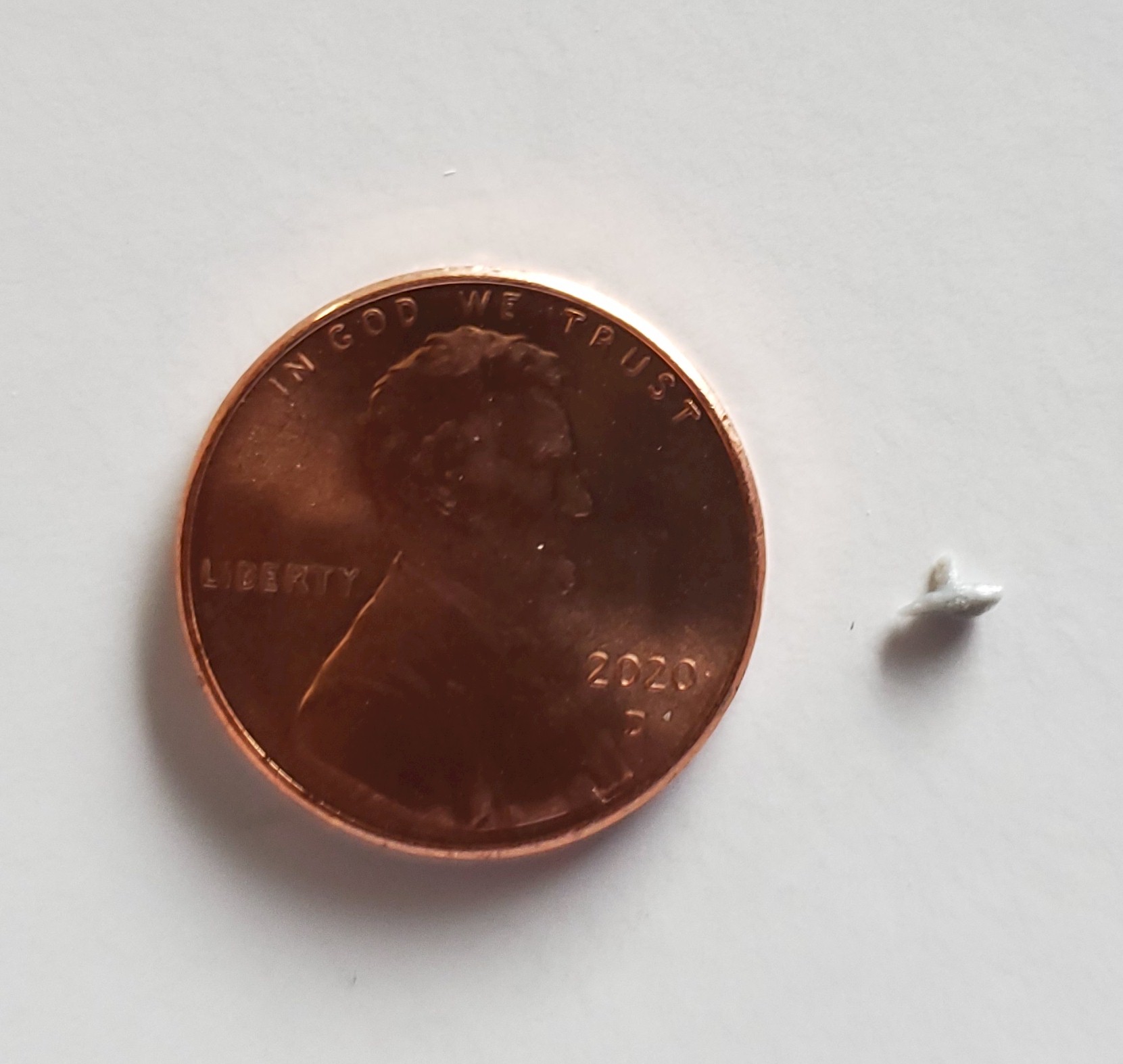

I’m working on the Tamiya 1/700 Prince of Wales battleship.
Don’t get me wrong, I’m all about fine detail, but some of the parts on this kit are just ridiculously small. The pic below is of the float plane pylon. It’s so small that I had to get out the optivisor and a specially-ordered pair of needle tip tweezers to handle it.
I was on guard against lost parts, so I was working over a large white platter and using adhesive on the tweezers. Even still, because these are so light, one went flying away into the void never to be found again. Not even sure how to craft a replacement because of the size. ARG!!!
Brutal, just brutal,pure torture.

Ya, that strut on the pylon is way out of scale, so I would replace it with a PE strut. Also add the guy wires to the Walrus for added detail.
Make a replacement pontoon out of a drop of expoxy or CA.
Instead of tweezers, I use a toothpick with the end wetted or dabbed with white glue that holds the small part enough to position it. I had way too many parts shoot off into never never land. Always cut your parts on a piece of tape and a finger over the part too.
