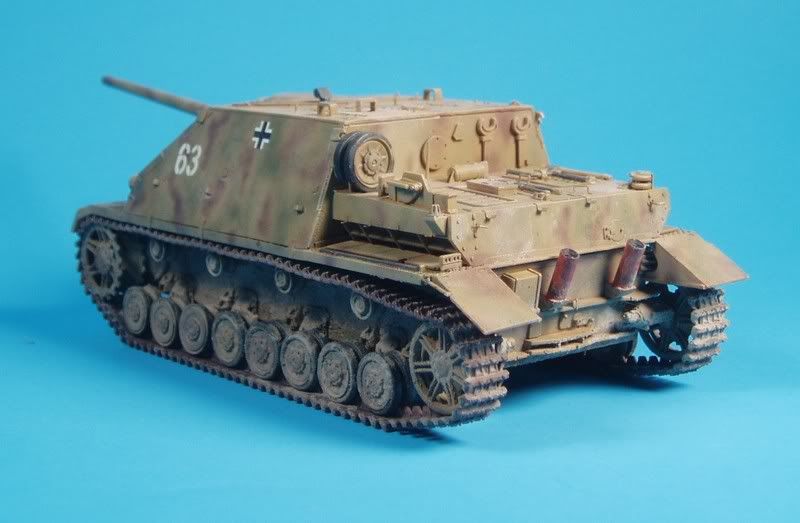

I’m sure dupes means to gently spray over the entire surface to simulate a layer of dust. Do it in layers and be very controlled. This will mute down the extremes in hues that your camouflage makes. Here’s my 1/48 Jagdpanzer IV L70A with a layer of dust.
Hope this helps
