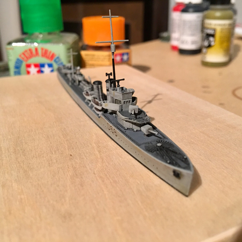

I bought this kit sort of on a whim last week. I wasn‘t expecting to assemble this so soon, but a paint color I’m wating on for my other kit is in-transit, and I had time to kill. I plan to make my first diorama with this kit, and I have a 6”x6” base to work with. Vampire was destroyed in WW2 by the Japanese, so I was thinking of adding Japanese carrier craft in the diorama as well.

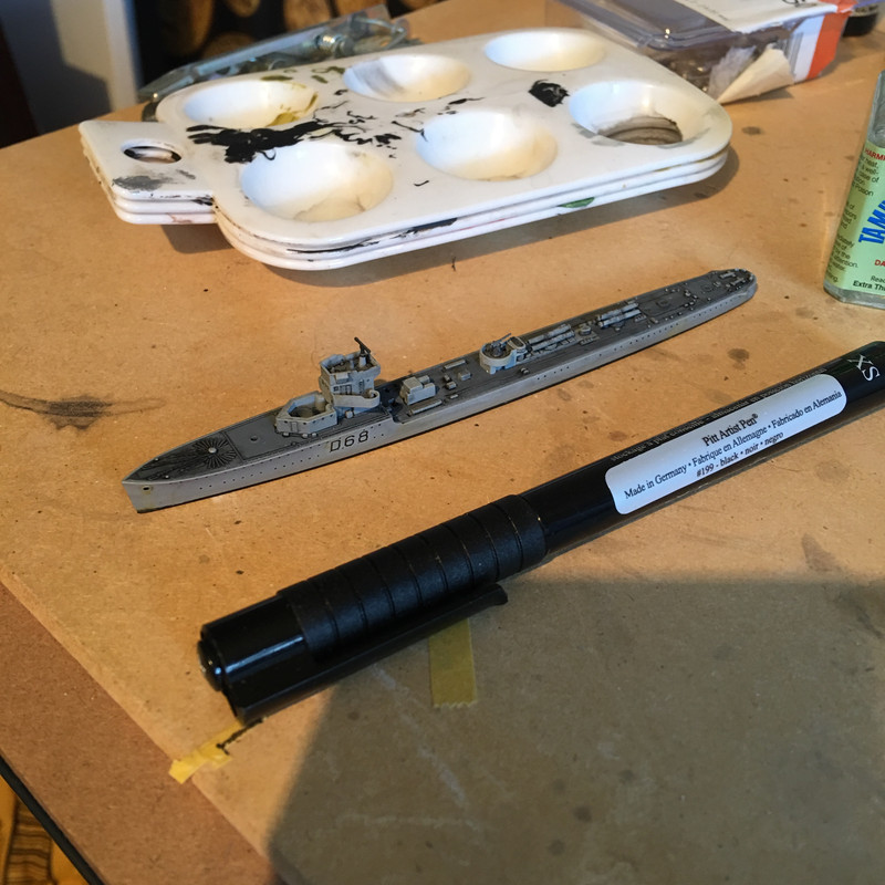

This is my first Tamiya kit, and it was pretty good. Everything fit, but certain things like the guns were hard to clean up. Things like the anchor were so tiny, and were not easily placed on the model. The worst thing were the horrible paper flags. I tried twice but could not pull them off.
I used acrylic paint, and artist‘s oils to weather/detail.
Those kits don’t take long to assemble. It looks good [Y]. Small items like guns on those Tamiya kits, or any 1/700 kit for that matter, are difficult to trim down. I also like your suttle use of oils. Adding it to a seascape base will make it come to life.
Perhaps a touch too subtle… WWII destroyers could get impressively grimy in service.

Thanks for the comments. I’m pretty happy with the results… so far… but, should I install some PE handrails? Stretch spruce for the rigging? Any idea what a good way to make the Japanese planes I’m hoping to include “fly”? I found a good video on water dioramas for a small ship from Vallejo.
I’d say yes to the PE handrails, possibly other bits too. There is a dedicated PE set for the V/W destroyers… White Ensign Models I think? I feel happier using thin thread, Uschi or similar, for the rig rather than sprue, it is tricky to get the sprue consistently thick. Or thin, I suppose I should say.
How about using a thin brass rod (0.5mm or something, it is rigid enough) to support the planes? It should work well enough low above the water. Paint it black or, even better, use a chemical blackening agent, drill a hole in the plane’s belly and one more in the diorama base.
And the Vallejo stuff works wery well indeed for making a seascape.

Very nice work so far…Cheers Mark
Great job! I really like how it turned out, but, and this my humble opinion, I can’t believe it’s so small. You are a better man than me to put a PE railing on that ship! lol
Seriously, very well done. I’m looking forward to the finished dio!
