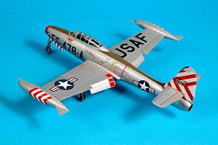

rangerj, heres a couple of pics of a Promodeler F-84G I built a few months ago. This one is OOB with AM decals.
Only real area of concern is the nose wheel strut. It’s a little weak.
Regards, Rick

The model looks great. The red in the AM decals looks RED. The red in the Revell kit looks much darker. Otherwise the decals look good, but I’m not sure about how they will apply. I’ve had a number of bad experience with RMs decals. Thanks for the pix.
