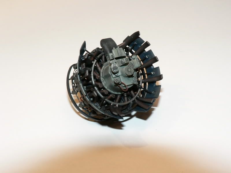

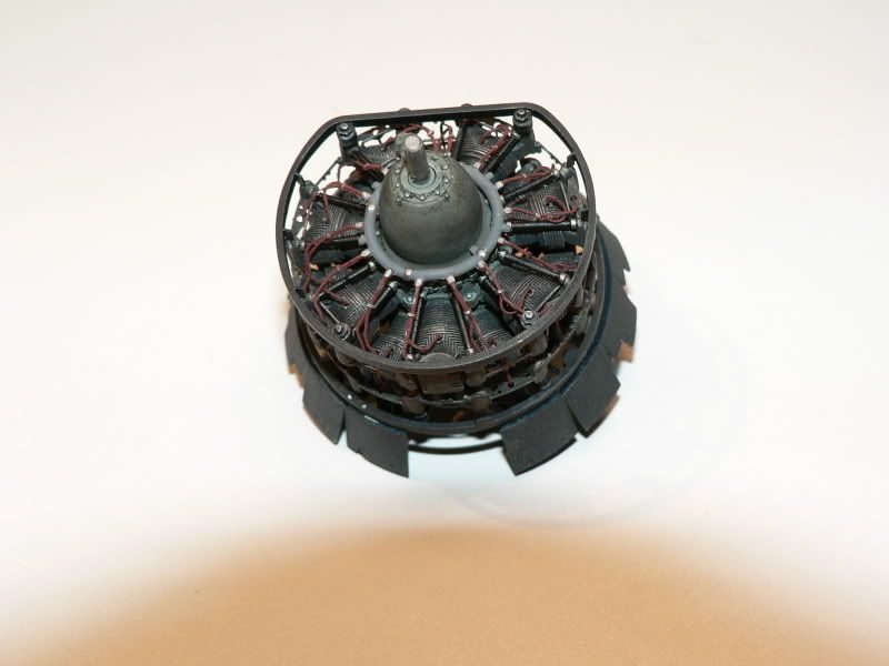

Here’s the engine I did for mine, with a little (OK, a LOT!) of help from some Eduard PE. [;)]
Your engine looks awesome! Way better than any I have ever done. What technique did you use to give it that dingy, worn look? I really like it!
Frank, for that worn metal look I’ve always prefered drybrushing with a mix I whip up of burnt umber oil paints and testors chrome silver (the one in the little square bottle). It looks like a very light bronze when mixed on the pallette, but it loses a lot of the hue when drybrushed and just leaves you with a nice subtle worn metal effect. The grime is just a straight oil wash, using both straight black and burnt umber, and applied liberally.
That’s the same technique I use! I think you do a better job with it, guess I’m gonna have to practice it a lil’ more to get it to look like yours. Nice job!
Thanks much, Frank! It took more than a few trys on my part to get the right combination for me and to find out that a little of it goes a very long way. [;)]
