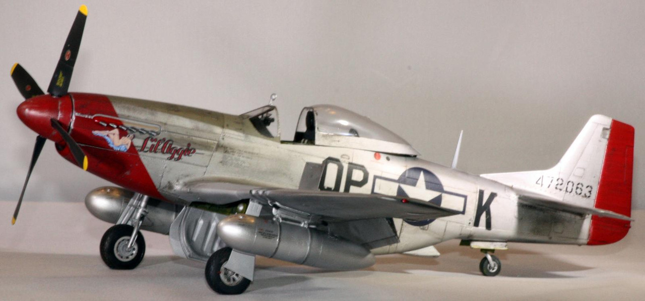

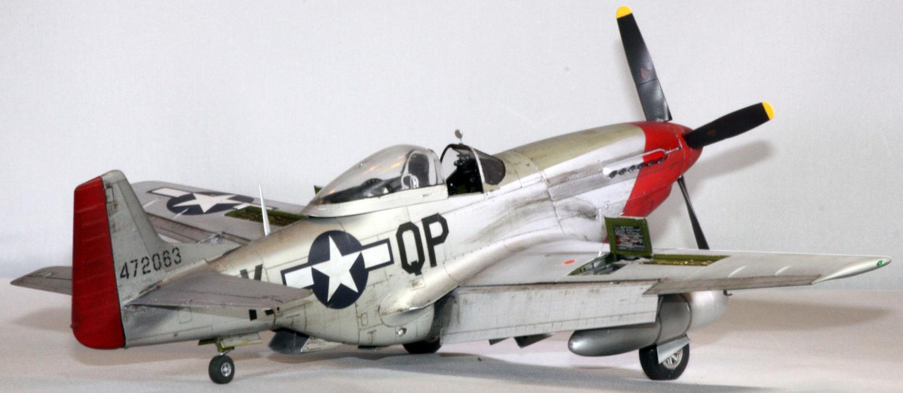

Here is my just-completed P-51D Mustang from Tamiya’s fantastic 1/32 kit.
I started work on this 9 May 2019, and completed work 1 July 2019. For me, that’s quite a long while for a build, a testament to the complexity of this kit but also of a painting issue that I ran into of my own making.

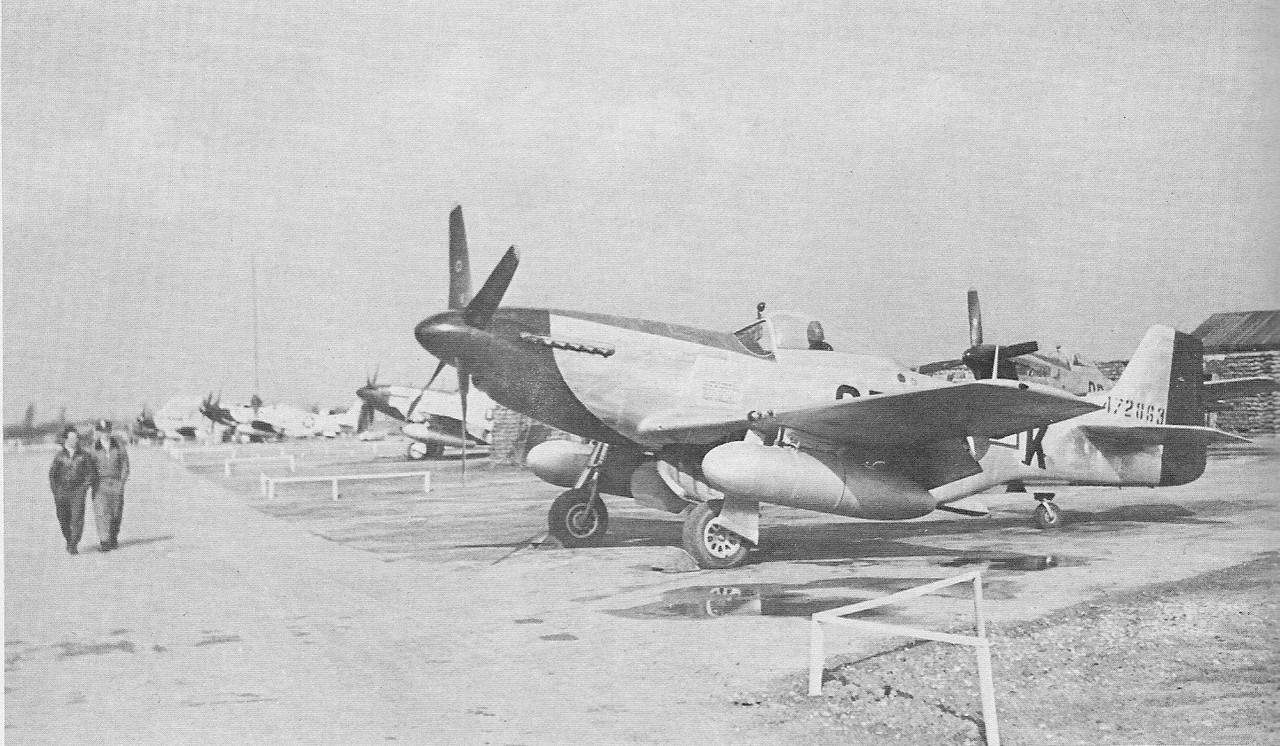

Anyway, here are some photos of the actual aircraft that I was able to find.
Kennedy’s 'Stang is the one in the far background, per the caption.
This one does not feature the “Lil’ Aggie” nose art but bears the identification number.
A color shot, also without the nose art. Notice that the identification number is different.

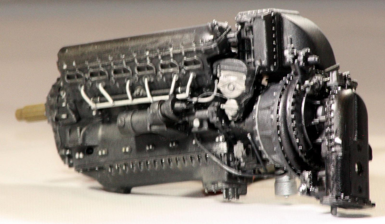

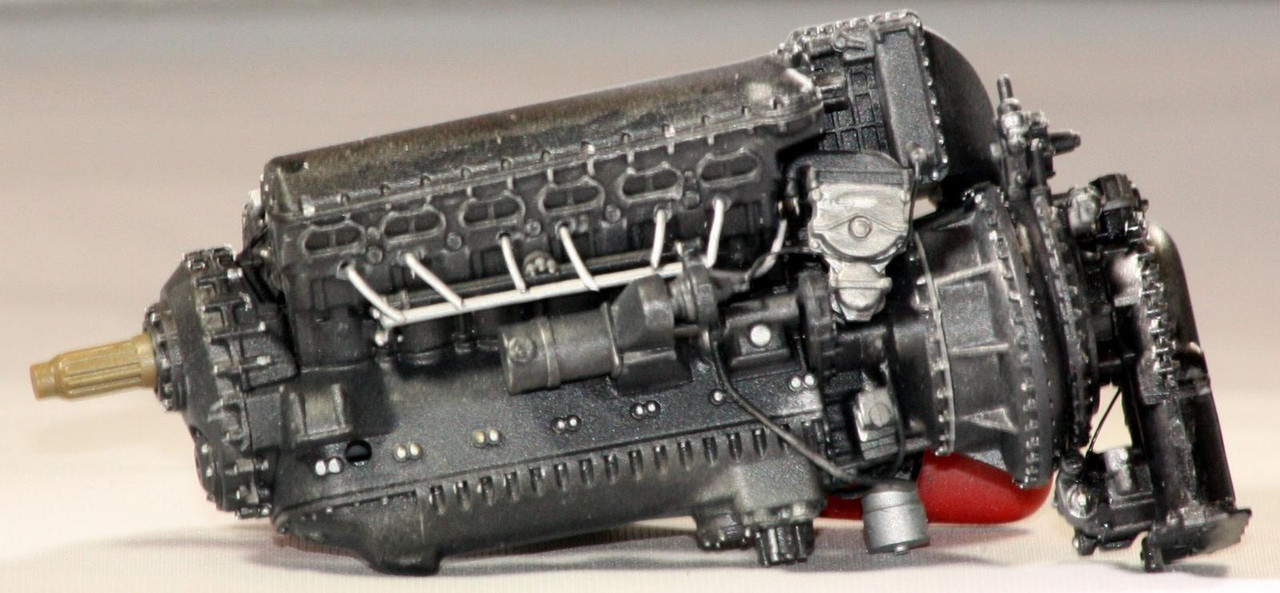

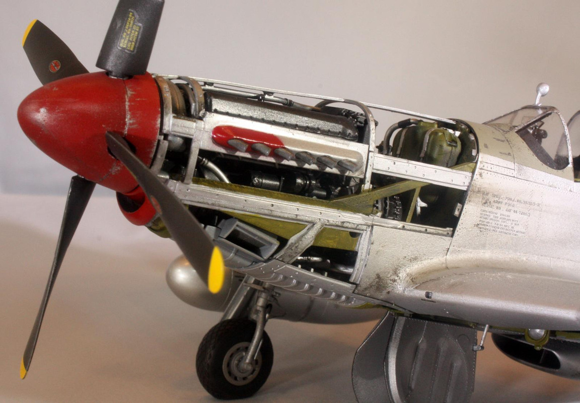

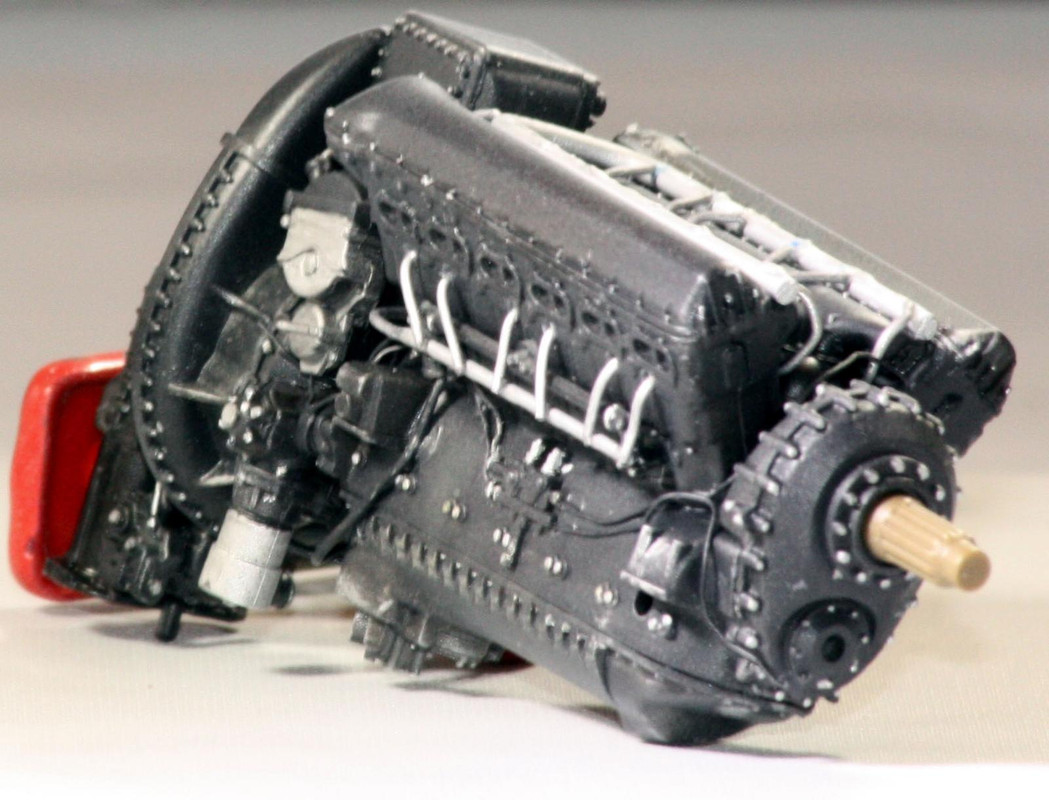

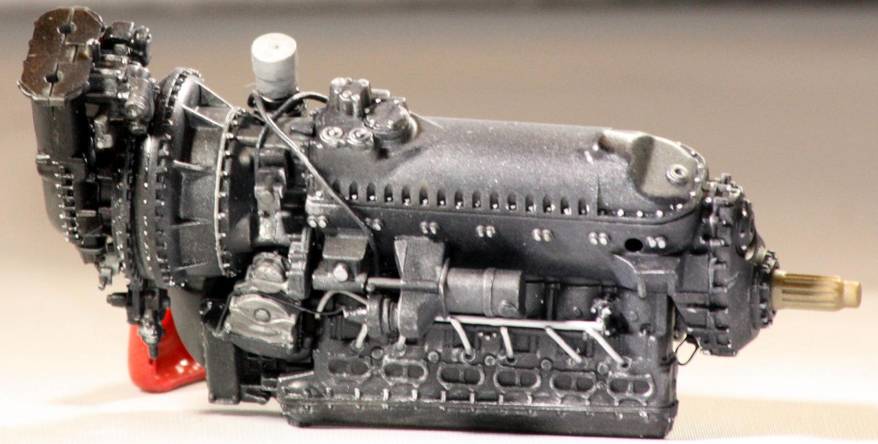

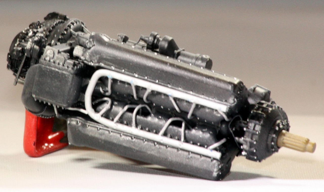

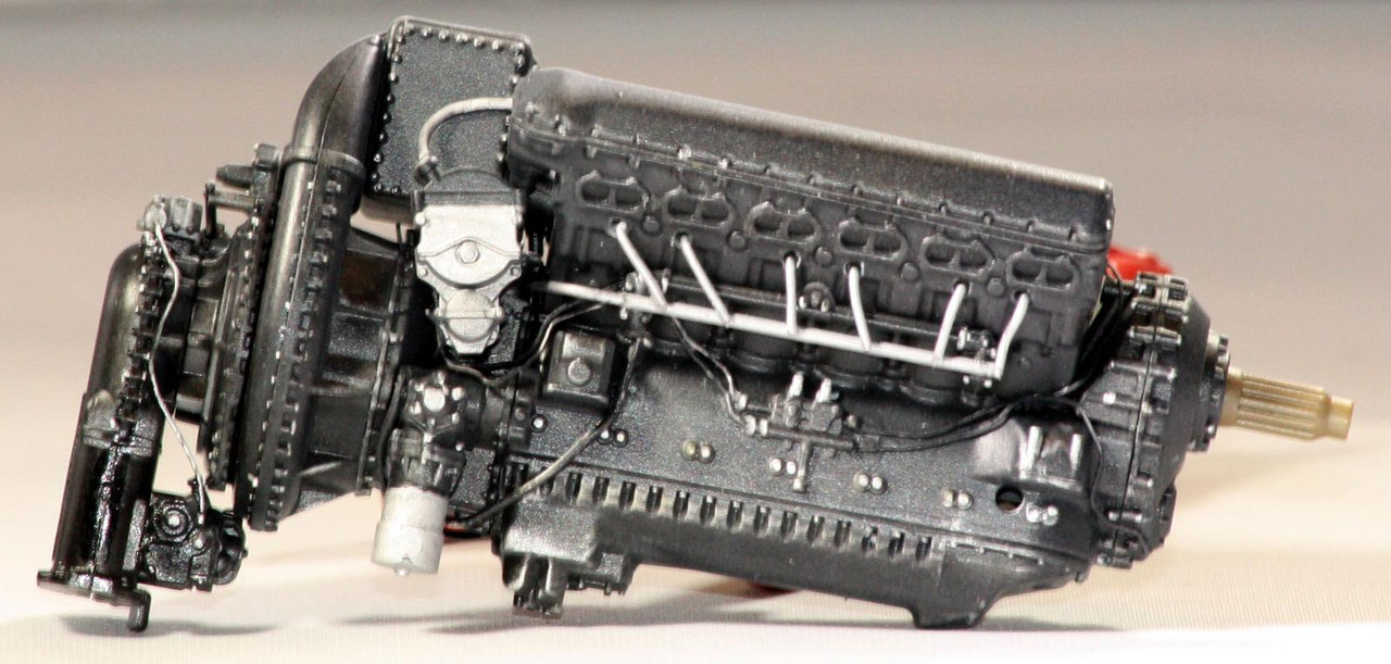

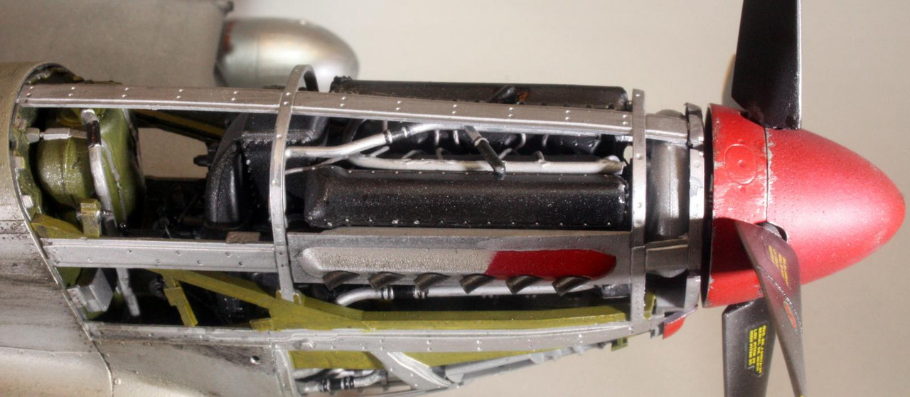

Construction began with the engine. The engine is a miniature work of art in its own right to which I added only a few bits of plumbing.

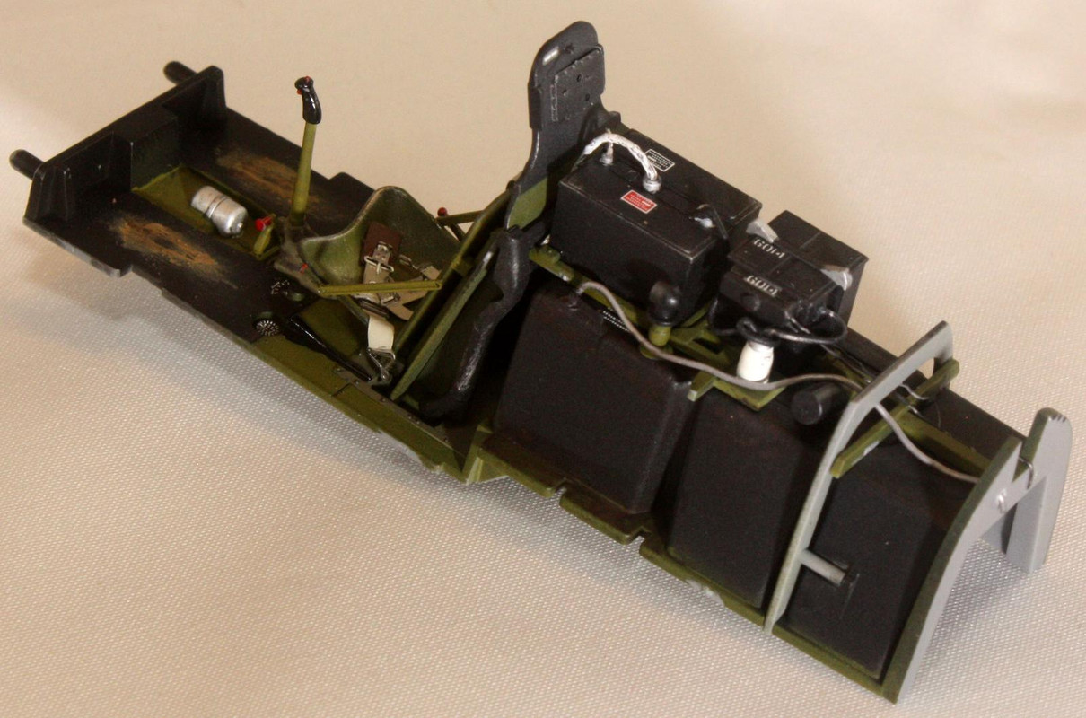

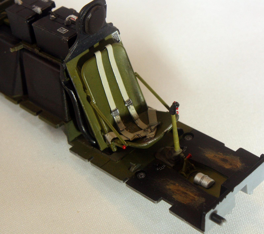

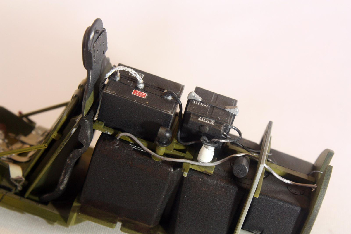

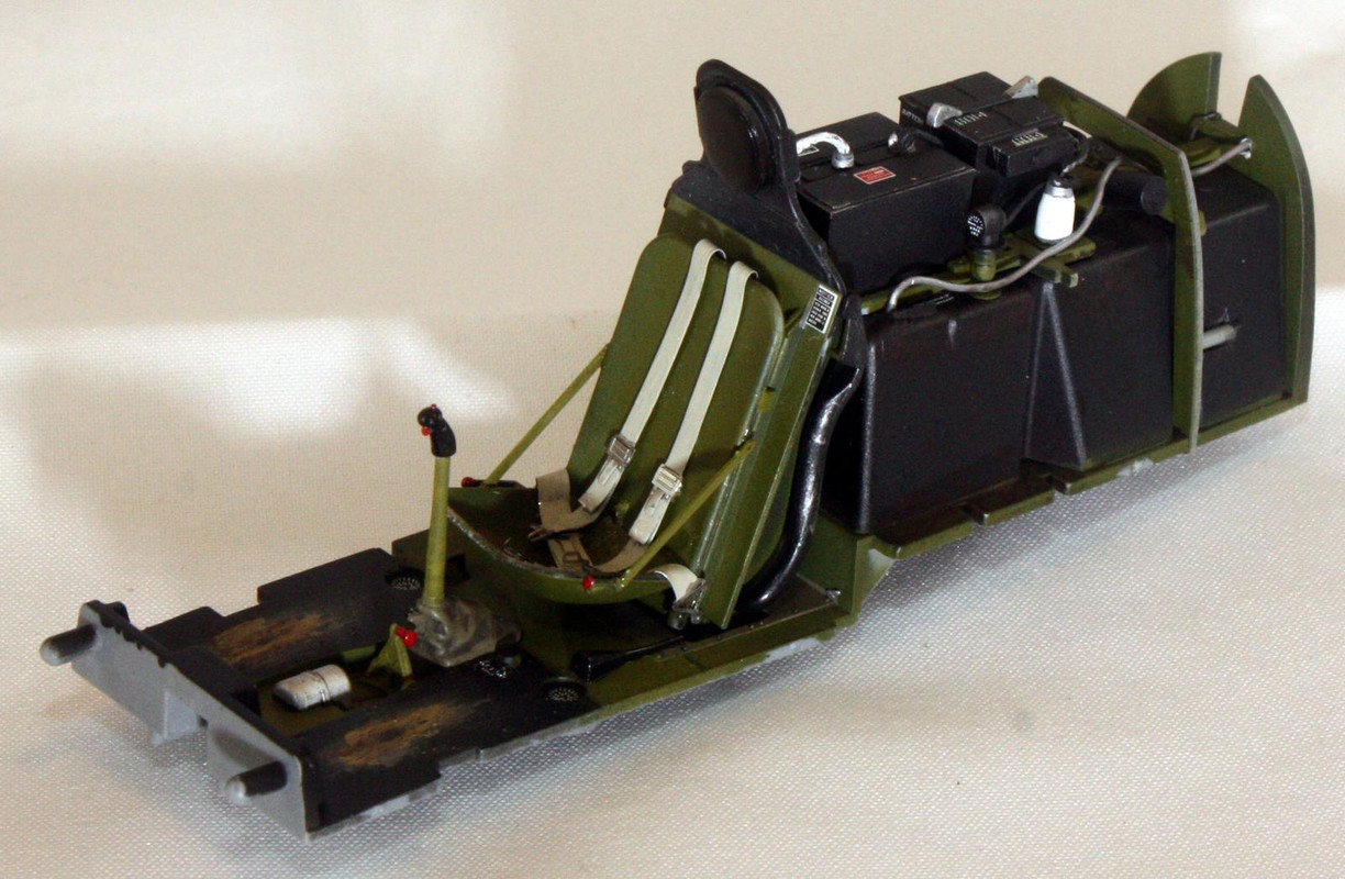

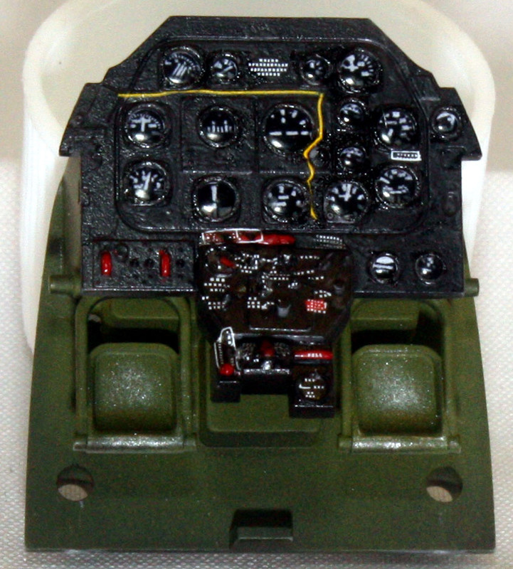

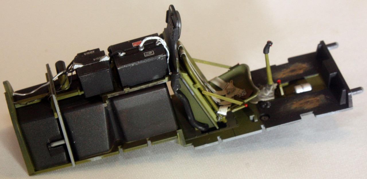

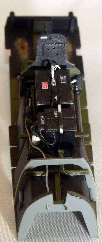

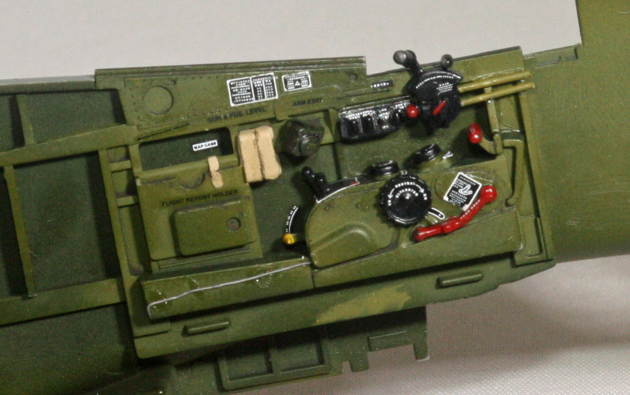

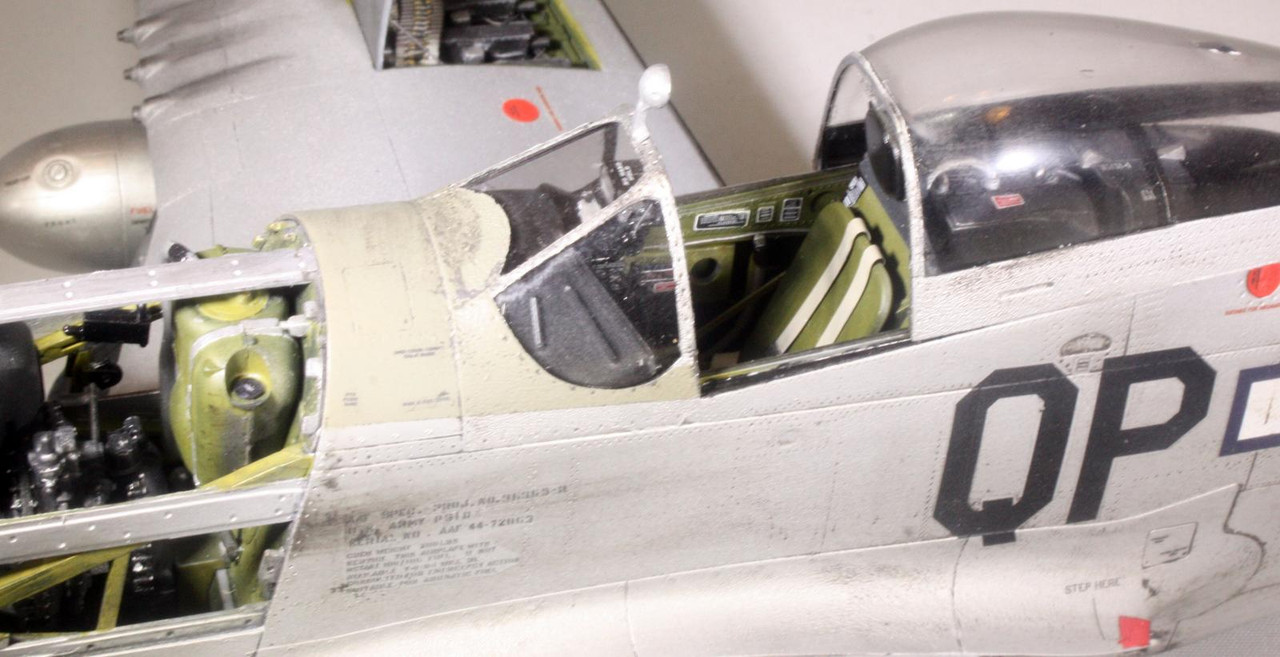

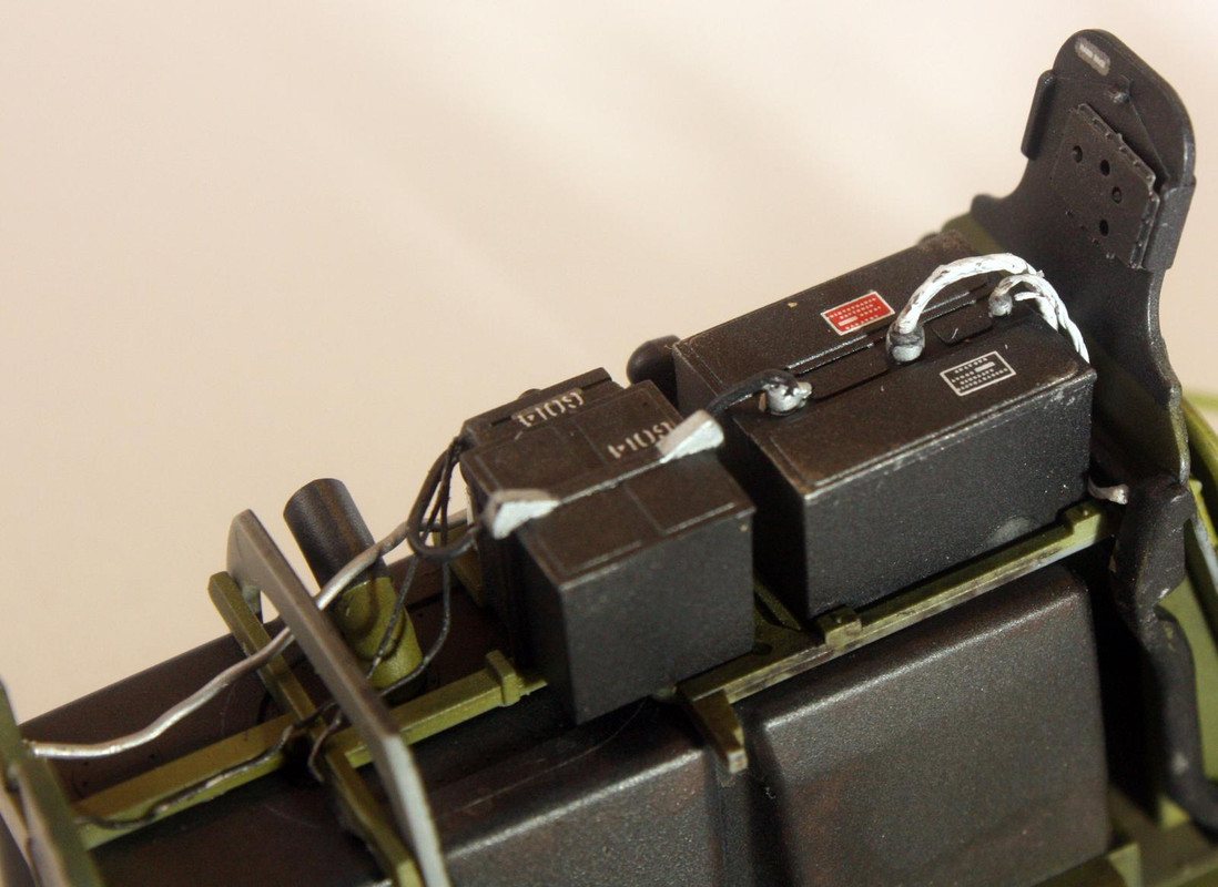

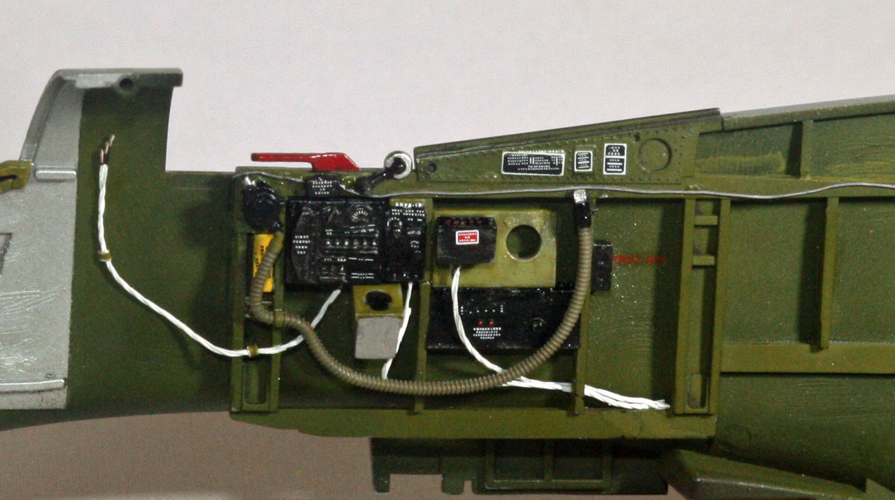

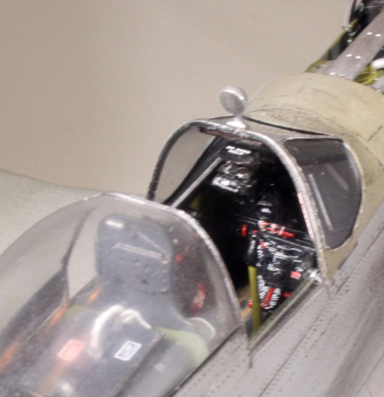

Next up was the well-apportioned cockpit. Aside from the aforementioned Kits World decal sheet, I was originally going to do this build OOB, but I found a Barracude cockpit placard set that I could not pass up. I also added a set of resin tires as the kit tires, made of rubber, feature a very prominent mold release line right along the center of the tires that resist all efforts to remove without leaving a crumbly mess. The kit comes with a couple of PE frets to spruce up the cockpit a bit. I also used various sizes of lead wiring that I got from UMM-USA (highly recommend this stuff as it is very pliable for running around tight areas like we often find in aircraft kits).

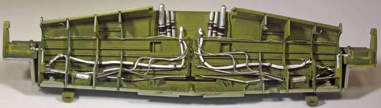

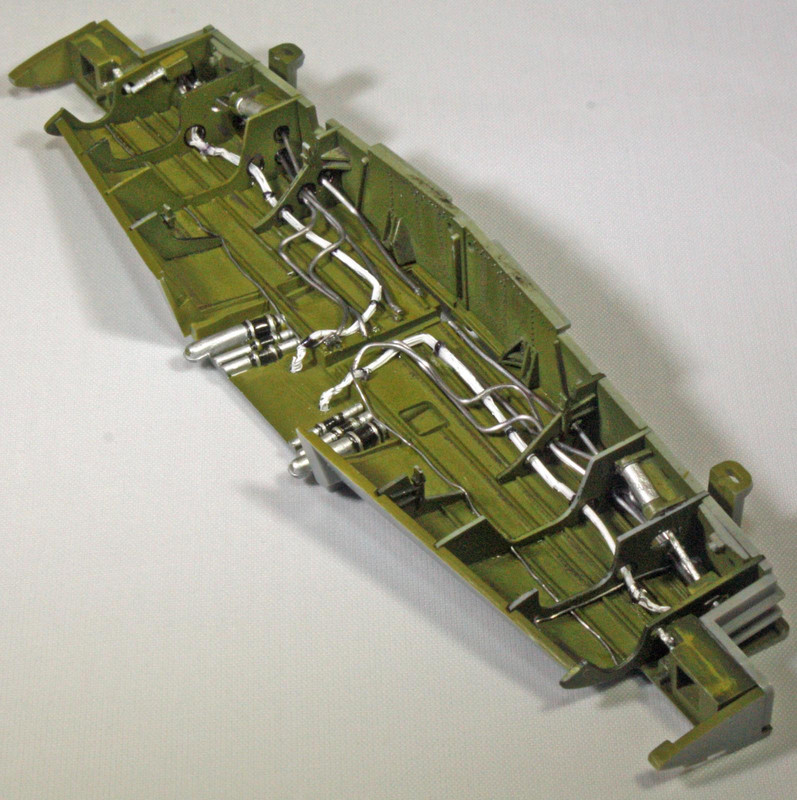

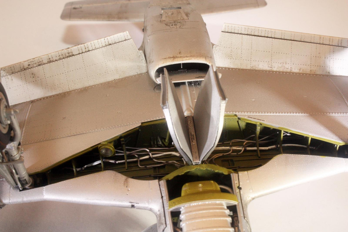

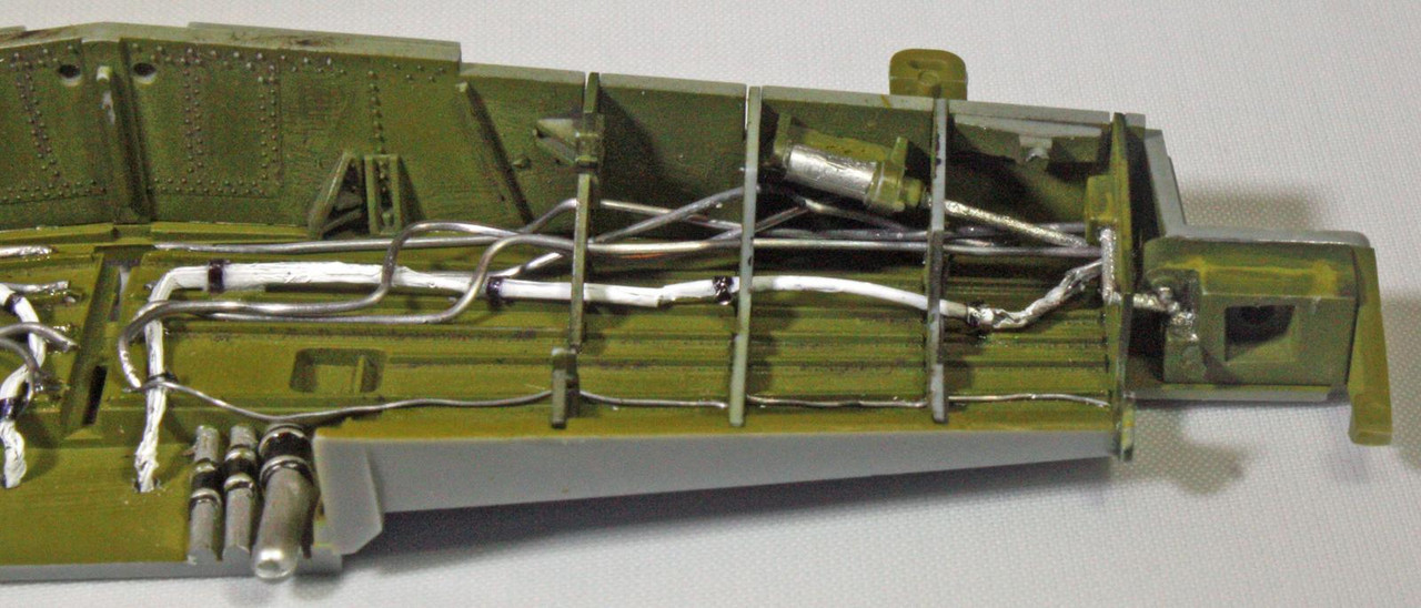

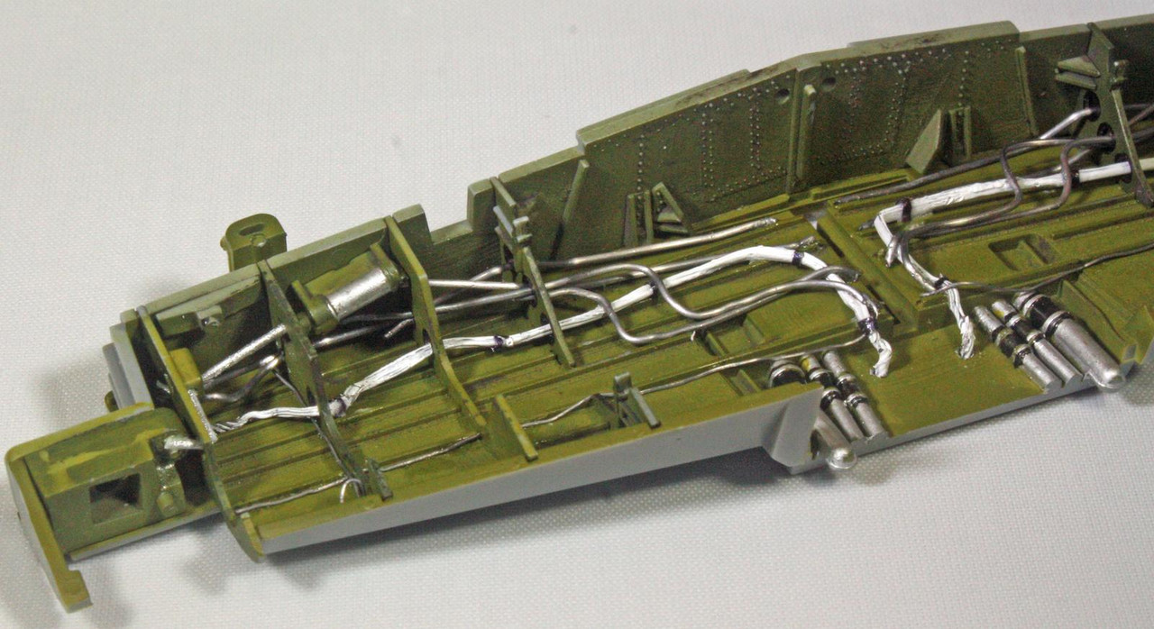

After finishing up the fuselage, construction moved on to the wings. First up was the wheel wells, where I spent a lot of time adding a bunch of plumbing and wiring to spruce it up a bit.

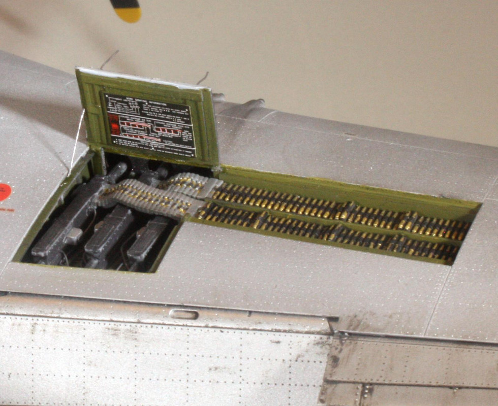

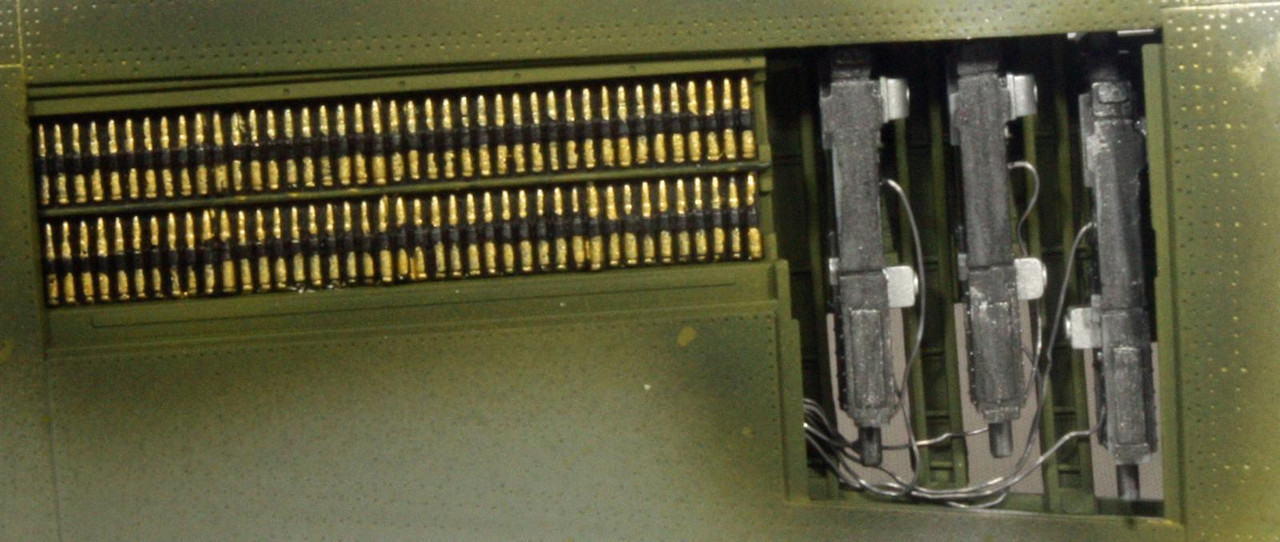

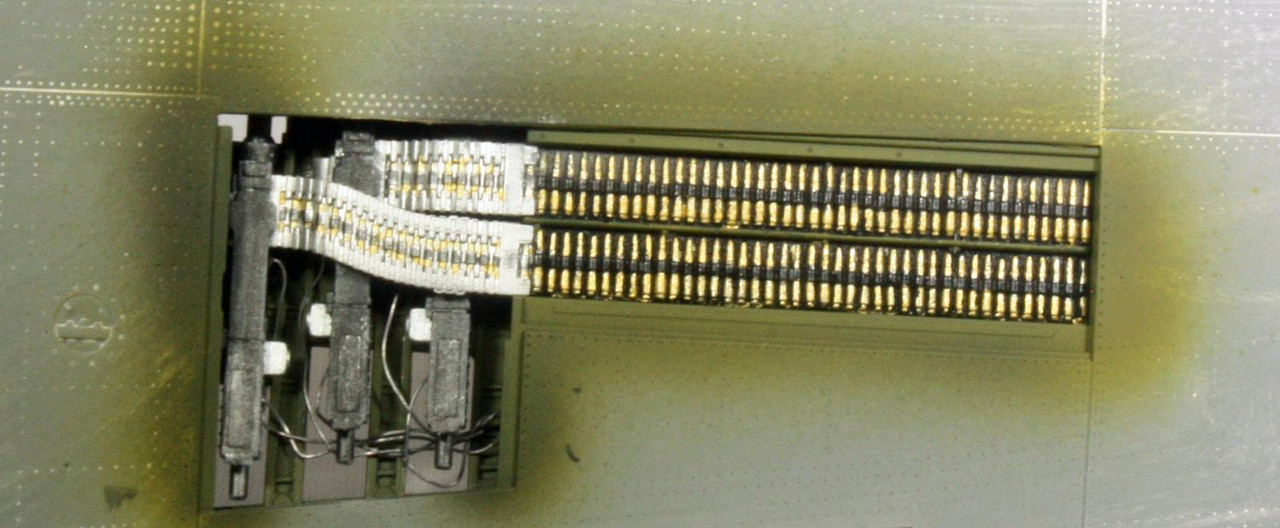

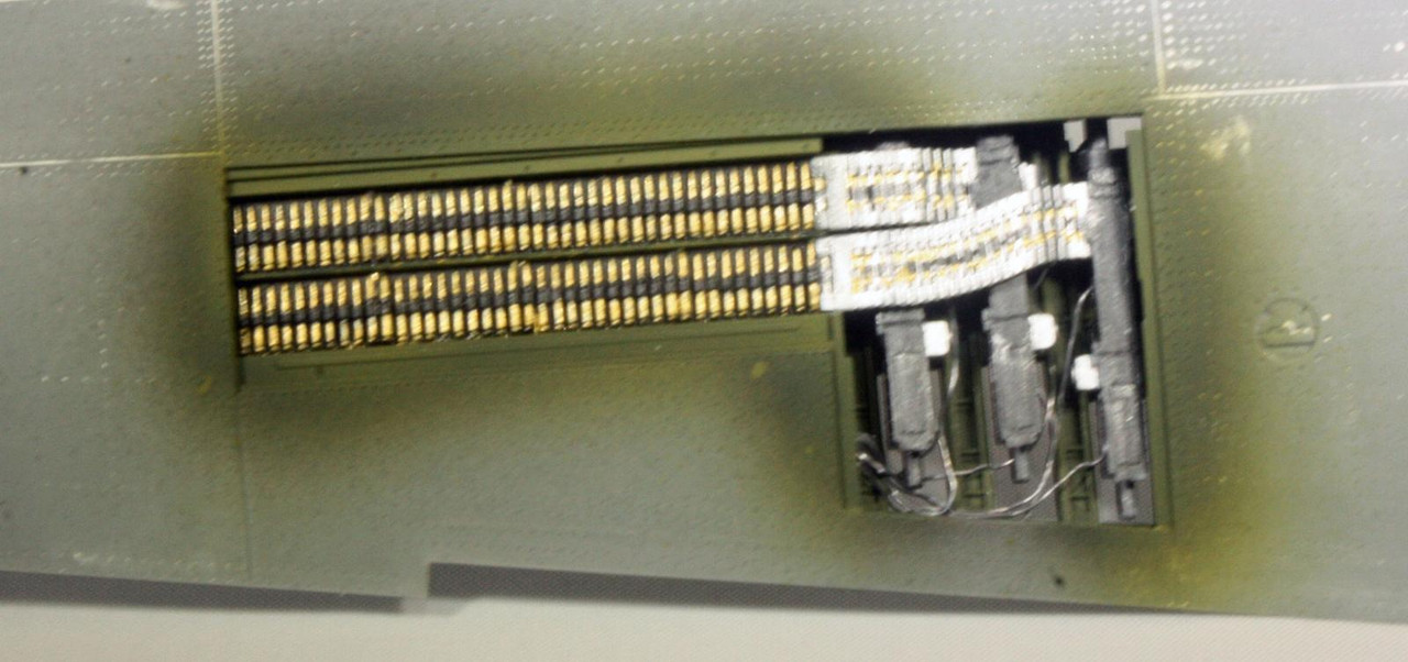

Gun bays next. These are the kit parts rather than an aftermarket set. I added some wiring.

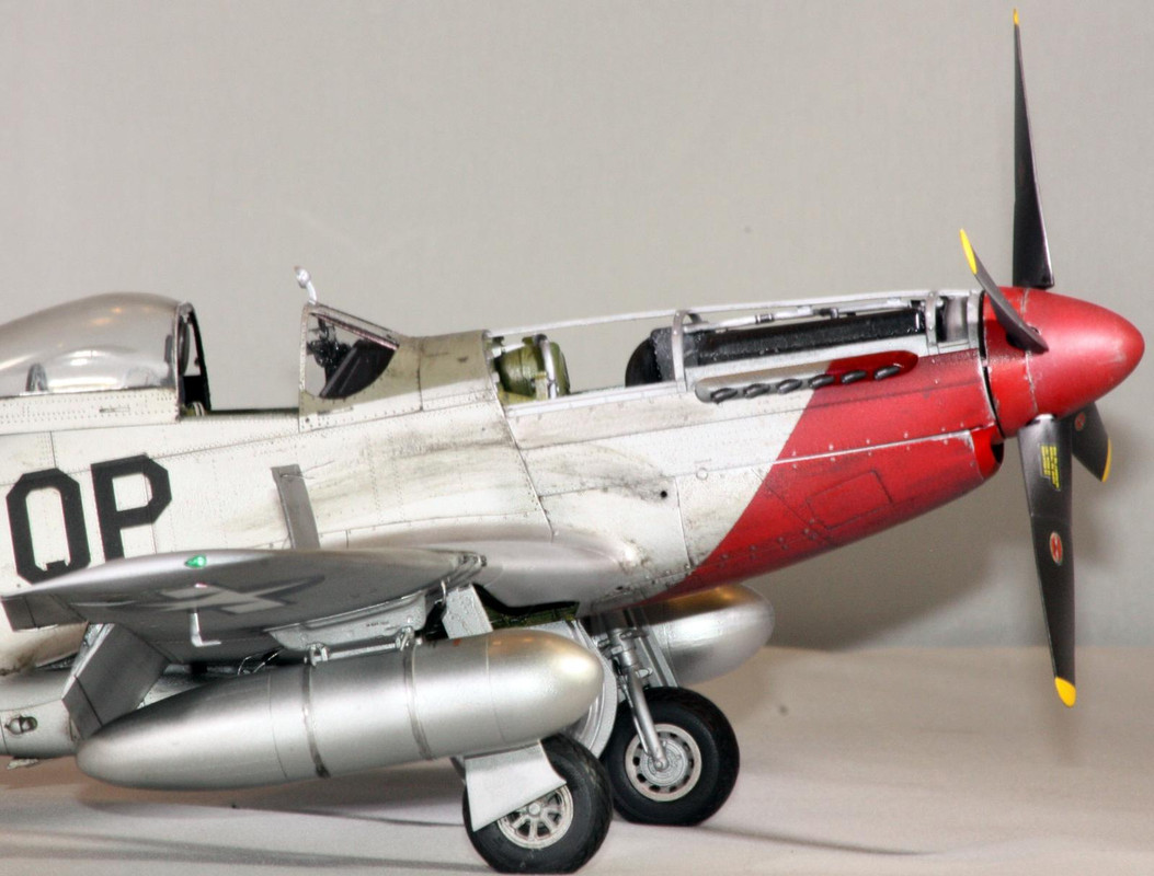

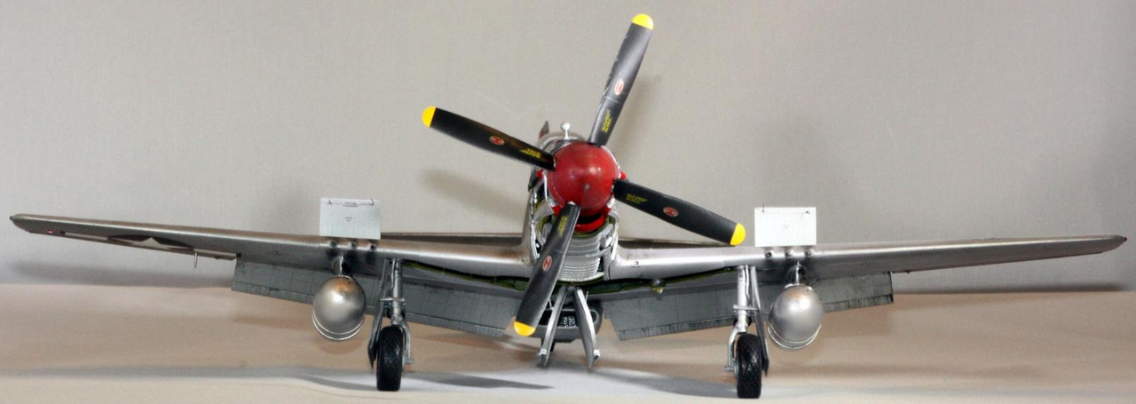

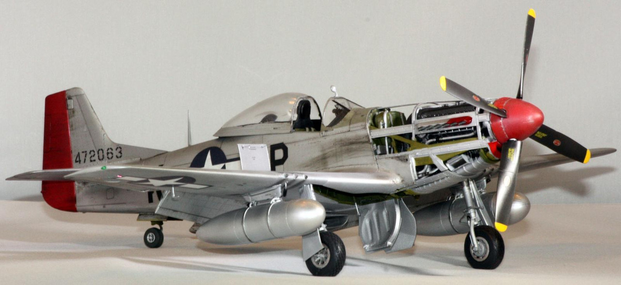

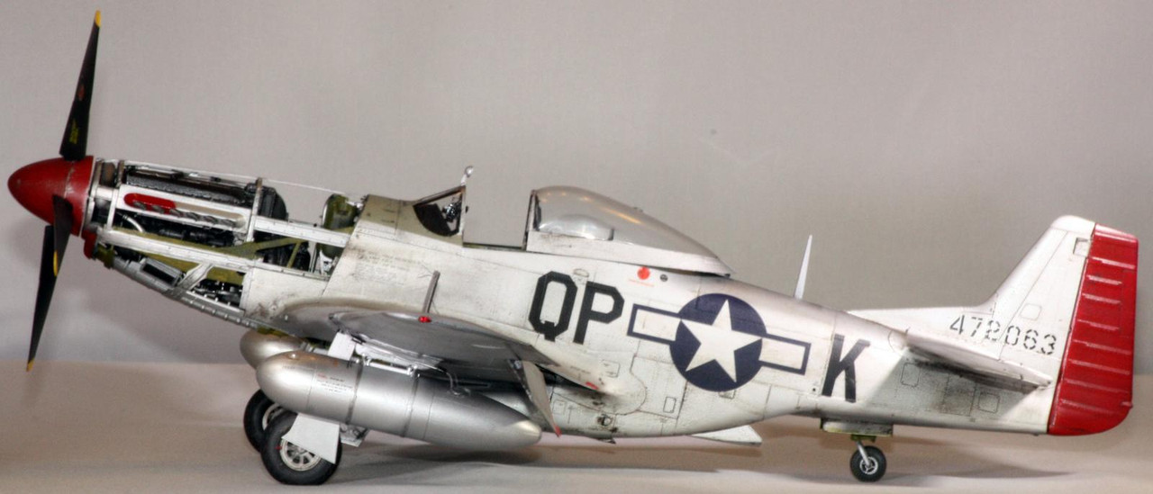

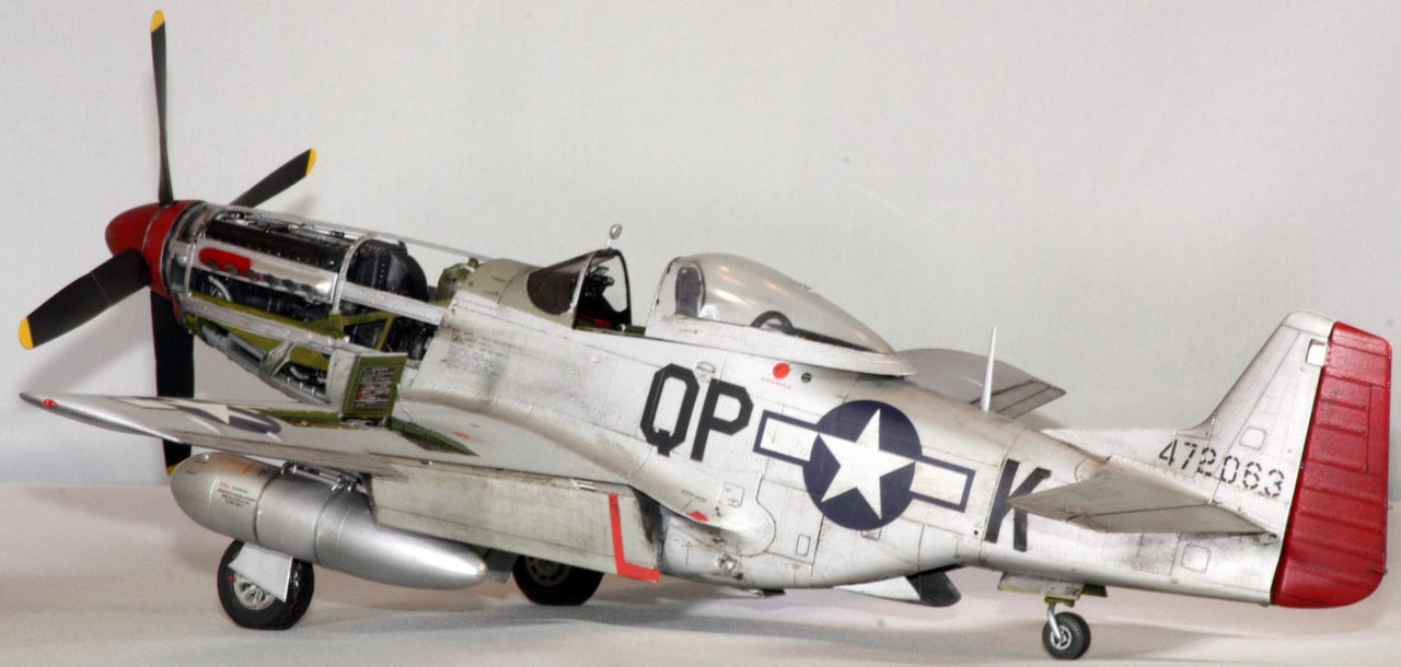

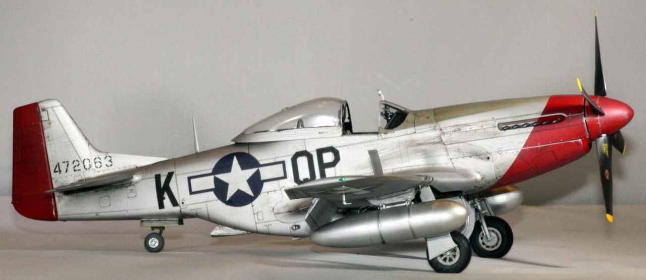

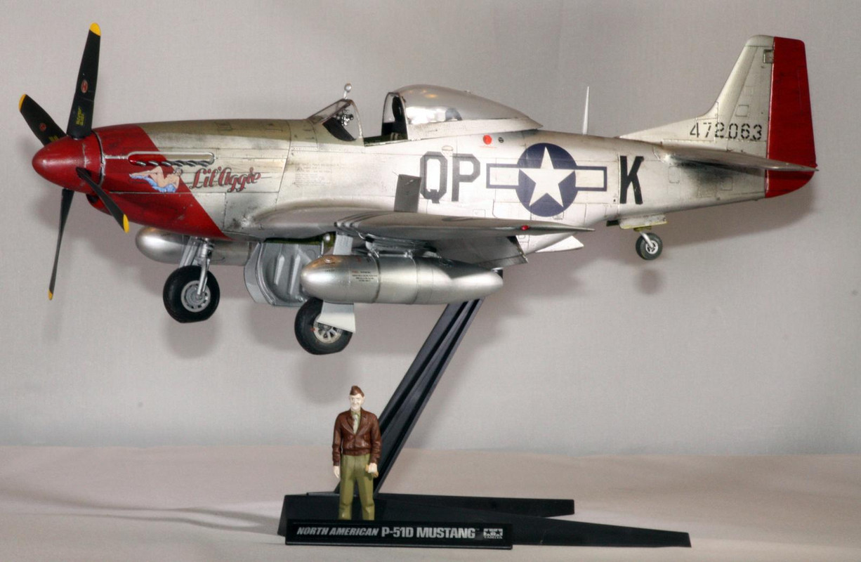

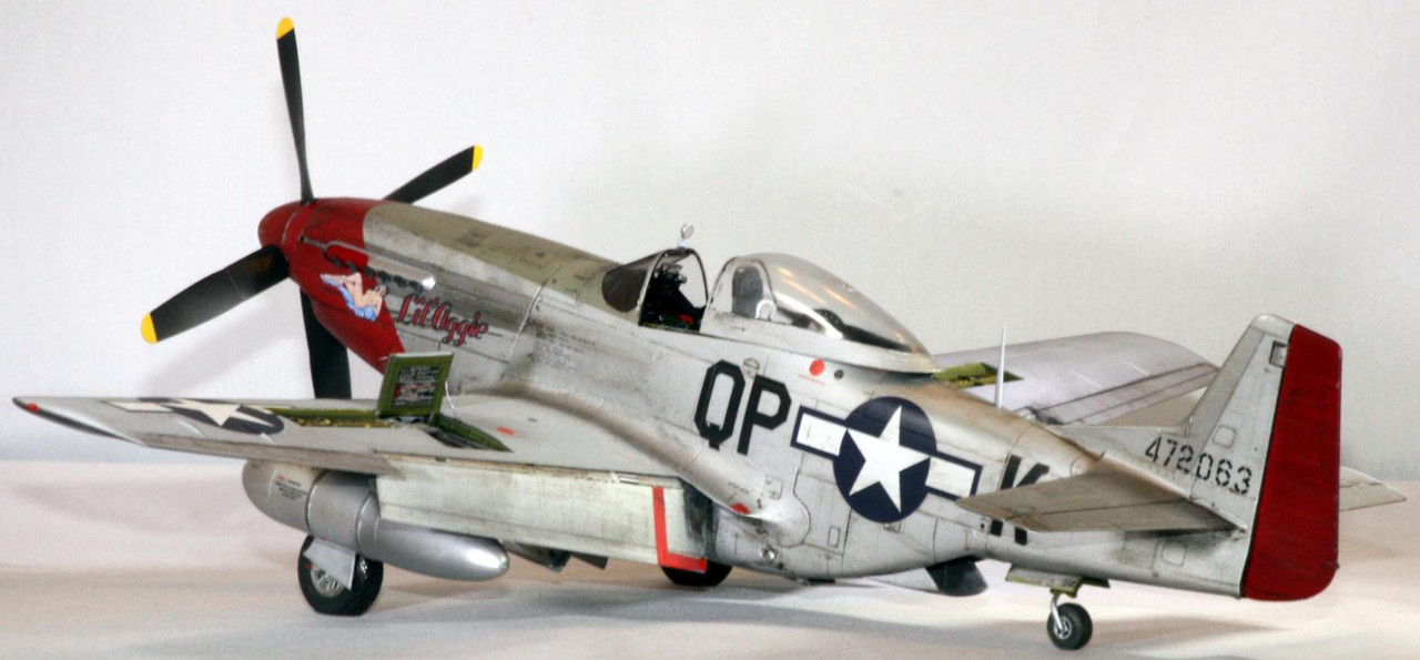

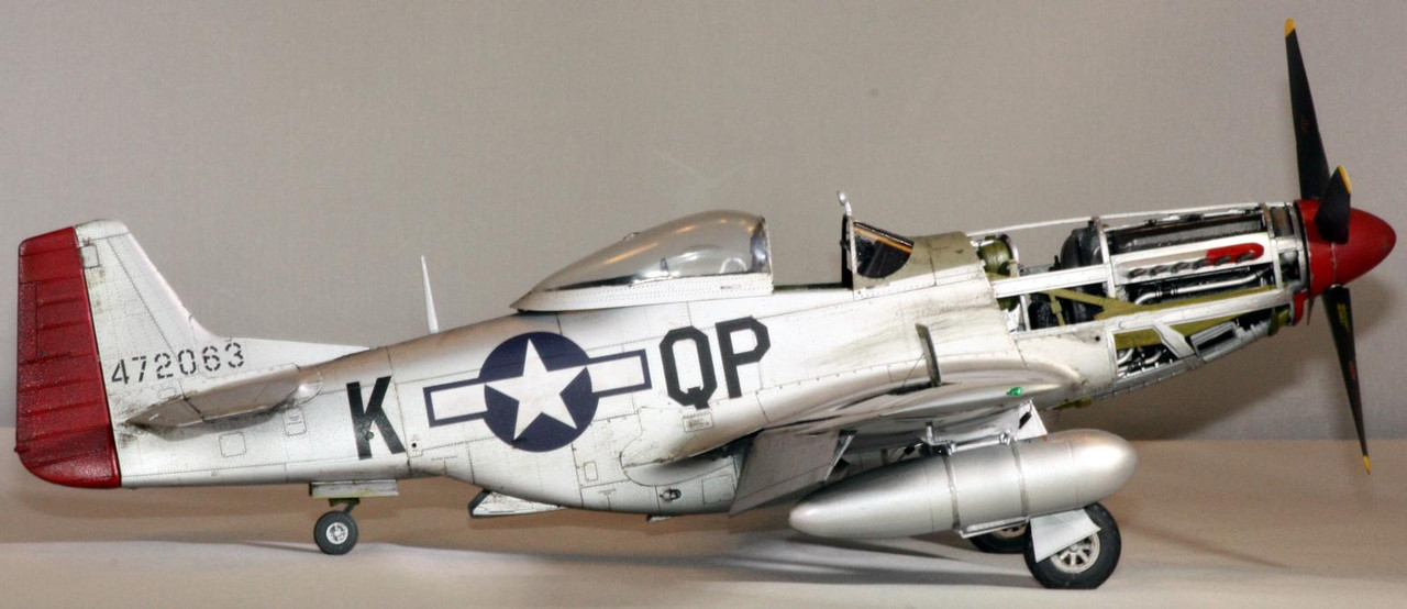

Now for some finished build photos. This kit comes with a bunch of magnets that allow for the engine cowling parts to be easily removed, or to remove other parts that feel way too much like a toy (operating landing gear) or swapping out parts such as the gear bay doors or the rear landing gear. I used all of the magnets but none of the swapping stuff is actually available, as I glued the gear in place. I did leave the cowling panels removable, although the underside is actually difficult to get into place so it will be staying on.

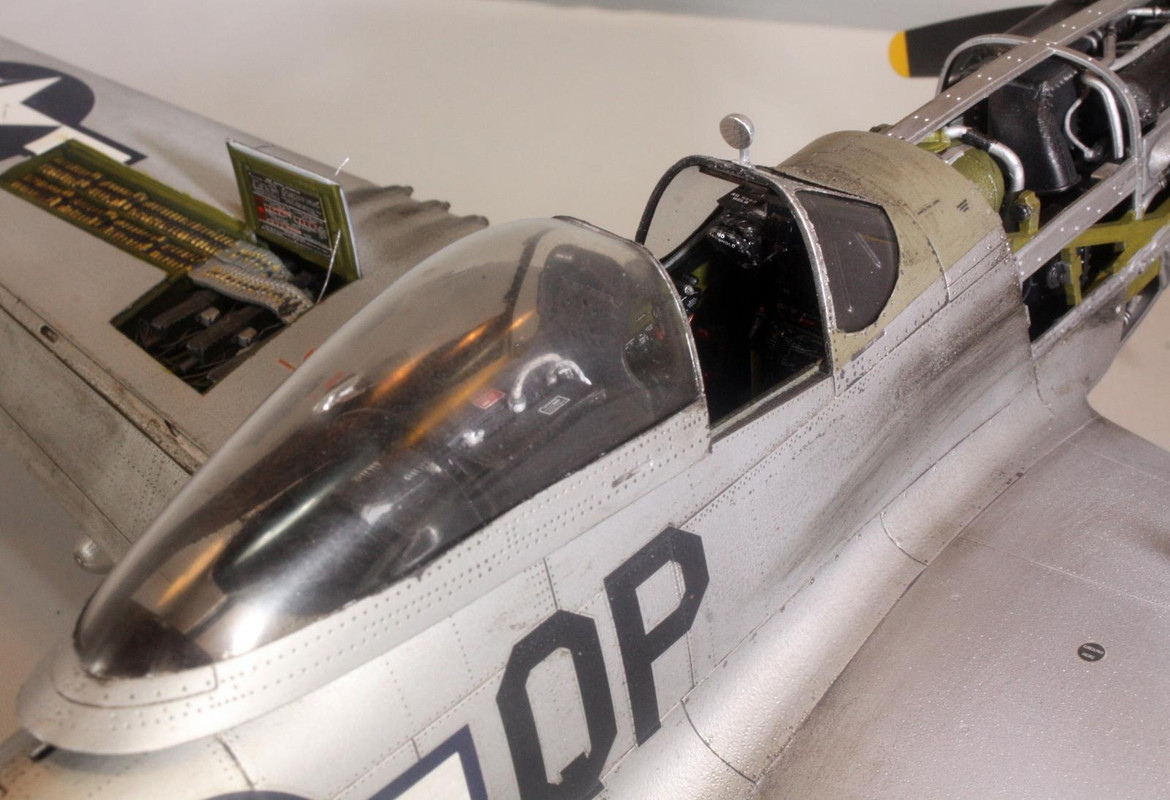

Some close-ups.
Note the added parts to the gunbay door. There is a PE sheet available that includes these parts, but I opted to use bits of lead wire to replicate the actuator for the door and what I presume are locking bars for the door itself. To the naked eye my efforts look okay but up close not so much.

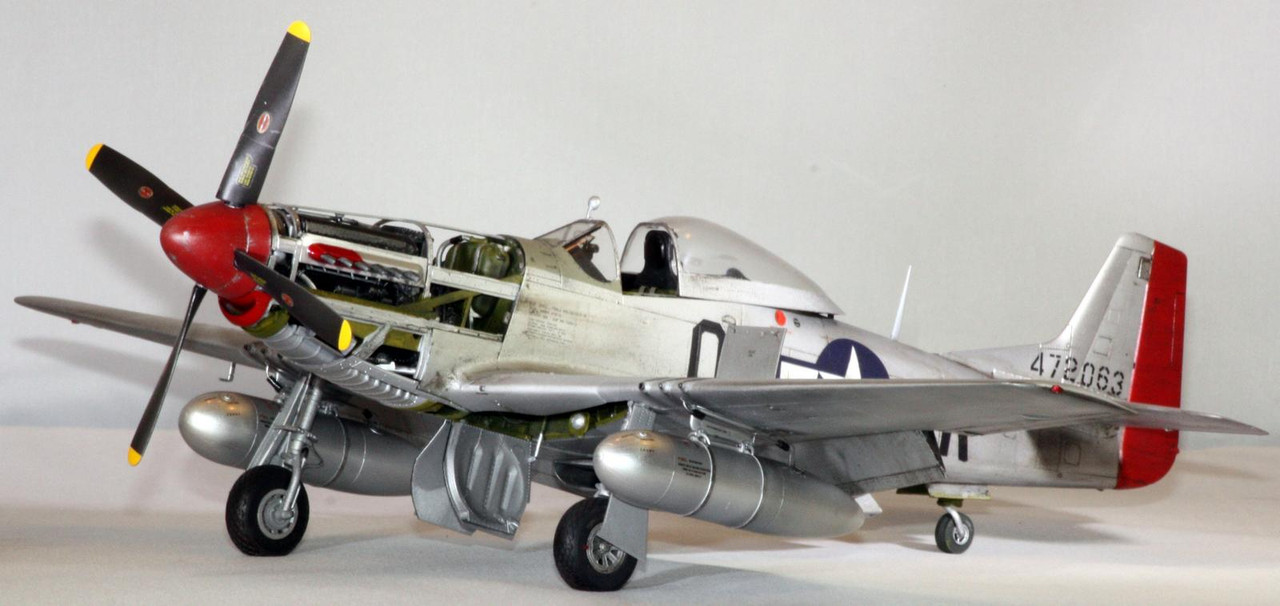

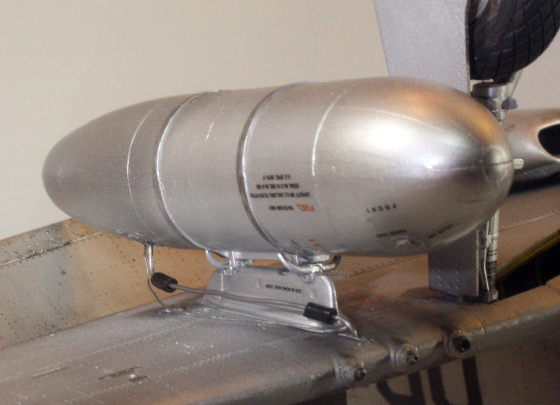

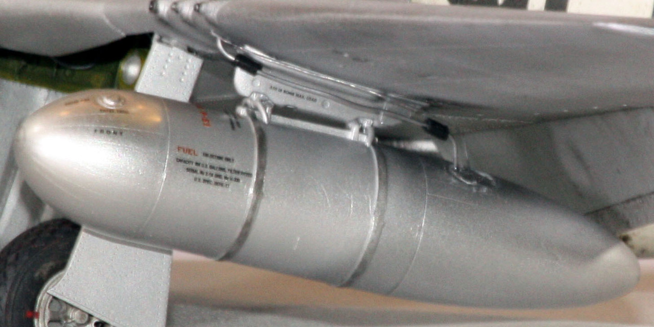

I added plumbing to the 108 gallon drop tanks.

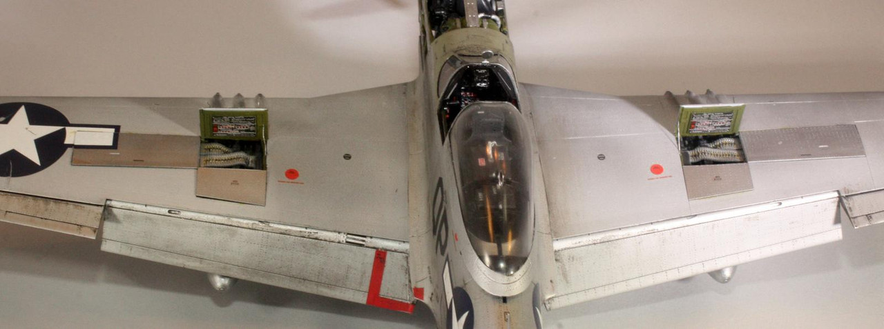

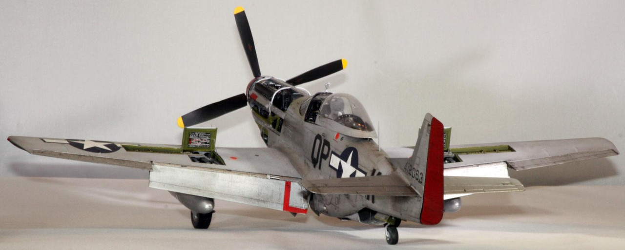

The gunbay doors don’t actually fit well. I don’t know if that is a builder error or a kit issue, but in any event, I was always going to leave them off to display all the work I did in the gunbays. If I was going to do a diarama, these baydoors would be on the wings as if crew were working on the guns.

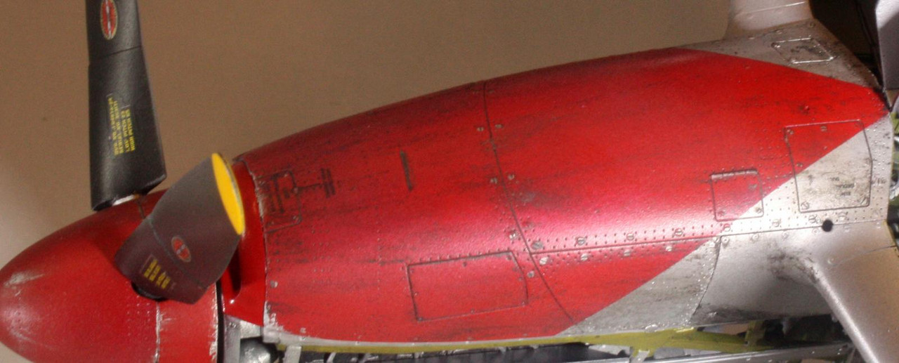

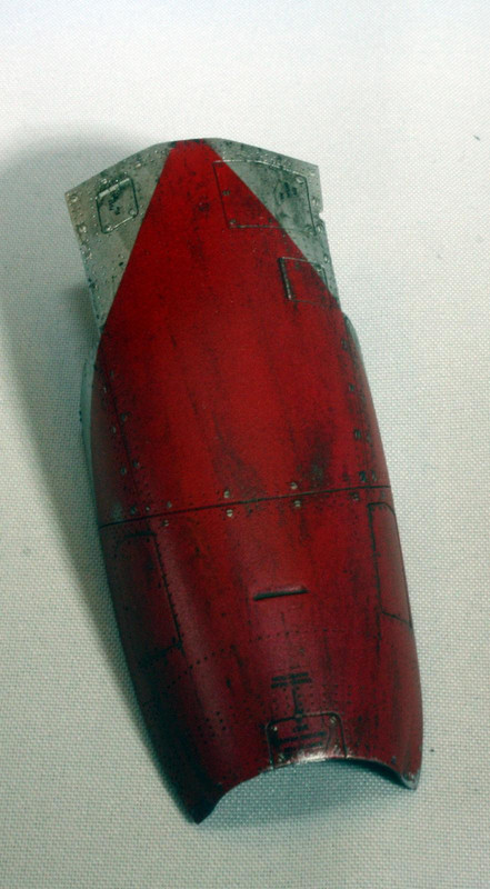

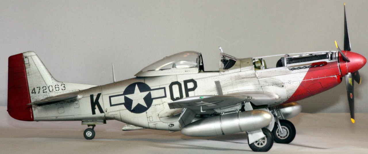

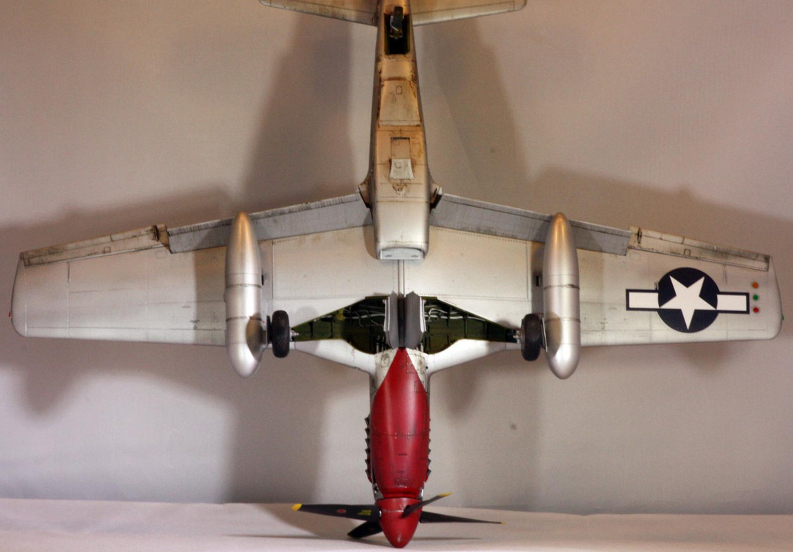

I thought the underside cowling cover should show just a bit of oil stains and other dirt. I also did some dry brushing with aluminum paint to add to wear and tear to this 'Stang.

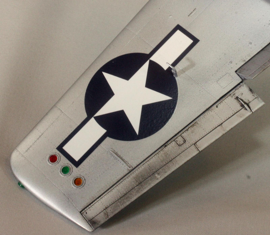

I also dirtied the flaps and ailerons. The wings themselves don’t show a lot of grit as the rivets were typically puttied over to improve airflow, although the putty would flake out over time. I could probably have added a bit more dirty wash to the wings, but I actually liked the relatively clean look there as opposed to other areas of the Mustang.
The stand for this is insufficient when aligned facing forward, as on my previous Tamiya 1/32 builds of the A6M5 Zero and Spitfire Mk. IXc. The Mustang was nose heavy, so I rotated the stand facing to the rear to offset the engine weight. Then there is the standing pilot figure. I don’t do faces well at all. Clothing turned out good, I think, but his face is way too monotone, and probably too in need of some sun as well. I used a 0 tipped brush and was able to paint his eyebrows and even his eyes (first a light brushing of white and then a pinpoint of blue, but that just looked cartoony).
This is a great kit. I think I did a reasonable job on it, given the Krylon issue I had. There are some areas where I can see the problem areas, but in general, to the naked eye I think those areas just look like part of the weathering job. The Kits World decals worked great, but that set didn’t include the insignia, which came from the kit sheet. The insignia on the port wing gave me fits. Looked like it was snuggled down just fine, even put a coat of decal softener on it, but when I went to spray a coat of gloss clear coat, the dadgummed thing lifted right up. I had to work at it a bit to get it to adhere, but even then a small chunk of it ripped away during a later spraying session.
