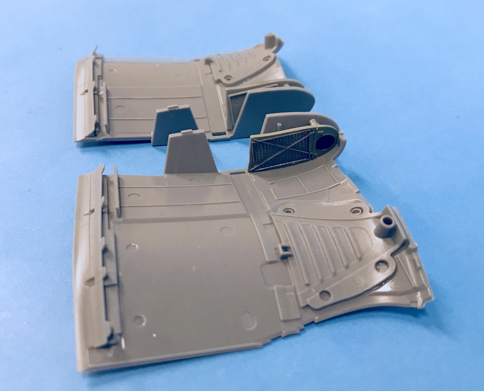

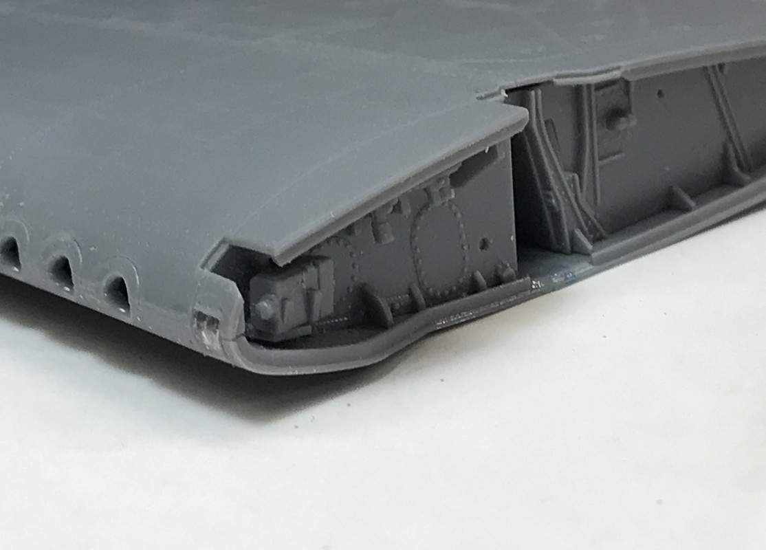

Building in the inner details of the wings is a lot of fun. First I did some dirtying up of the oil cooler intakes. I again used the Tamiya Black Panel Line wash.
That dirty front lip is hidden behind the fairing that goes on when the wing halves have been brought together.
I glued in the main spar and all the bulkheads and almost screwing it up by gluing the wing bulkhead in before the spar. It goes on top of the spar and interlocks with it. Luckily, the glue hadn’t set and I was able to disassemble the errantly glued part and get it right. I then painted all the wheel well interior parts white. I then masked the white and sprayed the interior green on some parts that will never be seen. I didn’t spray the exterior wing joint since this is going to be intermediate blue.

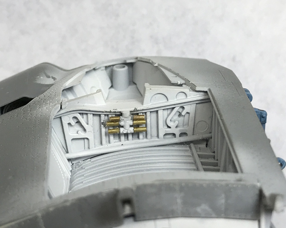

Here’s the reverse view. There are a suprisingly high number of parts in this sub-assembly.

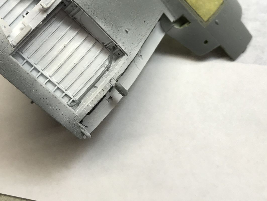

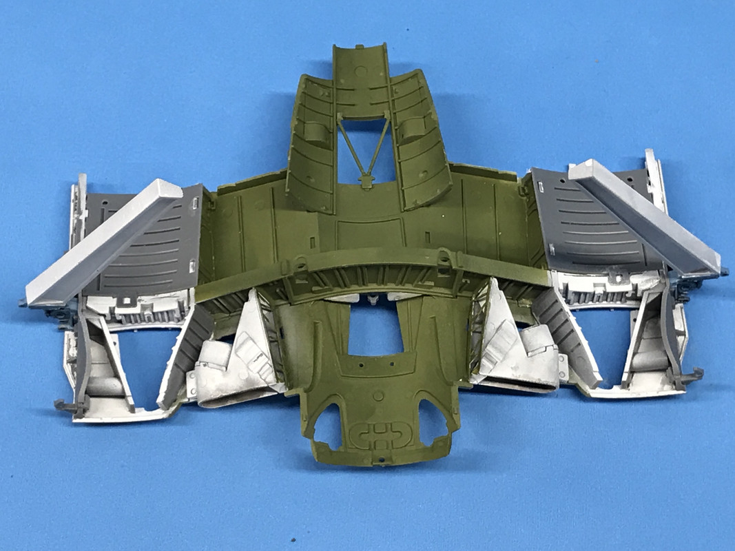

The wheel well ceilings were painted off the model so I could air brush the interior walls from both directions. I then glued the ceilings into place. Here’s the wheel well fully painted before any weathering. The overspray doesn’t matter since this section ends up being white.

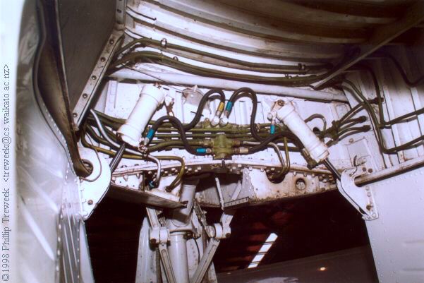

While there’s a ton of detail in the wheel area, what’s missing is all the hydraulics. After gluing in the control valve for the wheel door cylinders. The valve and cylinders are there, but no inconnecting piping. So… what to do? The problem is that the valves are glued in place and not easily accessible. I didn’t even realize what the valve was when I glue it in place according to the instructions.
I can’t get the micro-drills in at that angle. I may be able to get the micro-tubing over top of the those little fitting and put the tubing into the tubes. You can’t see these details unless the model is picked up, and I don’t want people doing that.
Here’s an example of the piping that’s missing.
I know I’m going to add some 3D piping to the wing fold area since it is so obvious. Whether I’m going to do it in the wheel well remains to be seen. The detail is all on the back of the main spar and won’t be seen looking from the front. I’ll take input from all of you to help me decide.

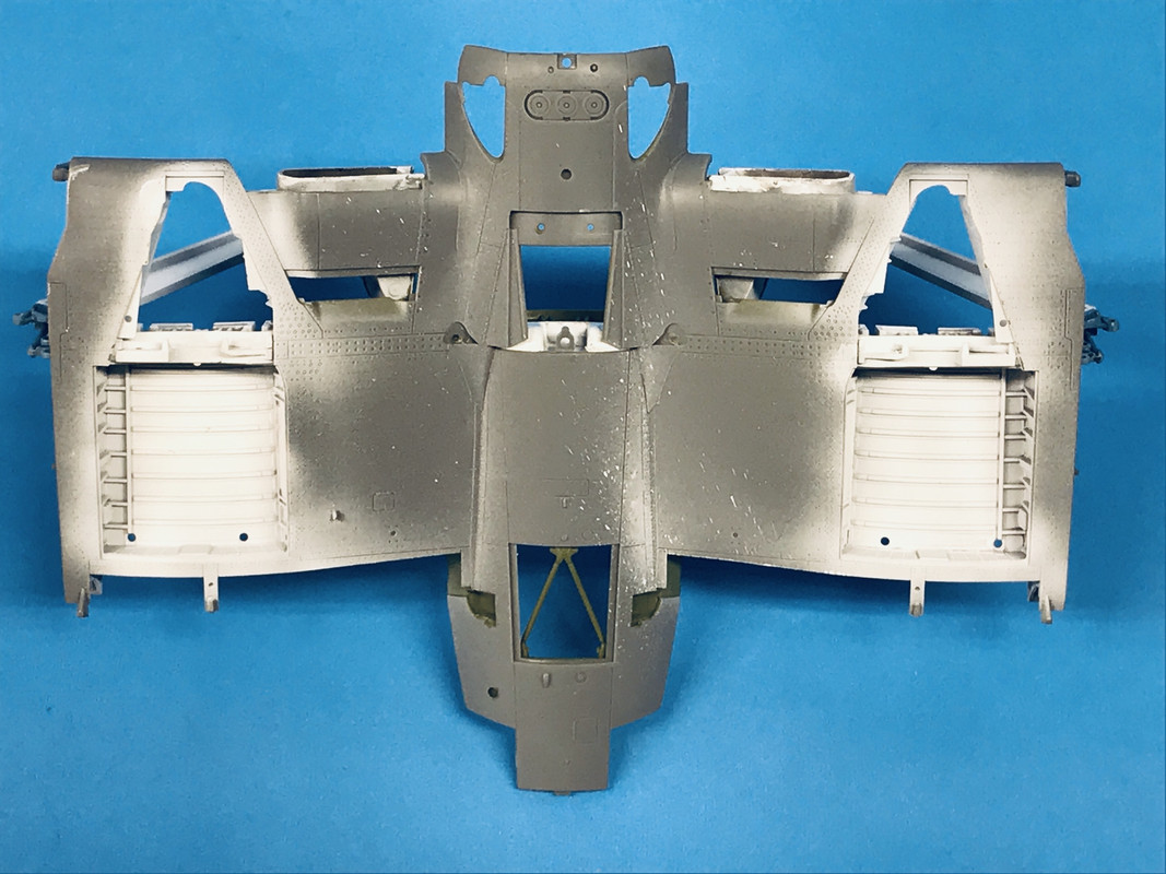

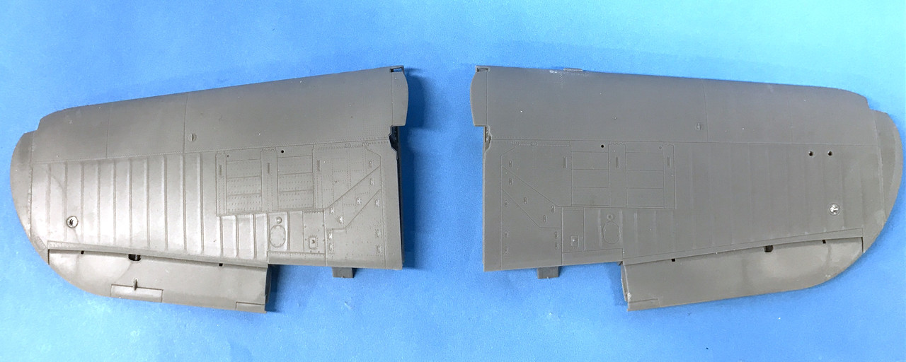

Today’s output was a mixed bag. I got the upper center wing skins fitted out and joined to the lower skin. Got the lower skin bottom all fitted out with a couple of hiccups. Then I decided, fatefully, to start working on piping all the wheel well hydraulics. And just at the end of the day, when putting too much stress on the wing trying to get the last stubborn brass fitting on the gear door valve, I broke off the folded wing spar. And this is not going to be an easy fix.
So let’s begin at the beginning.

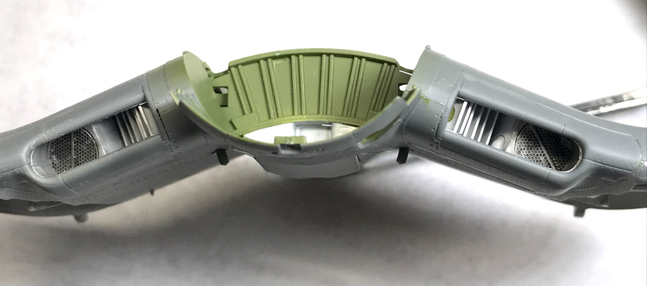

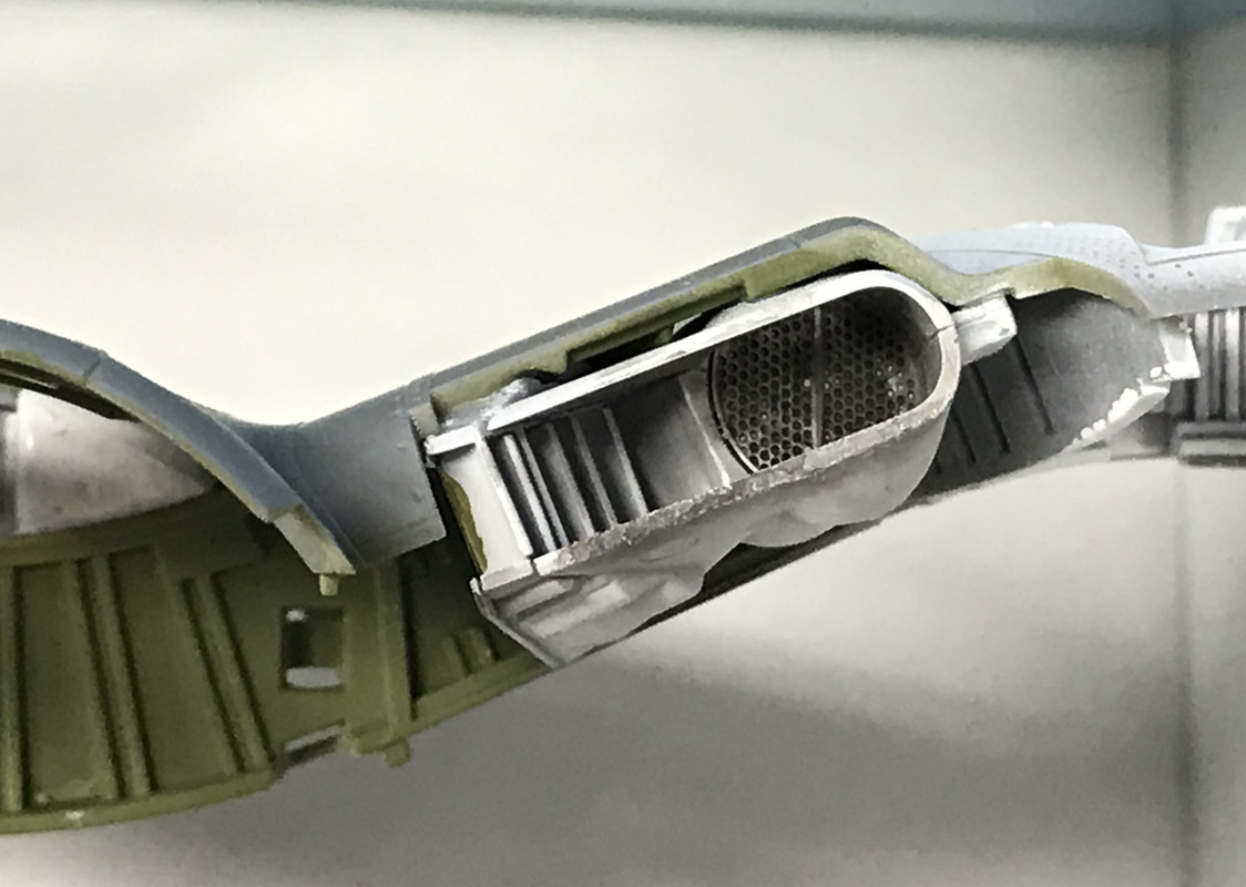

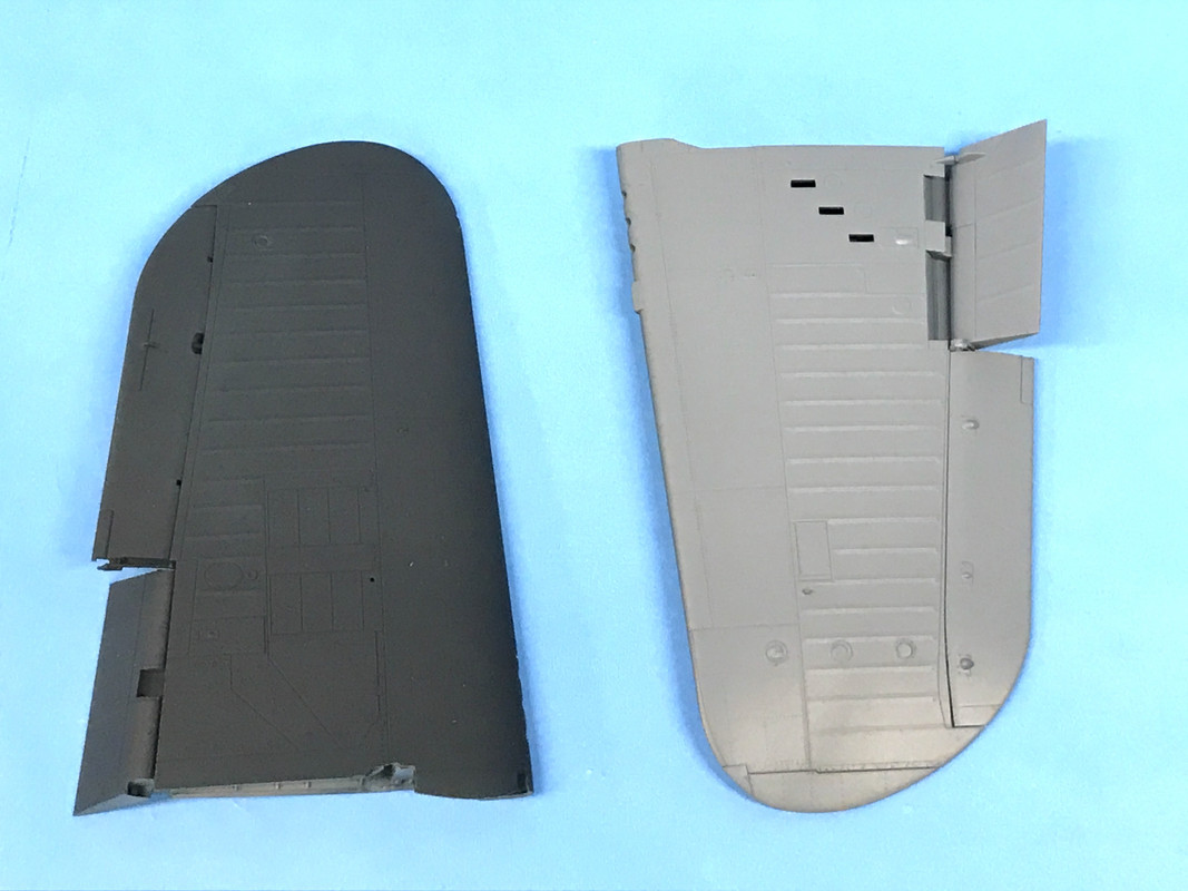

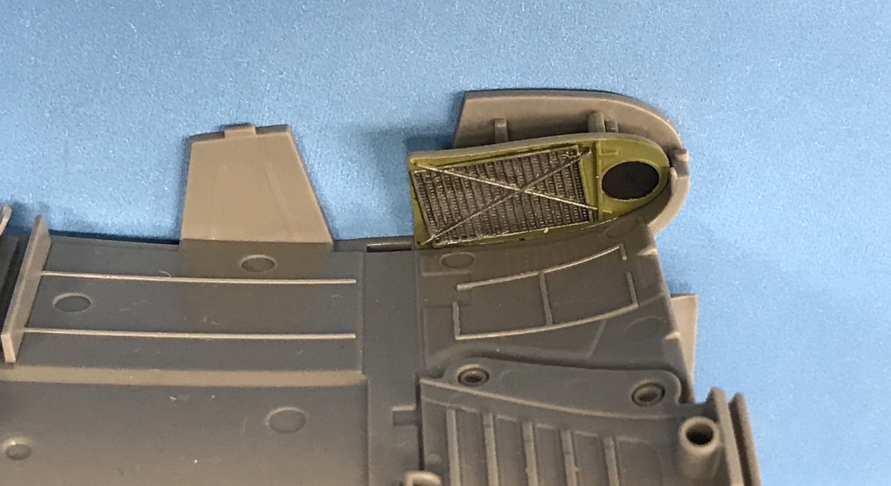

On the bottom of the upper wing skin there are three parts on each side: the intercooler face at the wing root, the ceiling of the forward wheel well and the reverse curved fairing that contains the flaps. You have to constantly pay attention to whether you’re building a “flaps up” or “Flaps down” version since there are different fairing parts in the flap area. I’m building “flaps down”.
Here’s a CU of the intercooler. and the duct leading to the carburetor.
The intercooler was supposed to be Tamiya Metallic Gray so I mixed up some Life Color dark sea gray and Tamiya chrome silver. And of course, none of this is even remotely visible in the finished model.
The top wing was joined to the bottom and, of course, it fit like a glove.
The leading edge fairings for the cooler inlets went on nicely and the innards look pretty good. If you were able to peer through the louvers, which you can’t really do very well, you would be able to see the intercooler facing. But I know it’s there.

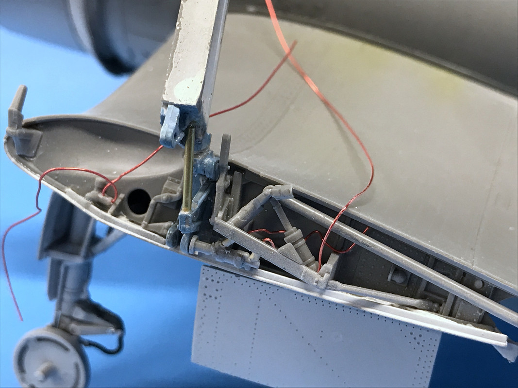

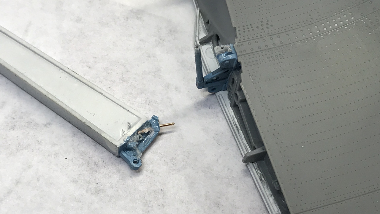

This brings me to the wheel well piping. I found that one of my Albion fine brass tubes is has the right O.D. for my finest gauge of solder. And this same tube kind of fits onto the nubs representing pipe fittings on the valve, except for the top position. I had to cut this off so the tubing will fit on the narrower stem.
I got 11 out of 12 fitting in place and was fussing with the last one. It was one that would go over the top stub which was just a bit oversized and I was pushing a bit too hard and didn’t realize what else I was putting pressure on. It was the folded outer wing spar. And this is a bad place for a break. There’s very little surface area for gluing, and similarly, there’s not much material to drill and pin. My first attempt to pin the hydraulic actuating arm and got it pinned, but then it broke below the metal reinforcement. I then drilled the main part for a pin, but it’s a bit misaligned.
This is getting messy and I’m contemplating what it would take to rebuild the joint entirely in brass. There’s also another possibility which is to have one wing up and one wing down. That’s not a terrible thought and I have entertained it before. If I don’t make the entire thing out of brass, I could make that actuating arm out of brass and marry it to the plastic parts. All of the lugs and fitting could be brass since I’ve been doing stuff like this fairly recently. In fact, if done correctly, you could almost make the wing fold functional. Stay tuned…
Sorry to hear about your mishap but a working hinge out of brass? I would want those to add to the kit so maybe you have accidentally found a sideline?

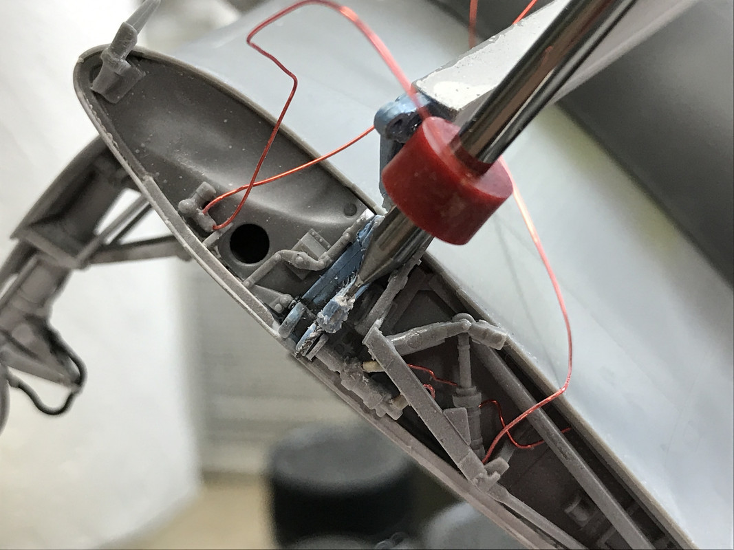

The first thing I did today was photograph the hinges from both sides, import it into CorelDraw and draw the 1:1 scale parts for the hinge directly over the scaled pictures.
The parts are very small, so before getting into a jewelry project I decided to see if I could get the plastic parts together using metal pins of varying sizes. For the main joint I used 0.022" phosphor bronze, and for the fold actuating strut I used a piece of 0.010" guitar E string. I’m pretty good at drilling tiny holes in the middle of tiny rods. I use a very sharp dividers pin to make a mark in the center of the part and then drill it with the carbide drills. This time, I just spun the drill back and forth in my finger tips instead of putting it in a pin vise. I found I could control it better and not put too much stress to break the drills.
This actually held pretty good. The junction is pretty munged up with CA, but the intermediate blue will hide some of it.

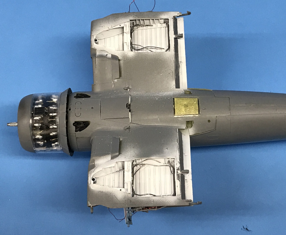

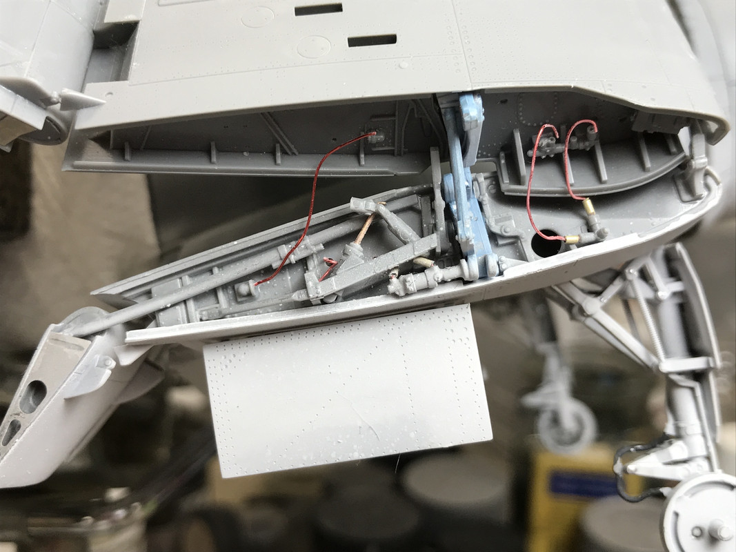

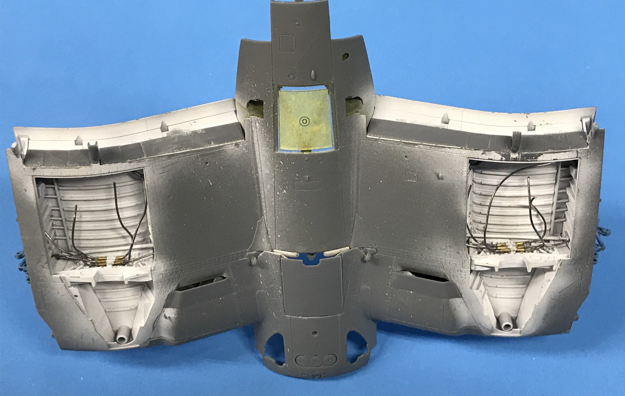

With the hinge fixed, I got back to putting in the wheel well piping. I got that last ferrule into place and then, using thin solder (about 0.022), I put the 6 lines to the control valve. The two center lines come and go to other parts of the airplane so I drilled holes in the wheel well sides and fed them through. The top and bottom lines on both sides go to the tops and bottoms of the door operating cylinders. These are put onto the doors first before you glue the doors on so the piping can’t be completed until doors are in. I’m not so sure how well this is going to work and I’m going to see if the cylinders can be installed before the doors so I can paint the entire bottom before the doors go one.

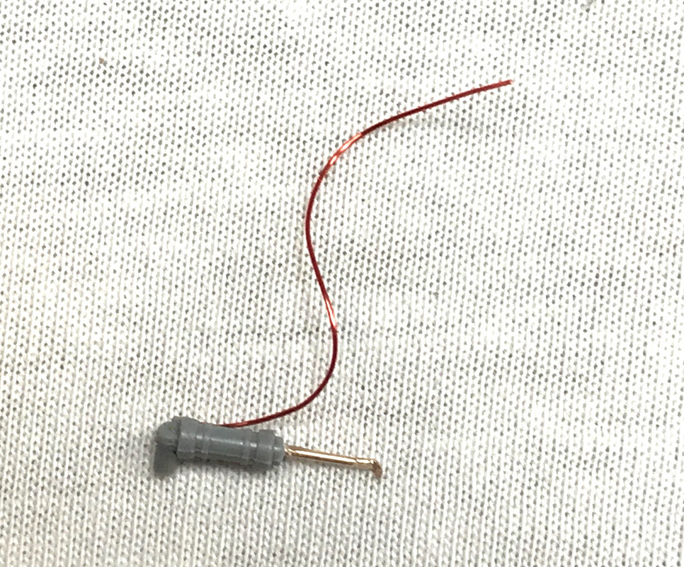

There are number of other electrical wires that pass through the wells, but I’m not sure I’m going to install them. That being said, the main gear actuating cylinder will have lines going to it.

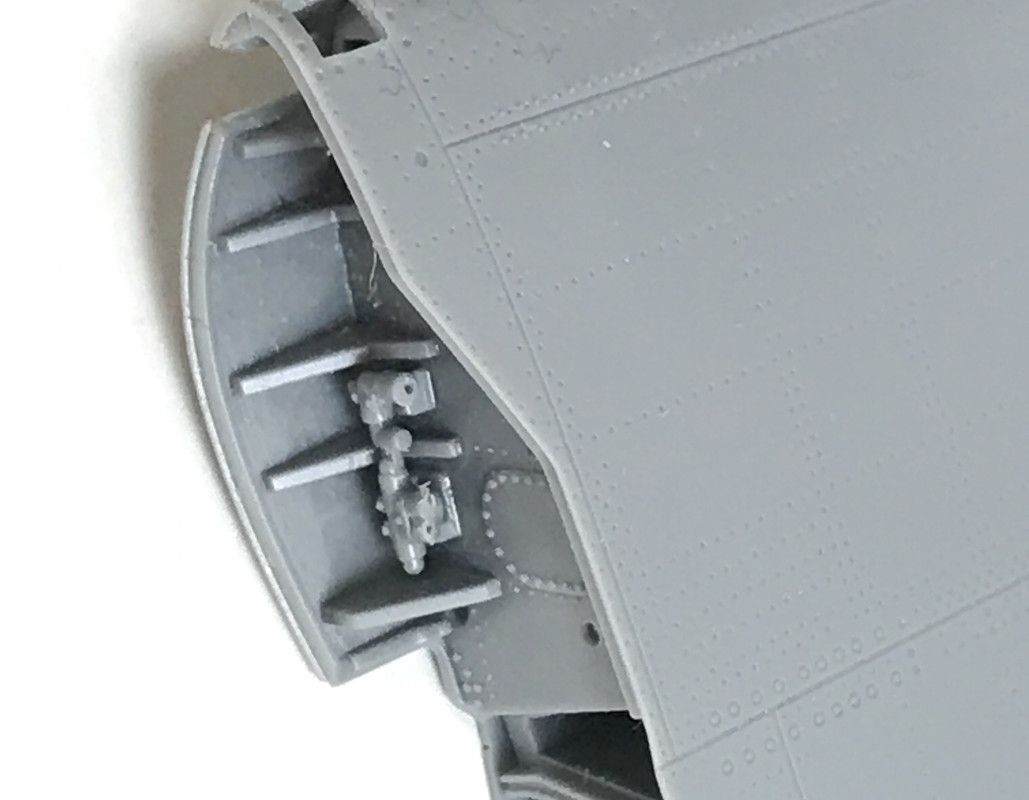

Next up was the wing fold detailing. It’s a very complete model just with the plastic. I sort of painted myself in the corner by putting in some oversize fittings that impeded putting in the parts that came later. It’s hard to figure out where these pipes should go before the rest of the parts are in place, and then it’s too difficult to put them in so you have to get a head start.
For the fold area, I did smarten up a bit. I put the piping on the fittings BEFORE gluing them into the wing. And I held the wing with a quick clamp that was in turn held in my Panavise which kept my clumsy hands away from those delicate wing spars so I wouldn’t break them again.
It was those two fittings that got in the way. This is a critical part in the airplane. It’s the hydraulic cylinder that moves the pin into the wing lock that prevents the wing from folding up again when the plane’s in the air. It has a line on both ends since it’s a double-acting ram.
Another hydraulic cylinder that goes in is the flap actuator. I broke off the piston rod on this one so I made another with a piece of 0.022" phosphor bronze. I flatened the end and then bent it so it would wrap around the little pivot.
Here’s all the hardware set into the fixed wing portion of the wing fold. There’s also a valve body that goes into the folded wing area and piping associated with it. It’s basically a swivel that permits the hydraulic lines to pivot around the wing-fold hinge line to get the fluids to the ailerons which are also hydraulically assisted.
You can see the fitting mashed over the side with the addition of the flap actuating lever.

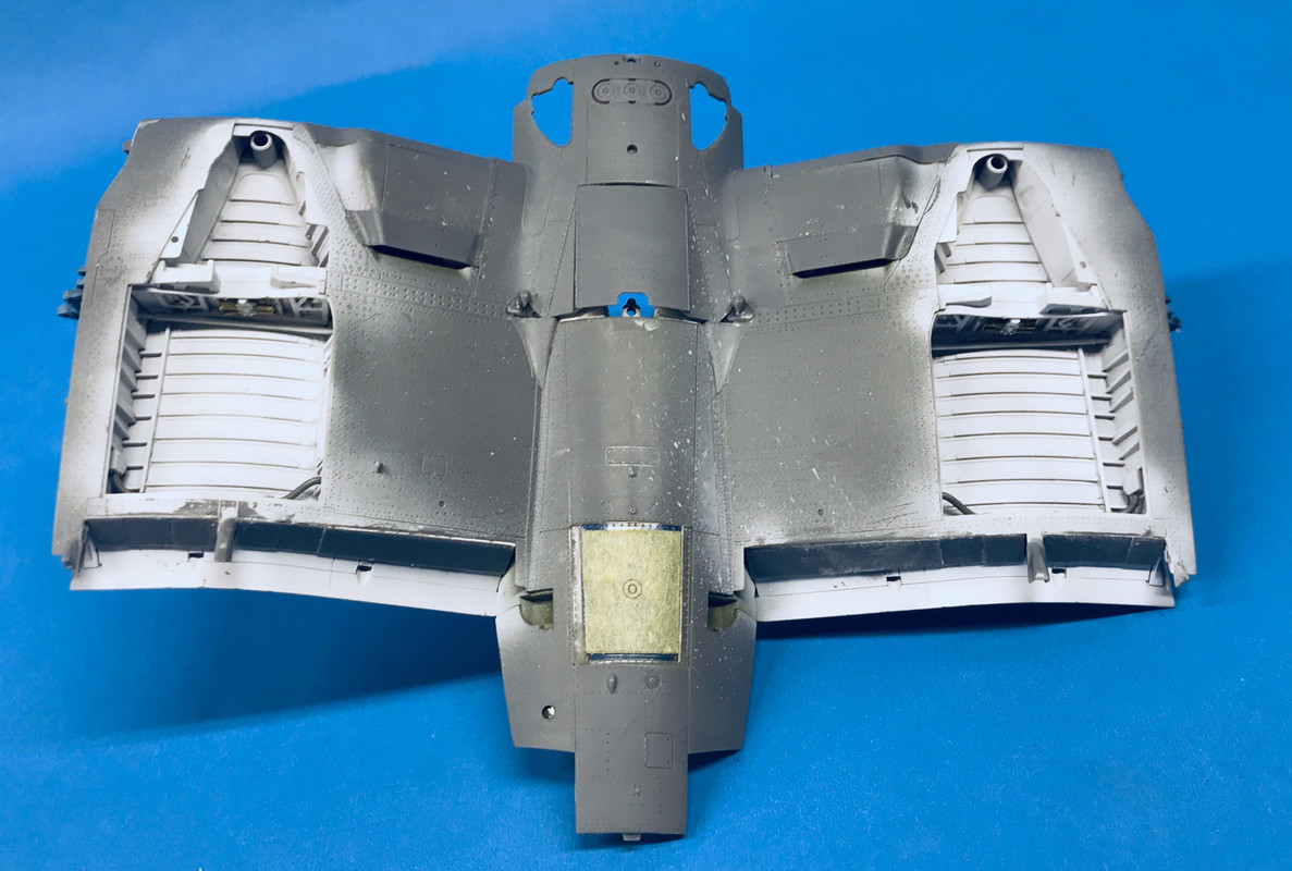

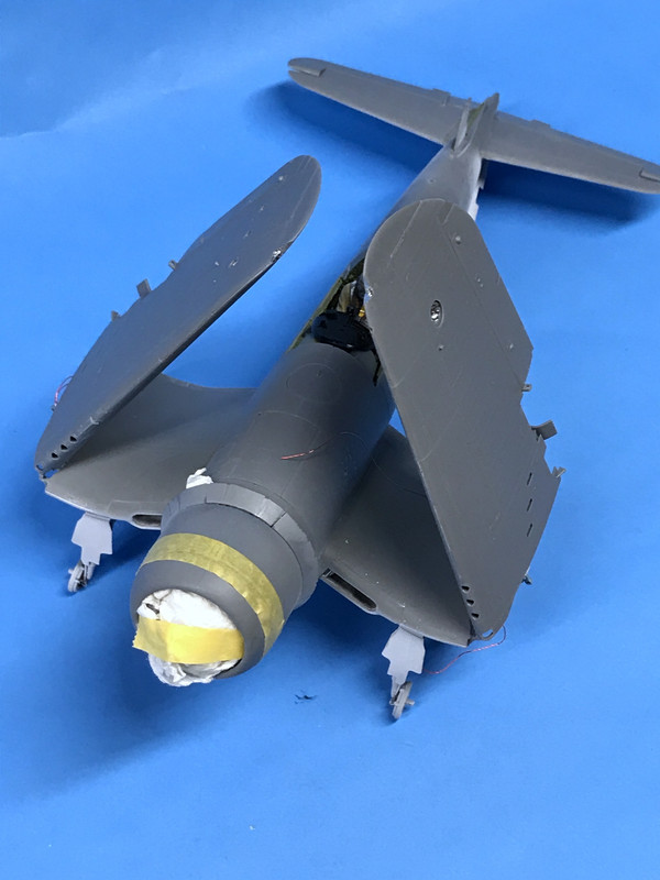

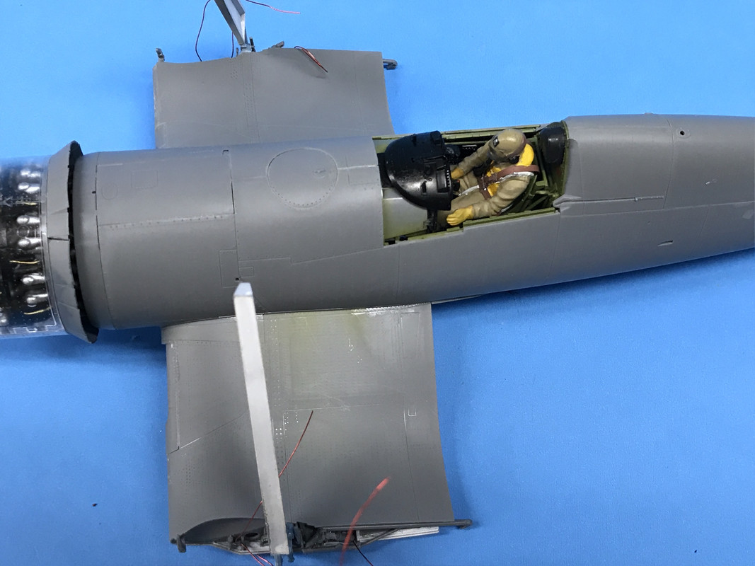

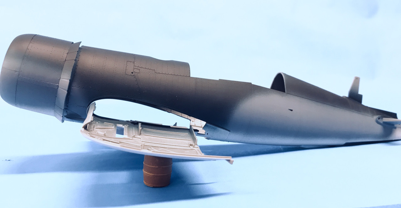

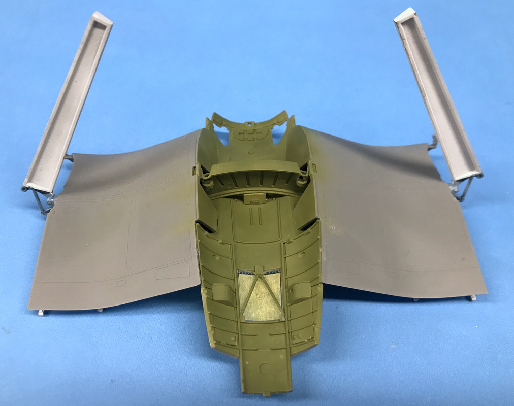

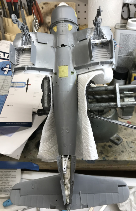

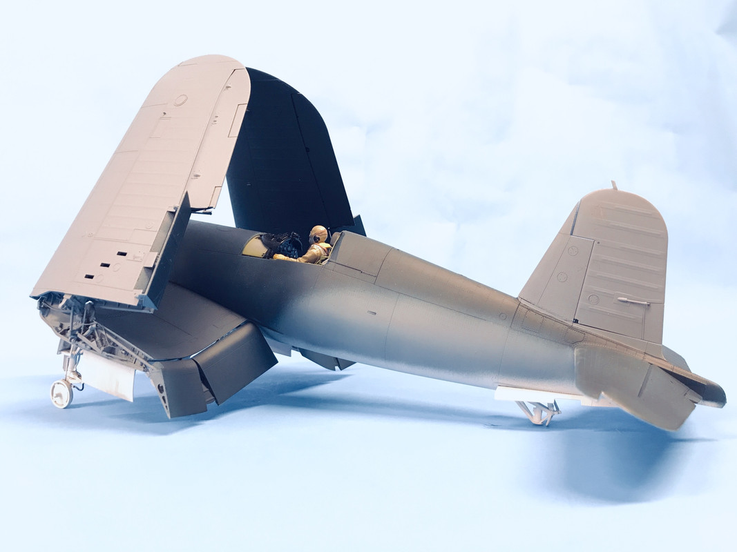

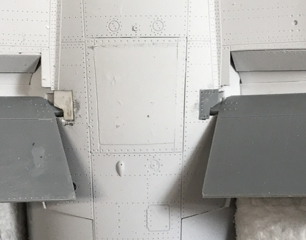

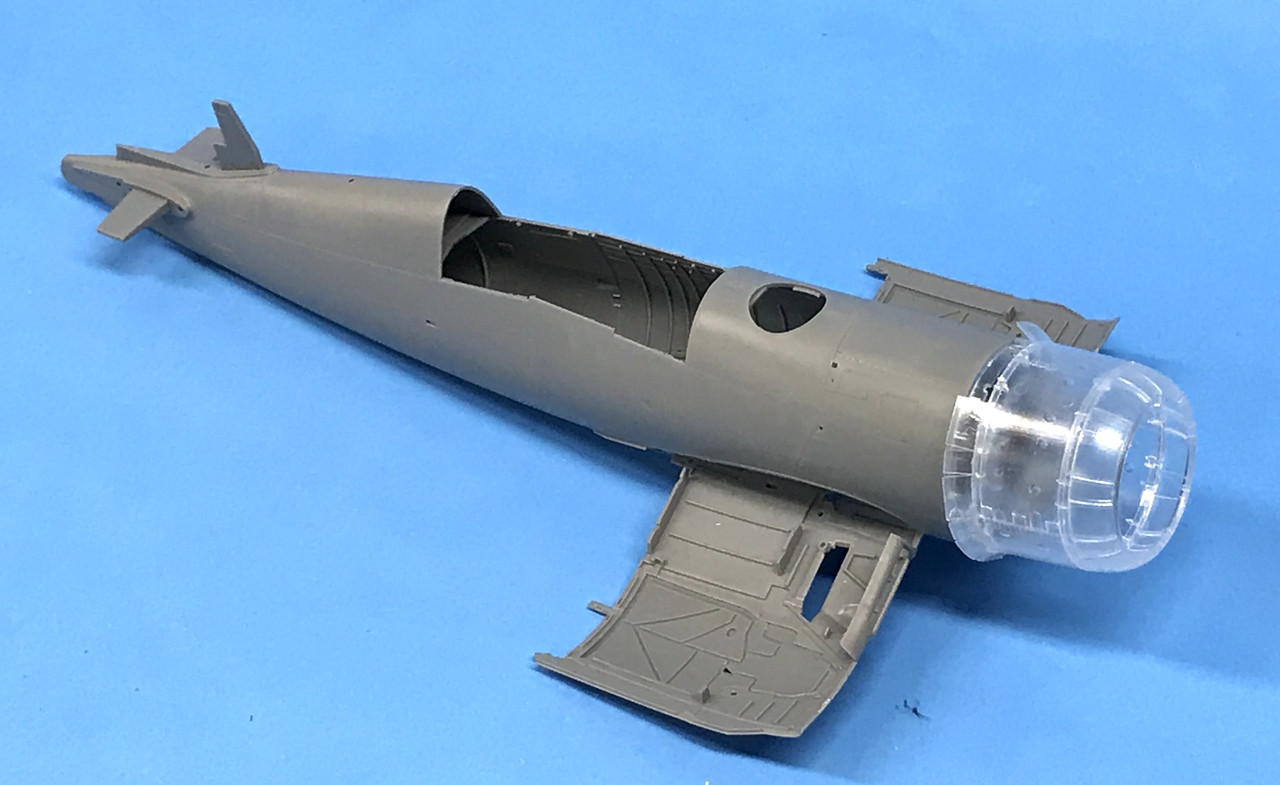

The next milestone step was the joining of the wing to the fuselage. Like other steps, this one went together very well. I put the thin cement on the outside of the joints and just let it wick in. Any surface inperfections that this causes will be hidden by the paint.
I’ll have one more work day on Monday to start work on main landing gear and then we’ll be off to our son’s house for Thanksgiving.

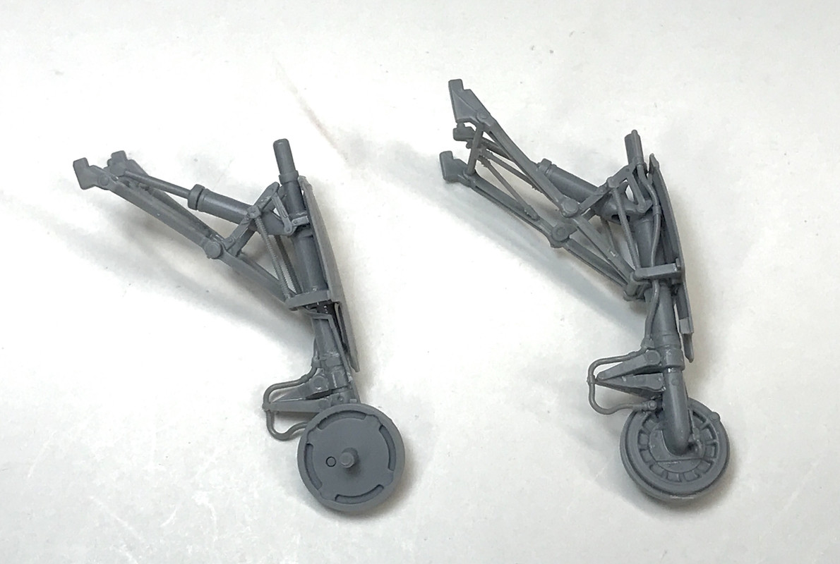

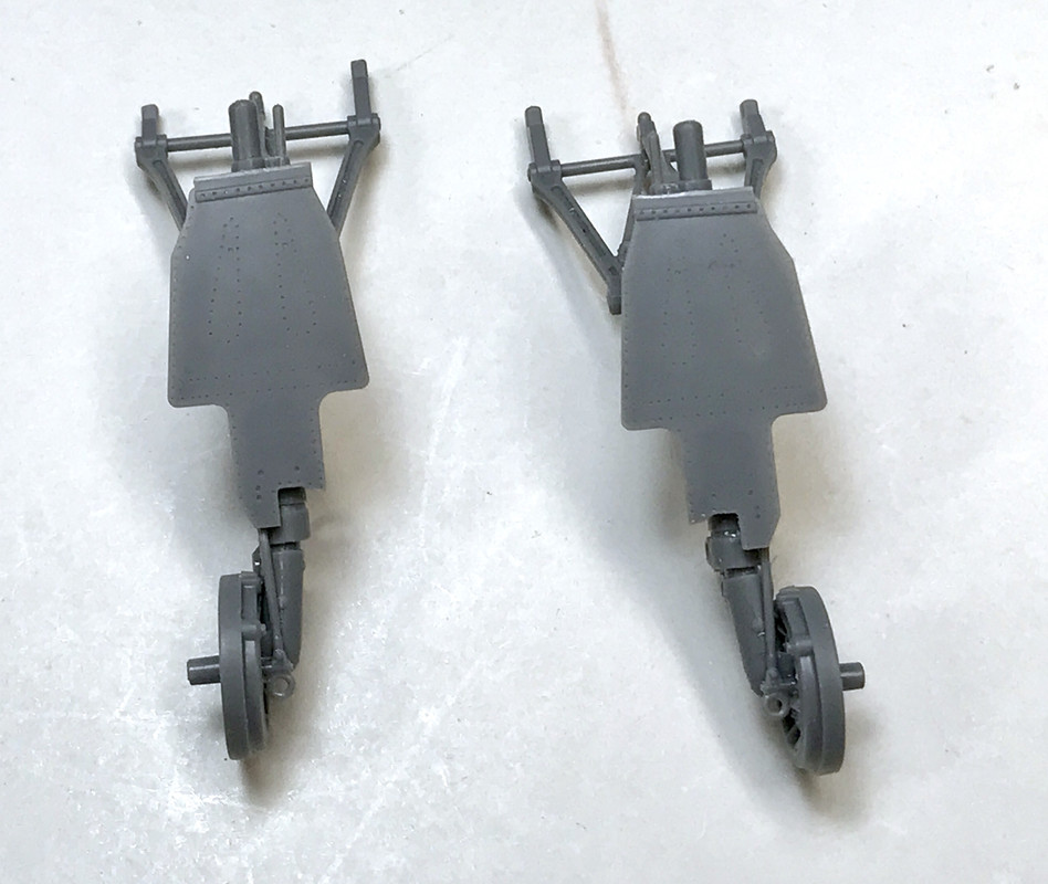

My session today was spent assembling those very intricate main landing gear. Many parts are included and there’s a steel shaft that is glued into the two halves of the main strut. This stiffens the assembly nicely and I’m sure that it will support the plane as it should. Being a tail-dragger, no nose weight is needed to have it sit correctly. I drilled the jack cylinder to prepare it to receive the hydraulic lines. Which, BTW, I find that it looks like the middle line from the valve didn’t go through the wing bulkhead. Instead, it goes through the main spar and enters the gear chamber. This tells me that it’s the one that operates the jack. So I prepared the valve by attempting to pull the solder pipe out of the wing bulkhead and re-route it through a hole in the main spar that I drilled. But the line was too short! So I tried to pull the line out of the brass ferrule, but the middle and bottom ferrules broke free of the valve body. So now I’m in the middle of reattaching everything… and then I ran out of time.
The gear will be painted off the model since there’s a decal that goes on the strut that will be easier to apply when they’re separate. There’s very little of the oleo piston showing so using the Chrome Pen or Bare Metal Foil is going to be very challenging. You don’t have to rig a break line on this model. It’s nicely molded by Tamiya.

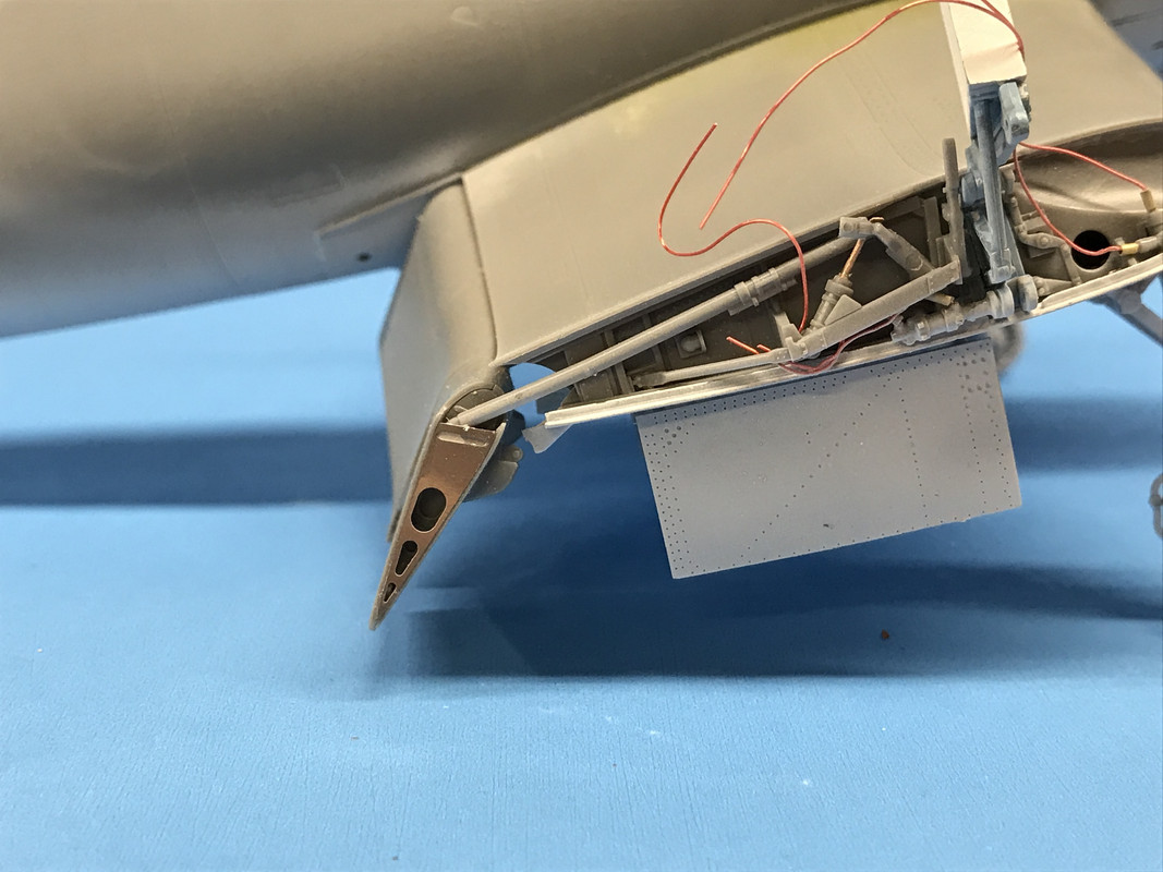

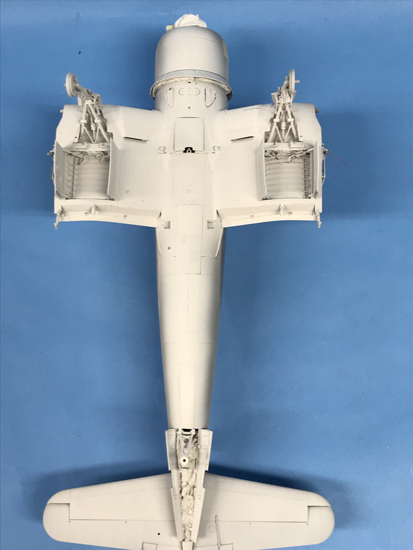

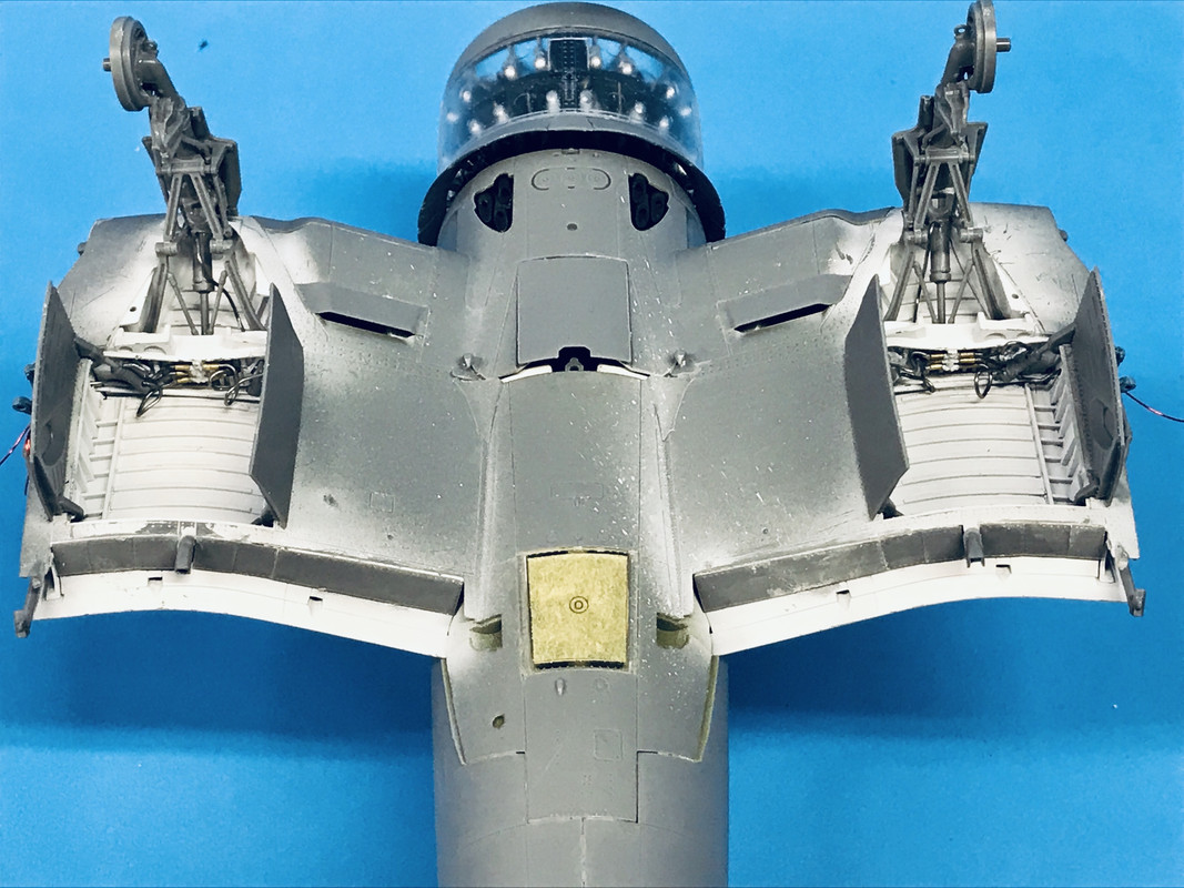

Got back in the shop this afternoon and finished up piping and building the undercarriage. I was able to attach the wheel door cylinders to the doors and then to the plane and still do the piping. I pre-drilled the cylinders to accept the piping while they were off the parts. I then masked the bottom and sprayed Insignia White (Tamiya Flat White an a touch of Flat Black). With that drying I started building the inboard flap system.
It was good that I took a break from this build since it was not difficult to fix the piping that had come loose, whereas before we left, I was definitely struggling. It’s not quite accurate, but it’s busy enough that no one will ever see the missing lines. For example, the main gear jack having only a deploy line and not a retract one. I also don’t have the right amount of pressure and drain leads going into the airframe.
I then was almost ready to spray the bottom, only to catch myself. I hadn’t sealed up the holes to prevent Insignia White from getting into that beautiful engine, those neat exhaust pipes and the inside of the tail wheel housing. I used dampened paper towels to plug up the cowl flaps, the engine front and the inside of the tail wheel housing. I trimmed Tamiya masking tape to plug the exhaust opening.
I then airbrushed the white on the bottom. Since this is the first layer of the three-color scheme, there’s no need to mask the separation line. I will go back and do all the detail painting. For example: the flexible hydraulics are black rubber hoses vs. airframe color for the fixed lines. Some of the gear pivot points are bright metal, and I have to chrome the piston rods and oleo piston.

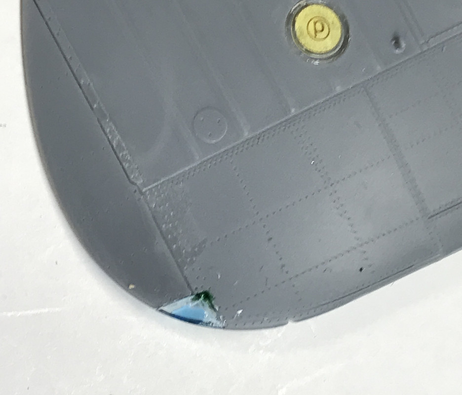

When setting up to take this picture, the broken wing spar broke again!! The plastic actuating rod was not up to the job and the piano wire pin let go. This time, I removed that pin and used some Albion Micro-Brass tubing along with a phosphor bronze pin and rebuilt the junction.
After cutting off the plastic strut, I had to drill the remaining lug with an 0.022" carbide bit held in my fingers. I used and even finer drill to start the hole in the lug’s center.

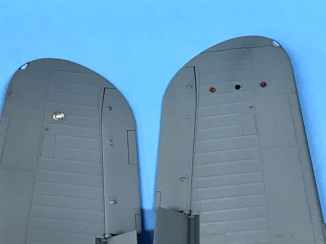

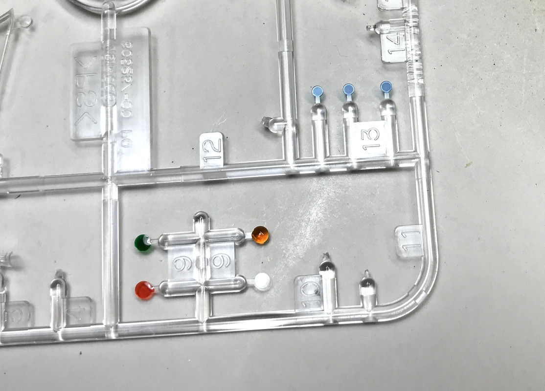

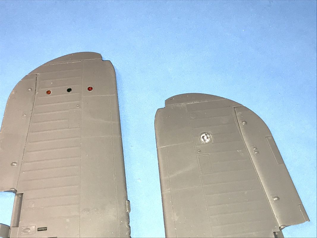

The last thing I did was to paint the clear lenses for all the running and landing lights. Letting them dry overnight will ensure they don’t get finger-printed. The kit includes a mask for the landing light lens. I’m going to glue the small ones in with Bondic with the color on the inside and then use MicroScale liquid mask before painting the outboard wings. They get painted and decaled off the model or else you’ll never be able to decal the folded side of the wing. This complicates finishing up the piping at the wing joint, but I’ll manage.

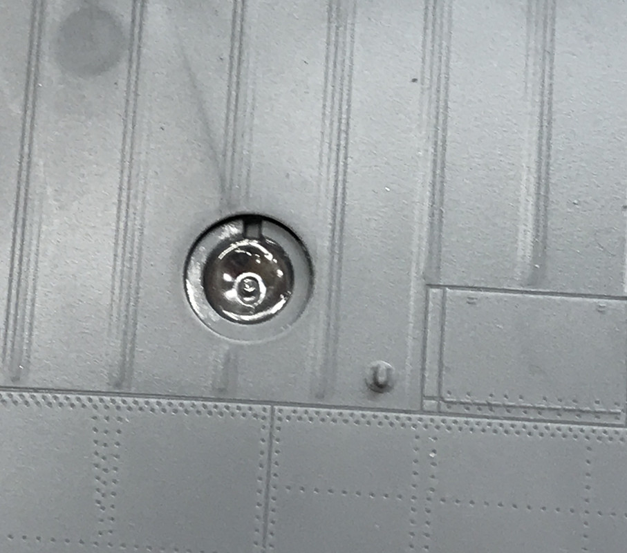

While this was drying I installed all the wing lights and coated their lenses with MicroScale Liquid Mask. The wing tip lights also got the Chrome Pen treatment and then the lenses were installed (like all the others) with Bondic.
I then carefully masked the transparent part of the lens so the frame with get airbrushed wing colors. Notice the round mask on the center of the landing light lens leaving the frame exposed to get painted. The chrome interior looks very real.

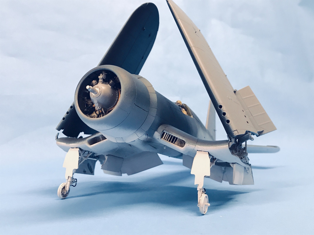

But… I couldn’t resist taking some more status pictures will all the flight surfaces in place.
I’m still considering whether to use the transparent cowl or the solid one, so the solid one needs to be in place during the painting. While it snaps in place, it wasn’t holding tight enough to block paint from encroaching into the engine compartment so I put some liquid mask on the tabs and am holding it together with a rubber band until in dries. If this doesn’t work, I’ll wrap the engine underneath with some wet tissue and then put on the cowl. The Corsair has one of the busiest wing fold areas of any naval fighter that I know of complicated by the flaps being split.

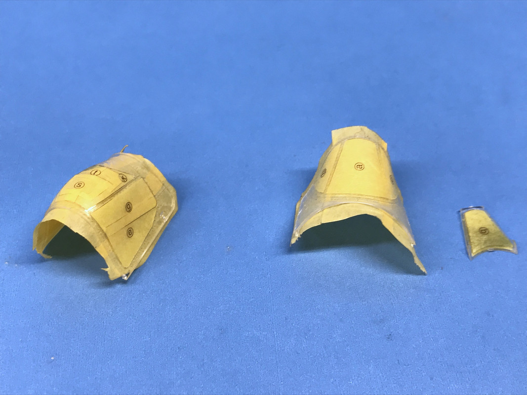

Tamiya provides nice masks, perfectly sized, but you have to cut them out. I used a fresh #11 blade and cut just enough depth to cut the mask and not the backing sheet so it was easier to separate the two. I actually enjoyed this. It was a nice delicate cutting op on something that wasn’t styrene. It’s the last thing I did today and I’ll airbrush them on Monday. They get black first (the inside color) and then Sea Blue. I am sure that this paint job will come out very well.

I glued the engine back on, and let it set up and then went to repair the fingerprints. Luckily, they’ll behind the big fuselage decals.
And then the 2nd disaster hit. Engine separated again, and this time, engine and plane hit the concrete!! Speed ring detached from the front of the engine, that pesky landing gear door came off for the 4th time, a faux wing hinge broke off, and the two bottom exhaust sets broke loose.
It took me a while to triage the mess. I needed to reattach the exhaust with brass pins and did the same with the broken wing hinge. The gear door went back where it came from without protest. I got the engine back on with Testor Tube Cement this time to give it more manipulation time, and got a bit on the cowl behind the cowl flaps. I was able to touch up spray the sea blue to fix the glue smudge, and got it all back togeher. Whew!!
Alls well that ends well. It could have been much, much worse. The landing gear didn’t get hurt. Those delicate wing fold regions were unscathed except for that fake hinge. Nothing in the cockpit was harmed, and nothing on the engine itself, even though it bounced around on a concrete floor. So I’m relieved.
I also got that all important P&W decal on the engine gear case.
I did get most of the stenciling on the wings’ bottom, and the fuse with have a chance to dry completely before decaling it. So it was a productive and scary Saturday.
Outstanding work and rescue!
Usually when something like that happens to me the resulting casualty is unrecoverable and has to be consigned to the recycling bin!
I personally would have invested in some insignia masks and painted them on rather than mess with decals and I do think Maketar Masks have some mask sets just for this…
and indeed they do
https://shop.maketar.com/?product=132-vought-f4u-1a-corsair-for-tamiya-kit
They also do the 1D and birdcage! I would choose the Kabuki tape option as that stuff doesn’t suffer shrinkage as vinyl does and would save you lots of time messing about with gloss varnish, decal mediums, matt varnish etc.
