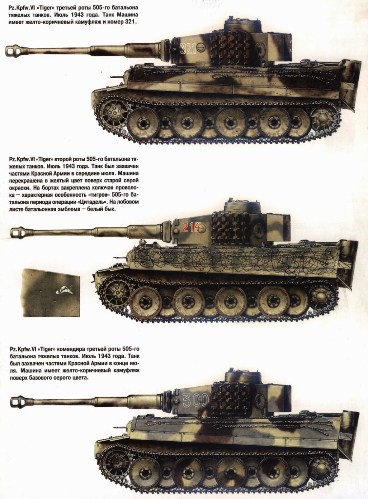

Is this the source material from which the image in question was found?
If so, it’s caption is incorrect. With a tactical number of “300”, it can’t possibly be from the second company, as the first digit is the company number! Rookie mistake on the manufacturer.
Tiger 300, (Oberleutnant Barkhausen, commander of the 3rd company), sPz.Abt. 505, is a well-photographed vehicle and was in fact recovered by the Soviets after being disabled on July 17 near Werch-Tagino. Note the damaged muzzle brake and the hole in the middle of the barrel!
It indeed appears to be 3-toned, look in particular at the gun barrel near the mantlet. There is a very dark, thin band of color separating the two other colors. Other photos appear to show the wheels to be in 3 tones as well.
https://www.worldwarphotos.info/gallery/germany/tanks-2-3/tiger-tank/tiger-i-tank-44/
Tigers in Combat, Vol 1, states that the 3rd company, not arriving at the battle until July 8th, was “still in tropical markings” [Tropen 1 with leftover dunkelgrau as a third color?]. FWTW…
Too high of contrast to be Tropen 1, IMHO. Look at modern images of the Bovington Tiger 131 paint, the difference in tone between RAL 8000 and RAL 7008 are very slight and hard to discern from monotone in B/W images.
This is not the situation with Tiger 300. If we go with Tropen 2 colors, this would explain the yellow as being RAL 8020 and the light grey as being RAL 7027. But what is the third color? Is it dark green or is it dark brown?

The RAL 8020 appears to be too dark for the yellow of Tiger 300 and still the contrast isn’t very noticeable.
Another view;
Here is another artwork showing the same interpretation, anyone want to translate the Russian?
Further discussion;
