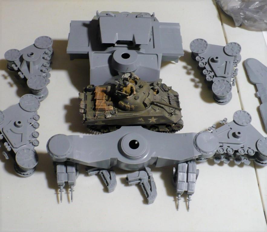

This is the 1/32 Hunter Killer tank from the Terminator 2 movie. As the “real” thing is described as 3 stories tall then even in 1/32 it is MASSIVE.

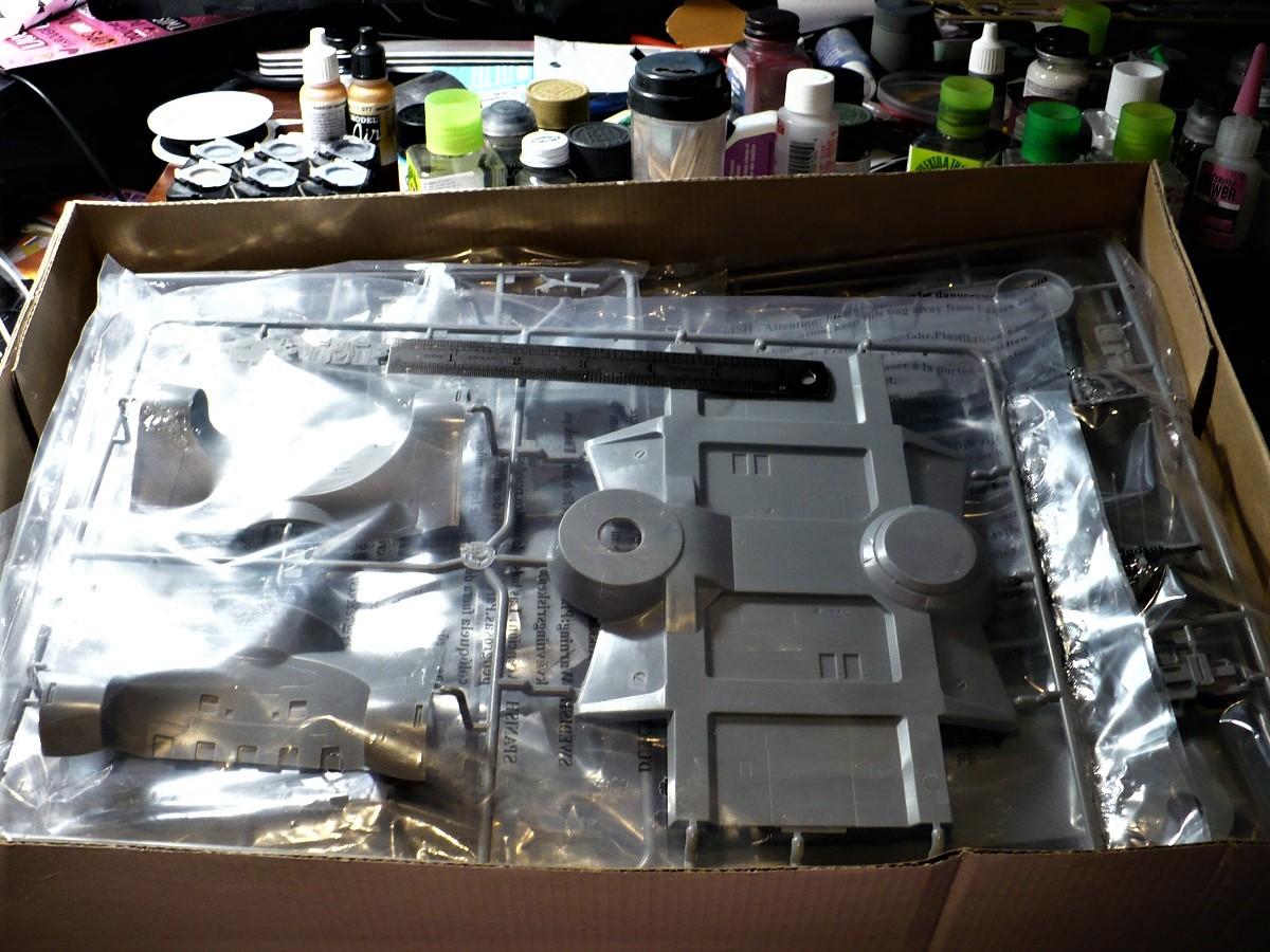

For anybody not familiar with Pegasus Hobbies kits the first thing that needs to be mentioned is that they are not styrene. The plastic they use is a heavy ABS. This means that some glues just won’t work and they recommend Tamiya Extra Thin or Modelmaster liquid only. Of course you can also use super glues. I use the Tamiya and it works great.

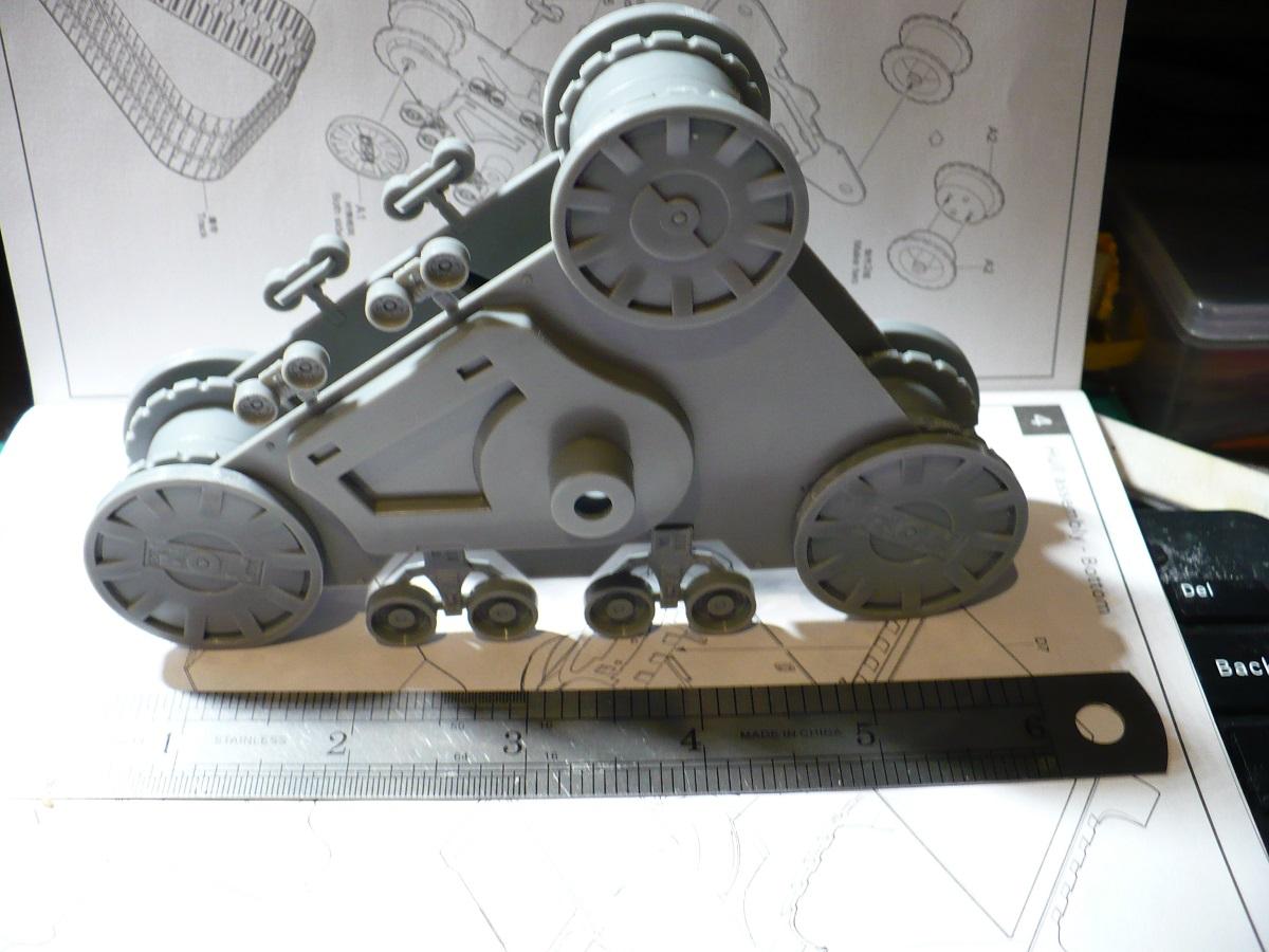

Of course this subject is modeled after a movie prop and some of the parts seem a bit simplistic when you first look at the. For example the return wheels for the tracks have no sort of suspension to them but are simply little wheels on a stick. The wheels themselves have nice detail but that is about it. This of course is fie with me since once the tracks and side panels are on you won’t notice anyway but anybody that really like to go to town could easily do more with these.

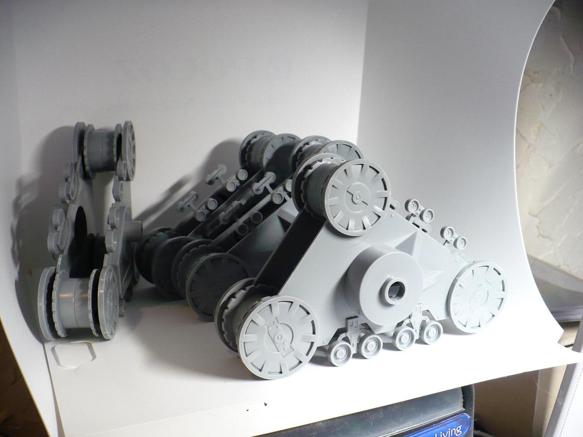

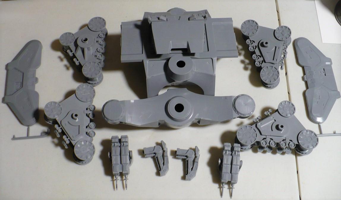

The track assemblies are huge of course but they fly together since there actually very few pieces.
The pieces there are you get to do 4 times

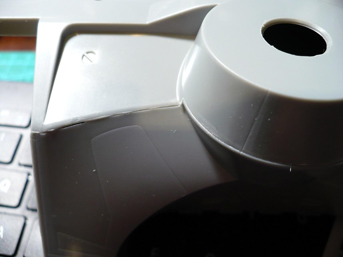

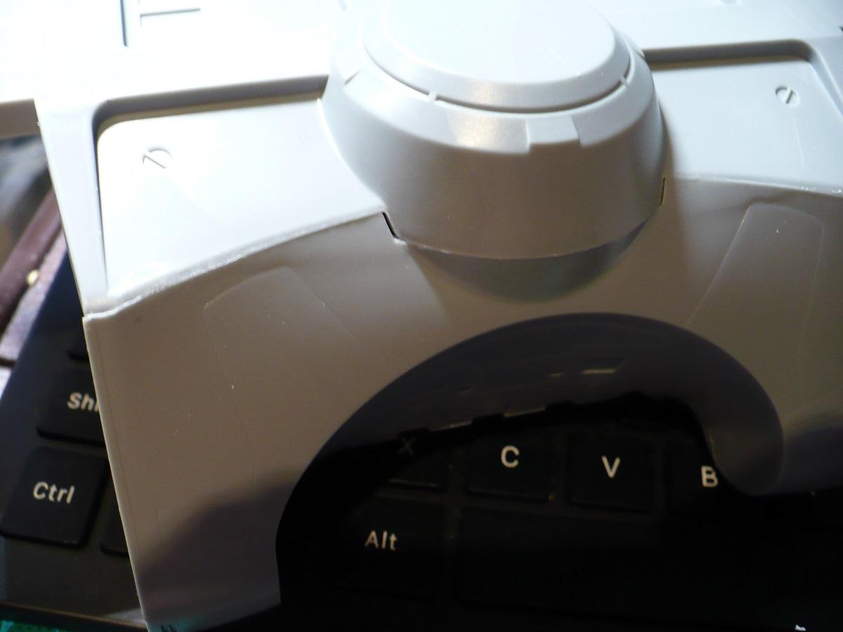

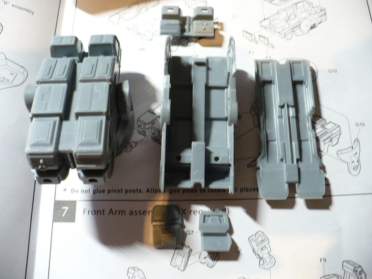

Pegasus uses a lot of slots and bevels in their design instead of locating pins. This does a good job of hiding most seams and is very strong but some of the bigger sections don’t fit perfectly so there will be some filling and sanding. I understand that this can be hit and miss with the molds and was a lesser issue with the first release than this one (this is the 2021 rerelease)
The smaller assemblies fit really nice though
All sub assemblies done just working on seams
And for those that don’t know how big these things are here we have a 1/35 Sherman lost in the middle.

Step1:
Buy glue.
That’s a lot of Tamiya Extra-Thin cement. What paint are you planning on using on the exterior?

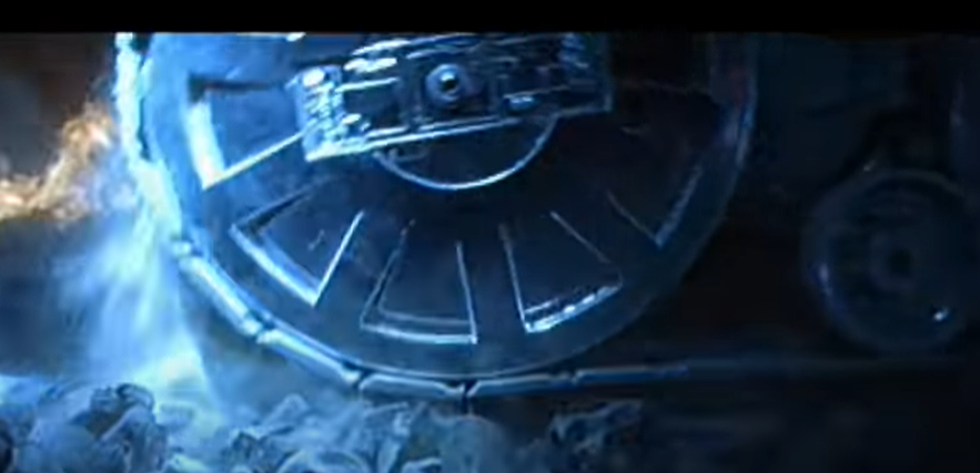

Not that you get a really good look in normal lighting but in the first movie they appear to be just sort of a low gloss steel color.
But by T2 it appears that Skynet found a good detailing shop and they are bright and shiny almost chrome like.
They don’t show up in the later movies but all the equipment that does runs between the two finishes so I don’t think there is a “right” or “wrong” answer really

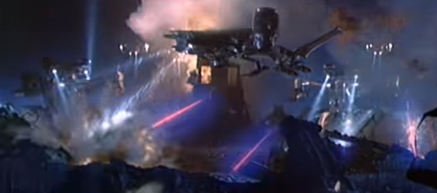

Somehow I remember it being chrome, I guess I remember the second film better than the first. And the lighting conditions could really alter what colour the thing appeared as.
I always remembered it being chrome as well. Probably the same miniatures were used for both movies but they had a lot more cash for T2 so the lighting and effects were better and you could actually see the shine.

I’m not sure if I am remembering correctly, but I thought I had read somewhere that for T1, the HK tank was painted, but for T2 it was vac plated due to the much increased budget.
Wouldn’t be surprised. I watched both movie openings several times for details and determined that T2 is certainly shinier. Could be lighting though. The good news is that you see small parts, at a distance or so briefly of each that I can detail pretty much however I want and it will be “right”.

In the close-up shots where the soldiers are trying to place a mine in the HK tank’s path, the tracks appear to be a darker metal color - weathered steel perhaps.
Yep.
