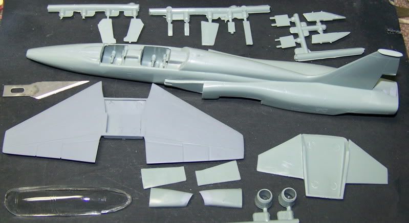

The parts. the intakes have been reshaped, the slats filled in and LEXs removed.

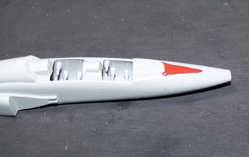

The triangular fairing in front of the canopy under construction. It still needs to be a little larger and then blended into the rest of the nose.

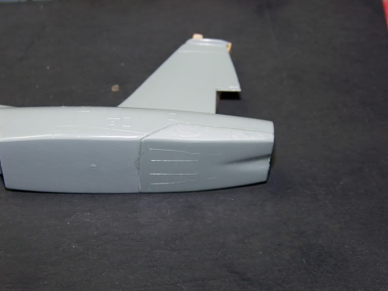

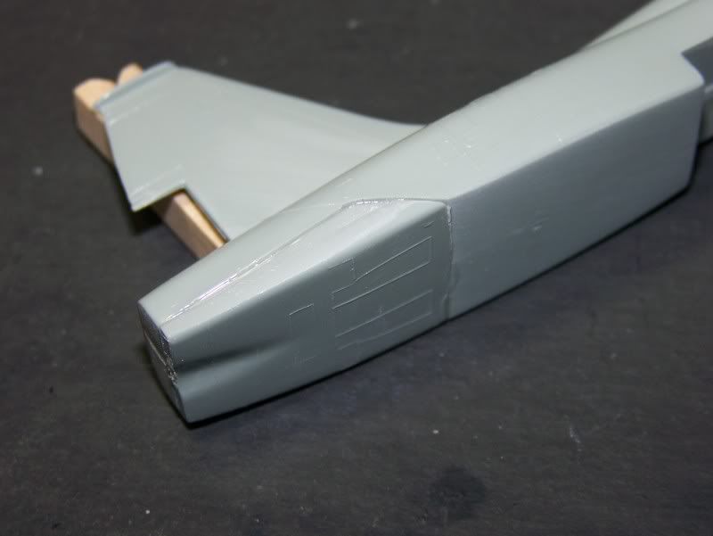

The lower, aft section of the fuselage was a very poor fit. I removed the molded on horizontal stabs and will fill in the gap at the seam.
