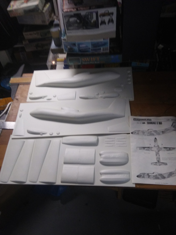

Cut out the fuselage halves and cut out the portholes and hatches.
Well you sure know a challenge when you see one. Various online posts say Archer carried the Sutcliffe line for a bit.

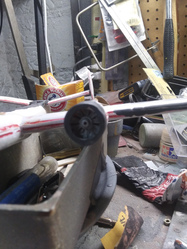

Three-bladed props on 1 and 4, four-bladed props on 2 and 3.

Yes but I like the fact that the plastic is on the heavy side…much easier to work with and the parts are very straight!

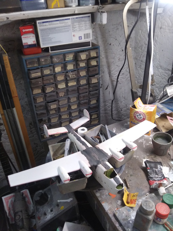

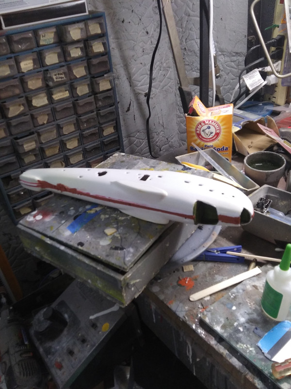

I decided to try something different and traced around one of the fuselage halves and cut it out …then I glued it on.Joined the halves together and it is Rock solid. There is a raised spine that I will grind down with a sanding drum in my Dremel.I will leave the raised section at the tail joint for a secure mechanical connection.

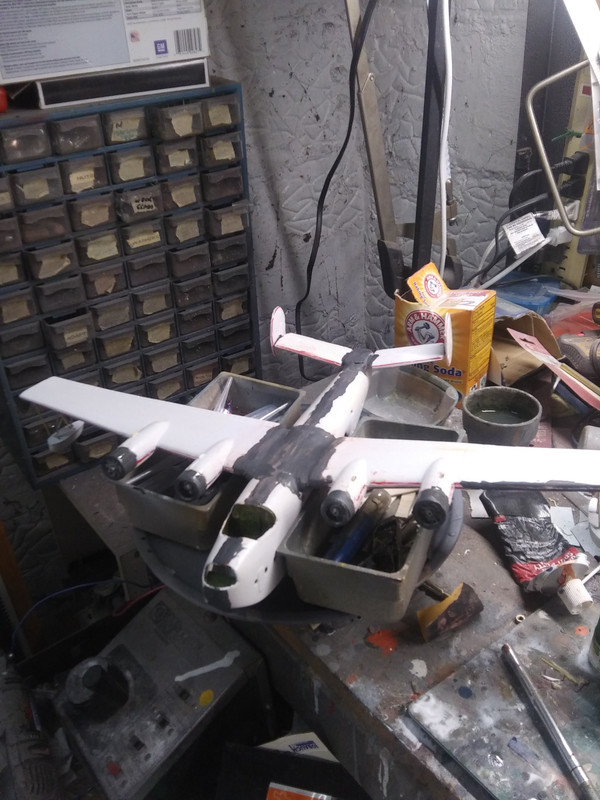

Mounted up the wings with a brass tube through the fuselage .set the dihederal with a couple of stain cans.

Unfortunately,the cowlings were missing from the kit so I had to make them.I wrapped a piece of .20 styrene around a 13 mm socket held in place with a rubber band.I carefully applied cement to hold it together.For the front I turned them by chucking plastic plates into my Dremel and holding them against a file at medium speed until the were round and of suitable diameter.Then I glued the parts together and installed them after the engines were installed.Took awhile but it worked.
