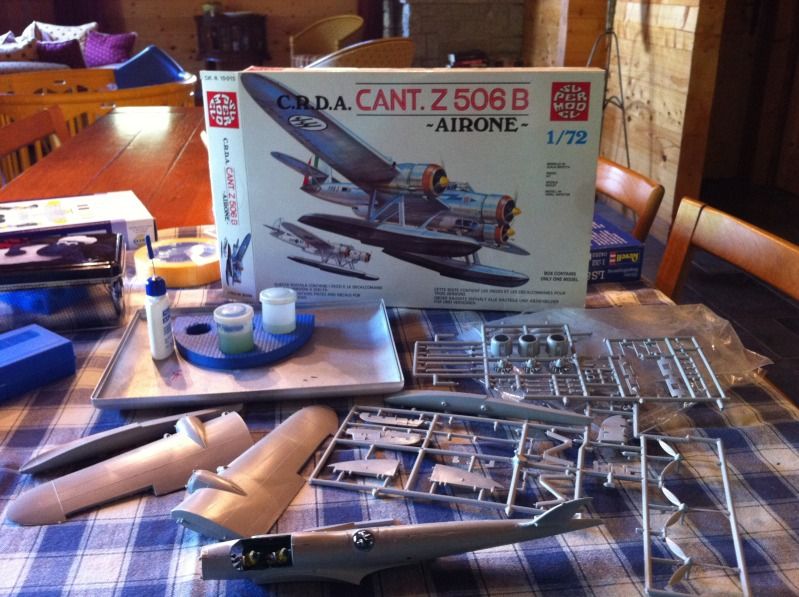

Next on the bench is this Supermodel 1/48 CANT Z-506B. I got it as a gift from a couple of friends. Not really my cup of tea but if I screw up I will not loose any tears about it.

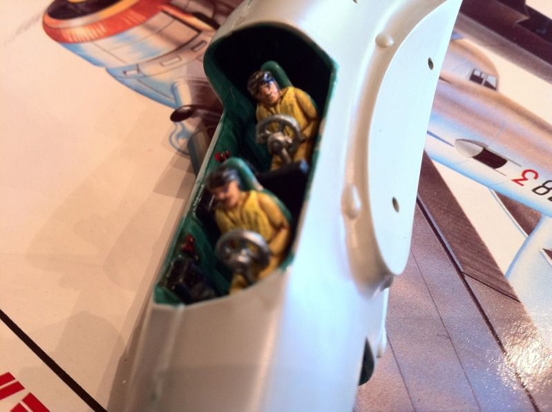

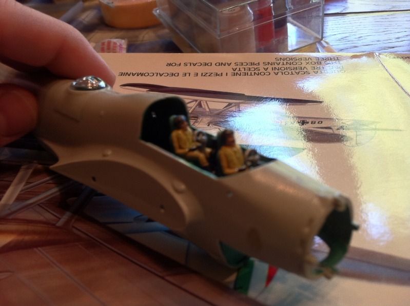

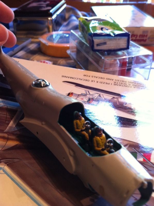

Since the cockpit is low on detail I chose to use the pilot models. They where identical so I modified the head of one and gave the other one a moustache, just to break the monotomy.

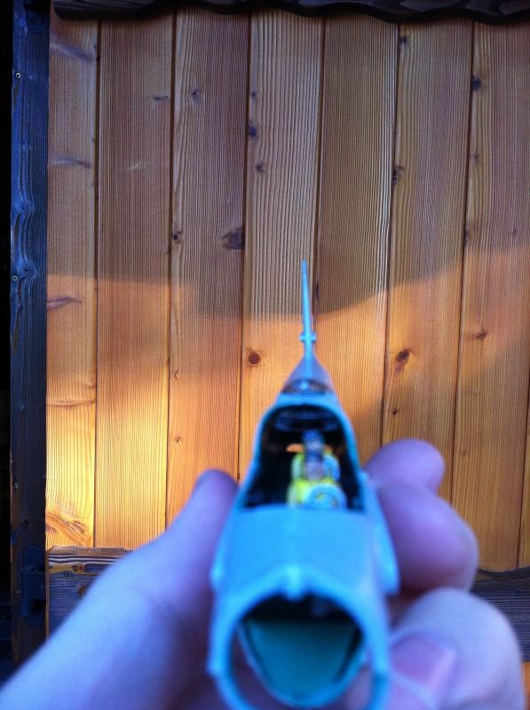

It turnes out that the fuselage was warped. I will have to fix this with some hot water.
Overall it is a mediocre kit, really showing its age. Details a sparse, soft and/or heavy handed. The transparent pieces are not very clear, the molds really should have been polished. And the fit is not so good. The whole fuselage seam is going to need putty.

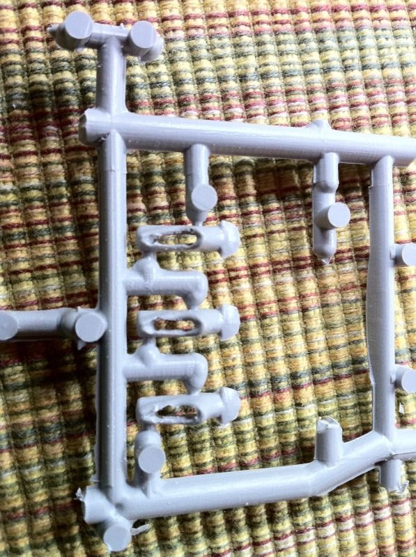

Because of the cluncky guns I am going to buld this as an unarmed sea rescue version, all white with german markings.

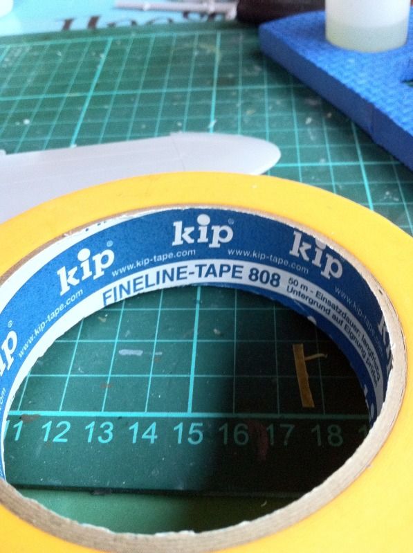

Here are some more progress pics. I saw several questions regarding canopy masking this week, so here is how I do it: Kip (or Tamiya) tape cut into in thin strips, working from the outside to the inside:

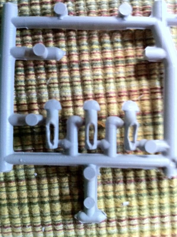

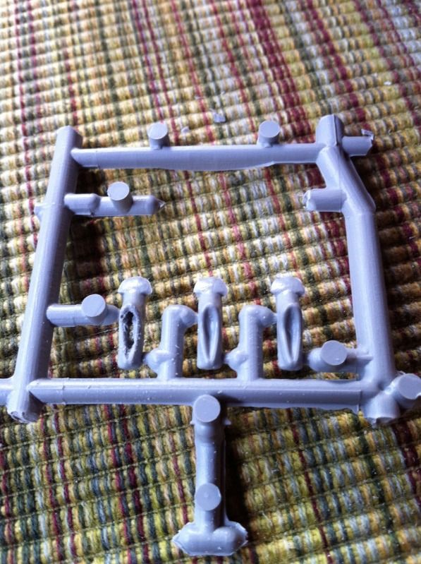

The exhaust where shallow so I drilled and thinned them out:
step 1: drilling
step 2: thinning
step 3: smoothing/sanding

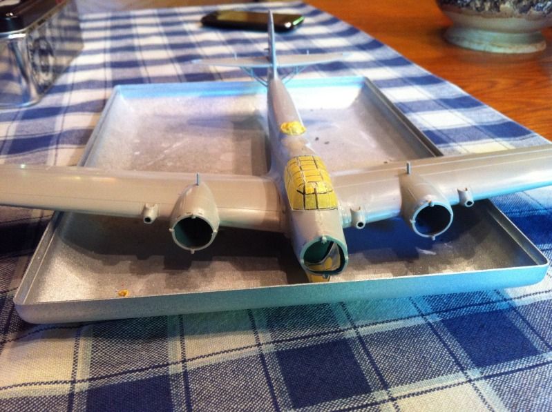

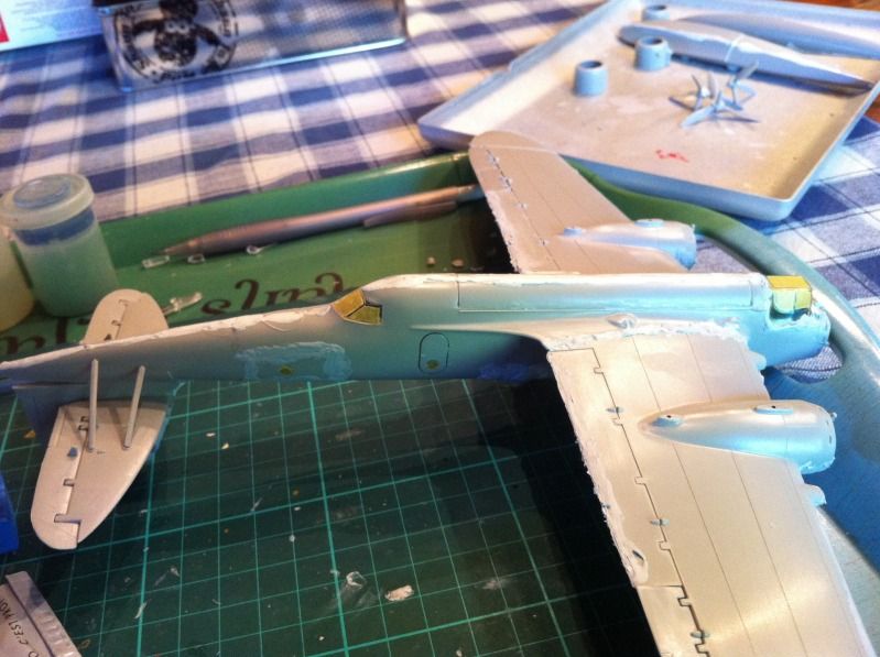

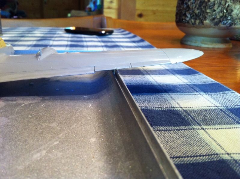

Current state: the wins and canopy are on:

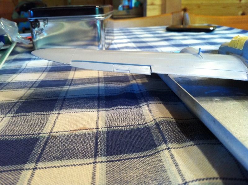

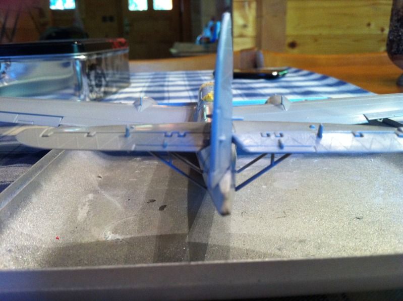

The add a bit more interest the control surfaces are not straight. This is one advantage of older kits, moveable control surfaces.
And a pic of the belly. For a split second I though about making it into a “what if” canard/pusher aircraft, it would look prettier then the real CANT Z 506…
All the grey stuff is putty, it is going to need some.
