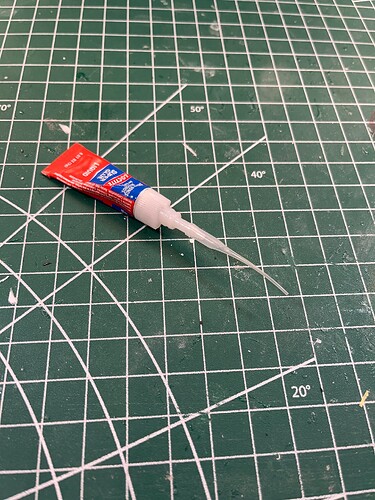

I’ve been using these for the longest time. There are other tips out there just like this one, where you can get even more precise in the application of your superglue. Hope this helps.

I watched a YouTube video (5+ years ago) where a guy melts and stretches plastic cotton-buds (Q-tips) to make glue tips It took some practice, but I got it to work really well.
Since then I’ve switched from BSI superglue to Starbond and the bottles come with micro tips.
Sadly the DIY q-tips ones are too small, so when I run out, I have to buy the ZAP ones (or similar). Buying those those just sticks in my cheapskate craw. :laughing:
