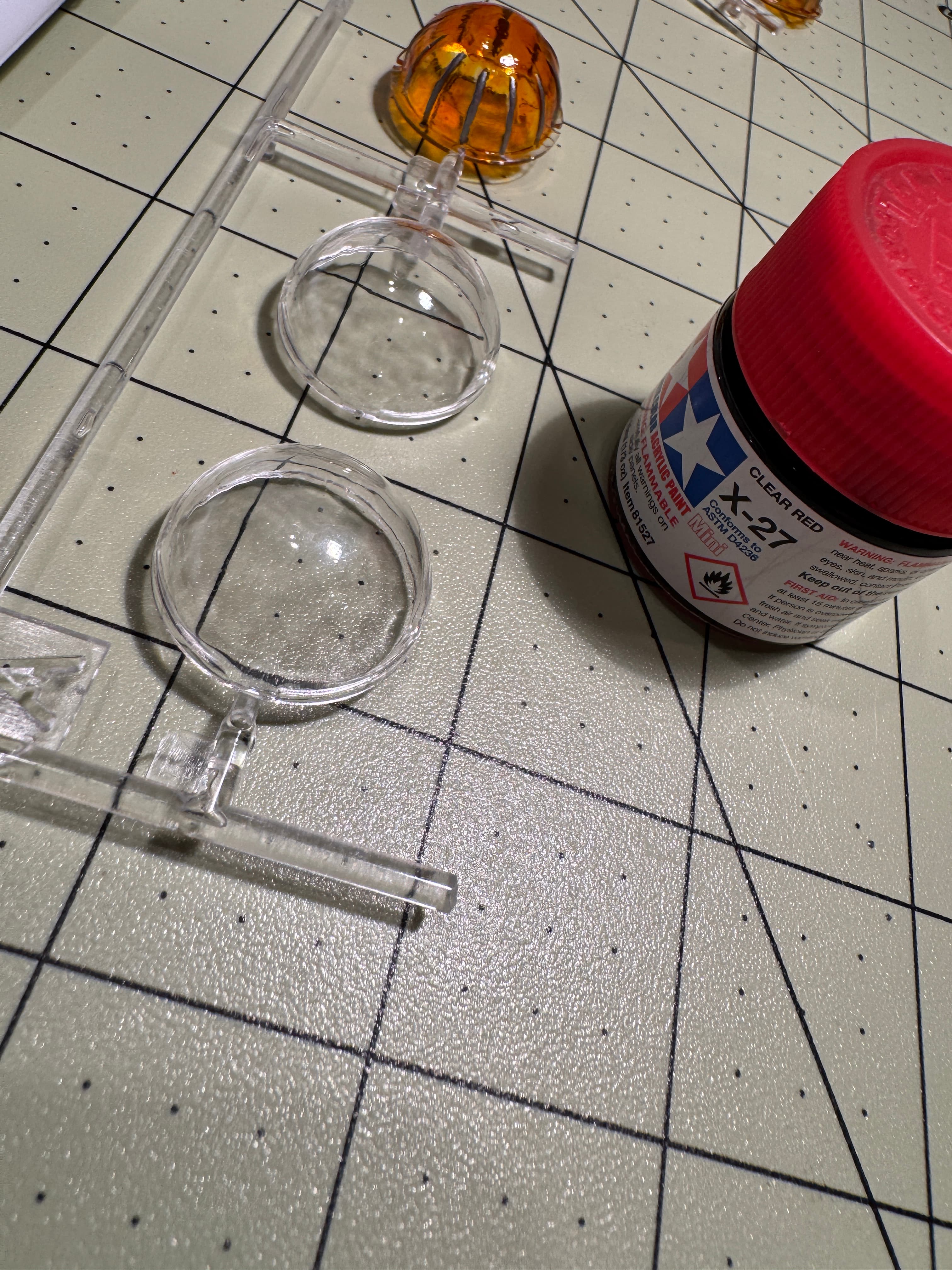

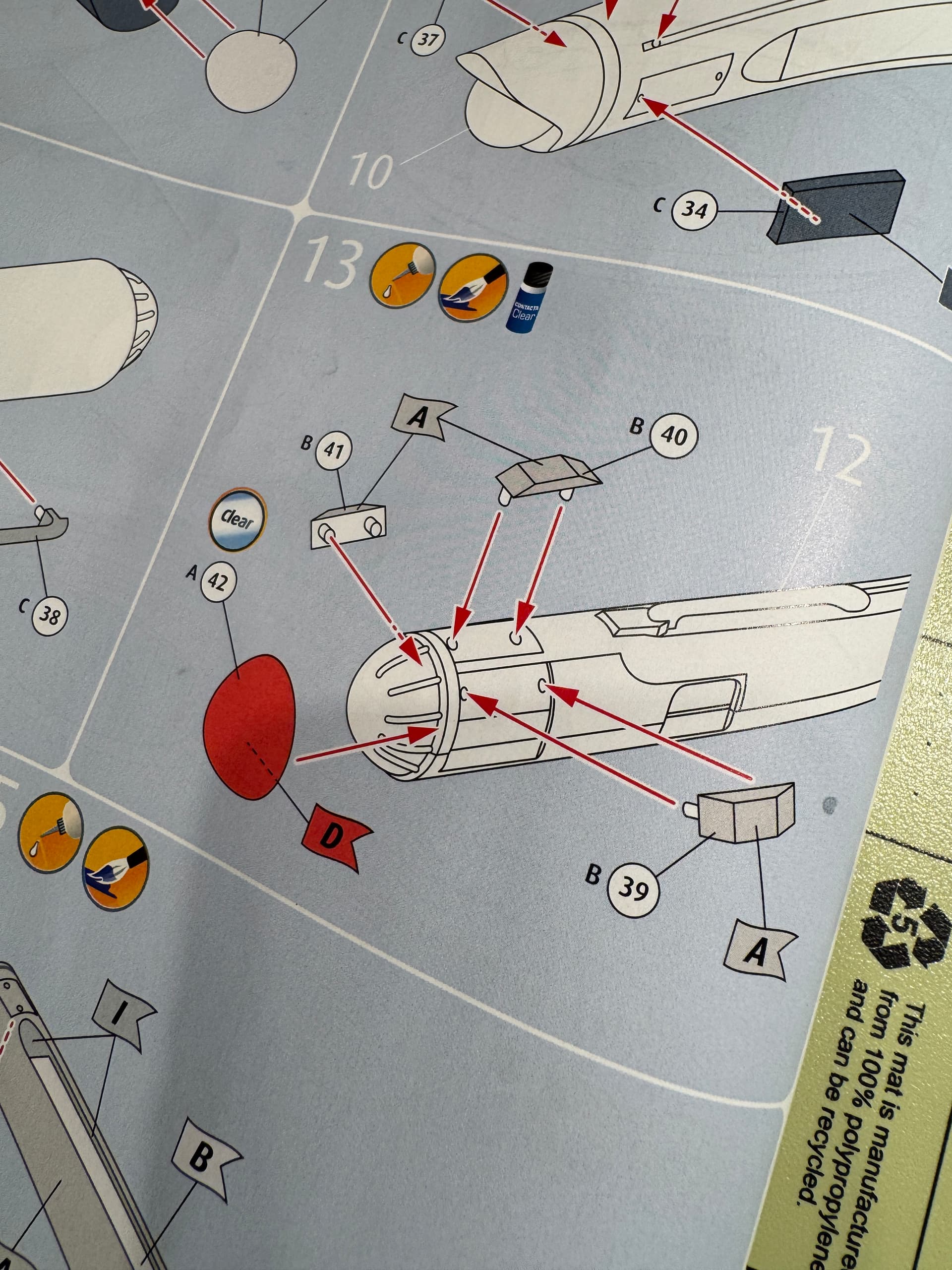

So I’ve never painted much larger than tiny headlights with clear acrylics and now have these larger pieces to paint. What are some techniques to get a good finish if doing by hand brushing? It’s the part labeled ‘ D’.

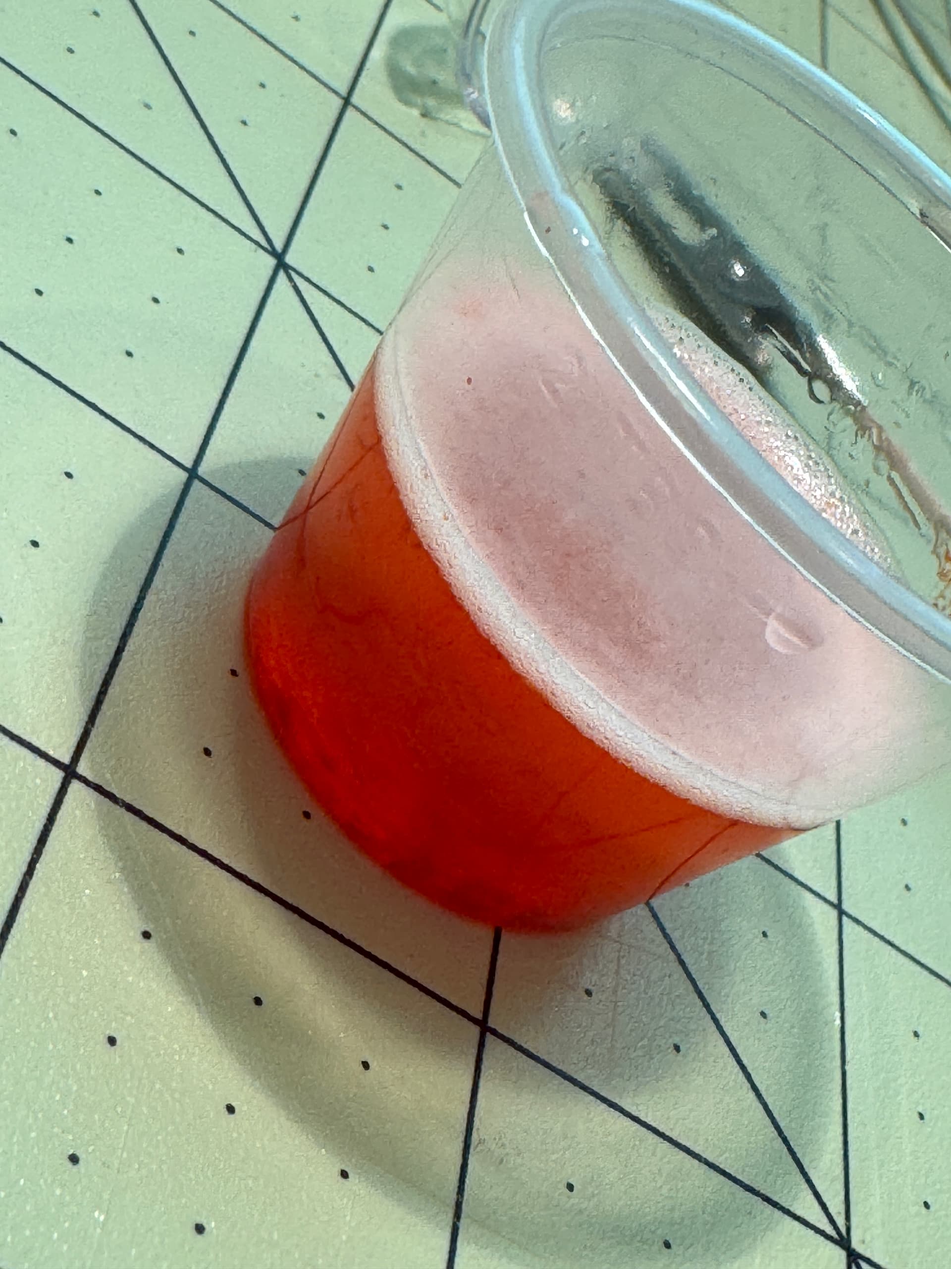

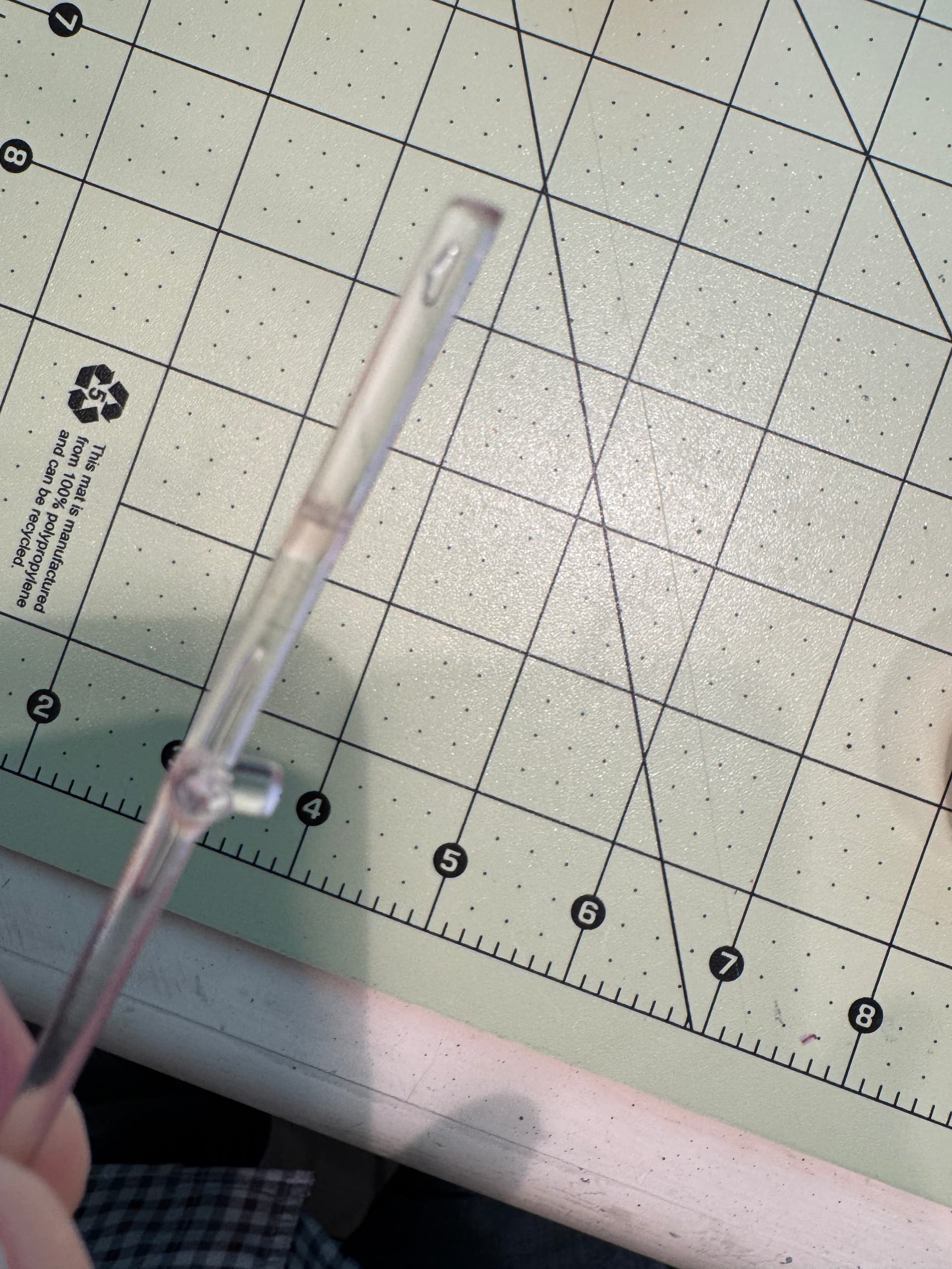

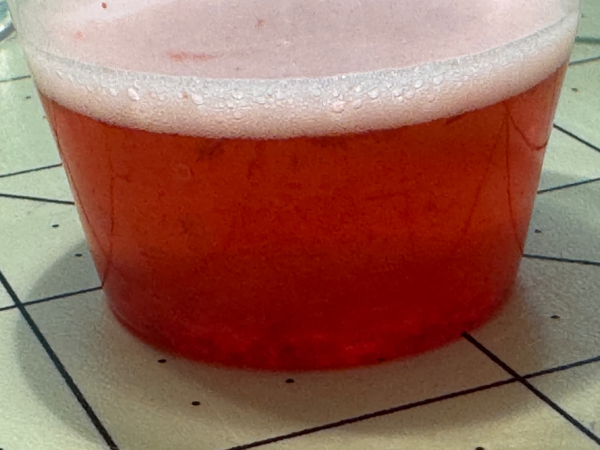

had a little down time to try dipping today - tamiya clear red mixed with pledge floor care. Im not sure the pledge & red clear are compatible - when I added some red to the pledge cup, the paint congealed somewhat. I mixed by hand at first and the result was a red coloring with streaky blobs floating in the cup. I then mixed with a mixer and waited for the bubbled to settle. still some clumps in the bottom and floating. I tested own a clear piece of sprue and I couldn’t see the red at all! I waited a bit and dipped a few more times and the red on the sprue was invisible! So plan B - whatever that is…

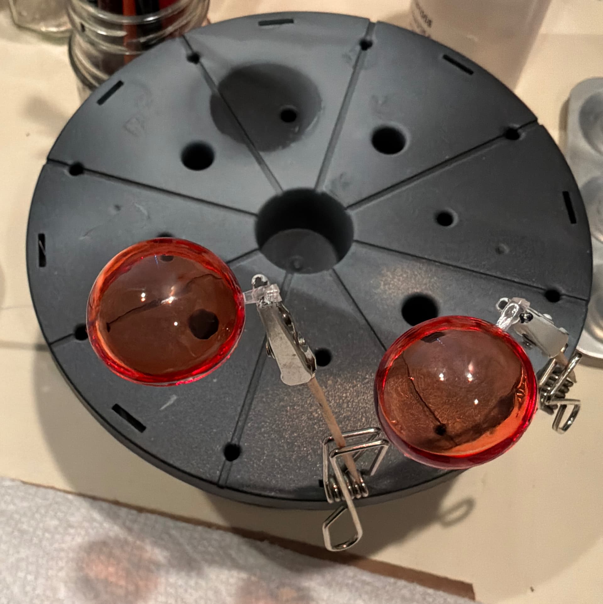

Done. Thinned a little and poured inside and drained out and left overnight, rim down on mat to settle. A little gooey around the rim at spots and a few bubbly areas in one dome. But ill have to work on this when i get back in town later this month. Now drying more this this:
I noticed the bubbling shortly after 1st swirl and tried to “remove” them by adding a tad more paint and swirling again hoping they would be grabbed and settle to the bottom rim - but no cigar ! We’ll see.
