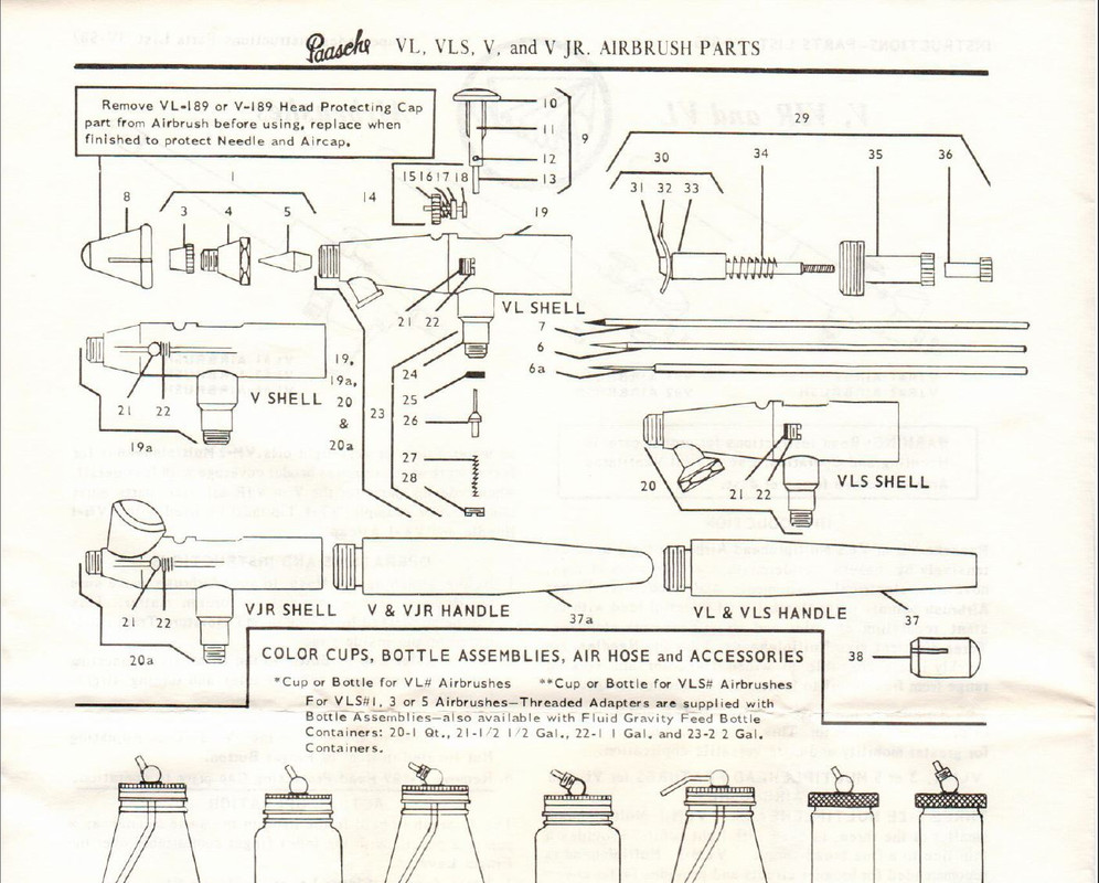

So looking for some answers here on something I found in my old Paasche airbrush. Replacing the air valve packing I found a spring on the top side or other side of the packing.
In the original parts breakdown it does not show this spring
https://i.postimg.cc/RZqHQh5Z/Paasche.jpg
So looking at number 23 the individual parts I have. From bottom to top; the nut, spring, Valve plunger and the air washer. But above the air washer is a smaller spring which is in my Paasche, but it is not listed at all.
I also have the updated version of the VL and it too does not show this spring.

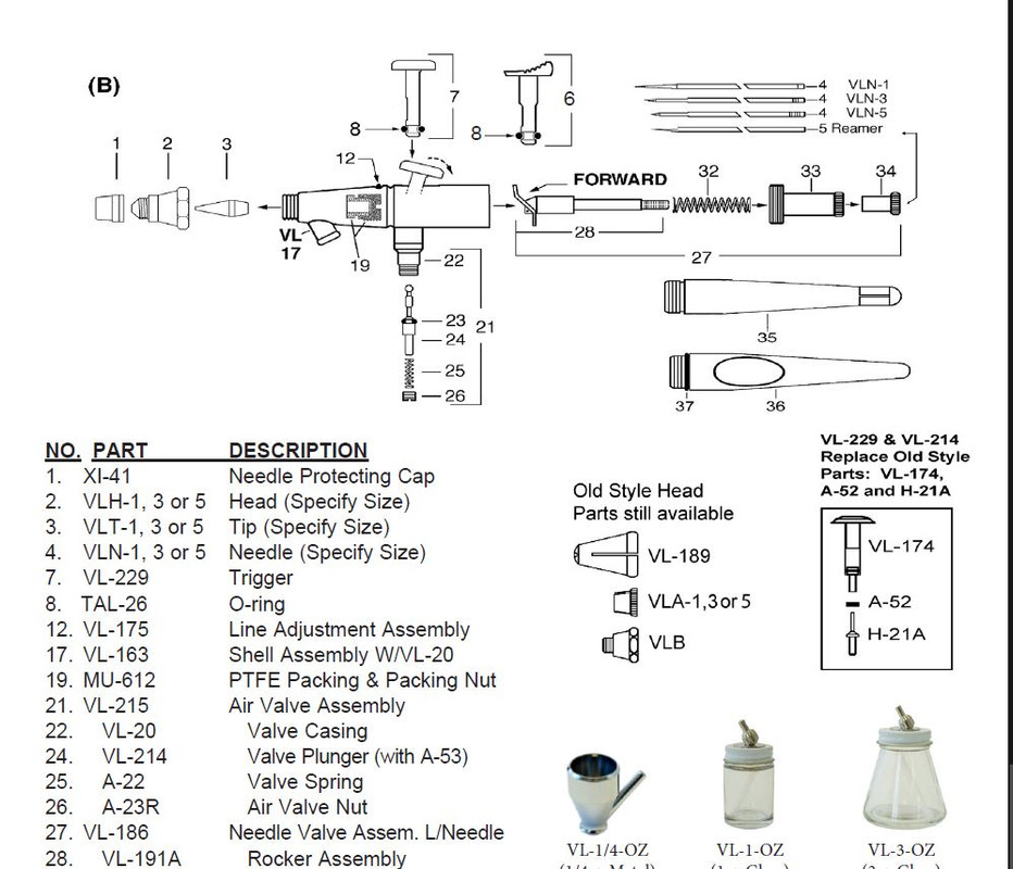

https://i.postimg.cc/Twyxt82m/Paasche1.jpg
On the right side in a boxed view, you can see the trigger, then the washer and the valve plunger. But no spring
Does anyone know why on my Paasche that a spring is on the trigger side? Maybe from the past, someone who owned this did not know that there was no spring and put one in anyways?

Someone was probably trying to overcome a sticky trigger return or something. I doubt any extra springs belong in there.
Those valves are inexpensive, if it sticks or has lateral movement/leaks etc., it may be best to just get a new valve. It is threaded so does remove, how easy I have no idea. I’d probably find a piece of rubber or neoprene tube that pushed on there, then take pliers to squeeze down on it and break it loose. Probably even a rubber band wrapped around the valve would cushion pliers but offer grip enough to get it broken loose.
thank you for the reply. I did remove the spring and it works fine. No stickiness for me. When I found this Paasche in my old desk it was in rough shape. Been buying parts like the packing, aircaps and more needles for it. Oil and a ultrasonic cleaner have been good to it.
I will try the rubber or neoprene. I can see yellow paint in the seem, what I do not know is how far it went in so just want to clean it up.
