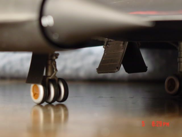

Here is a picture of the main gear on my 1/48 Blackbird I did a couple of years ago. I used Testors titanium for the sidewalls, and dark brown for the hubs. I think it matched some pictures from my references. Hope it helps, btw, which kit/scale are you building?[?]
Hope to see it when your done![;)]

By the way, your wheels look very good and you take nice pictures.
