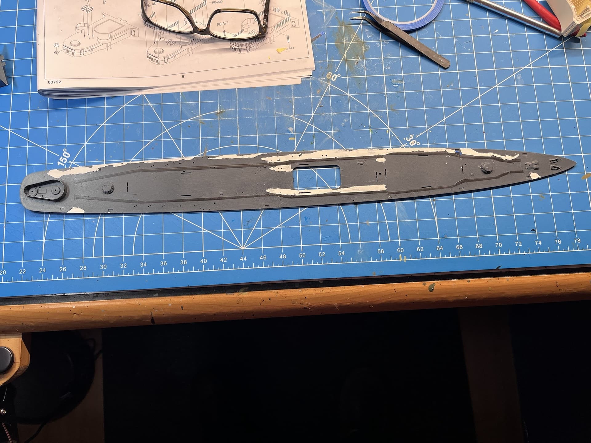

Well, this has been quite a journey. The first picture shows what happened after I removed the Squadron Colors paint down to the enamel primer. I sprayed on 3 light coats, waiting about 1/2 hour between the coats. I waited 24 hours and tried a tape test. Everything was fine. So I went ahead and masked for painting the walkways. This is the result after I removed the masking. Mostly good, but there were still a couple of areas to clean up.

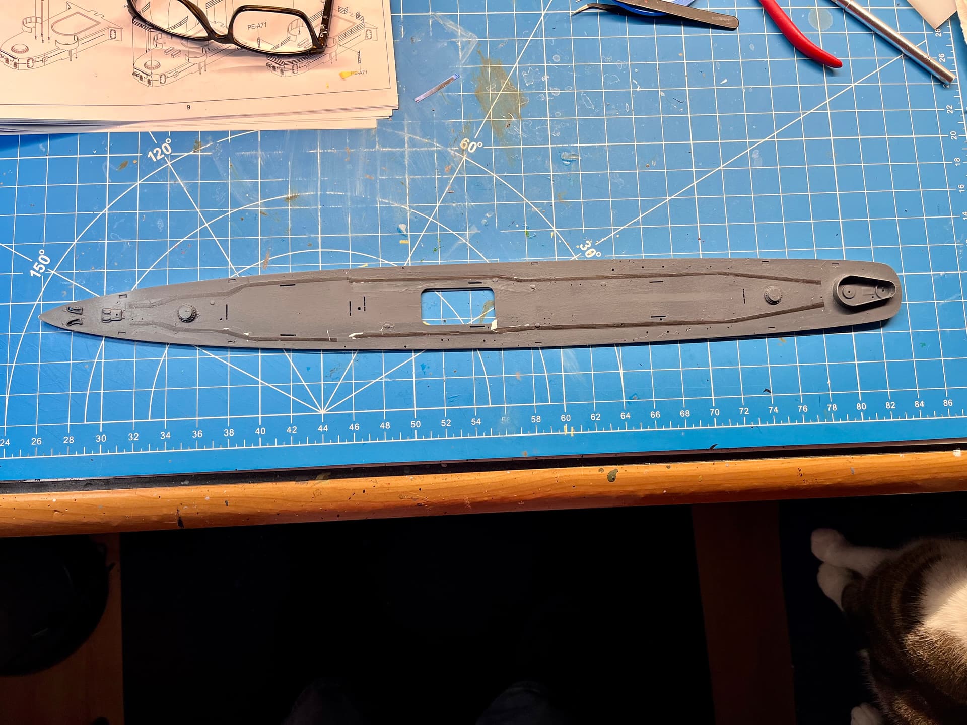

So I went ahead a masked a second time and touched up these areas. When I removed the masks, this is what I ended up with. It should be easy enough to fix with just some brush painting.
