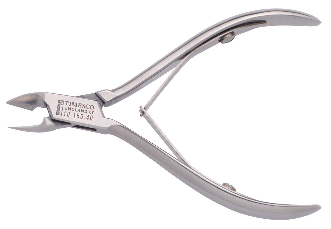

You can always go old-school and use what many modelers used, back in the day:
You can find that in the Health & Beauty section of your grocery store, or at the local drugstore.
