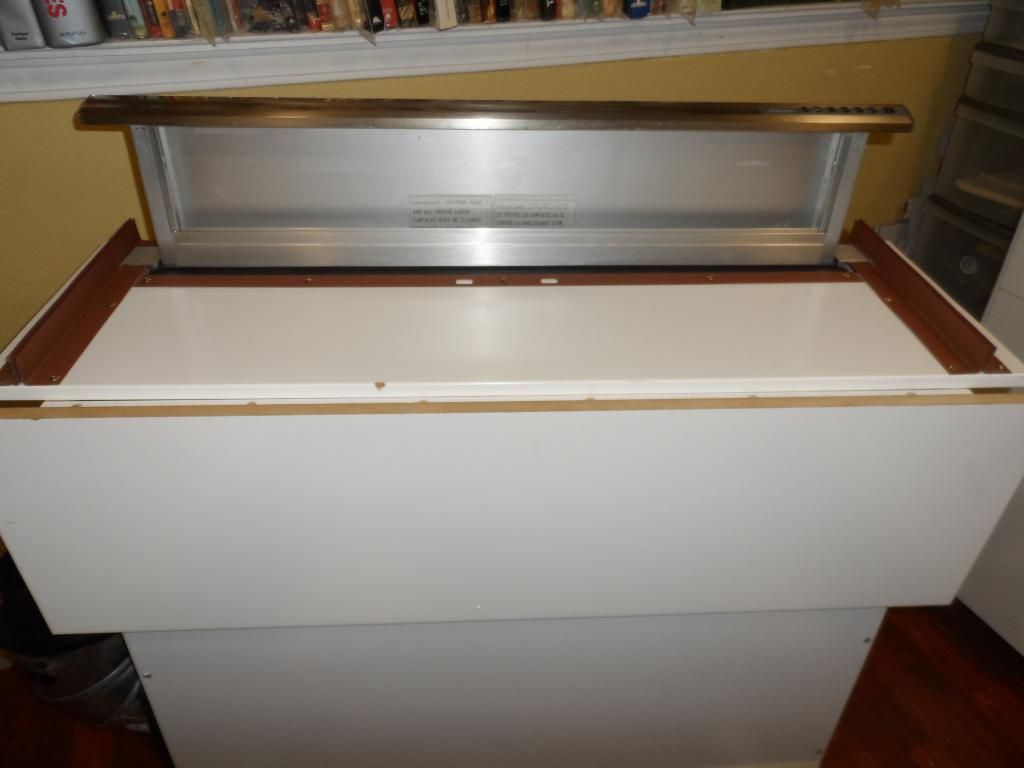

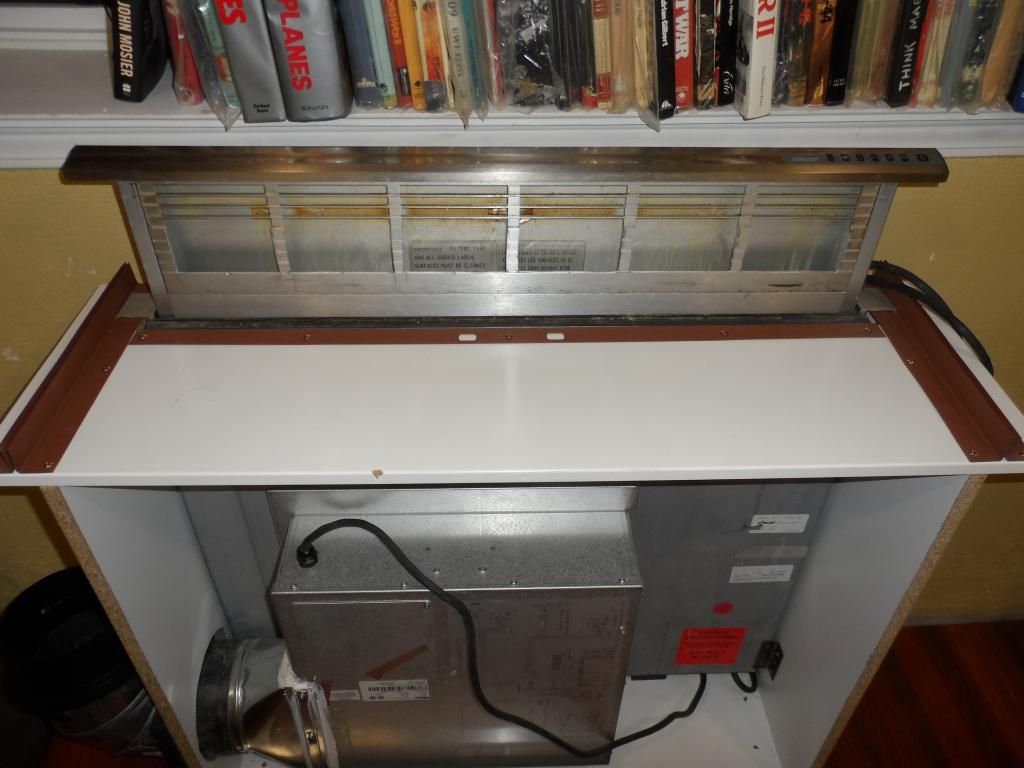

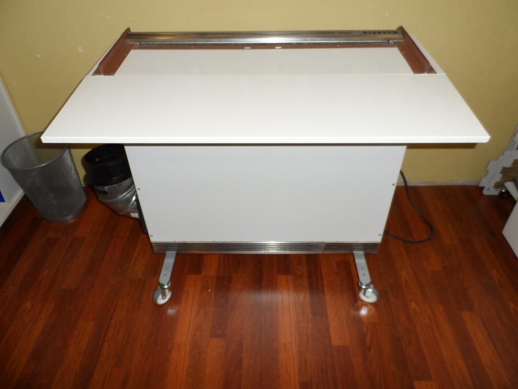

Def. go the custom route. Perhaps even consider building your booth using a down draft stove vent. With a push of a button it automatically rises from concealment, powers on the fan and can provide as much as 700 cfm of air movement. Some models will also have a multispeed switch. You could build yours into a custom rolling cabinet like I did, or with some careful planing build it into the work bench, so its hidden away until needed. With a little luck one can be had for as little as $20 on CL and second hand stores. Either way go custom you’ll get what you want and just how you want it.
Good luck and have fun with it.

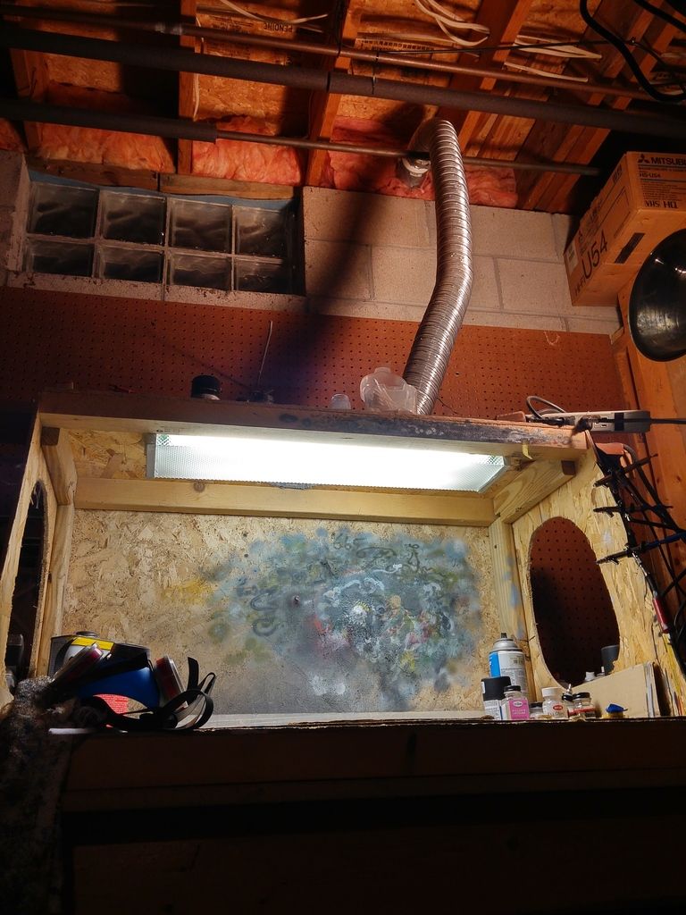

Building your own is the way to go!
I used lumber from a job site scrap pile…picked up a bathroom vent fan and small flourescent light (also have a clip on shop light to the side). The vent is enough for the typical airbrush sessions…not quite enough on the rare occasion that I break out a rattlecan though. Everything plugs into a power strip, so a flick of the switch turns on the fan and lights. Having only glass block for basement windows, I cut a hole through the wood, just above the block and stuck a dryer vent on the outside.
I made mine about 24" x 24" x 36"wide. This has been more than enough for most projects…there’s only been a couple that I wish the booth was a little bigger.

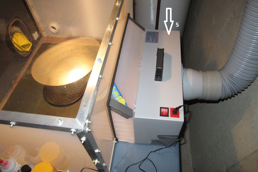

TJ-- I bought one and I am happy with it. There is one caveat to that though. I have modified mine a bunch.

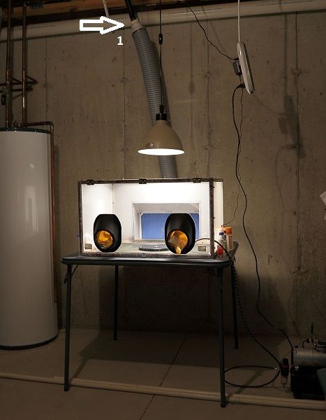

Years ago I lived in an apartment and I built this enclosure from scratch. I wanted something that not only minimized dust issues, but one that would reduce fumes into the apartment. It is pretty much a closed system. I vented the spray via a squirrel fan that was mounted to a board and that was then inserted into a window frame. Since then I have moved, and I had to redo things. The fan system that worked well for me years ago, didn’t work so well now. The ventilation hose has a much longer distance to travel and the fan was just not up to the job.
So… I decided to buy the unit that you are talking about, and I use it in conjunction with my existing booth. It had most everything that I needed to make this retrofit, and it works like a charm. I did have to buy a coupling noted by #1.
You can see below how I connected the housing (#5) to my booth. I cut a hole in the back of my booth and butted the two together.
If you plan to use the unit as is… you may find it limiting at times for what you can fit in there. As for the build quality, I think that it is pretty good, and I have no complaints.

PS: Don’t gauge the opening size of the unit by my photo. I butchered the heck out of mine to make it more compact.
