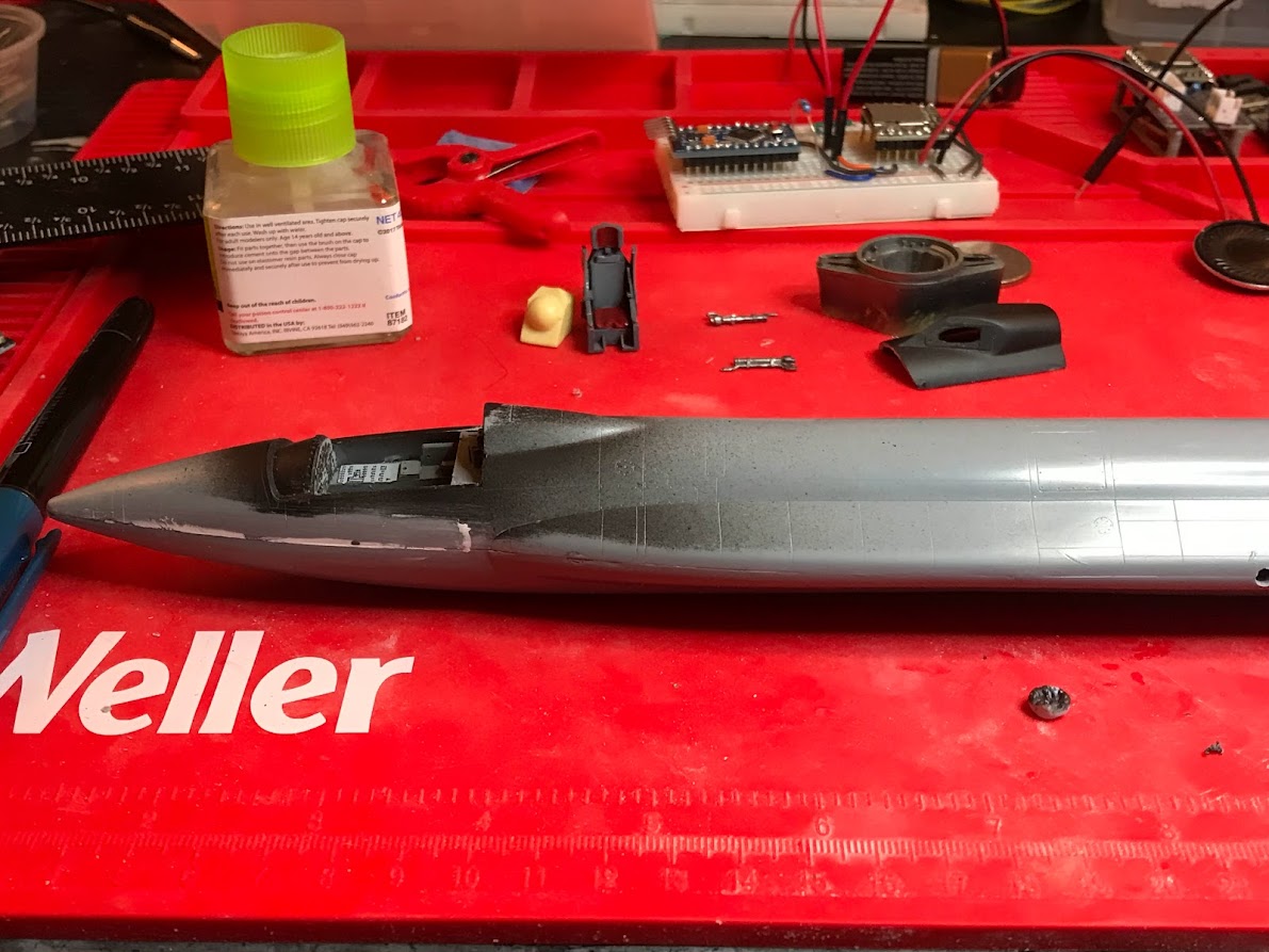

Priming

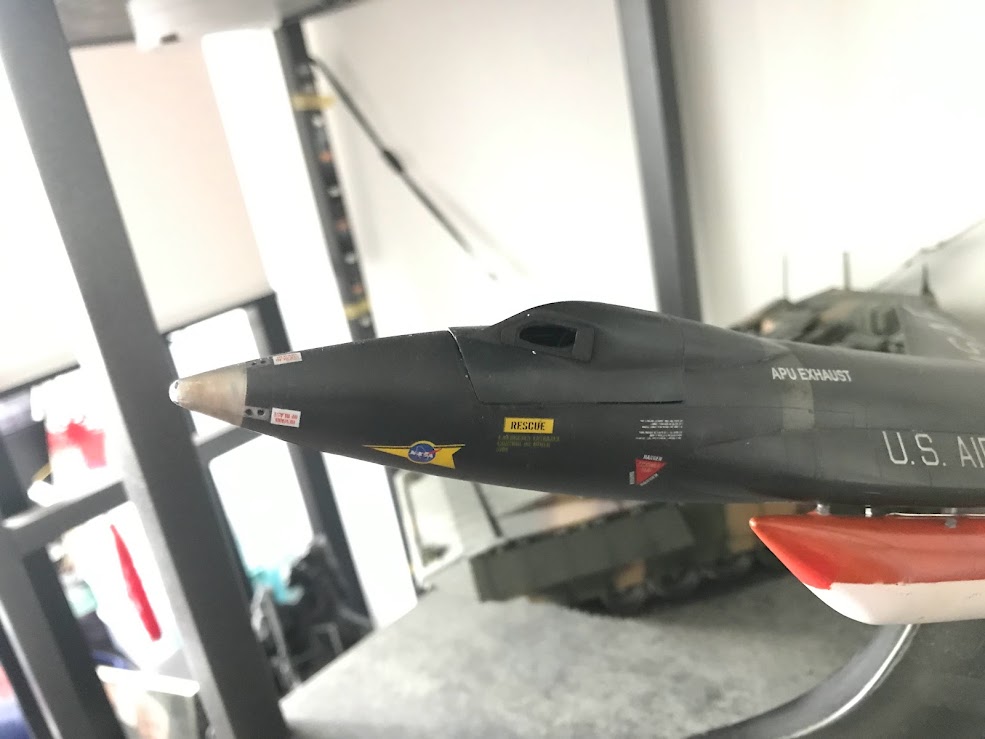

Trying to simulate the wear and tear on it. This is loosely based on some pics I took at Dayton’s Wright Patterson AFB.
Nose
Panels
hatches

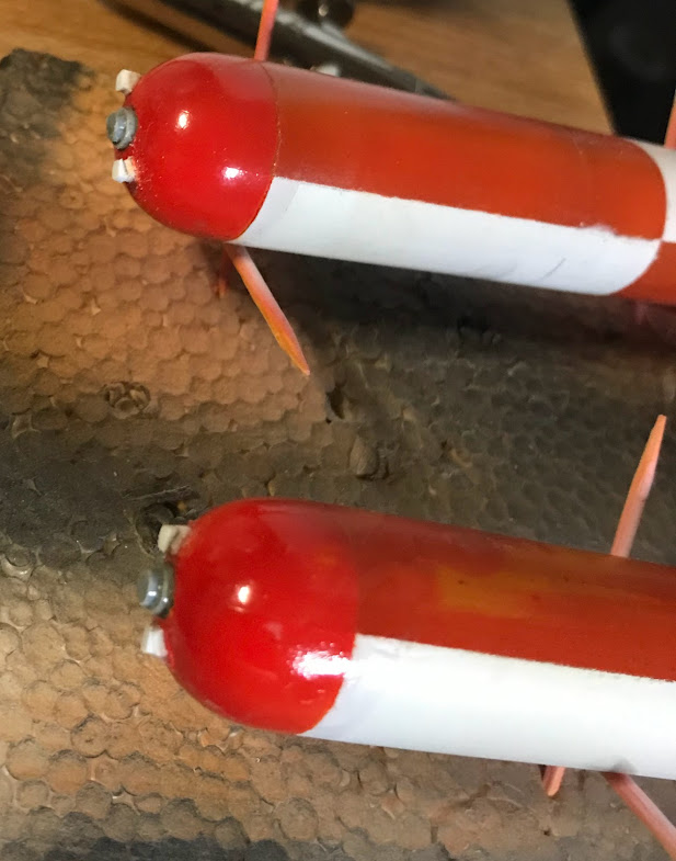

Detailing the external tanks

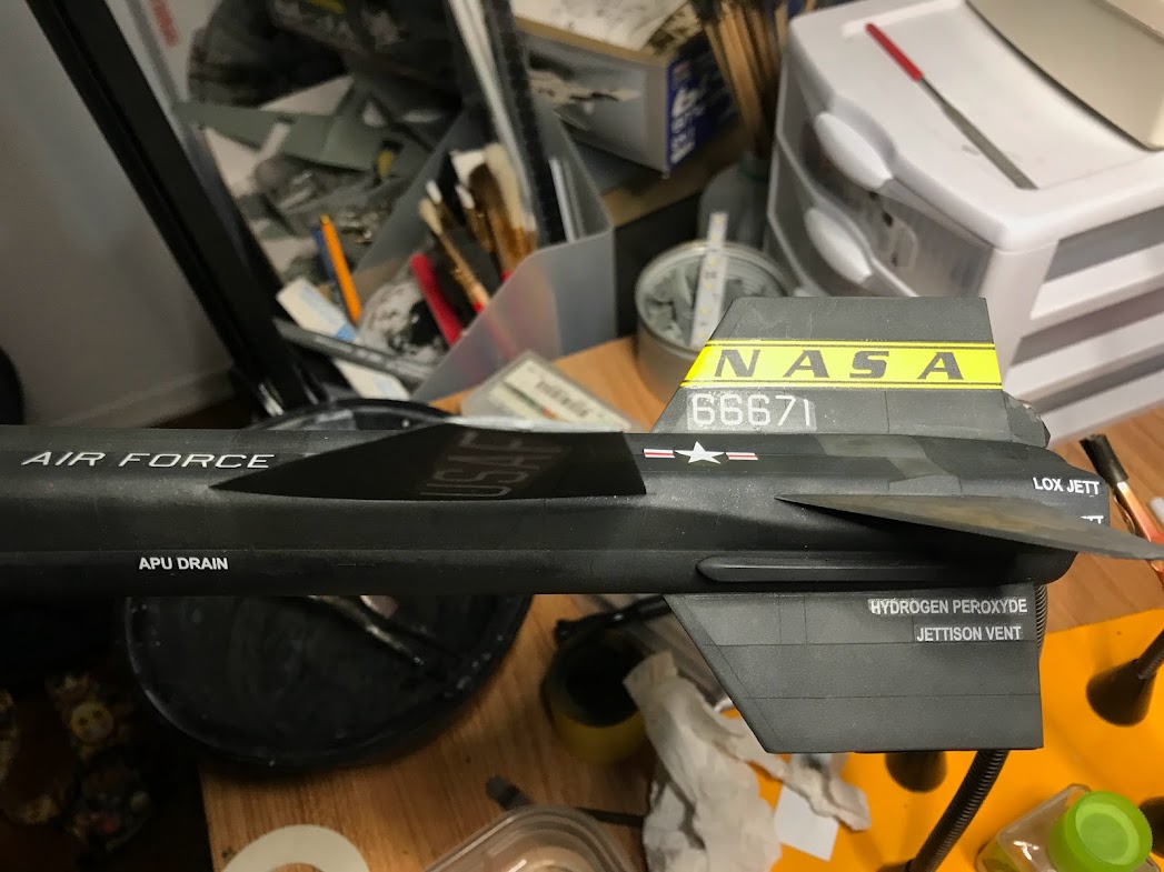

Decals
Clear coat
Damn decals were super delicate and easy to break
Panel lines
not sure how effective it was. the panel lines on the model are very faint.

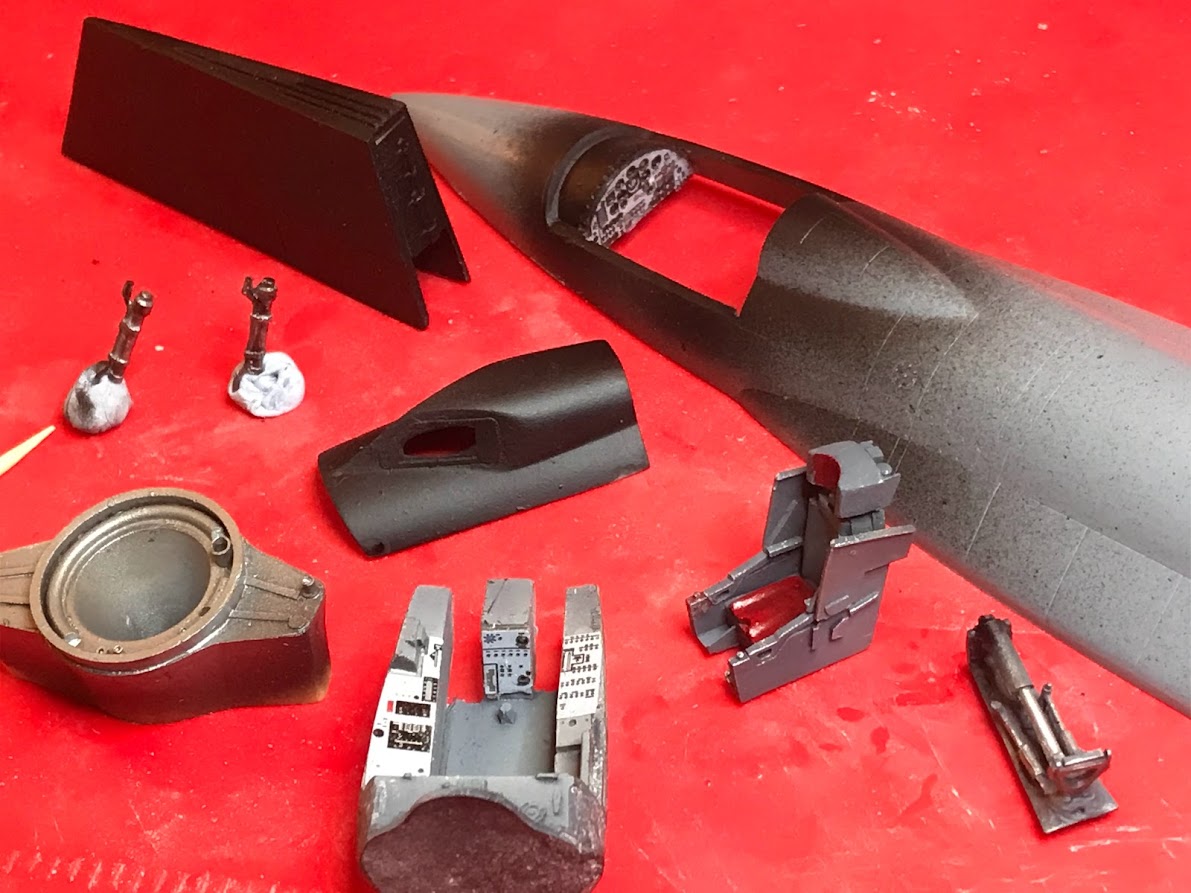

Almost done…
Cockpit close up before closing it up
