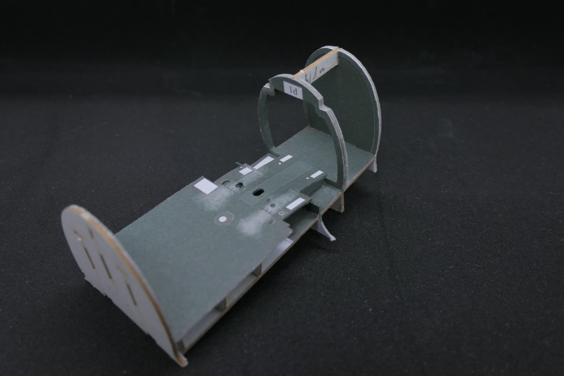

I’m starting the build with the cockpit, or rather its frame. There won’t be photos from this stage, since they’re of tragic quality (I promise to improve in the future) – but I’ll show what I’ve got."

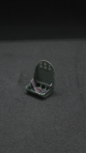

A small build update. With a bit of free time on my hands, I got started on the pilot seat.
This was probably the most time-consuming part so far – lots of small wire pieces, hole-punching and bending to get a realistic, three-dimensional effect. It wasn’t without its stumbles: somewhere along the way I ended up with a weird “step” where two elements met, the paper started delaminating on one of the bends, and the polymer glue I wanted to try turned out too sticky and stretched like crazy !– so I went back to my trusty Butapren and BCG.
To finish it off, some retouching for realism, and I used Eduard photo-etched seatbelts, since they simply look much better.
I’m really happy with the result :blush:
As always – tips are welcome. Still learning as I go.

Just watched your video, I’m totally blown away by this, I had no idea. You are literally making every piece, coloring it and then glueing it together.
Some thoughts/ideas:
You might want to try a PE bending tool for some of your small bending. It is designed for exactly what you are doing with a ruler, but really precise as it is meant for metal.
1/33rd scale? Why did they do that I wonder? I mean I guess it is close enough to 1/32nd but it seems silly that they have created an entire new standard. Are they all that scale?
It seems like you would go through a ton of knife blades, I’ve mostly switched to the snap off kind that have the same blade angle as the standard #11 and they work great and are much less expensive and easy.
I subscribed to your channel as I look forward to seeing this new artform.
Thank you for supporting my work on the YT channel :slight_smile: Muuuuuch appreciated !
I will definately have a look into this PE bending tool. Is it not the one I’m using in my second video where I work on the pilot seat?
Why 1/33 scale? I have no idea to be honest, 90% of the paper aircraft models are designed and printed in this scale. Maybe it has something to do with the size of the parts. For example 1/48 would be almost impossible to build in my view.
You are correct about the blades. I have a good pile of brand new ones waiting for their turn :wink: Working on a paper model uses a looooot of those.
