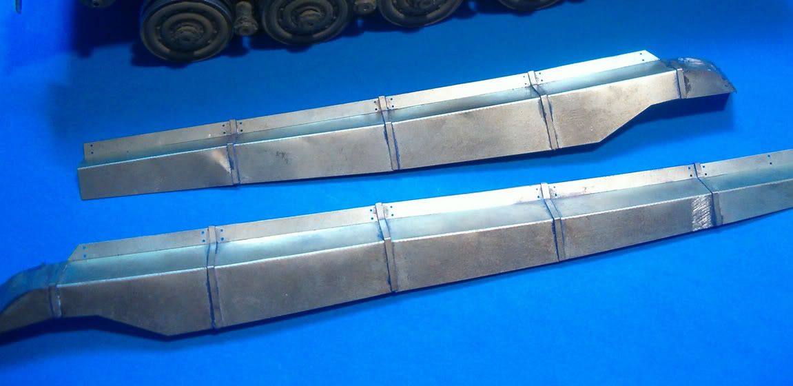

here are some side skirts from my Tiger II done with solder
front fenders
