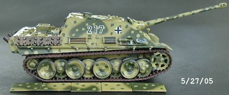

Ditto on all the comments about the short dragon vinyl tracks. The thing that gets me is they are so nice and detailed.
Here is my jagdpanther with the tight tracks
Here is the finished model - tracks tied down with thread and CA
