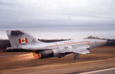

They do when the afterburner is on…
I saw it done quite effectively at a show a number of years ago:
The guy took an acrylic rod and put it inside two acrylic tubes; he airbrushed rings of different transparent colours from the Tamiya paint range on the rod and each of the tubes before assembling them as one unit, once together and inserted into the model’s tailpipe as a support, he had a very nice conical “burner ring” effect.
That he had an LED wired up in the tail pipe to illuminate it didn’t hurt either.
On AB they do or these 2 Canadians are in for a short ride!
TWR: " EH… Random 14 you have a dual engine fire!!!"
TWR: “Disregard 14 I see you’ve already ejected!”
