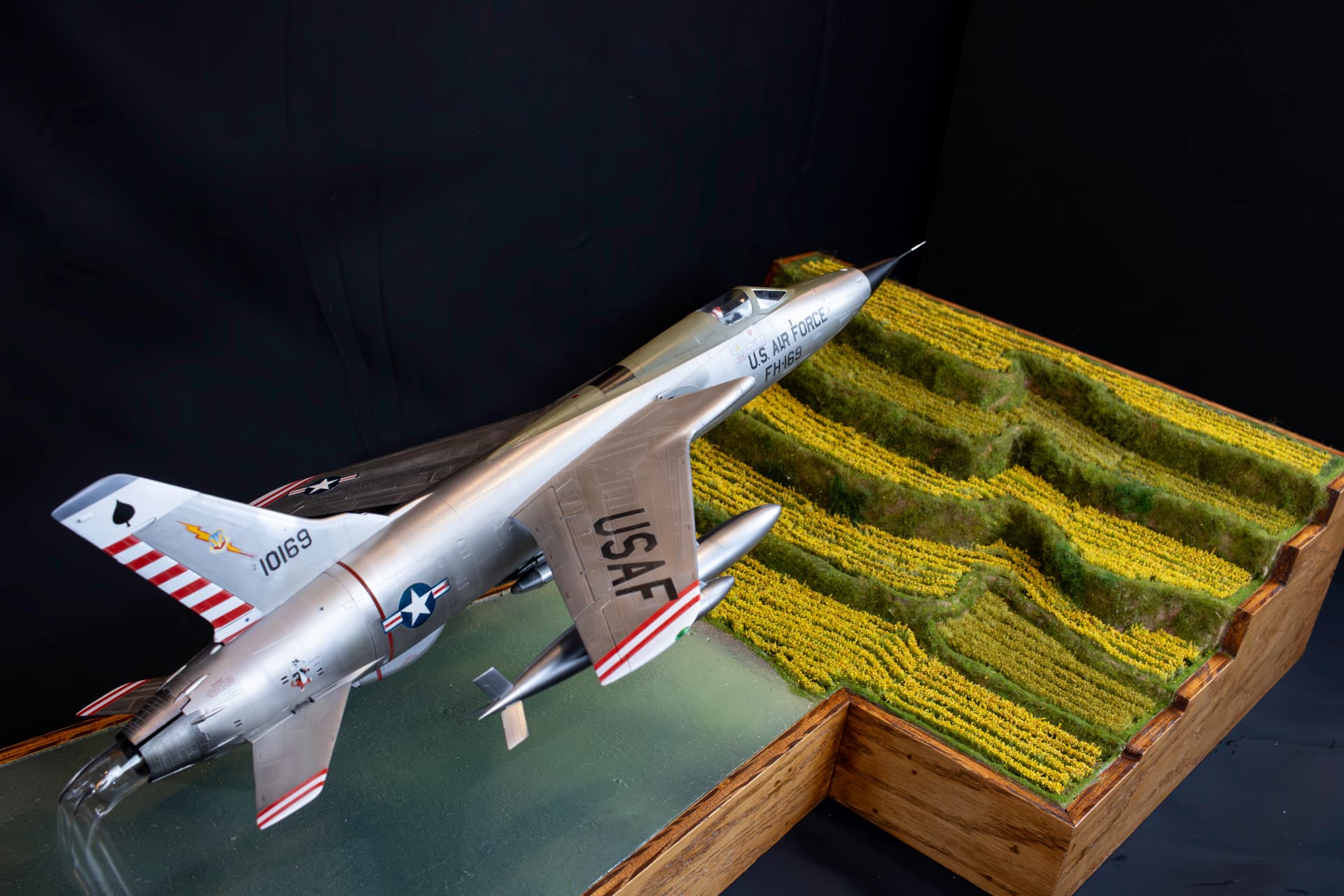

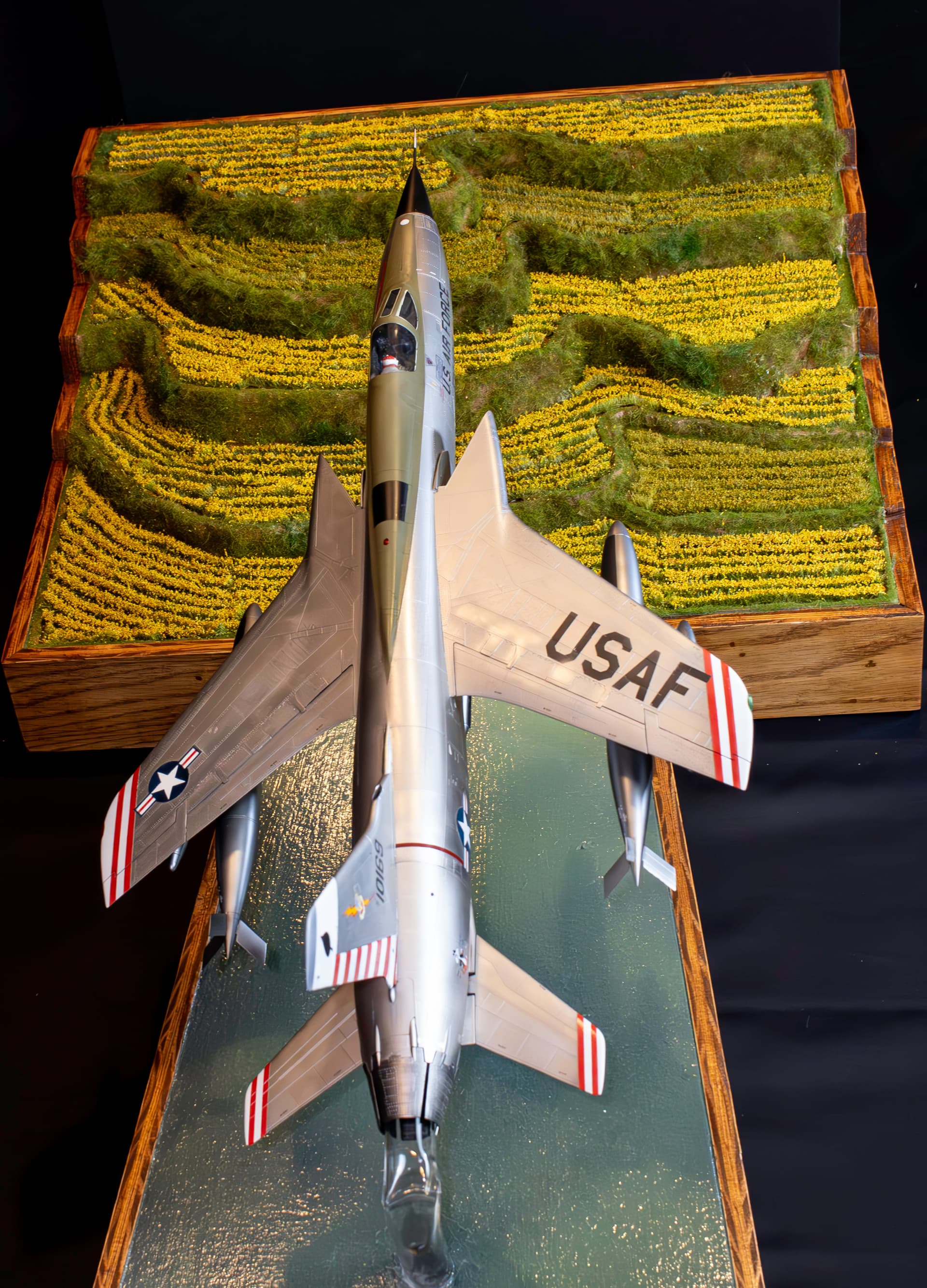

A buddy of mine has one. He did an F105 markings with it. It turned out amazing. I can ask him what’s the best material to use and pass that along to you.

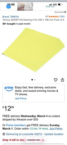

This text is from him, “ Tamiya is best from my perspective. Holds down over curves and doesn’t shrink after application.

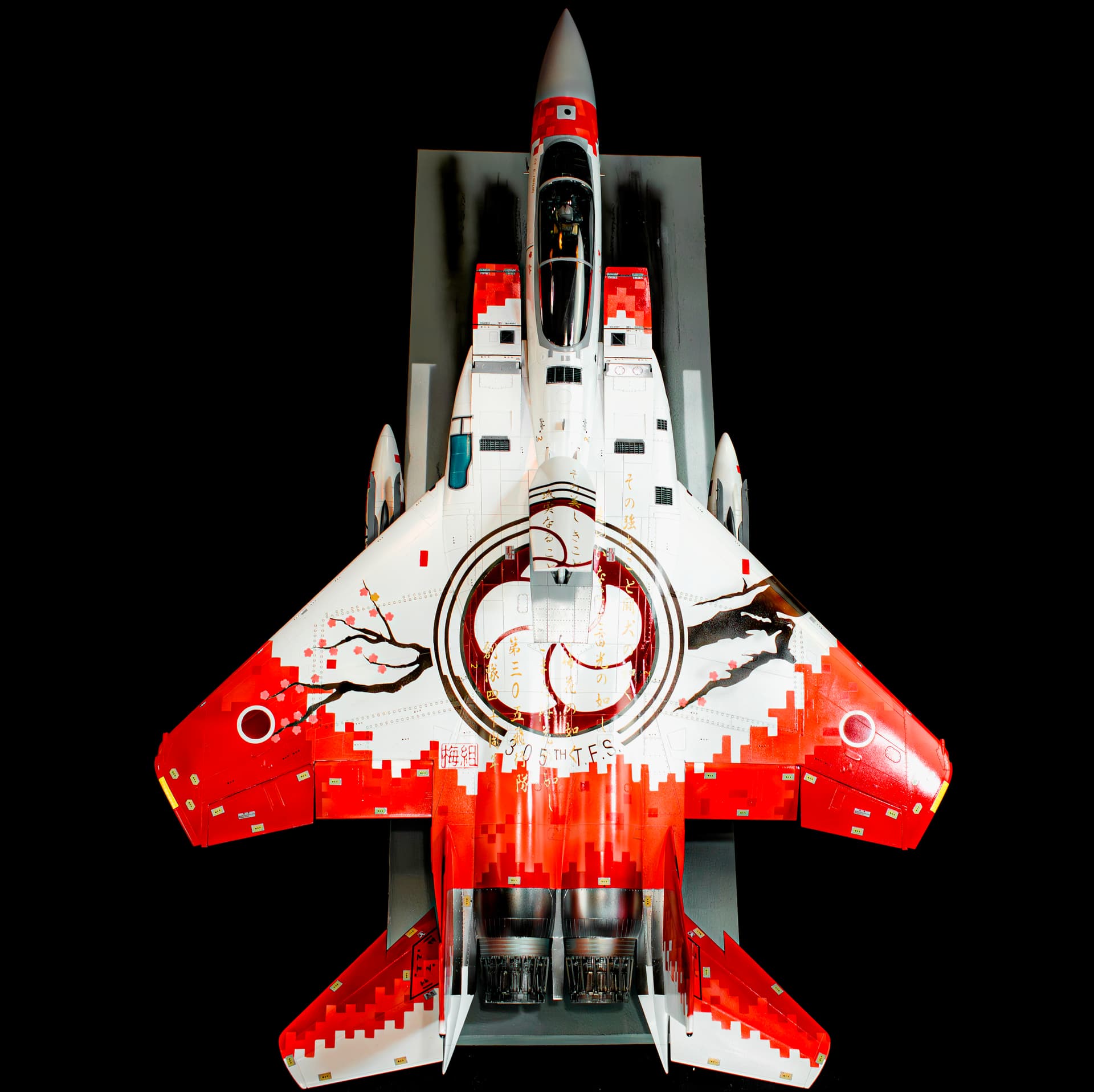

These were built by a good friend of mine. His name is Chris Vandegrift. Here’s some results using the cutter.
