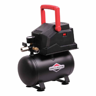

All you’ll need, works for me… about $50 bucks.
1 Gallon Air Compressor
