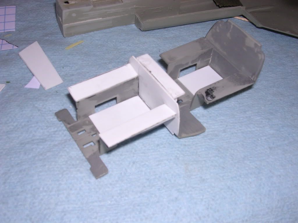

This is from another thread where I’m using Evergreen sheet to re-build the cockpit tub of an old Revell 1:32 F-4J. I’m using sheet pieces for the main panels, then will use strips, rods, and other shapes to add details. I normally will use an index card to make a pattern for trial & error fitting, then cut the final piece out of plastic.
