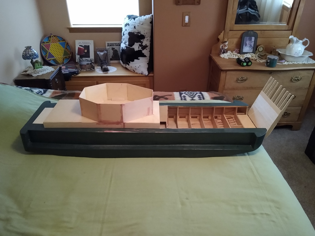

Anyway, here is the Tango Boat so far. Basic ATC hull is done, and I’m into the bow ramp sub-assembly. Now it’s time to break out the Bondo . . . Fun, Fun, Fun !

Well, that is looking good. !
I drove an LCM-8 at Assault Craft Unit ONE in 1970 at USNAB Coronado and loved that boat. Sure, it really was a “pig”, but one could park that 73-footer in a 70’ space (with twin screws, who needs a rudder?). My boat (LCM736) was an old steel boat, but it sure seemed more sea-worthy than the newer aluminum boats, especially when retracting and making that u-turn past the surfline.
So, despite the limited availability of Tango boat drawings, progress is being made using those that are available and what photos are around.
