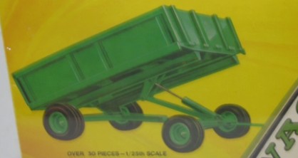

I have a similar situation, but the farm wagon that I want to build is a lot more modern. I plan to build everything from scratch using various pieces of styrene (square stock, round stock, angle stock, sheet). I’m not able to build the wheels and can’t seem to find a basic steel rimmed wheel on scalemates (seems everyone wants fancy rims for their models). Does the group have any suggestions?
Is there someone who 3-D prints the steel wheels that you’re looking for? I’m curious as to what tractor is going to be pulling this wagon?
Here’s a link to @NucMedTech build of a ‘53 pickup. The way I read it, both these wheel/tire options are in the truck kit. Maybe that would work and someone might be willing to part with the stock set.
Thanks @Frozin I don’t want to volunteer his wheels for him. :smiley: He may have a use for them.
Oh. I wasn’t suggesting his wheels specifically. I figured there is a chance someone else here may have the same kit and some to spare. Or if you felt so inclined, you could pick up that kit yourself.
Oh, I agree= I didn’t realize we were talking about such small scale. I build spoked wheels only in 1:16 and larger.
