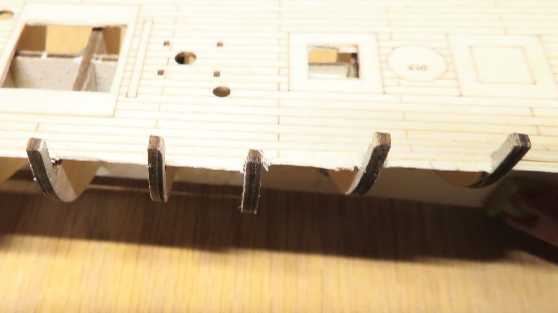

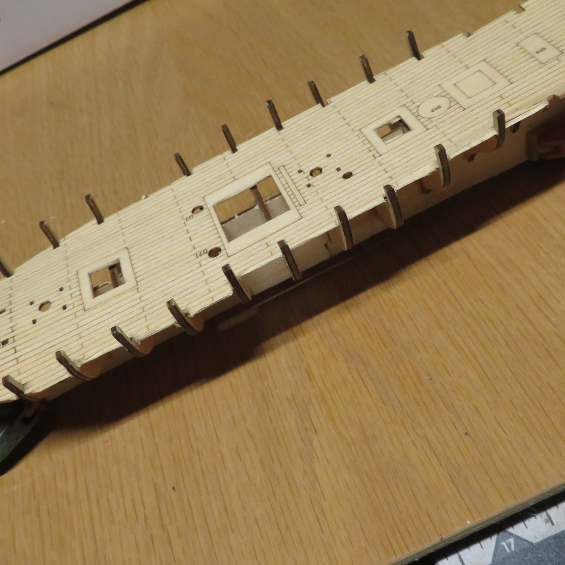

Sorry it has been so long getting back to this project. Got the deck in. Here are a few pictures.
I shoud have widened the slots in the deck. As it is, a bunch of pieces of the deck sheared off. I can take a piece of strip stock, cut pieces, and glue them in place. Still, it would have been easier not to have to do that.
