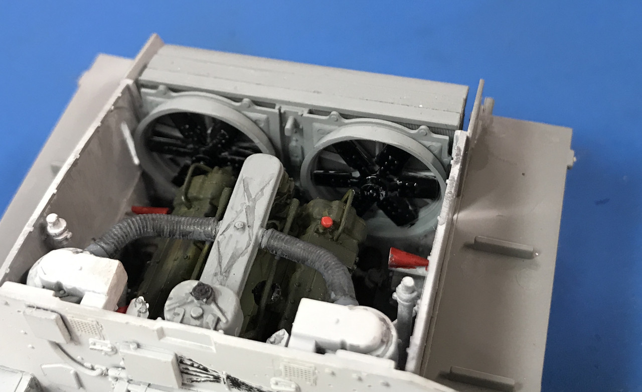

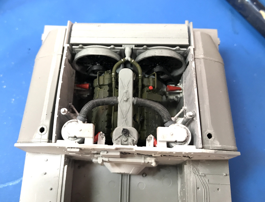

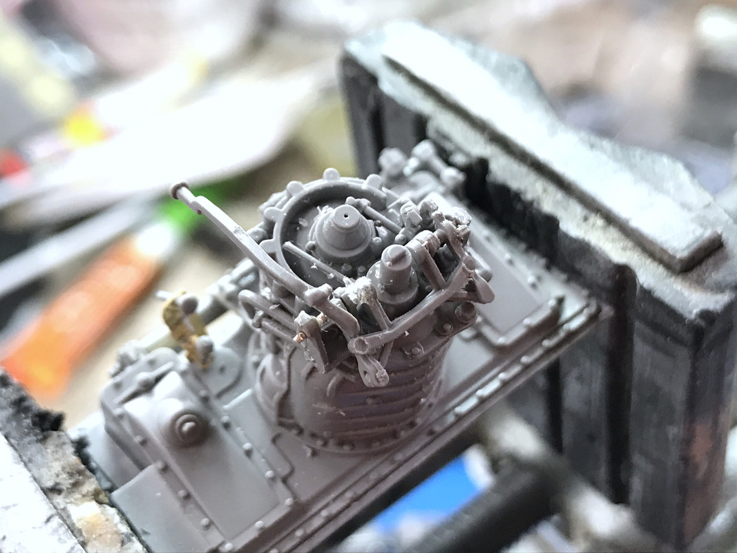

That said, I got something done for my hour in the basement. The radiator, fans, belt drives and top radiator line are now in.
Instead of following the instructions, which had you gluing the front portion of the radiator in first and the back portion up to it, I glued both halves together and then glued it all in. Before gluing I masked the glue edges and airbrushed the whole deal the Life Color Haze Gray. I then brush painted the fans semi-gloss black. I brush painted the belts Tamiya Rubber Black and then the hubs the semi-gloss black.
Here is the radiator assembly in place.
I then had to finagle the belts into position. This was troublesome because of the clearances at the gear boxes. Having the hole in the correct location on one of the boxes for the pin on the belt drive, really wasn’t much help. In fact, it was easier with the other one where I clipped the pin off since there was no hole for it. I was just able to swing it into place and then glue it. I finally got them in and had to retouch the paint a bit.

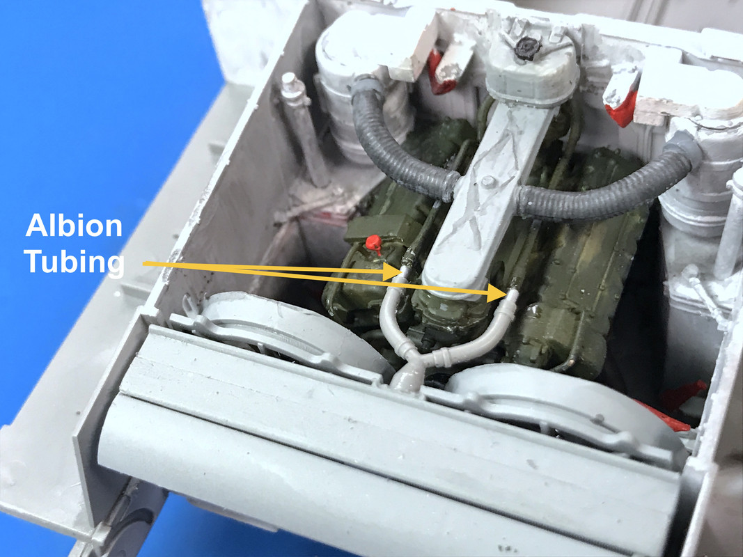

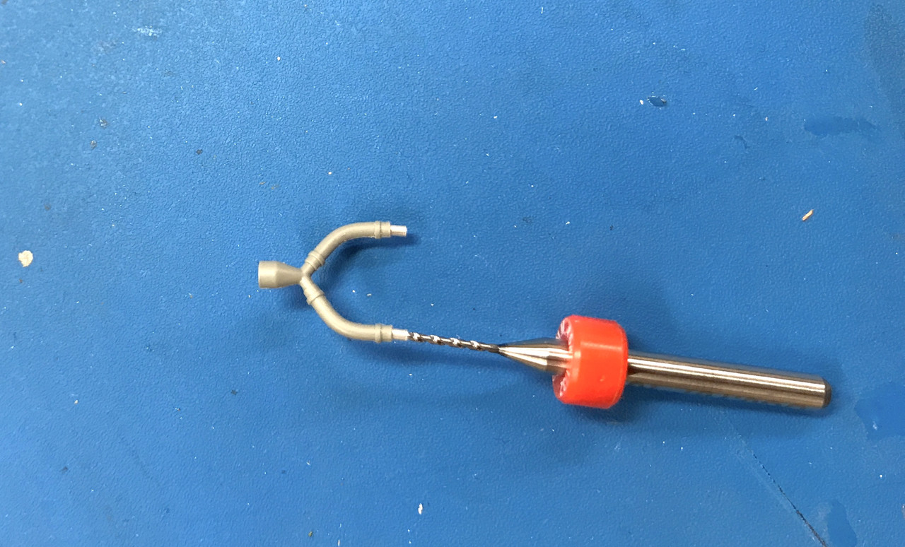

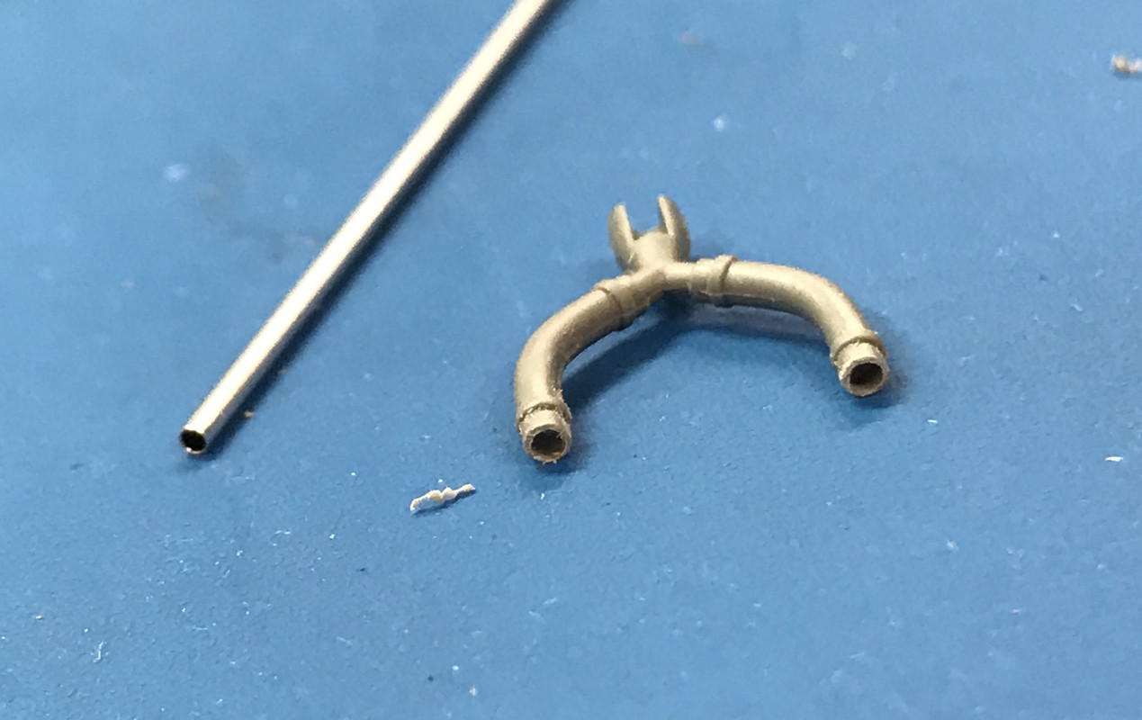

The top radiator hoses were supposed to intersect with the piping coming off the intake manifold, but they were about 1/32" short. I decided to do a little micro-surgery to add some 1 mm Albion Metals micro-tubing to close the gap. I first had to drill the ends of the styrene radiator piping. I started with a pin-prick from a pair of dividers, then drill with the 0.022" carbide and finally opened up to 0.037" for the Albion Tubing. I was very pleased with myself that I was able to center the drilling and not break out of the side.
I cut Albion tubing with a razor blade. You roll the blade across the tubing a couple of times and the piece breaks off. You need to keep the blade perpendicular to the tubing. To do this easily, just watch the reflection of the tubing in the blade. When it appears that the tube is still going straight through the blade, you squared up. The key is to keep it that way while you roll it back and forth. Don’t press hard! If you do so the part will come off with energy and we all know what that means. Soft works better.
To get the tubing into the holes, it’s best to use a guide in the tube to align it in the hole and then push it in. In this case I used a 0.032" carbide drill. It took a couple of tries, but miraculously I did not lose any of my cut pieces.
With the added pipes, the lines now touched. I will paint this tubing tomorrow. Again, these are details only a modeling nut would ever notice, but believe me, the guys in my modeling club are a tough crowd.

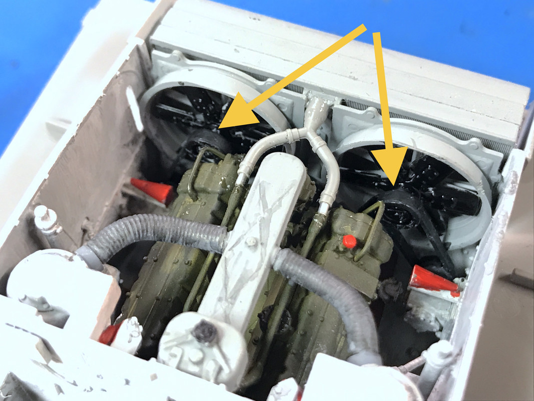

Here’s a reverse view that shows the whole deal including the fan drives. Yellow arrows point out the drives. I still have to weather the radiators, will do tomorrow.
Albion tubing is ridiculously small with very thin walls, and is the only thing I’ve found that can give you reasonable looking terminations for scratch-building piping using .5mm solder wire. The tubing comes in an assortment of telescoping tubing in 1mm, .8mm, .6mm., .4mm and .2mm. The small one is so small that it’s almost non-usable.

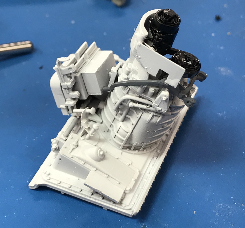

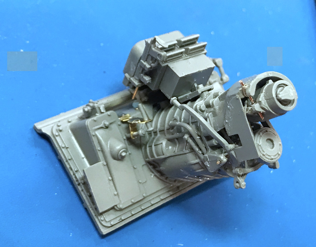

Today’s work, the transmission tested those hands to the limit. I only didn’t put on one crazy small part. Not because I couldn’t handle it, but because the gluing surface was so small as to be completely ineffective and it wasn’t worth the trouble. Before I did that, I finished up the radiators. I painted the connecting pipe with my extensions and I aged the rest with low-odor mineral spirits + Tamiya Panel Accent Black. This didn’t dissolve the water-based paint underneath. I didn’t overdo it; just a little to break the newness. I picked out the pipe connectors with the Molotow Chrome Pen. With this the engine compartment is complete.
Now onto the transmission. This assembly includes the trans, a generator driven by belt off the drive shaft, the ventilation distribution apparatus and the grease gun portable machine gun.
This assembly consists of 48 parts! That’s a huge parts count for such a small structure. Here’s what the instructions look like. This was two out of the five steps to build it.

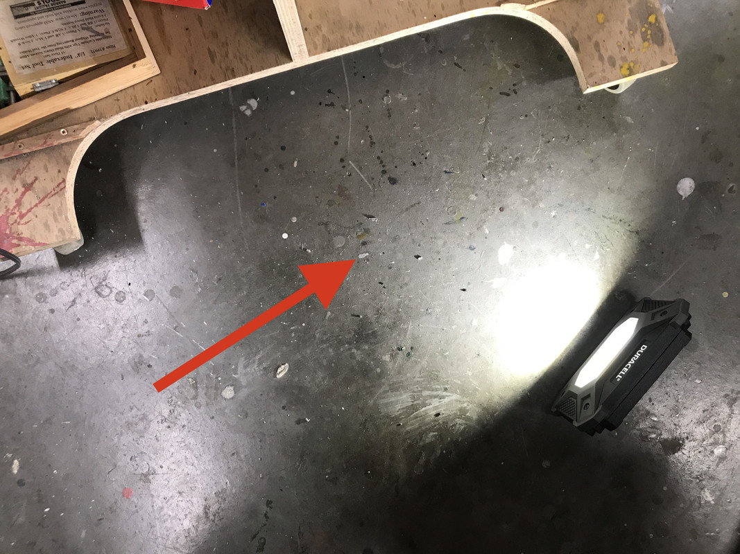

And one of those parts look like this:
I did not use this part. It was the only one.

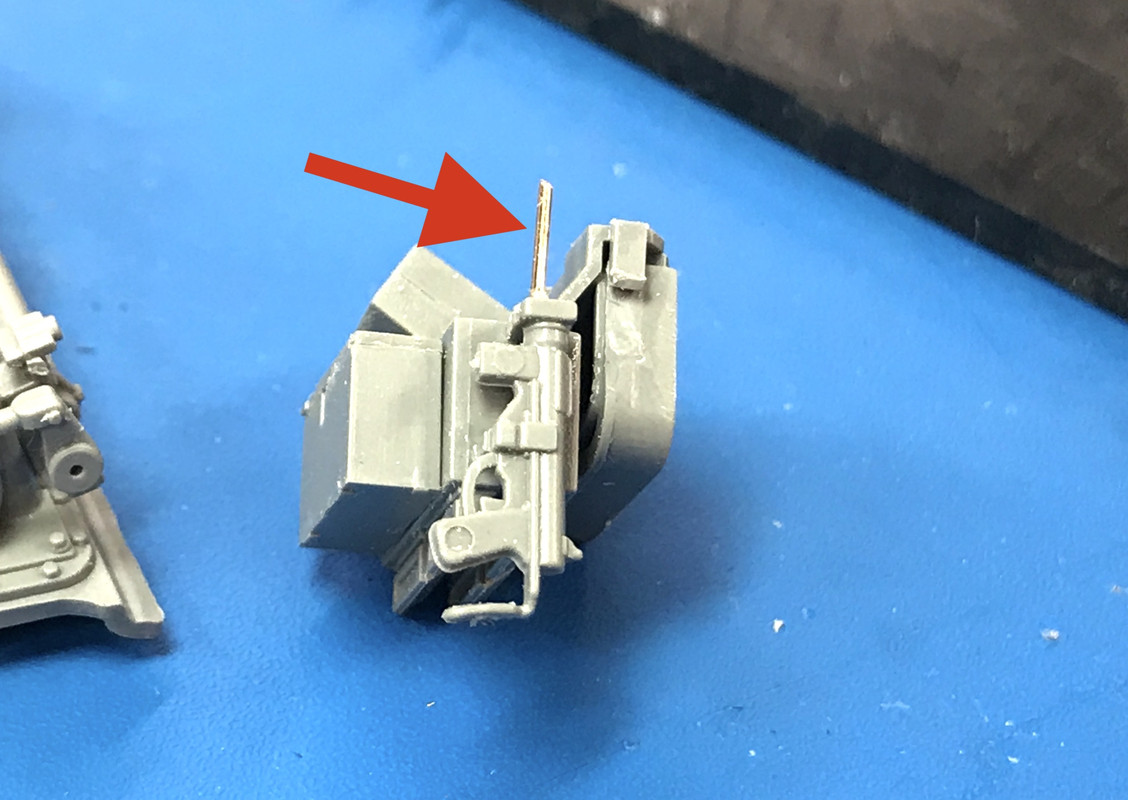

The ventilation system was a six-part affair not including the machine gun. That gun’s barrel broke off while still in the sprue. There are others so I measured their barrels and it came out to a convenient 0.022" of which I have the drill and the rod, so I drilled it and replaced it.

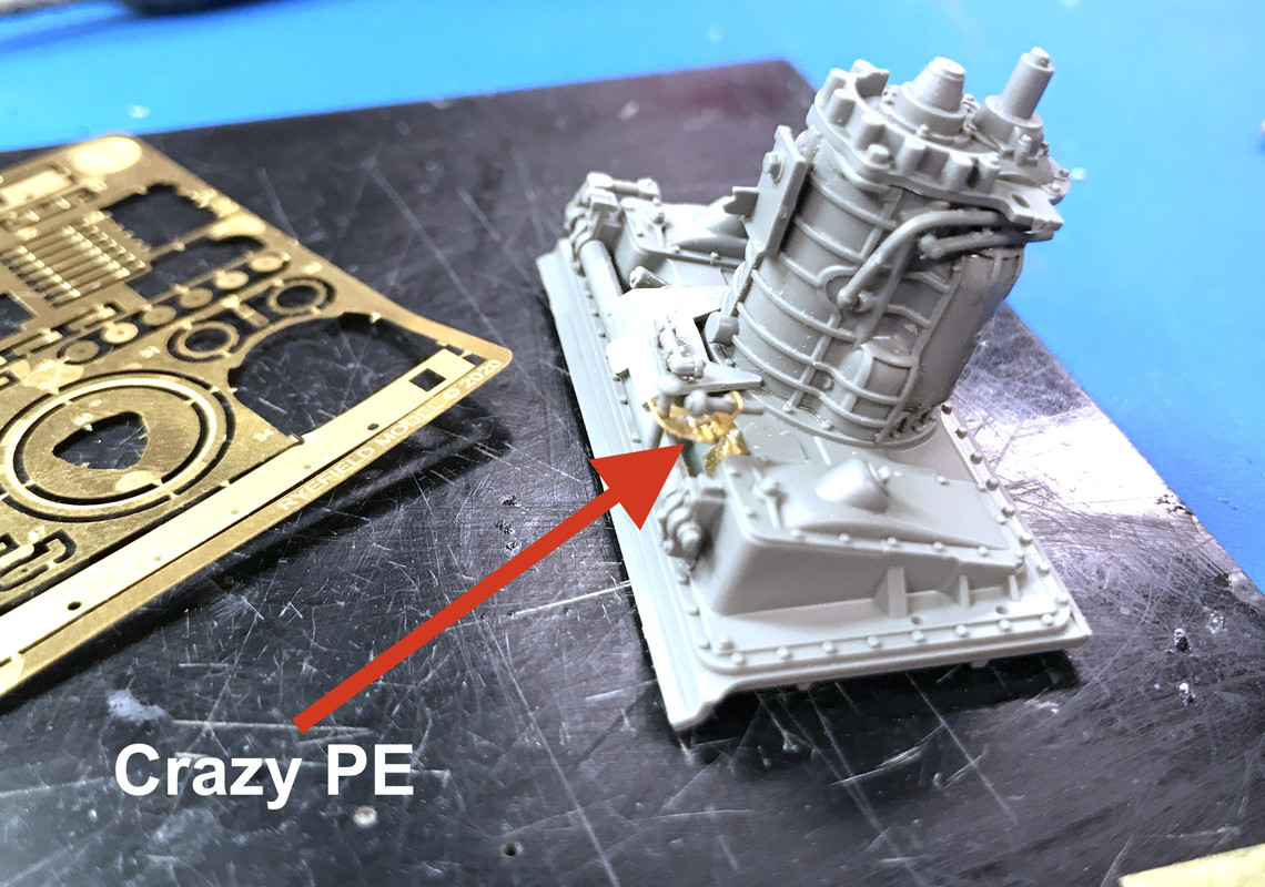

There was an intricate folded piece of PE with some plastic parts added. I had to reinforce with CA and Bondic to keep it all from unfolding and eventually breaking.
The trans’ back end was ridiculous. Lots and lots of tiny parts with specific orientations. It was actually fun and was a challenge. The lever? I’m not quite sure what it actually does. It may be a parking brake. I’d have to find a Sherman operations manual to figure it out. (Editors update: That’s the gear shift lever! DOH! Of course it would be with all the mechanism attached to it) The gear shift nestles between bunch of brackets as does the operating linkage below it. Solvent cement wasn’t cutting it. I eventually succumbed to cross-drilling the whole deal and pinning it with phos-bronze.
Behind the trans goes this generator thing. Again, I’m not sure why the generator is attached to the rear of the transmission and not in the engine bay. (Editors Note 2: Yes, it is the generator, and I still don’t know why they put it in the fighting compartment) It has a belt that will be intersected with the drive shaft. The guard and the gerator were difficult to build. That’s because the generator was suspended on solid material only on one side. The other side has a scale-sized (read very fine and thin) adjustment link which would support the other side. That link broke in my many attempts to correctly install it, and again, I was forced to make a link out of phos-bronze and used Bondic to lock it all together.
These very closeup shots make the stuff look very rough, but you really can’t see it with the naked eye and it’s not painted yet.
So here is the finished transmission. The front gear case glues to this bulkhead, and then this gets glued to the hull front. Only then will the steering levers be attached. They attached to the cross shaft on the bulkhead top.
The front gear case gets built tomorrow. When I fasten this to the hull, I might spray that part the base white color. Also, I put a coat of Molotow Chrome on the fire bottles’ piping. This will be nice and dry to tomorrow so I’ll put the clear colors over it to simulate the brass.

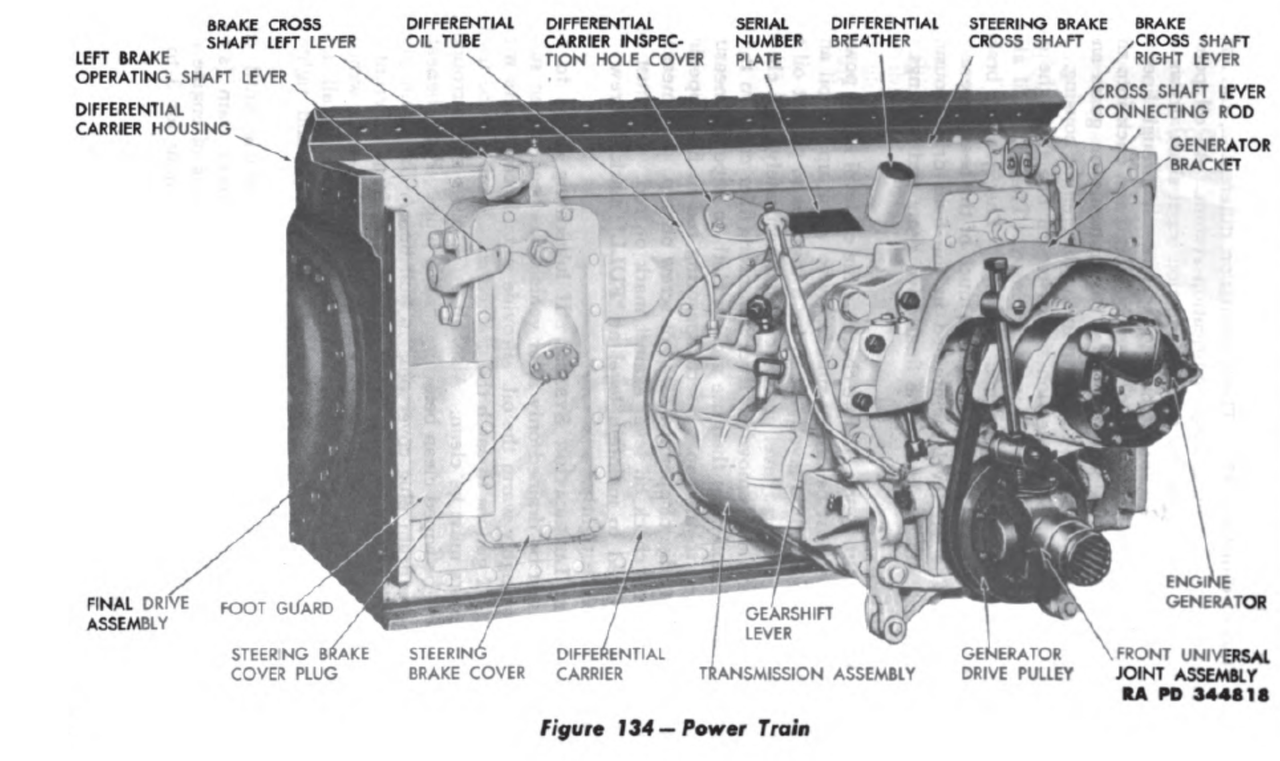

Found this diagram that not only names all the parts, but shows the coloration of the generator assembly that contrasts to the rest of the interior painting.

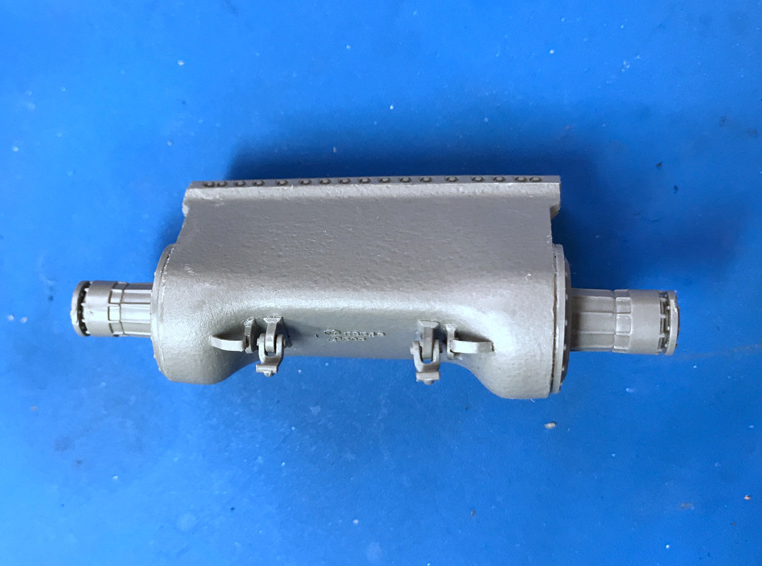

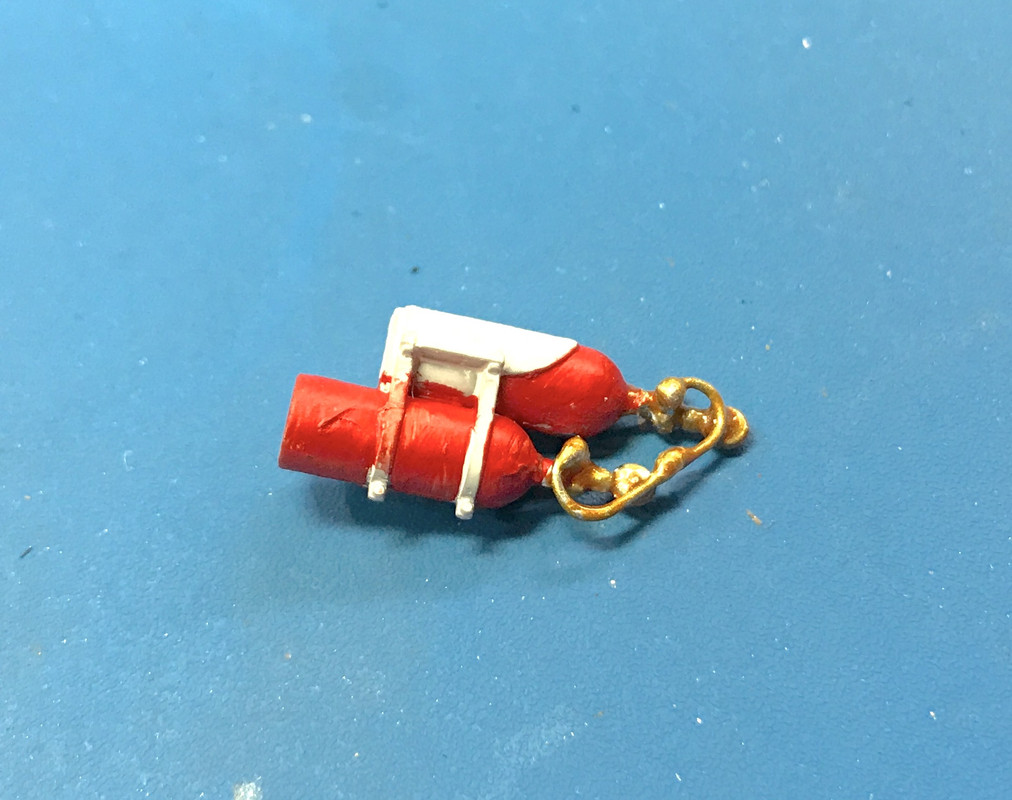

With little over an hour in the shop I got the “brass” painted on the fire bottles and built the gear case. While the gear case was not high in part count, it did present its challenges.
I mixed Tamiya Clear Yellow and a little bit of Clear Red. It’s a bit orange, but won’t be seen anyway. Remember: this was on a base coat of Molotow Chrome Pen.

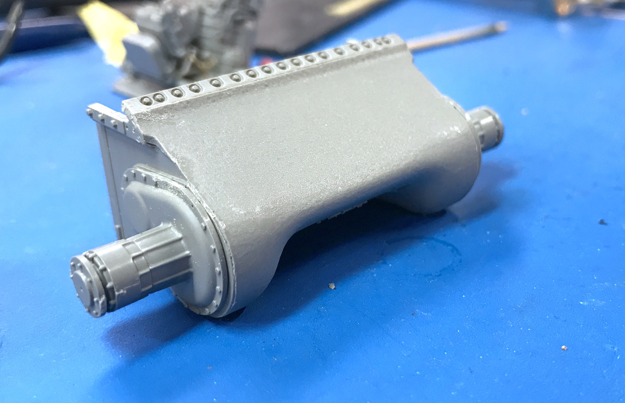

While the gear case should have been a slam dunk, it was not. Instead of having the end plates inset into a rabbet around the edge like normal plastic companies do, they had both edges of the joint as a miter and little or no alignment aids. You have to get it aligned and started on one edge and then gradually position it around the perimeter. Solvent cement was applied from the inside and pulled through the length of the joint.
The gear covers on the ends were mislabeled in the instructions. Part E23 should have been E22 and vice versa. There were tiny alignment pins on both pieces that were on alternate sides. When I tried to put the parts called out in position, the two pins were direct opposing each other making it impossible to properly seat the part. When I looked at the other piece, the pins were on opposite sides helping align the joint. I made the change and noted it on the instructions.
The outer hubs slipped into poly cap and do rotate.
Underneath the cover goes the similar arrangement that you saw in the back, simulated welded on brackets holding a movable tow hook. Also note that tiny piece of plastic forming the guards on both sides.

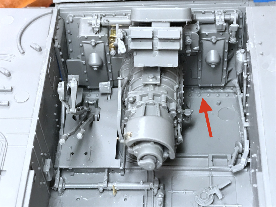

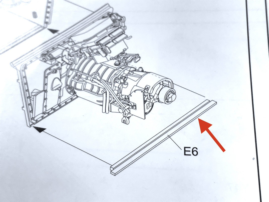

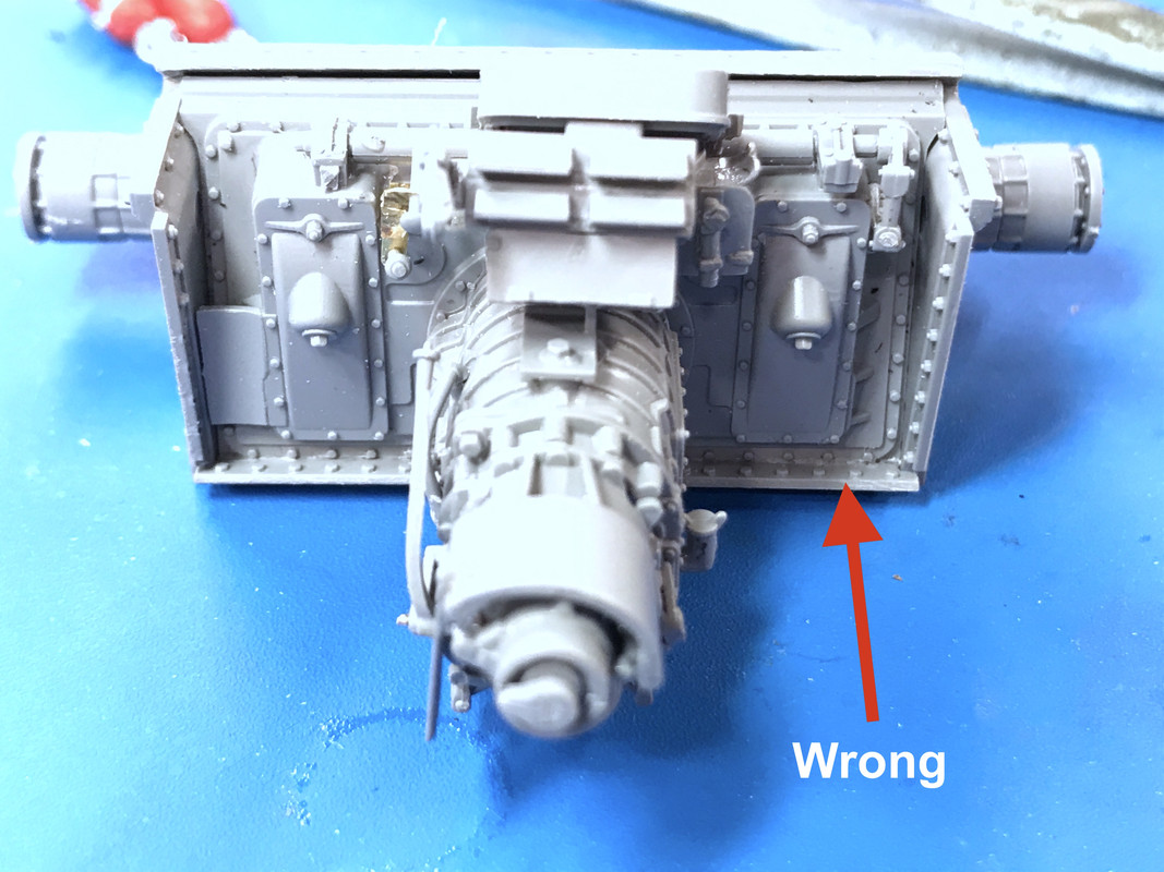

Lastly there was part E6. When I first put it on according to the instructions, it seemed upside down. That’s because it had the bolt detail facing the bottom and I thought it would be hidden when the gear case was joined to the hull front. So I reversed it with the bolts up. This idea was reinforced in my mind since there were matching bolts on the vertical surfaces of the gear case mating to the assembly.
Then I tried the whole assembly to the hull and found that the forward edge of the hull bottom had the bolts that I thought should be part of E6. Clearly, the instructions were right all along, so I ripped it off and re-glued it with the bolts facing down.
Here’s where I had the bolts facing up… WRONG! You can see the vertical bolts that I assumed incorrectly had to match those on part E6. BTW: those bolted on bulges on either side of the foot board are the covers for the steering breaks. They’re adjusted from the inside of the vehicle and are fully enclosed from the compartment.
Here’s the part correctly installed and showing the bolts on the front face of the hull floor. The arrow is showing the bolt detail that is alread part of that flooring. So my concerns were unfounded. BTW: according to that gear box illustration on last night’s post, the generator and it’s drive system is painted black, not interior white like the rest of the trans. I’m painting the trans assembly BEFORE I glue it into the gear case and before that gear case is glued to the model’s front.

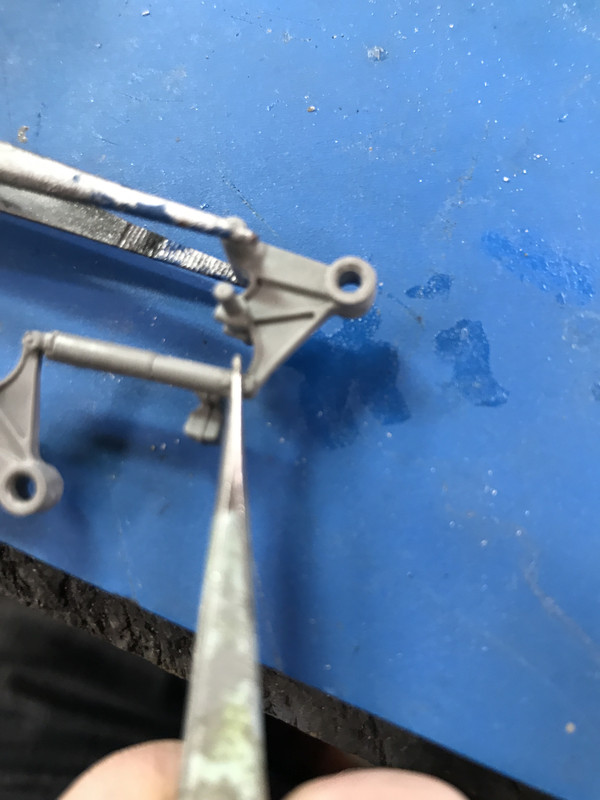

The little round part glues to a notch on the half-arms. Took a while to clean all the parts. No flash, just sprue nubs and some parting lines.

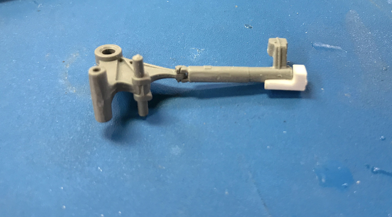

Then comes the shock absorber that is one of the members that holds the two sides together. The shock is three parts: the main shaft and two very little other halves of the two ends. These ends are supposed to be movable if you want the suspension to articulate. I was able to successfully get all of the part 58 (6) onto the one end and captivate the arm.
The arrow shows the notch that the part goes in. The part is laying upside down in the image. BTW: that very large tool in the picture is a very fine-pointed pair of Swiss tweezers. You can only get glue in the notch so the pivot remains free. That was not easy. And the gluing surface is small. The only way I could figure to get it together was to glue the part in place, spread them enough so they could pass over the pivot holes in the shaft and then squeeze them back together. Sounds simple, but it wasn’t because the solvent cement would cure too quickly so when I spread them apart to slide them over the end, the little part would fall off. It wasn’t too bad one the single arm.

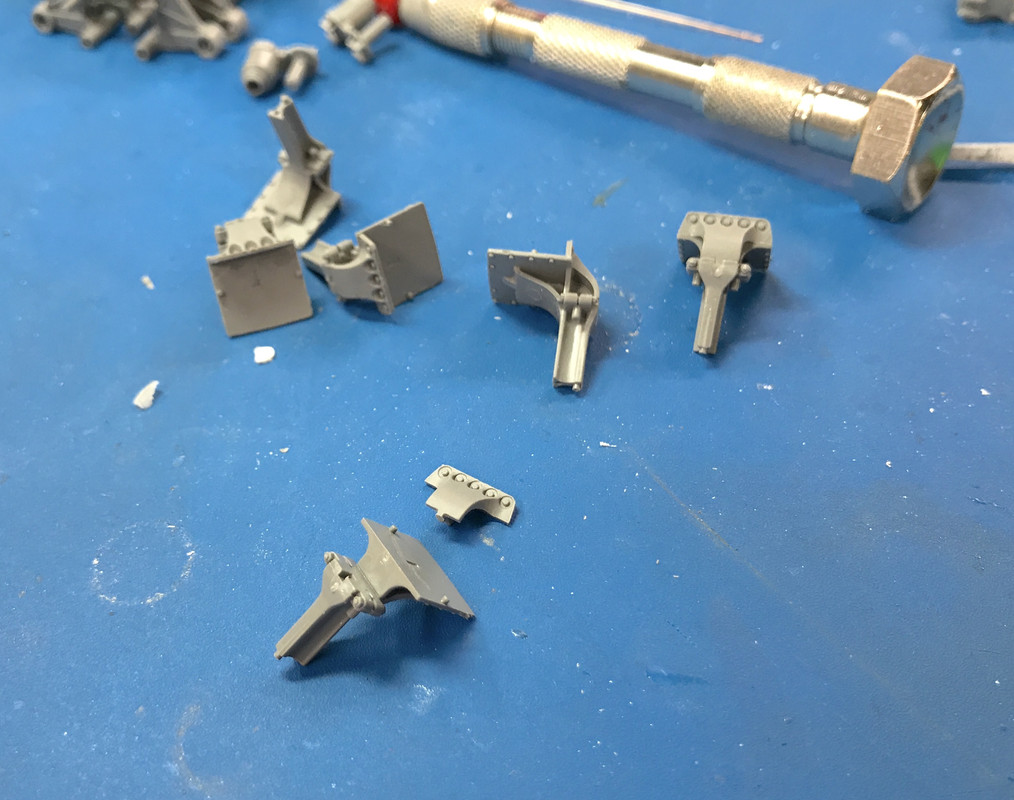

Things have gotten much uglier when I attempted to add the second end and connect the two sides. Again the quick drying cement was causing trouble and I even had the first ends starting to come apart while I was manipulating the parts. And then I kept flying them all over the place as they launched at of those aforementioned tweezers. I’m now down two, hopefully I’ll find them, but if not I’ll figure something out. My guess if this was Tamiya, they’d made the clevis as part of the shaft and make it flexible enough to spread to snap over the end. Or it could be drilled and pinned. That may not work here because the ends don’t have much meat and the holes will probably break out. If worse comes to worse, i could actually make them out of brass. Where there’s a will…

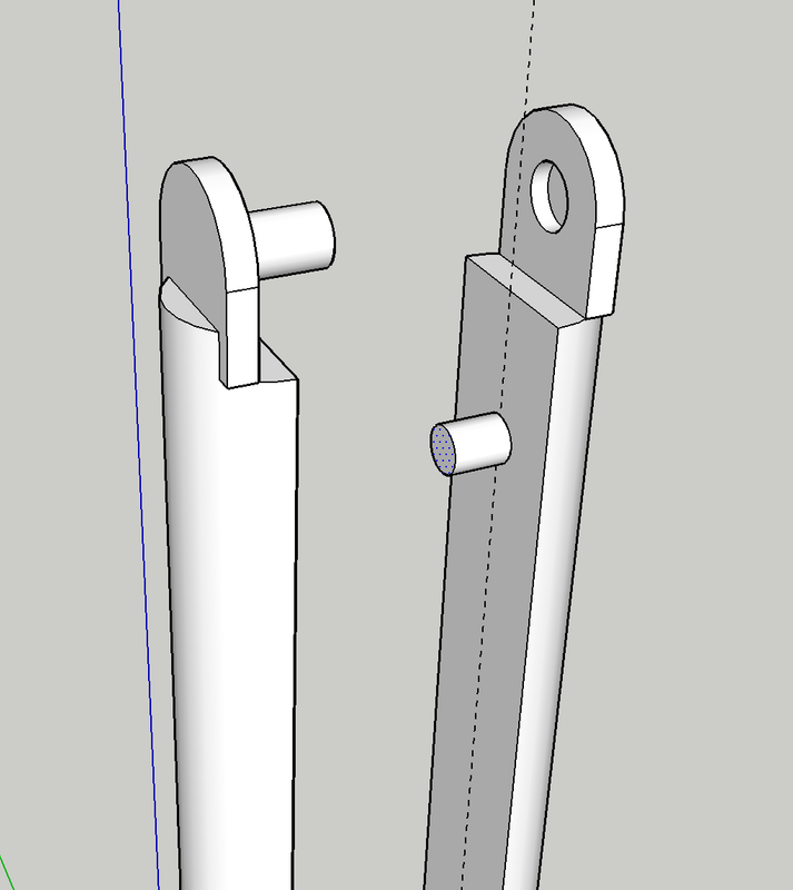

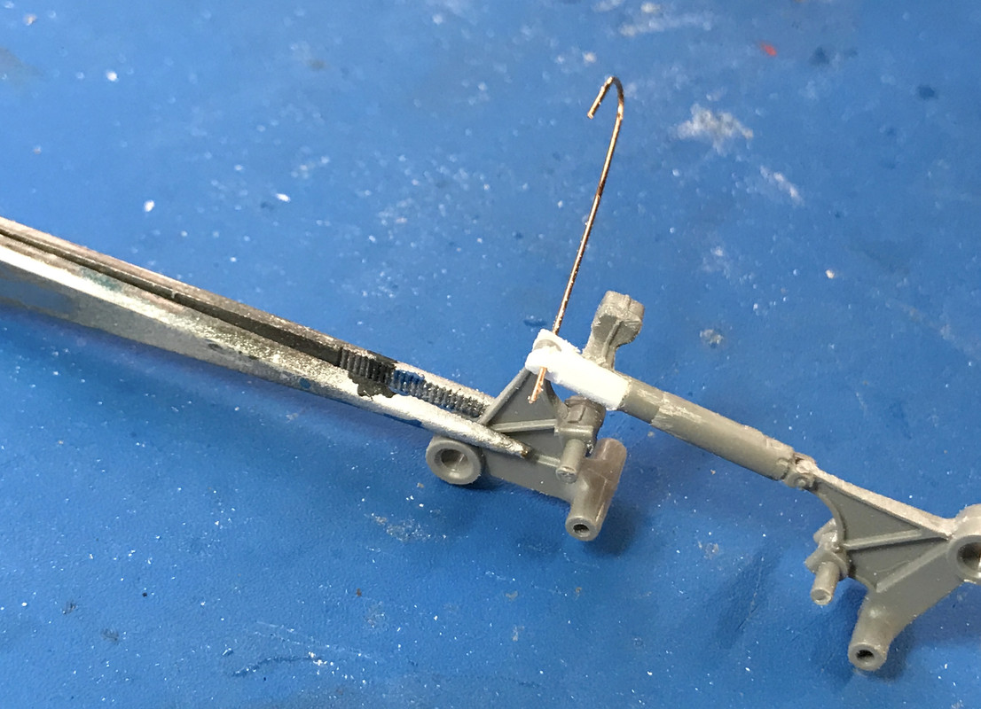

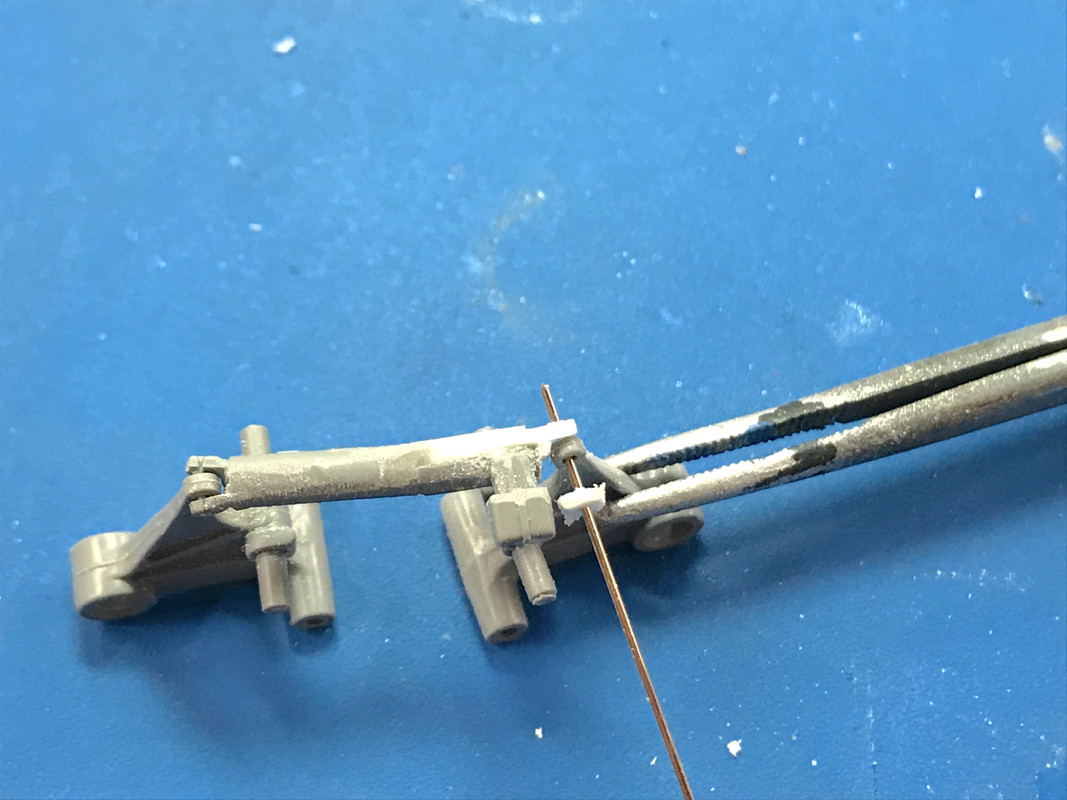

This is how Ryefield should have engineered this suspension part. The shock should have been split down the middle with a large pin on one side and a locating hole on the other. The glue surface would be huge and it would have been very easy to keep the glue out of the hinge zone. If Tamiya would have designed it, it would have looked like this. I’m going to flatten a larger area of the shock (it’s in the back) and crearte a longer more substantial piece out of styrene and then use a steel pin. It will work better.
As I remember the swing arms on the Asuka/Tasca M4 kit are designed more like that.
As you probably have surmised, when I set my mind to doing something, it probably gets done. I did get three out of the six bogie shocks built with the kit parts. And I found a way to glue the ends on with more success than I was having.

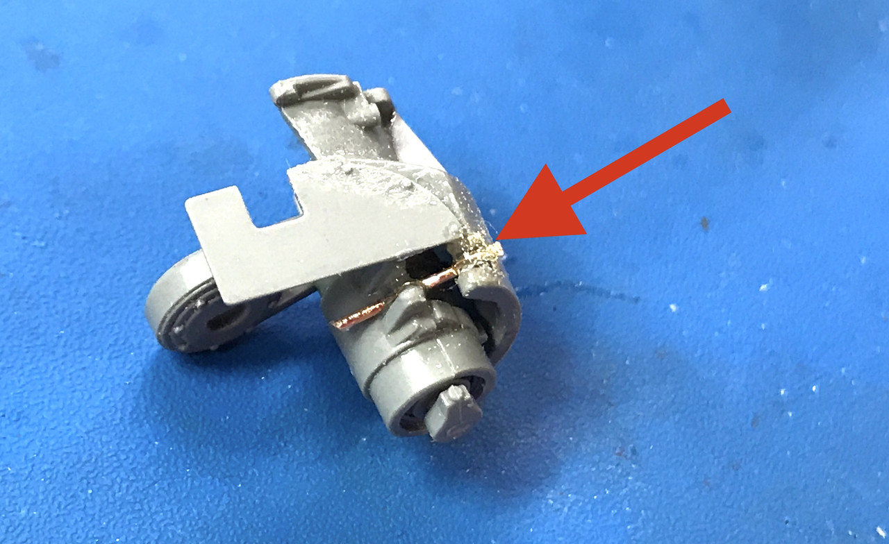

I placed the tiny end in its slot and then held it in position trapping the suspension arm. I then add added a very small amount of solvent cement to the back of the end and continued holding the tweezers until the glue set. I had to add the glue with my left hand, which for you non-ambidexturous (spelling… this site does not access the MAC spell checker) that was a challenge in itself.
This technique worked well for the three ends that I had left. I was three ends short! That meant Plan B. I had to add a styrene end with phos-bronze rods to replicate the missing ends. This activity took most of the afternoon. It was not easy and it was not linear. The first attempt worked great, which gave me a false sense of accomplishment. The next two took almost an hour and half.
I made a micro-saw cut some distance back from the shock’s end and then removed the material down to about half the diameter. I then cut a piece of 1/8" square Evergreen styrene, notched to fit into the cut on the shock. I glued this with solvent cement and let it dry.
The size of stock I was using was obviously oversized, so I used various methods to reduce the size and blend it into the existing shock strut. After shaping, I cut the slot for the existing suspension arm with two strategically spaced razor saw cuts. I then removed the piece between the cuts with the point of a very new #11 blade. The first attempt was perfect, although the slot wasn’t quite deep enough and I had to fudge it a bit to get the suspension arm to sit deep enough in the slot. I then drilled the 0.022" hole through the clevis and tied the two parts together with the phos-bronze wire.
Piece of cake… NOT! The second shock decided to rupture in half at the end of the flat cut due to putting too much stress on it when sanding the square styrene to make it round. This was another side trip. I drilled and reinforced the joint with the heavier 0.032" wire. It didn’t come out perfectly straight. It will be noticeable.
Then I had one of the clevis ends let go due to being such a small cross section and when manhandling the wire to get it installed. This was not repairable and it meant ripping out the entire piece of styrene and starting over.
The other thing that happened was I cut the slot on the wrong axis not looking at the clevis on the other end. And then the other end clevises started letting go due to all the handling. They didn’t break, luckily, but they were troublesome to get back together. To avoid overstressing them, I cut some relief notches in the suspension arm eye’s edge to guide the pins so they could snap into positon with less pushing.

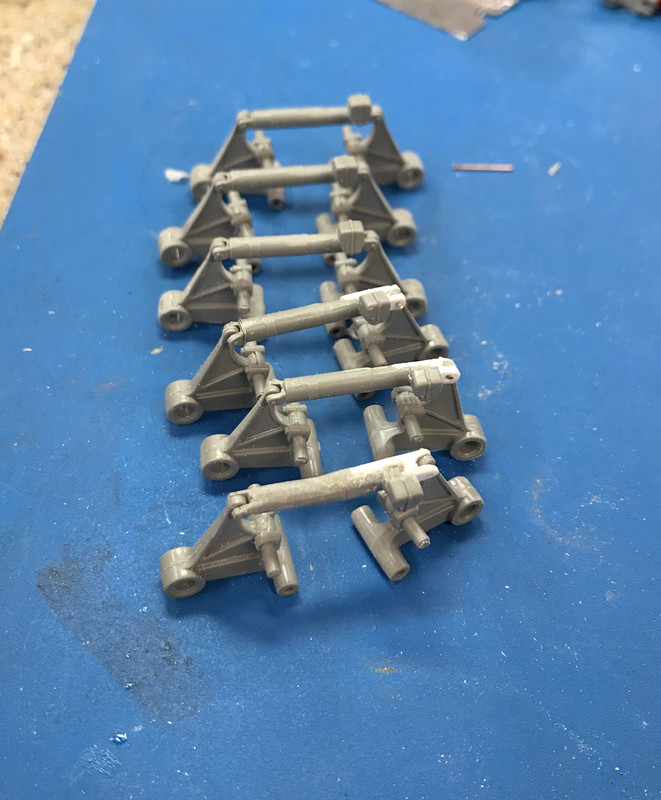

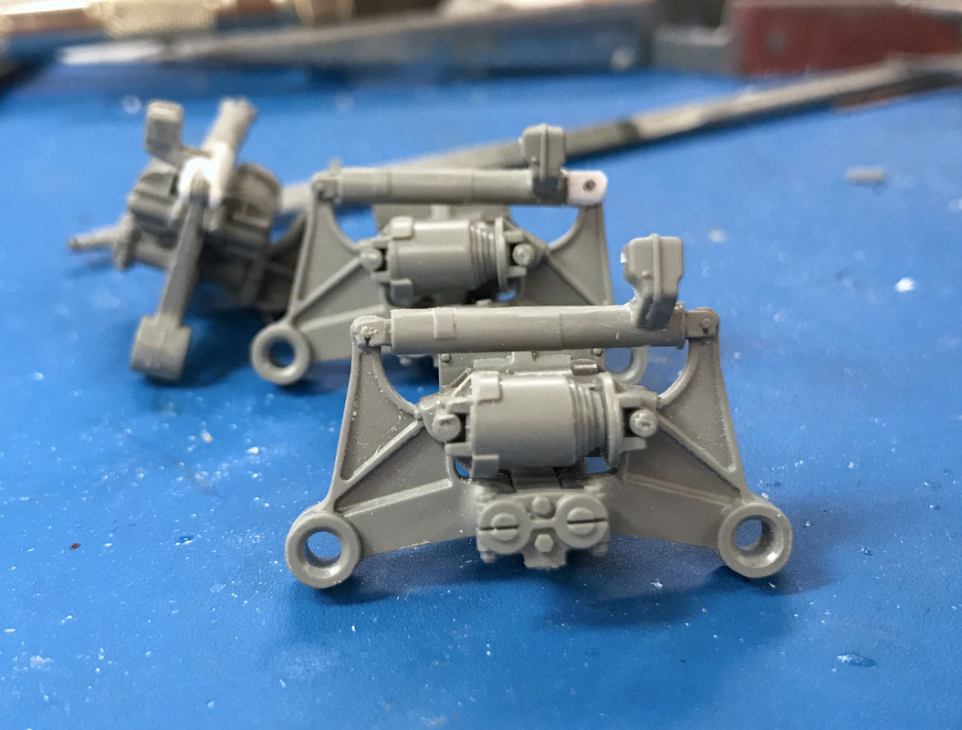

Finally, I was able to get all six bogie arms connected with shock absorbers. Their ends are different and a little fatter. If I attempt to reduce their size to the kit parts, the Evergreen styrene would have fallen apart. Evergreen’s is a much softer composition and wouldn’t hold up.
When painted they won’t look too bad. Considering the alternative, meaning three incomplete bogies, I’m okay with the solution.
Then you have to attach these arms to the suspension frame that ties it to the hull. These elements were also 3-part affairs. More details. The flat backing was a single part, and the arm was another, in addition to that other part with the bolt heads.
Putting this all together was annoying. You had to put the volute spring into the crotch between the arms, but there do snap in. They just lay there. They’re not supported until the swing arms are captivated by the frame. So you have to keep pressure on the arms pressing against the volute and then getting the pins on the frame into the arm holes. My first attempts were clumsy. Later I realized that if you hold the arms to their inner most position with you finger tips, then slide the frame up between the two lugs and get the pins in. Then you have to keep pressing them together while you put the end cap on that locks it all together.
The cap goes on one way, so you need to orient it while doing all the other stuff. And you can’t put too much pressure on the arms or the kit clevises will pop out from their location. Ask me how I know about that… After the cap is on, I put a tiny drop of cement in the center of both sides being careful to not let it run into the hinge points.
I just took this picture. I went downstairs and took it. I also checked to see if the joints moved. NONE OF THEM DID! Not to worry, I was able to wiggle them back and forth, carefully, and got them moving. One of the kit clevises popped off, but I got it back together. I have two more to build and the bogies are ready for road wheels. To make this bogie truly operate like the original, in addition to the spring having to be compressible, the shock had to be able to telescope. I would be fun to make one that actually articulates as it should. Now these things only rock back and forth.
