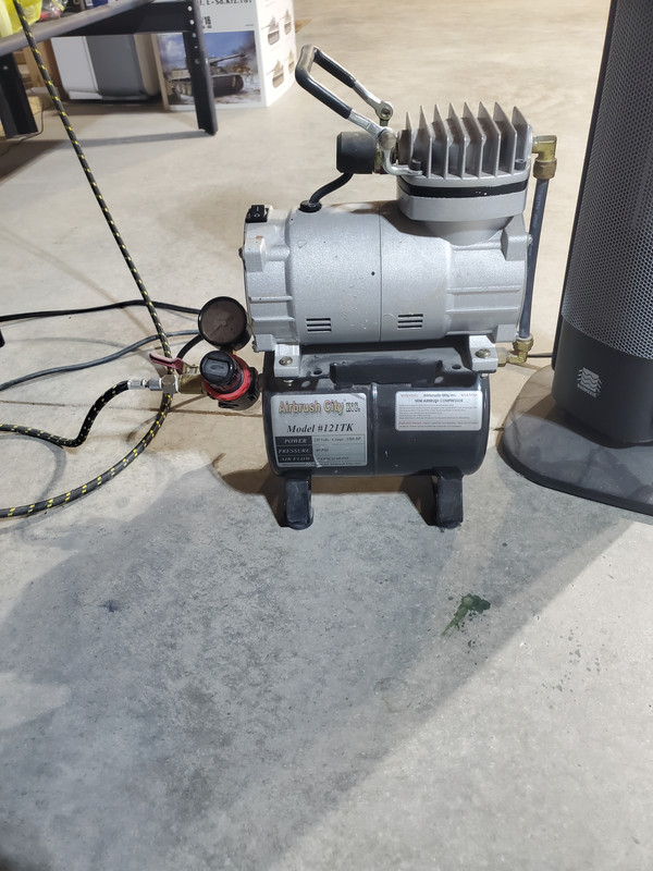

This is the compressor,it’s tiny,the “patch” is a plug of JB Weld the size of a dime on the very bottom of the tank,any blowout isnt going to do anything.
