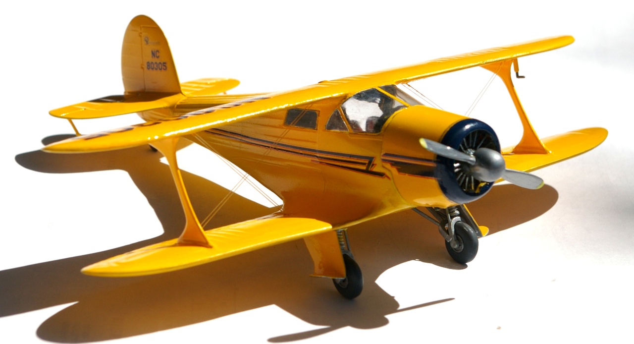

This is my AMT G17S Staggerwing incorrectly done up as a UC-43:
[CENTER]
[/CENTER].
I do have another AMT kit in my stash that will be built up as a stock Staggerwing at a later date.
