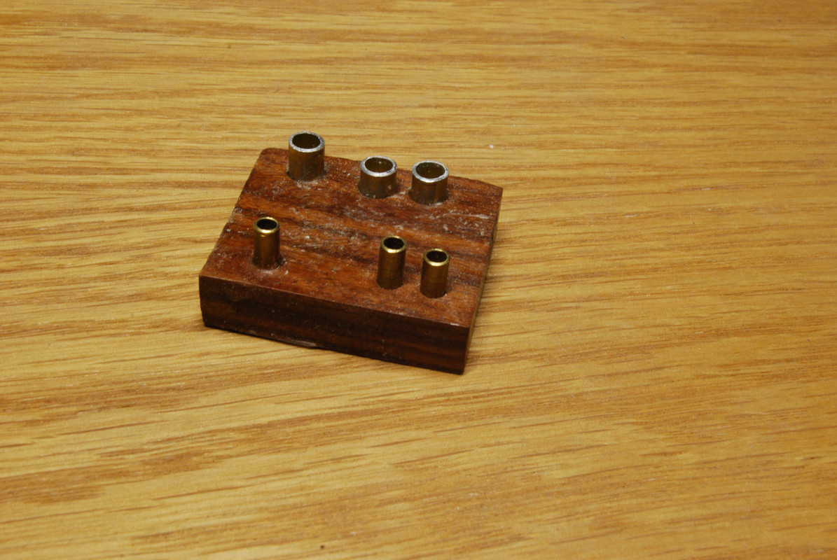

I reccently made a new coiling jig, and have been meaning to shoot and post it. I wii get right on that. It will do two sizes of simple coil and two sizes of figure eiight coils.

I promised to show my coiling jig but my computer when southfor a bit. Here is the jig.
There are two sets of metal tubing- the brass ones are 1/8 inch and the alumium are 3/16. In each set there is one standing alone, and a pair almost touching. The lone one is for a single coi, the adjacent ones are for a figure- eight tie-up. I use cotton thread ind dip it in thinned white glue 2 parts water to 1 part glue. After dipping I whith paper toweling to wipe off the fuzz. I then coil it and let it dry, with the figure 8 jig I simply cross cover eatch turnwhen ust abouut dry I take it off. Note the shiny and white color of the surface of the jig. I coat the matal withe wax before each session of use, I also tie a knot around the center of the eight of eight and let it dry further,
