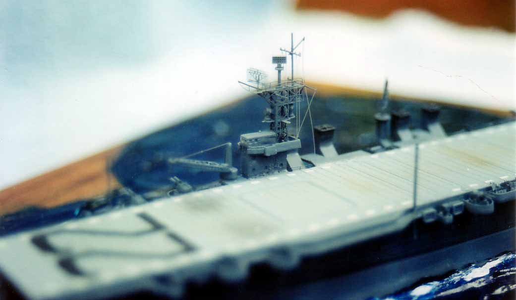

I’ve used nylon quilting thread, recommended by Jeff Herne (who also gave me the tips on how to do it). Here is a 1/700 USS Independence (CVL-22) with nylon quilting thread used for rigging:
