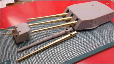

Ok here is something interesting why is it that the Revell Arizona which is 1/426 scales down to 1/400 scale that there are no aftermarket guns? and at least Tom’s modelworks and Gold Medal Models makes a PE set for it though.

No aftermarket barrels, like these from B&D Barrels?
scroll down to ‘other scales’
Thanks, Bondoman!
