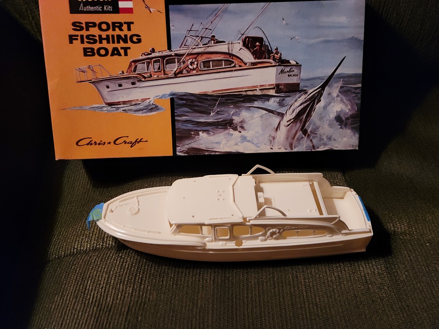

Hi,
I just picked this up off eBay at a pretty good price (I think) because it was missing a few small parts. I can’t wait to get started. I’m thinking of maybe adding a cover for the open bridge, and updating its color scheme to look a bit more modern, with maybe a Blue, Green, or Gray hull, and White deckhouse with blacked out windows, and window trim. For the underwater hull, I’m thinking maybe either light or dark Blue (depending on whatever color I make the upper hull, and maybe a White boot topping.
I’m thinking of also adding a swim off platform and door in the transom, so that it’ll probaly be a bit more of a cruising boat than a fishing boat. And finally I might add some planking to the open bridge and do all the decks in a light tan/Teak look.
Pat

Looks like a fun project.
That is Revell, not Lindberg
Oh Boy!
Revell was so wrong with this. This mold goes back to the fifties. It represents a Chris Craft Tri Cabin Motoryacht. They were never or rarely used for a Sport-Fishing boat. The Rear cockpit is to small for that in real life.
Now, that said, You can enclose the Flying Bridge area and create a style of boat you see many of in Northern California Delta waters. They are modified to be Live-Aboards.
The Tri-Cabins were usually 44 to 54 ft. long. They were intended for the boat owner to have his or her Quarters in the Aft Lower cabin. With an entry to the cabin from the Great cabin and the Aft deck area.
In reality Putting a walk through in the transom would not work. It would weaken the boat in following seas. They were designed to be coastal open water boats. Although it would be neat with the Wood style swim Platform.

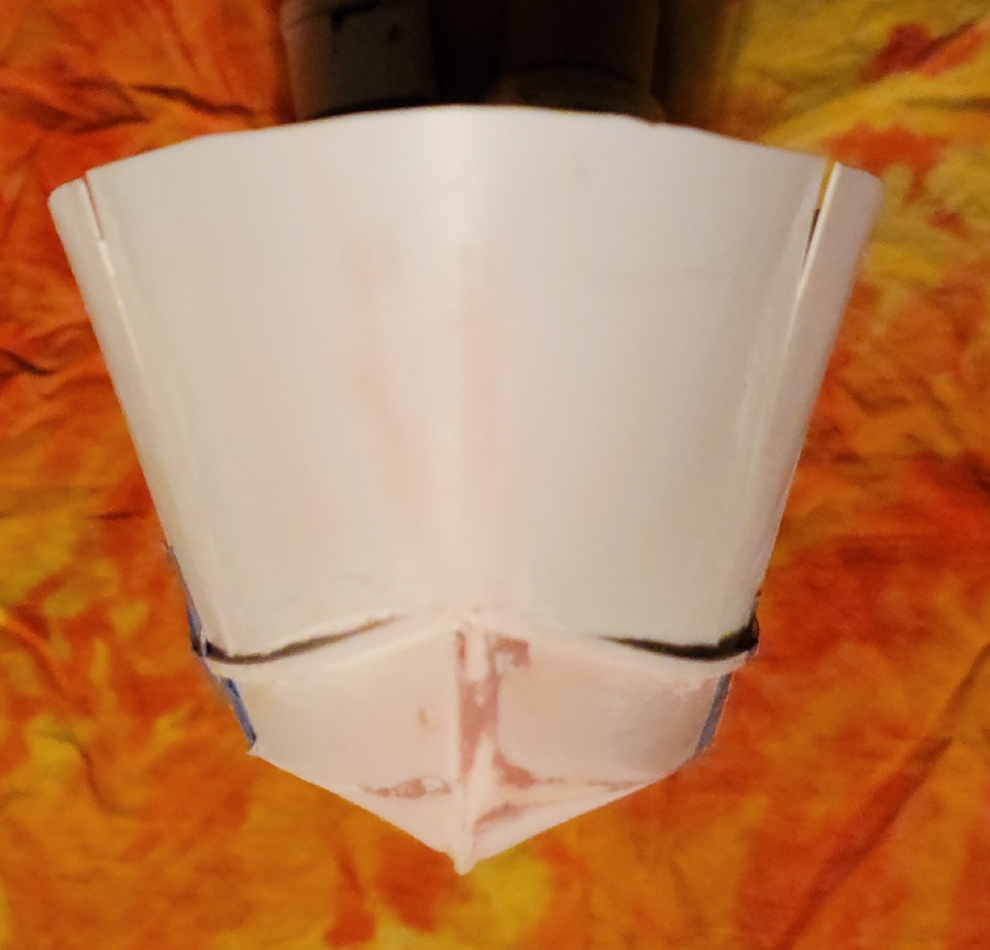

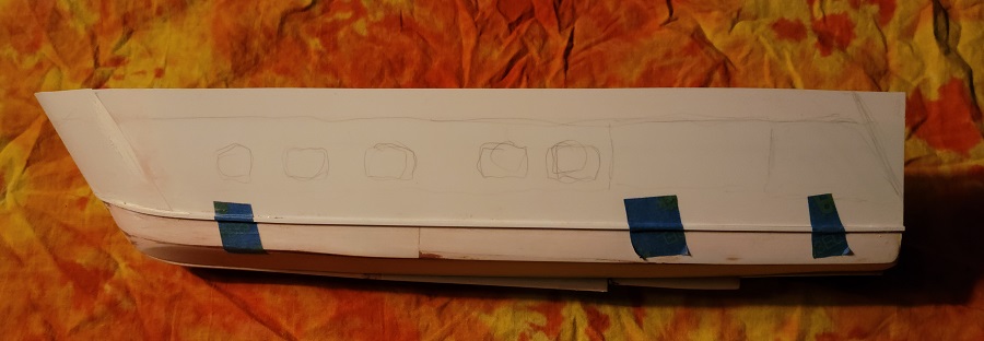

Hi,
I was able to find a second (complete) copy of this kit on eBay, so I decided to do a little kitbashing with this initial kit (that I bought knowing it was missing a few small parts).
Looking at the original boat, you can see that it is a bit short and stocky (Length overall/Beam overall of about 42/12.83 = 3.3 or so). I started thinking about making the boat longer, but noticed that for a lot of power boats the L/B seems to go up a bit as length increases. In general I noticed that for the hull, its bottom rake (slope) varies constantly over its length. However, I found that if I cut the boat roughly in half I could add some mid section while smoothing over any discontinuities in the bottom since the bottom slope/rake was very low in that area.
The next issue though was that I couldn’t really change the beam by much very easily, and that a beam of 12.83ft (or about 2.75in for the scale model) was kind of narrow for anything larger than the original boat size (of about 42ft). I began to realize though that if I changed the scale of the model a little I could make a model of a bigger boat without adding too much midbody.
In addition, I also realized the a larger boat would likely have a bit more hull depth, and that if I added some additional “strakes” above the existing top of the hull, the beam overall would go up a little more since the hull has a bit of flare in it.
In the end I decided on changing the scale to 1/87 (HO scale) as opposed to its original scale of 1/56 since my (semi-) local hobby store stoicks some model train related stuff in 1/87 scale (including platic ladders and railings) [:P]

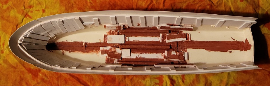

The pictures below show where I was earlier today, with one side modified, and the other still only partially done. One issue that I ran into was that when I cut the model in half I found that the basic hull was a bit asymmetric in shape with the sections being a bit concave on one side of the keel but a bit convex on the other side, as shown below.
Front
Aft
As such I ended up gluing a thin sheet of styrene to the bottom of the hull to etither side of the keel to try and hide this weirdness in shape and to also help hide any “discontinuities” or flat spots in the bottom of the hull due to the added midbody. In the end I also added a thin sheet of styrene to the modified sides of the hull too, to help clean up the relatively messing joints in the hull and to also add strength to the lengthened hull, as shown below (sorry that the images turned out a little fuzzy).
PortStbd
GThe 1st picture shows the port side of the hull with some strakes added on top to increase the hull depth and with its “outer plating” while the 2nd picture shows the starboard side before I added the upper strakes to increase depth and without its outer plating to make it look cleaner. In this second picture you can also see the inside of the prt side of the hull where I added the extra strakes to increase its depth.
I was able to finish up the starboard side today, but am still working to clean up the “styrene sheet” joints and such.
In general, I’m hoping to try and make something roughly similar to the boat in this link, but not necessarily exactly the same as that boat.
Pat

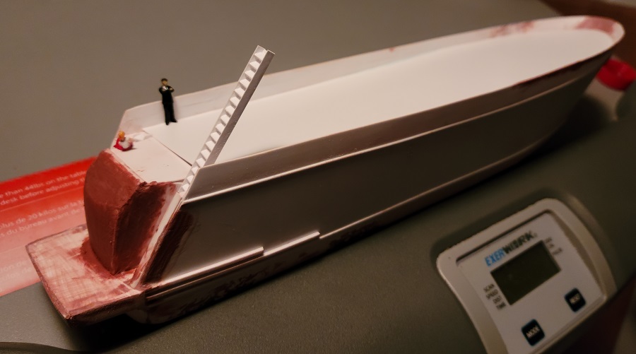

Hi,

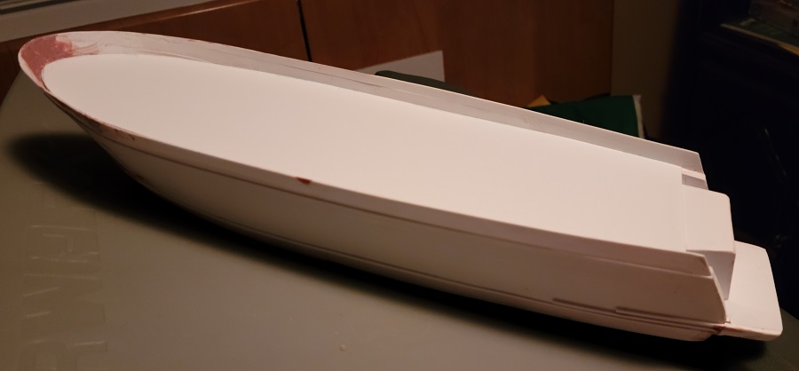

Here are some updates to the hull.
Side
Top
Front
Although the original hull looked to be a single chine hullform, when I initially rescaled it to a larger boat I hadn’t realized that the front end of the chine would look kind of low on the hull for the larger size. As such, I’m kind of modifying it a little to make it a double chine hull with a higher upper chine, while also trying to smooth out the front end of the lower chine a little.
Pat

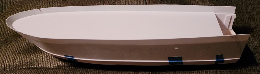

Hi,

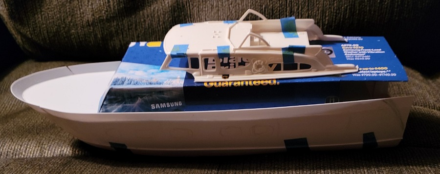

Here is a quick image of the hull with its main deck in place (though not glued down yet) and another with a quick mock up of a rough notional superstructure.
Pat

Hi,
Although it may not show it much, I’ve been making some progress on the hull. First I reinforced and trimmed up the deck edge bulwarks, better shaped the deck into the hull, added some rub rails, trimmed back the transom and added a swim platform, and a rough shape for a stern “garage” (that I hope to clean up a bit).
I also bought some small generaic 1/87 scale people to place on deck.
Regards
Pat

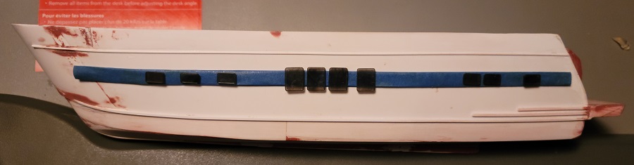

Hi,
I decided totry and print up some windows with my new 3D printer. The blue stripe is just the tape that I am using to hold them in place for now.
Windows
I’ve also printed some freeing ports/lines hadling openings for the bulwarks and have downloaded a 3Dmodel for an anchor that I hope to print later this weekend.
Pat

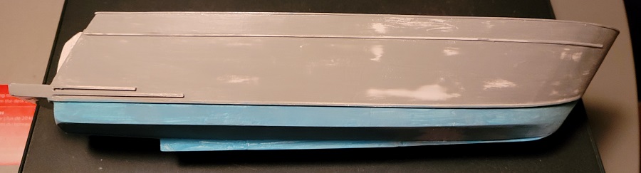

I’ve started messing around with some color ideas.
Pat
Yacht Paint
