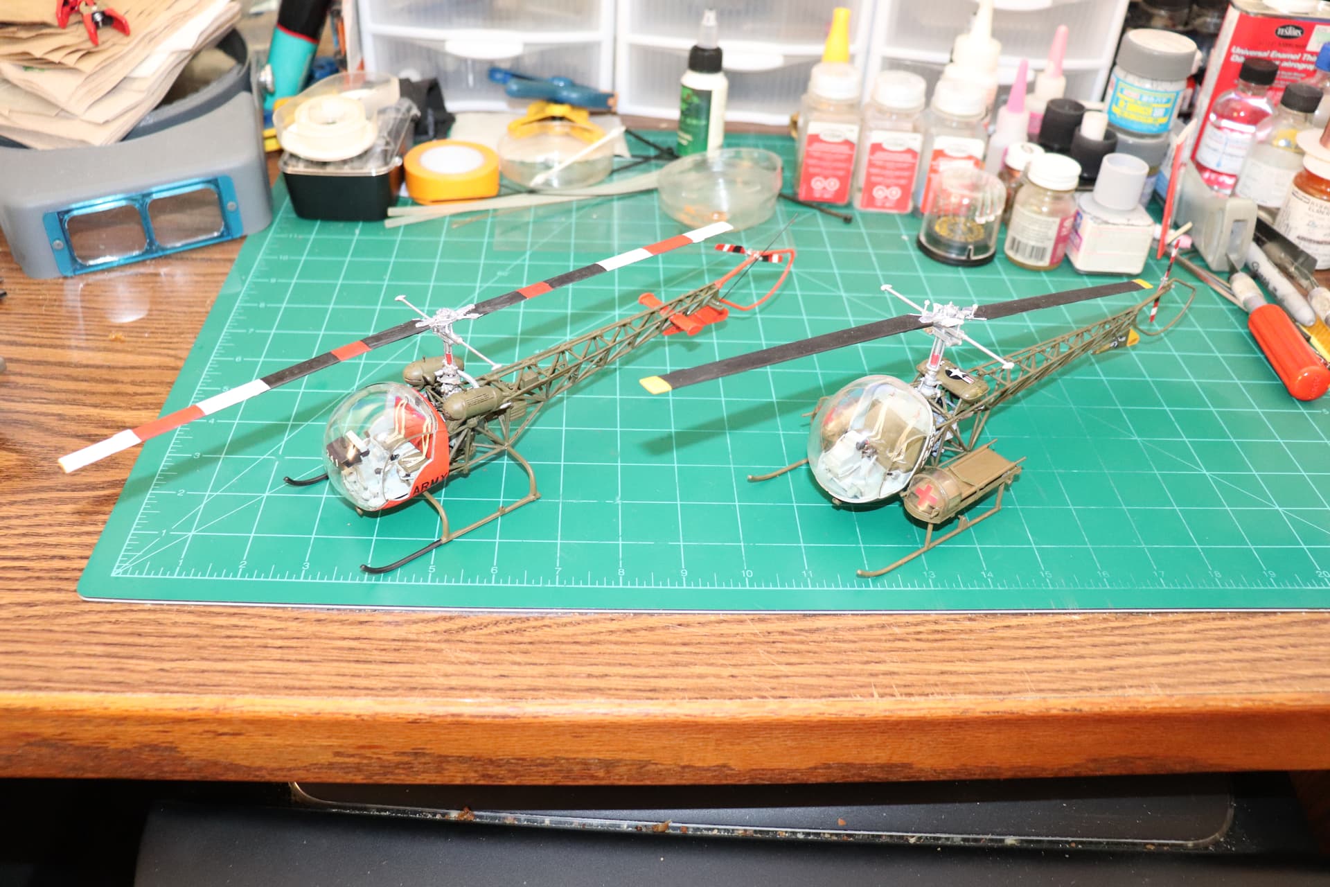

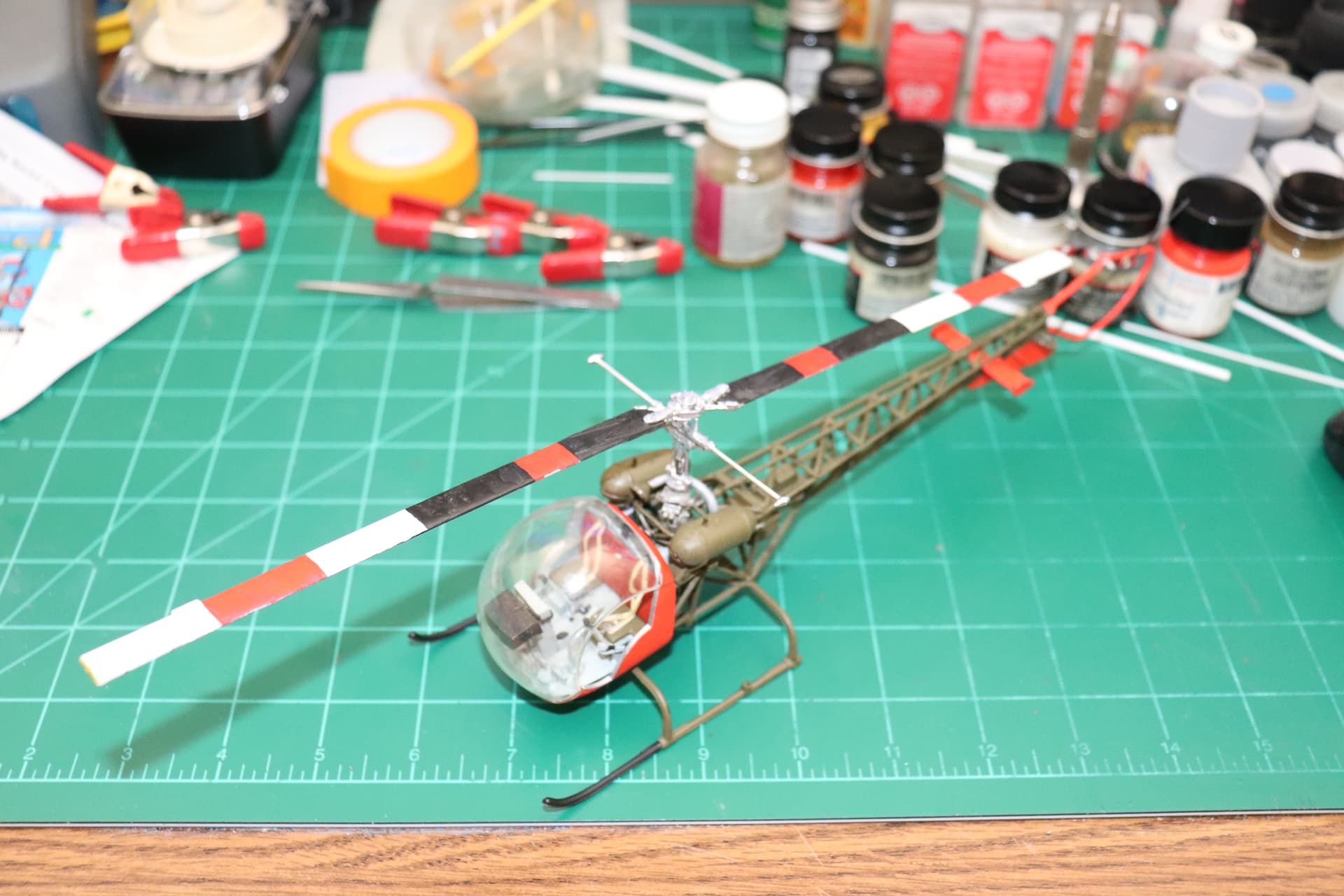

I just thought that it might be nice to show results of this helicopter extravaganza… I wound up with two birds…

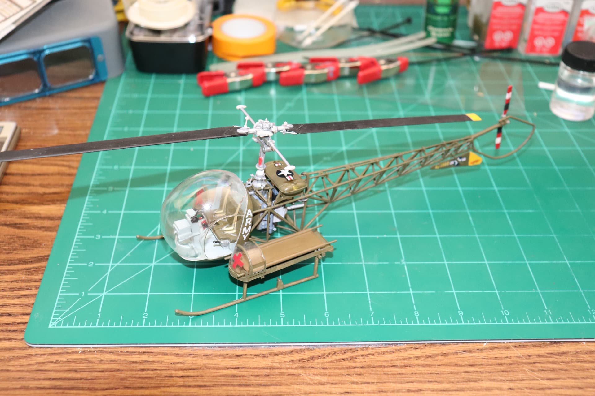

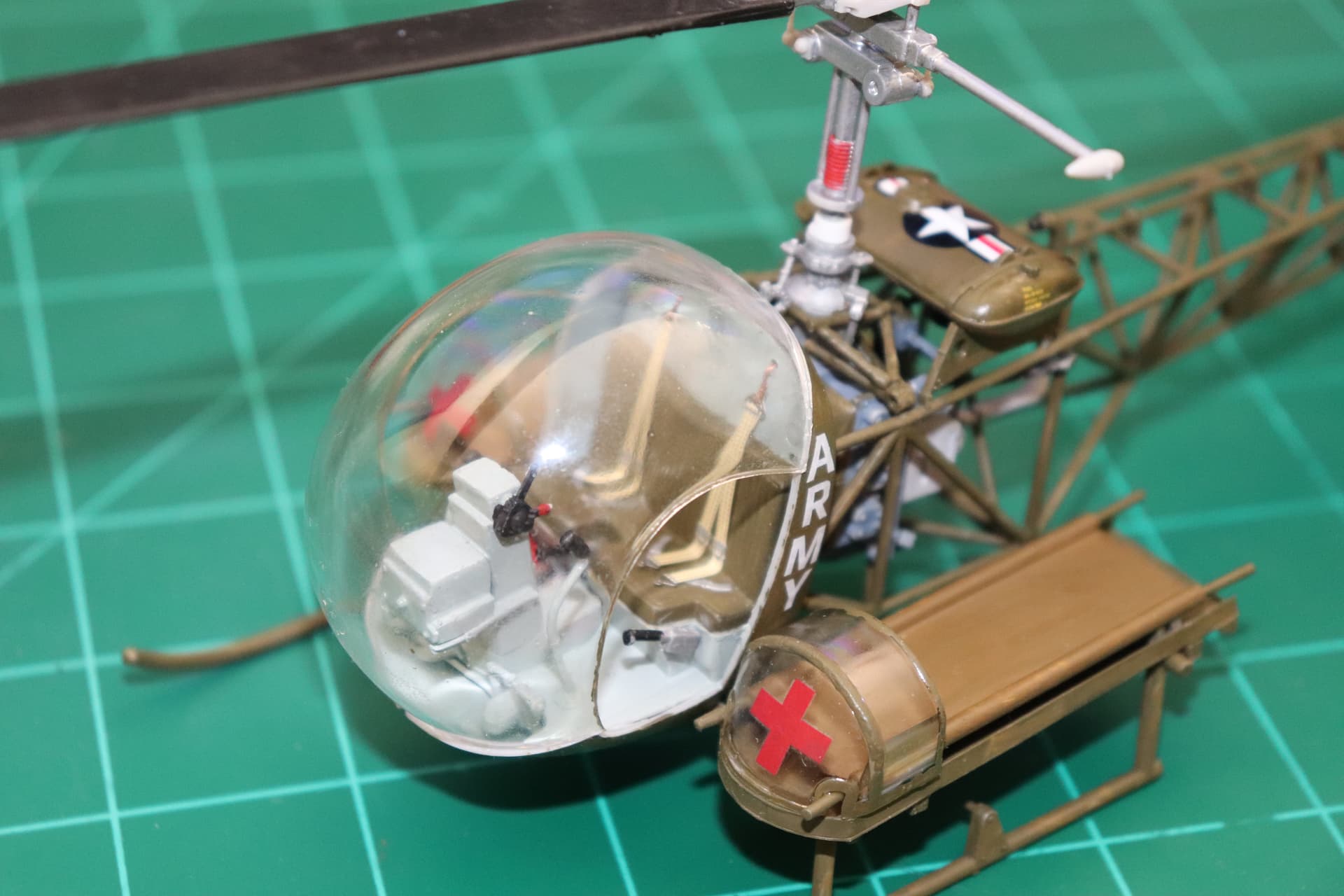

An H-13E Korean Medivac bird…

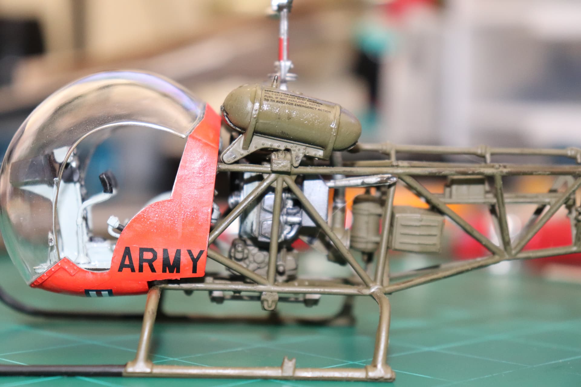

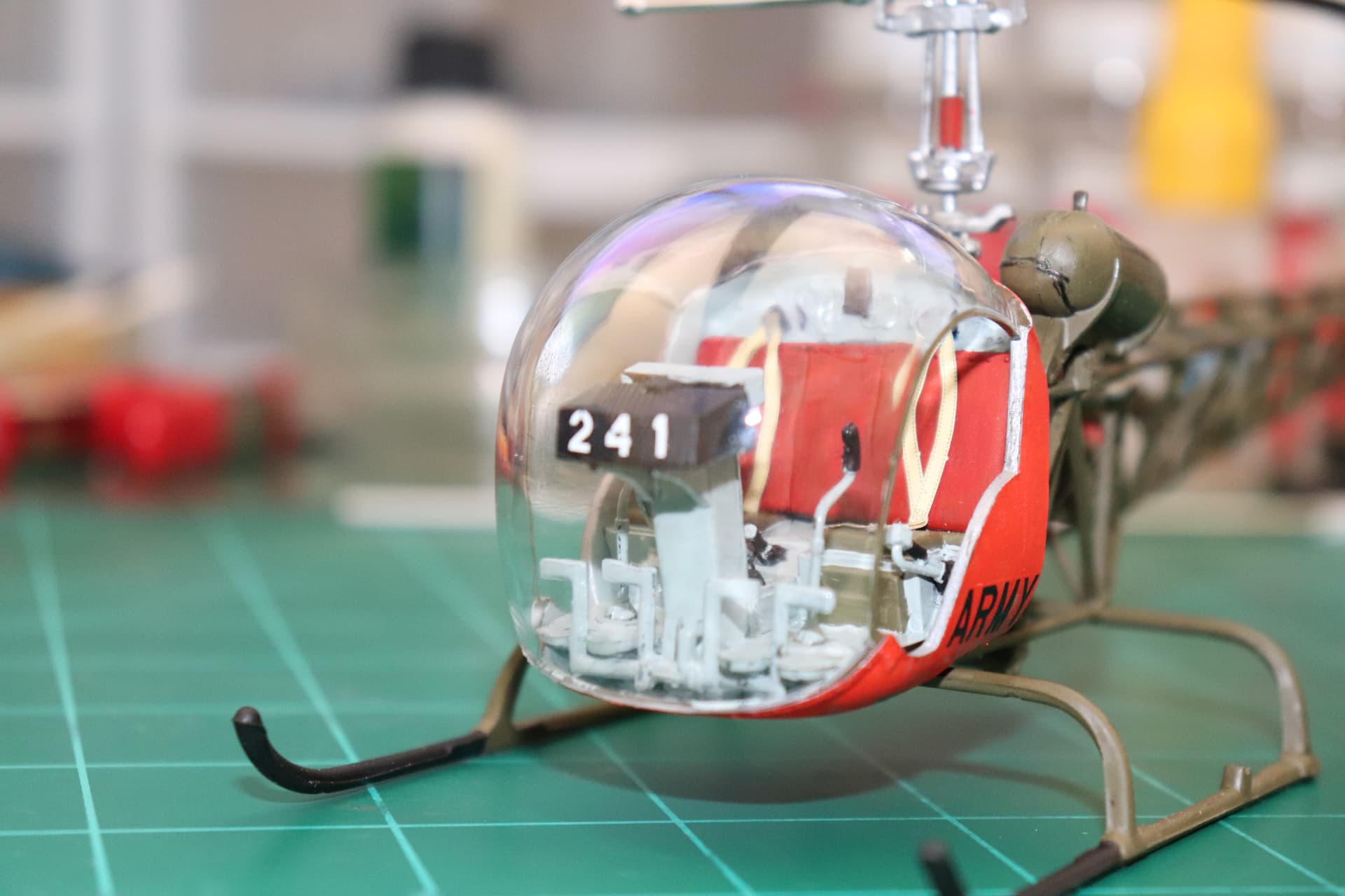

And an H-13H Training bird…

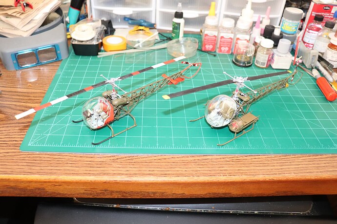

It was a two for one build so here’s both sitting complete…
I just thought you guys would like to see them…
EG
Best of luck on your OH-13H build. Can’t wait to see it!
Makes me want to get my “Shelf Queen” OH-13 kit off the shelf and start working on it again.
You thought right. They’re both 1/35, correct?
