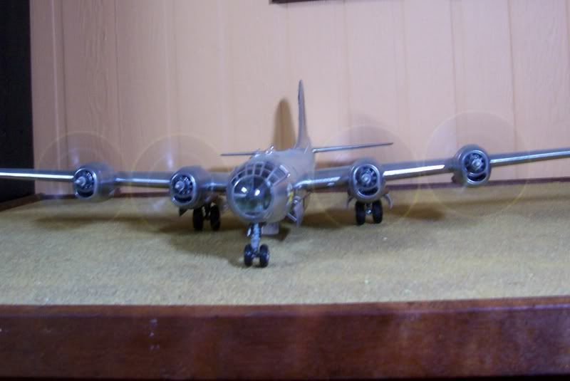

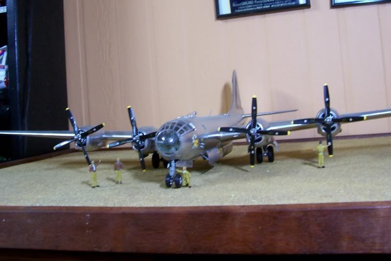

Almost finished mine. One of the original Monograms kits from the late 70’s. Just painting the canopy (fairly time consuming if you dont have an aftermarket mask for the canopy lines) I motorised it, with 4 x 1.5 volt motors I had lying around. the bomb bay houses the battery pack (2 x 1.5v) and the switch. I built mine with bomb bay doors open, to allow for battery changes and to hide the switchgear. If you build the Enola Gay or Bockscar versions, I wouldnt bother with the interior detail in the midsection of the fuselage, as you cant see any of it through the tiny peepholes which replace the perspex bubbles. It was an old kit I bought on e-bay, and the decals were garbage after 25 years - self destructed as soon as they hit the water, even tho I sealed them first. Natural Metal Finish needs a very clean starting surface and as dust free a painting area as you can get - every little speck looks like a boulder. Dont forget to put in plenty of nose weights - I used the space where the belly turret would have gone (I built the atomic version) and either side of the nose wheel compartment. A great looking aircraft which still draws attention 30 years after the kit was released - as long as you have the space.
Wirraway, you are right on the mark about the Superfort kit. Just finished my Academy " Enola Gay". Put in many many hours doing the BM finish. Probably the most time I have ever spent on any model with that type of finish and I have done quite a few. Your right about the weight. Need plenty of it, but whats nice is that their is plenty of space to conceal it. Like you said, no need to bother with anything other than the bulkheads for strength if it,s going to be closed up. A waste of time and effort especially the Enola Gay. That extra time and effort is better spent on getting a flawless finish. The paint masks for the nose glass area worked great. A nice crisp clean line. The aftermarket flattened wheels do it justice too. One thing I can say for sure is that I was never so happy when this thing was finally done, but when done properly it is well worth the time spent. I.ll post the pics when i get them taken.

As far as the extensive nose glazing I’m thinking of recreating what I did on project #2, and that is: super glue them to the fuselage. Work slowly though, don’t want to cloud the clear parts, and do one side at a time and let it dry thoroughly before doing the other side (tape one side while working on the other). Once super glued in place, sand away all the framing and buff/polish it back to clarity. This also gives you an opportunity to match the clear part with the upper portion of the fuselage, since there’s a slight step between them.
Recreate the framing using masking tape or draftsman’s tape (they come in several widths) as guides, then mask the clear portions, remove the guides and paint as usual. You’ll have seamless glazing - just like on the real thing.

I did this one for Col. Soltez who displayed it at the 504/509 BG reunion in Annapolis a few years ago then later gave it to Boeing when one of their execs saw it at the American Legion here in town. I helped him package it for shipment to the Corp. office in Seattle where I’m told it is now displayed. It was a good build but really, really big. The only other larger 1/48 scale model I can think of is the B-1. Of course the 1/72 B-36 is larger also.
