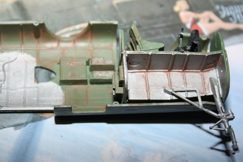

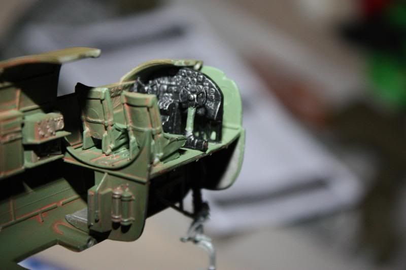

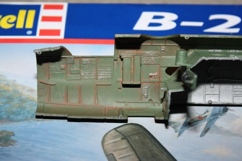

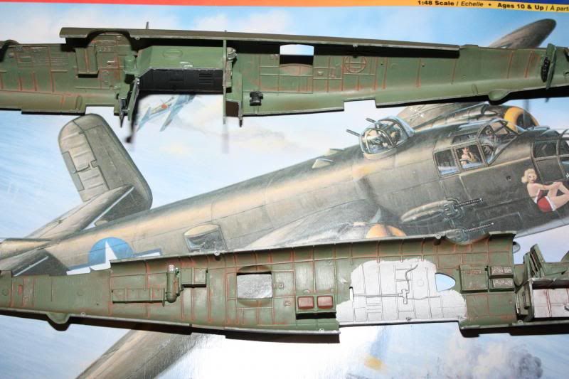

Started this a while and decided to pick it up again and finally finish it, tried my first pastel wash on the interior, hoping it came out ok. I’m not the best at modelling but I try my best. :smiley:
Still need to clean up some more, looking for any input. Thanks
Looking good. The cockpit is going to be a nice addition
Looks good. One suggestion, the wash might be a bit heavy, but I am not sure how it will look once the model is put together. You might want to try dry brushing a lightened version of the base color to tie it all together.
how did you apply the rust color inside the fuselage?
Nice work so far! FYI if you don’t know add lots of weight to nose its a real tail sitter.
I like the rust color…that came out well.
Thanks guys :slight_smile:
For the wash I did a dark brown compressed pastel chalk, ground up and mixed with water and some dish soap. It did come out a bit heavier than I wanted but once I clean it up a bit more it shouldn’t be too bad. I was going for this look: www.modelairplanebuilding.com/cockpit.html.
Would glued pennies be heavy enough? I did some test fitting and your right, this thing is extremely tail heavy lol
I would think pennies would work. But I’d imagine it would be pretty hard to hide them with the clear nose. When I built my B-25 I ended up packing lead weight in the cockpit area where it was hidden. If I recall I put some in the engines as well.
Lead fishing sinkers, lead shot, solder, or old tire weights provide the most weight for the smallest size. You can shape it with a hammer and secure it with CA glue. Lead is toxic so you shouldn’t be sanding, filing or grinding it and, be sure to wash your hands really well. The back side of the nose tunnel is a good place for some of the weight. Put the rest where the weight is on the real aircraft; In the engine nacelles forward of the landing gear.
On the other hand, the kit comes with a small step ladder that can be glued to the rear crew entrance hatch ladder or just placed under it. That will prop up the tail. I prefer to weight the aircraft, though.
