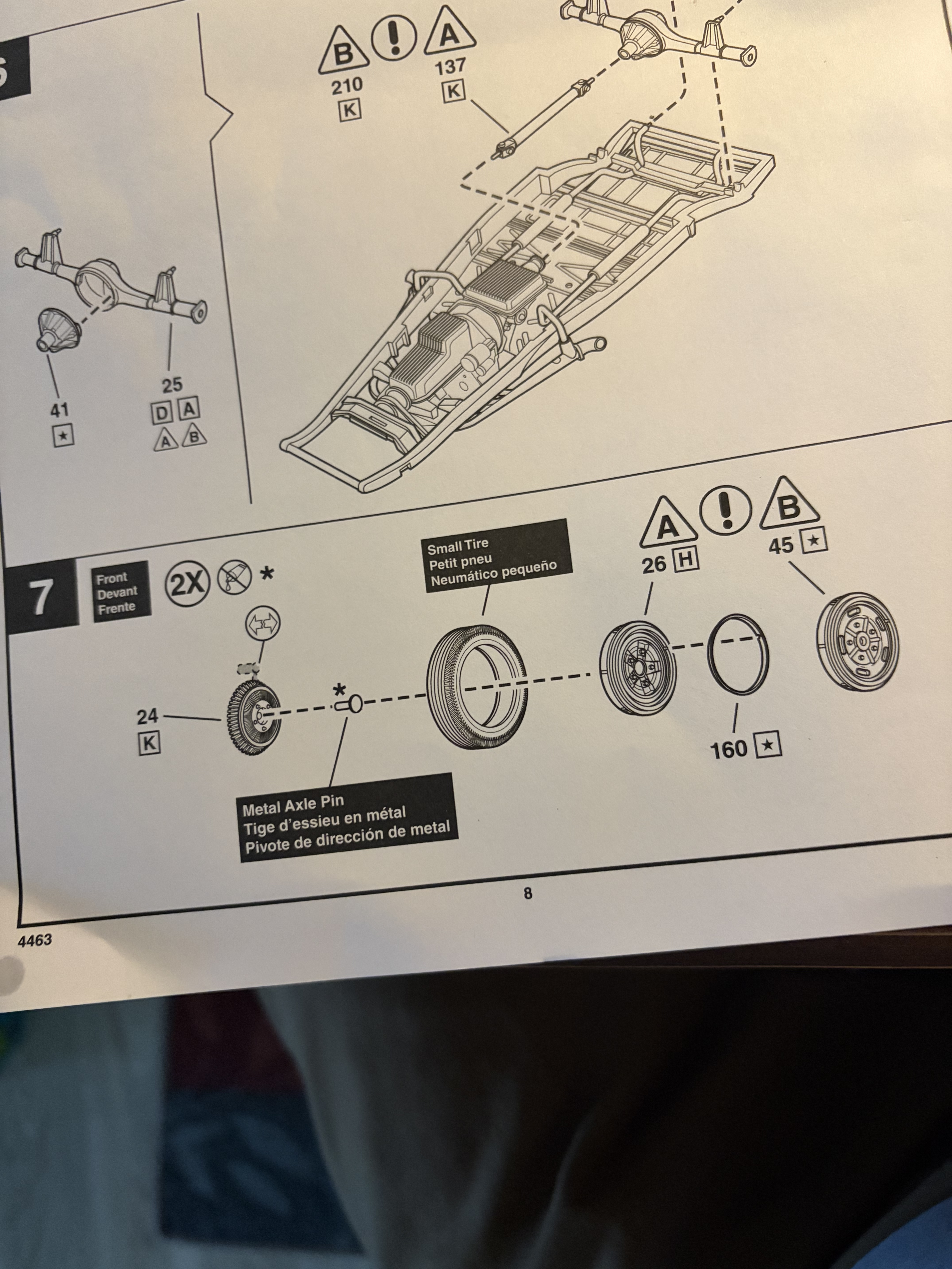

I am having difficulty following the directions for assembling the wheels for model “B” . I’m not using Part 26 for A. Am I supposed to use the ring (Part 160) between the rims and the rubber tires? Is the metal axle pin supposed to be glued to the inside of the rim? The pin is too big to go through the hole in the rim. Is the gear Part 24 supposed to be glued to the inside of the rim?

Part 160 is supposed to be a chrome trim ring. It is optional.
That little pin is not supposed to be glued inside the rim. If the hole in the backing plate is not big enough for the pin to go through, it needs to be drilled out or enlarged just enough for the pin to fit through it. The pin is supposed to glue into the front axle. It’s designed that way so that the wheels will still roll.
Yes , part 24 gets glued to the back of the rim. It’s the back half of the rim.
I hope this answers your questions.
Back again. The steel pins appear to be too long. I’m thinking I need to cut them in half for the front wheels. I’ve tried drilling the holes longer but there’s not enough length behind the original holes to drill very far.
Thoughts?
