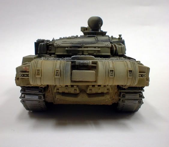

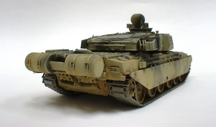

Revell 1:72 Challenger 1 Finished with pics

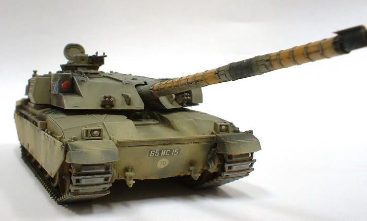

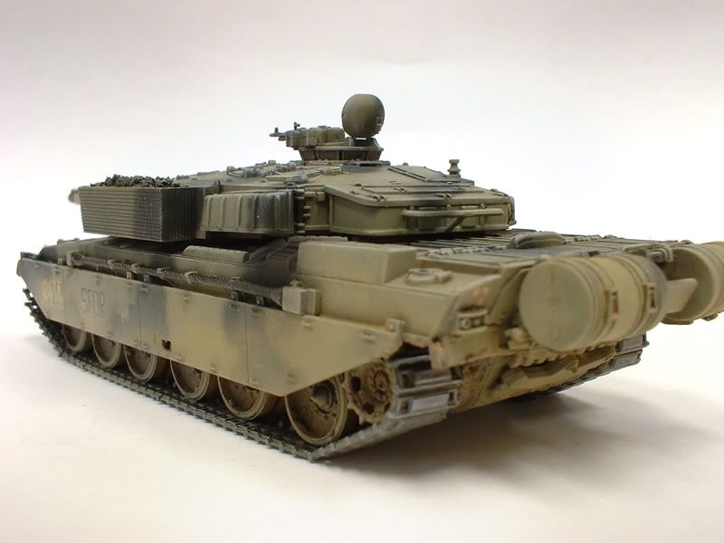

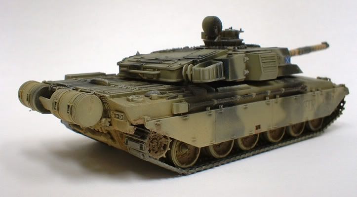

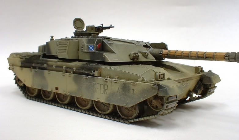

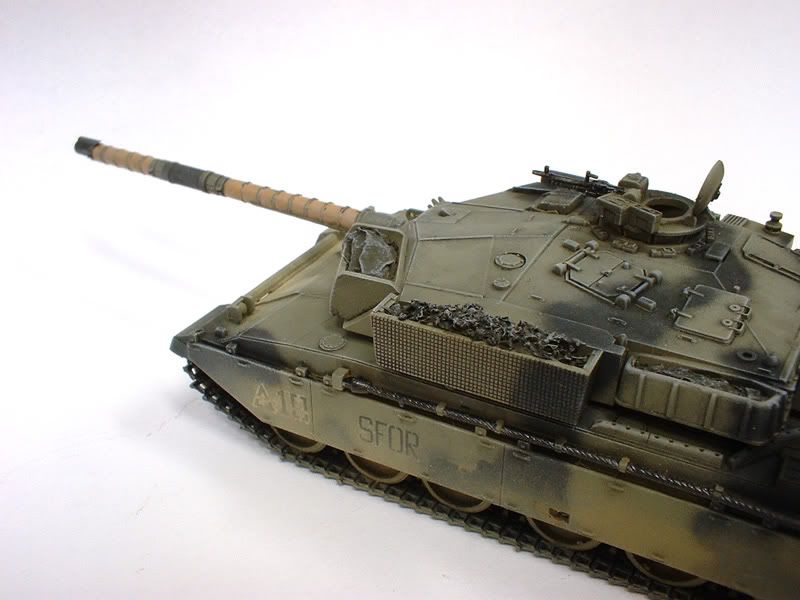

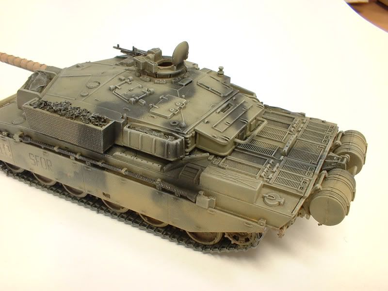

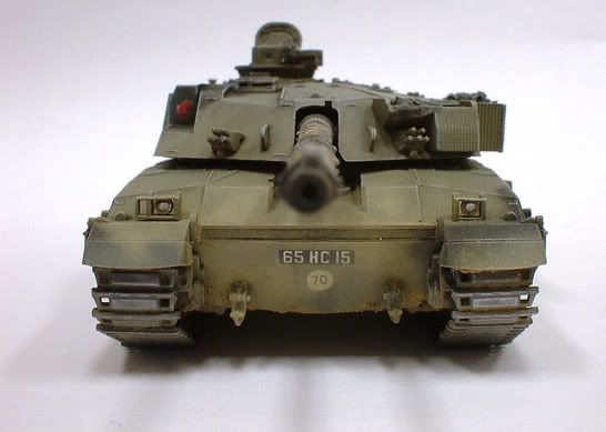

This is vehicle 1 of a 2 vehicle diorama I’m making, including a 1:76 Land Rover FFR vehicle… Its a very nice little kit, but not the best decals (or I stuffed them up). Two tarps and a camo net were added using tissue paper and white glue. The camonet is a tissue liberally coated with glue and the contents of 1 PG tips teabag. Painted using revell #45 light olive as a base, then Tamiya NATO black camo stripes. The tarps and camonet were painted olive drab. Next was a black and burnt umber oil wash, drybrushed with titanium white oil, dusted the skirts and rear with tamiya buff and wet-looked with tamiya smoke. The mud is tamiya dark earth with flour. The tracks were painted flat black, then drybrushed with gunmetal and silver, but then I re-drybrushed heavily with humbrol metalcote and buffed that to a sheen. Next up was a dusting with pastels.
Enjoy!

The lateral basket… you made with the kit piece or made another with a small net?

Thanks for all the kind words, folks. I can really recommend the kit.
Fabio: The turretbin is the kit piece, and for 100% accuracy might be better done with a piece of mesh and a styrene frame, however for me its accurate enough.
I-beam, these are link-n-length tracks, which look far, far better than any rubber bands I’ve ever seen. Revell’s tracks have really raised the bar. One thing though, next time I’ll start on the ground side and work up so its easier to hide any links that aren’t long enough or overlap. Neither was really a problem here though.
Saddler, Revell recommends their #45 light olive enamel. It seems to come pretty close, but could do with a tiny drop of their grey-green to darken it a smidge. By the way, I’ve never seen two pictures of any British camo job the same colour. Anyway, after a fairly dark black oil wash and other weathering, it comes pretty close to the picture you linked to (I think)…
Crockett, the basic trick is when you start to wonder if you need to do more, stop immediatly!
