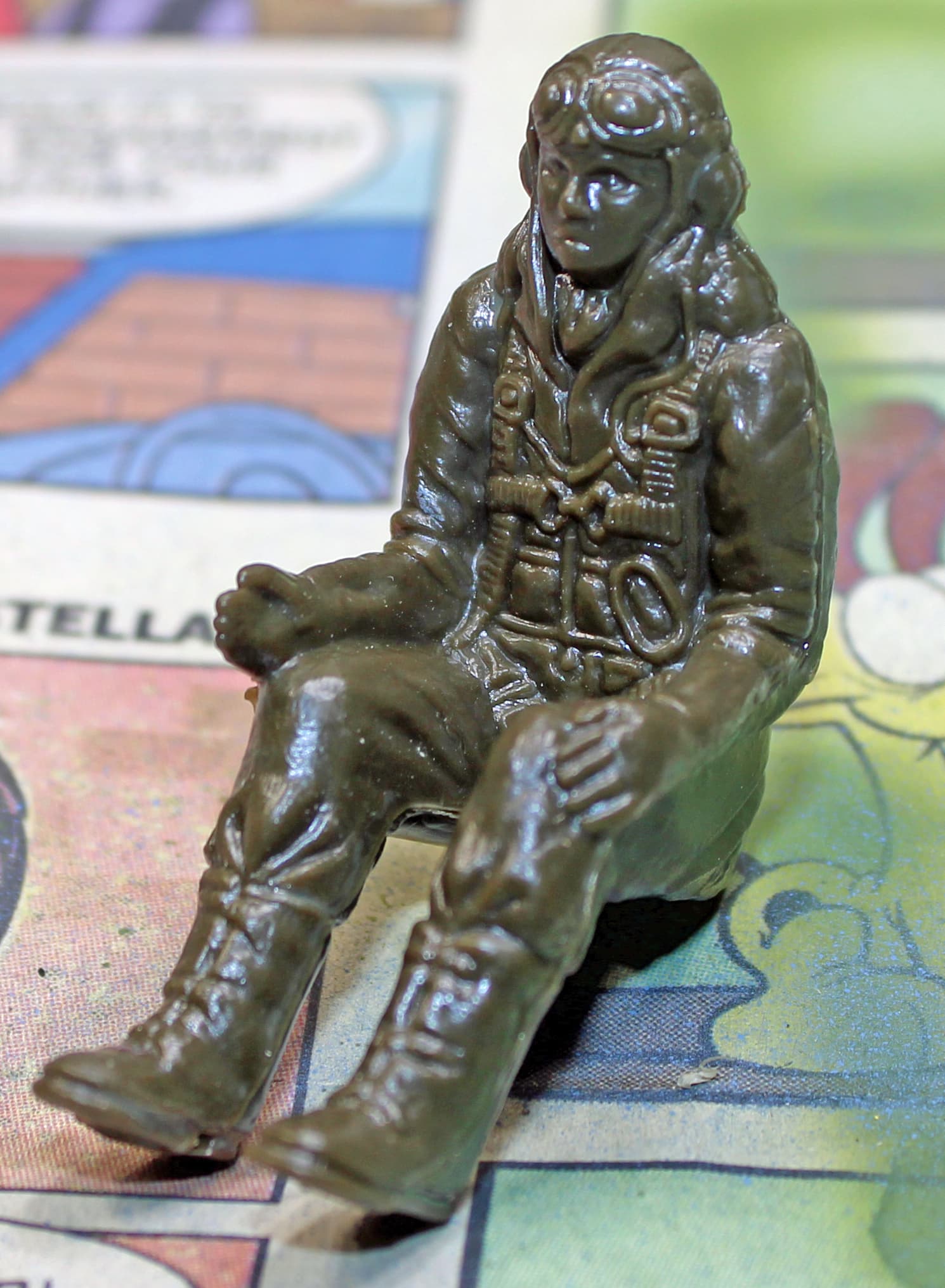

I plan to build this one wheels up and hang it from my workshop ceiling. I am considering the awful pilot figure that Revell used for all of their 32nd releases. I might very well use that figure, but I’ll add some white scrap material to represent Kelso’s scarf when he caught it in the canopy. Not totally on board with that right now, but it’s a good idea if I can pull it off.

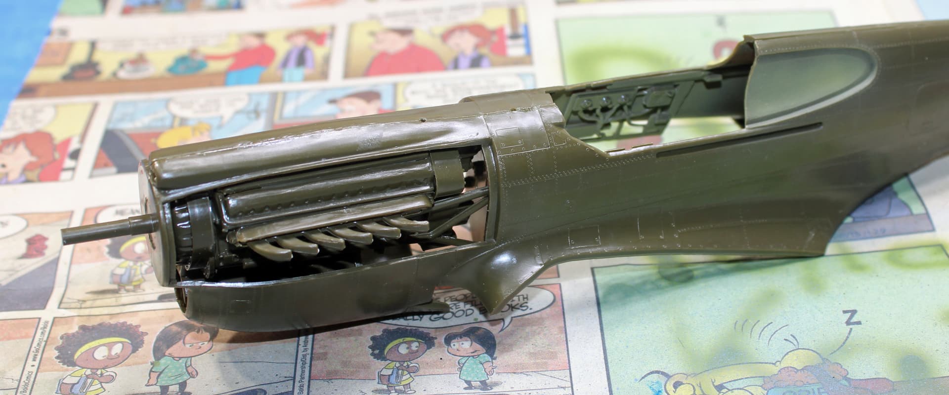

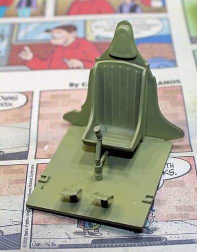

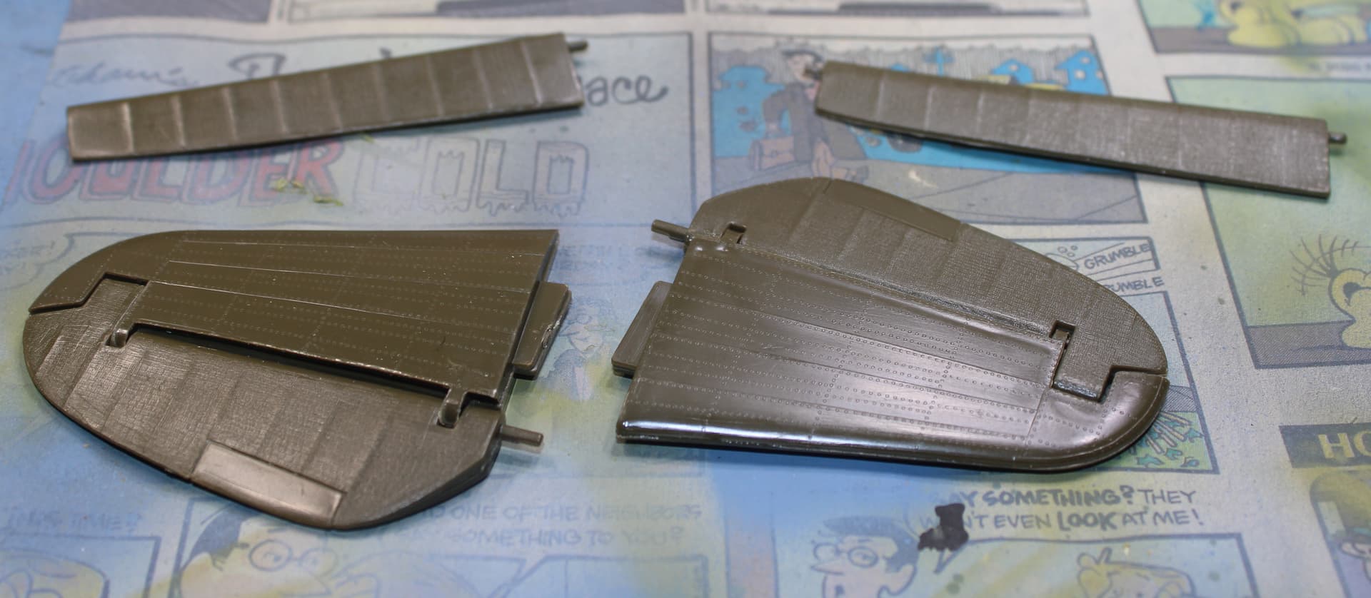

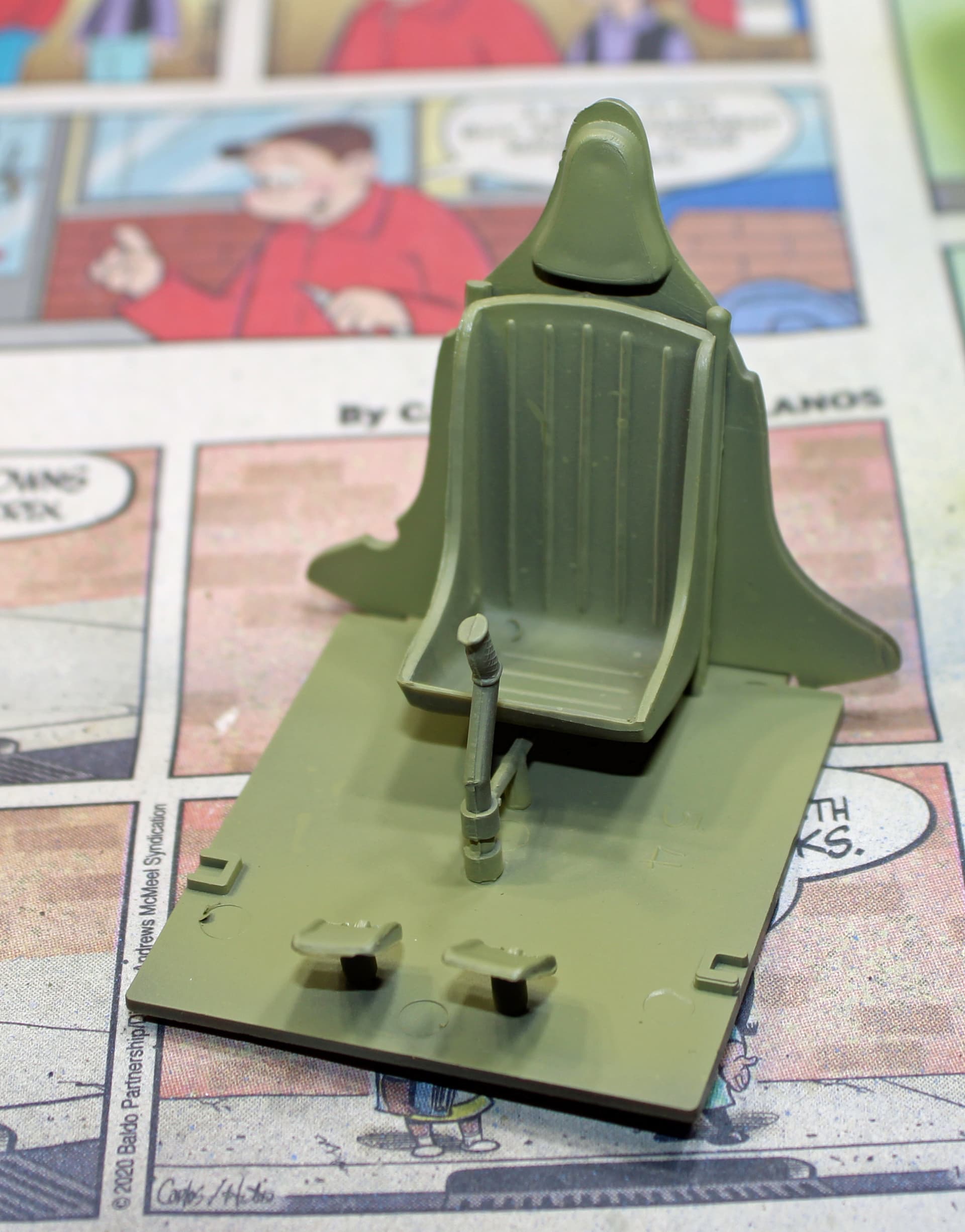

I once built this kit, complete with a hand-done paint job, in roughly a couple of hours. That’s not going to be the case this time around. But, I did get a whole lot of the kit put together yesterday, to include all control surfaces, most of the engine, the cockpit, gear doors put into closed position, and the fuselage closed up.
At lunch just now, I mixed up some AK Interactive Real Colors interior yellow green with olive drab faded and a couple of drops of neutral grey to approximate Curtiss interior green. I didn’t quite get the right ratio, but since this build will go on the ceiling and is intended as a quick build, I am going with the mantra of “close enough is good enough”.

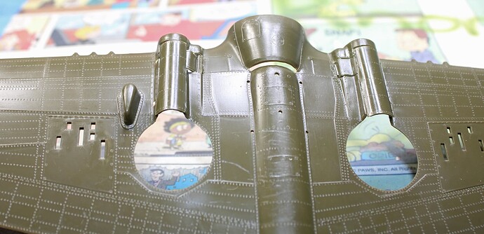

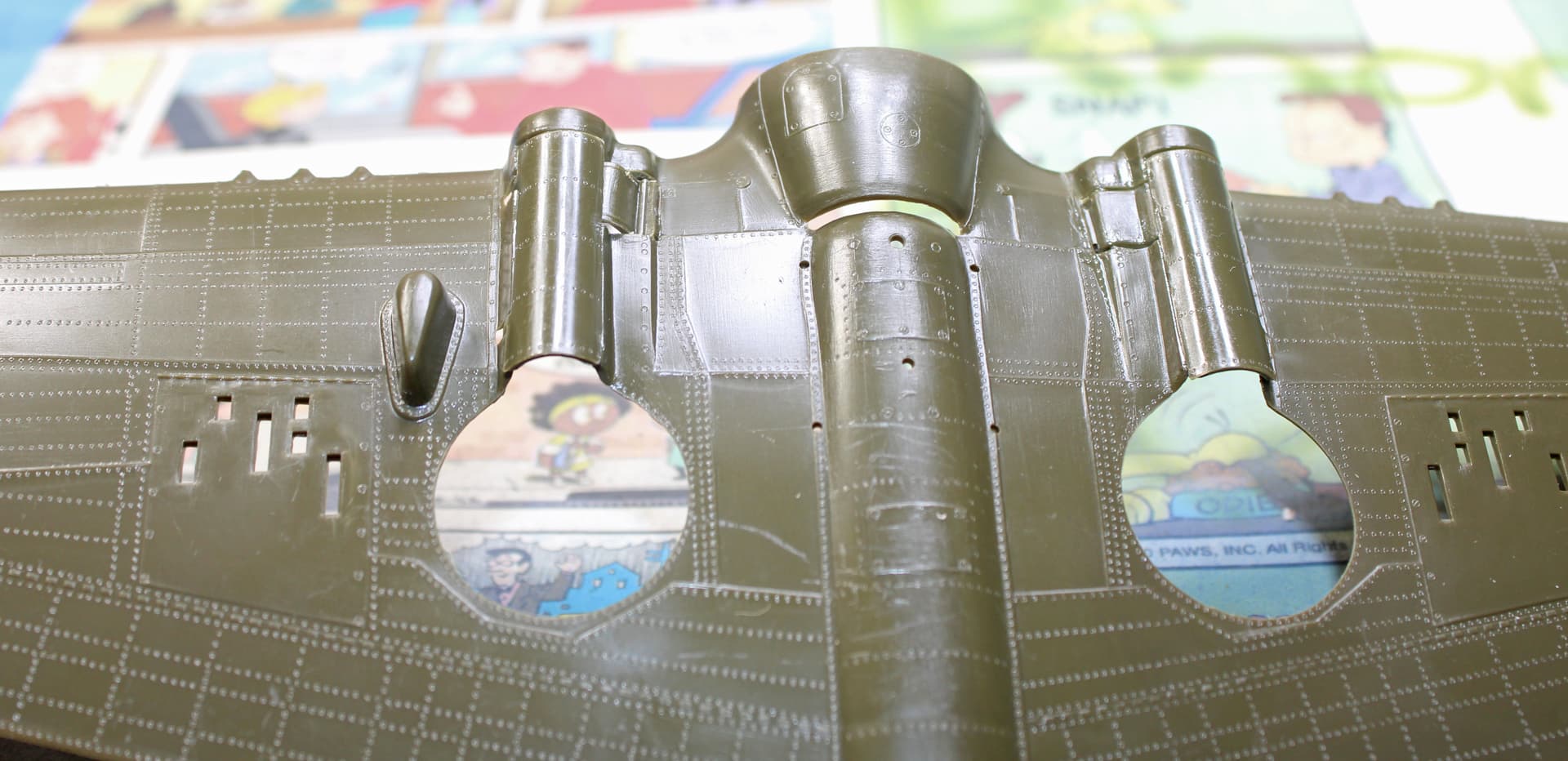

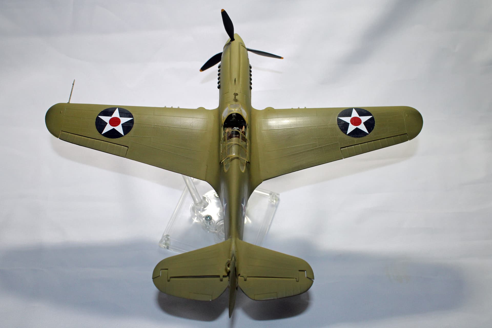

I’ve been away for a bit due to family stuff and work, but have been steadily making progress on this kit. The kit itself is not living up to my memories of having built it so many times in my distant past - lots of fit issues that when I was 10 simply didn’t faze me. This one is not going to be a museum piece; in fact, it never was intended as such. It’s really just a quick one to get me from one more complicated build to the next (an Italeri Short Stirling).

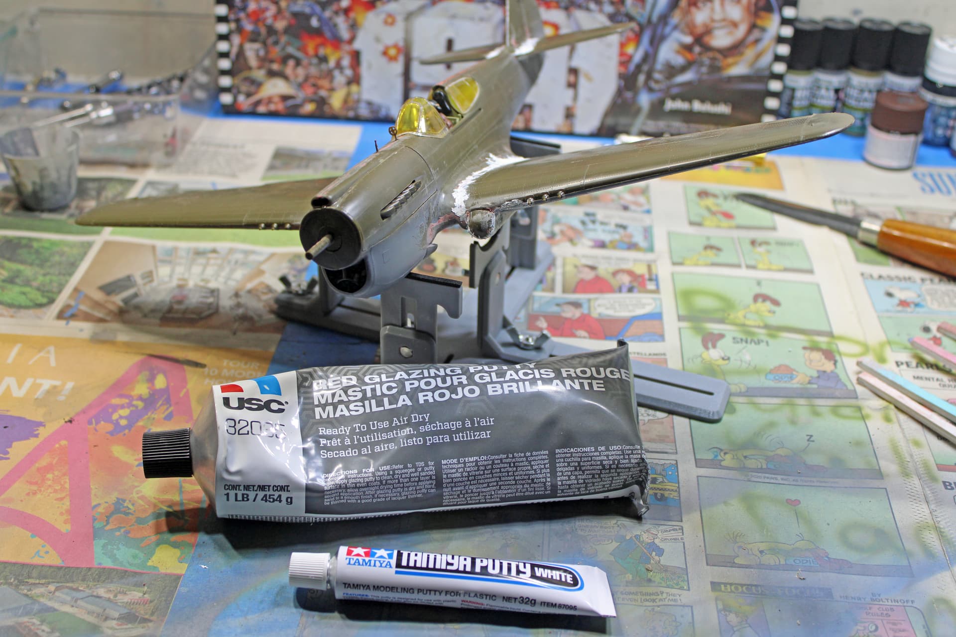

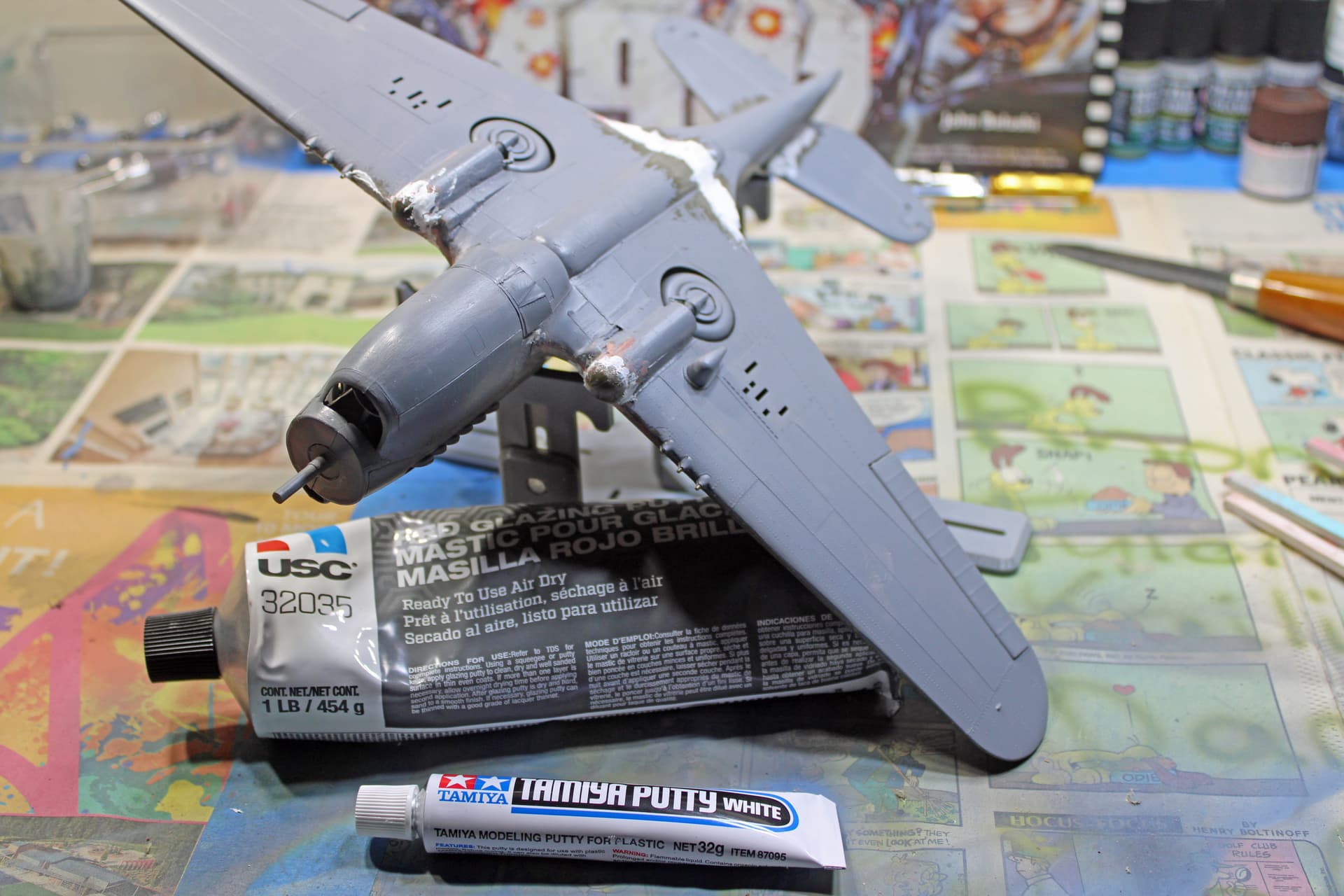

I haven’t kept up with photos, but I have a couple of additional pictures to add today. All of the primary parts are in place. I had painted the underside prior to adding the wing bottom, but quickly realized I would have to re-do much of that paint work due to the large gaps present in the typical areas for a vintage kit such as this. So today I dealt with all those gaps with first a layer of red glazing putty - let that cure and sand it smooth - then fill it some pock marks with basic Tamiya putty. That is now curing while the wife and I go see the new movie, Disclosure Day

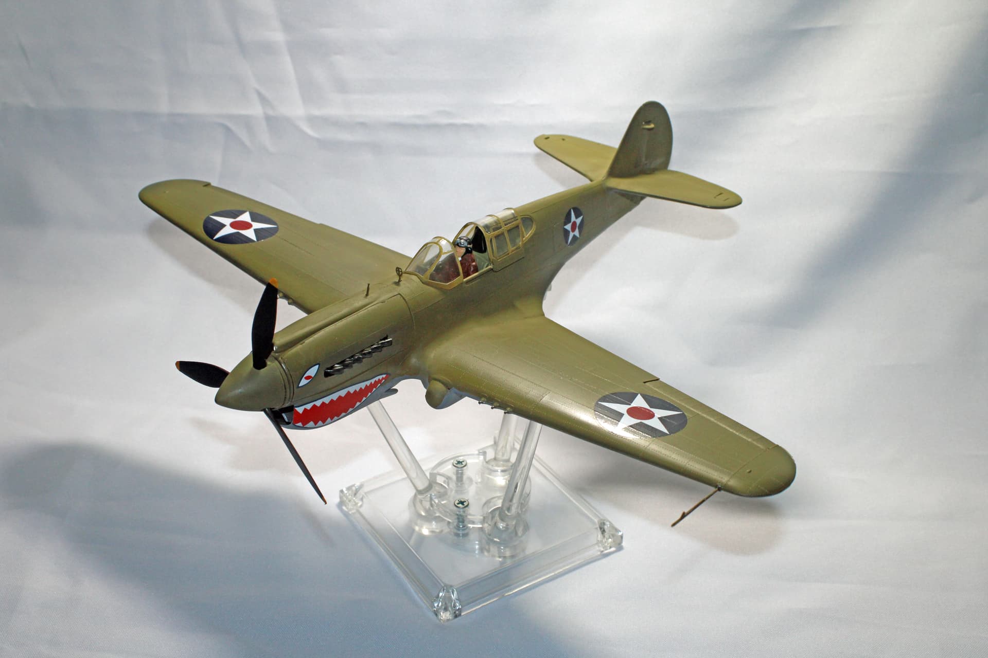

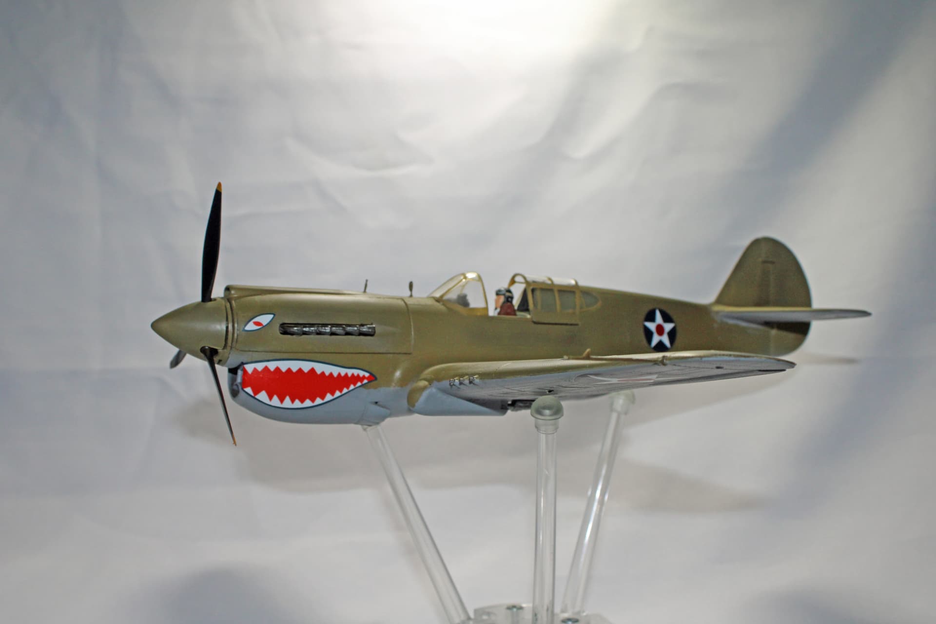

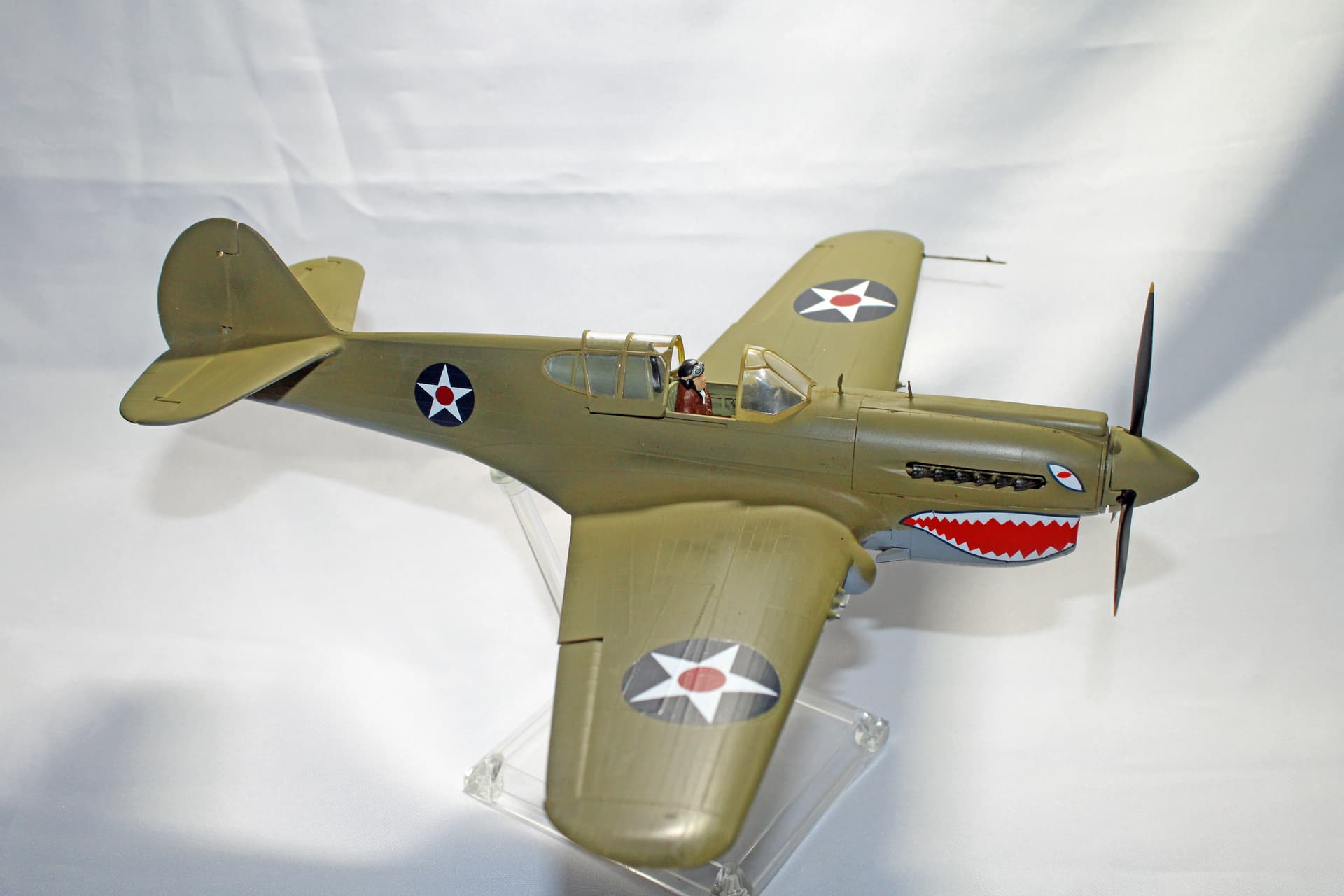

Calling this one done.

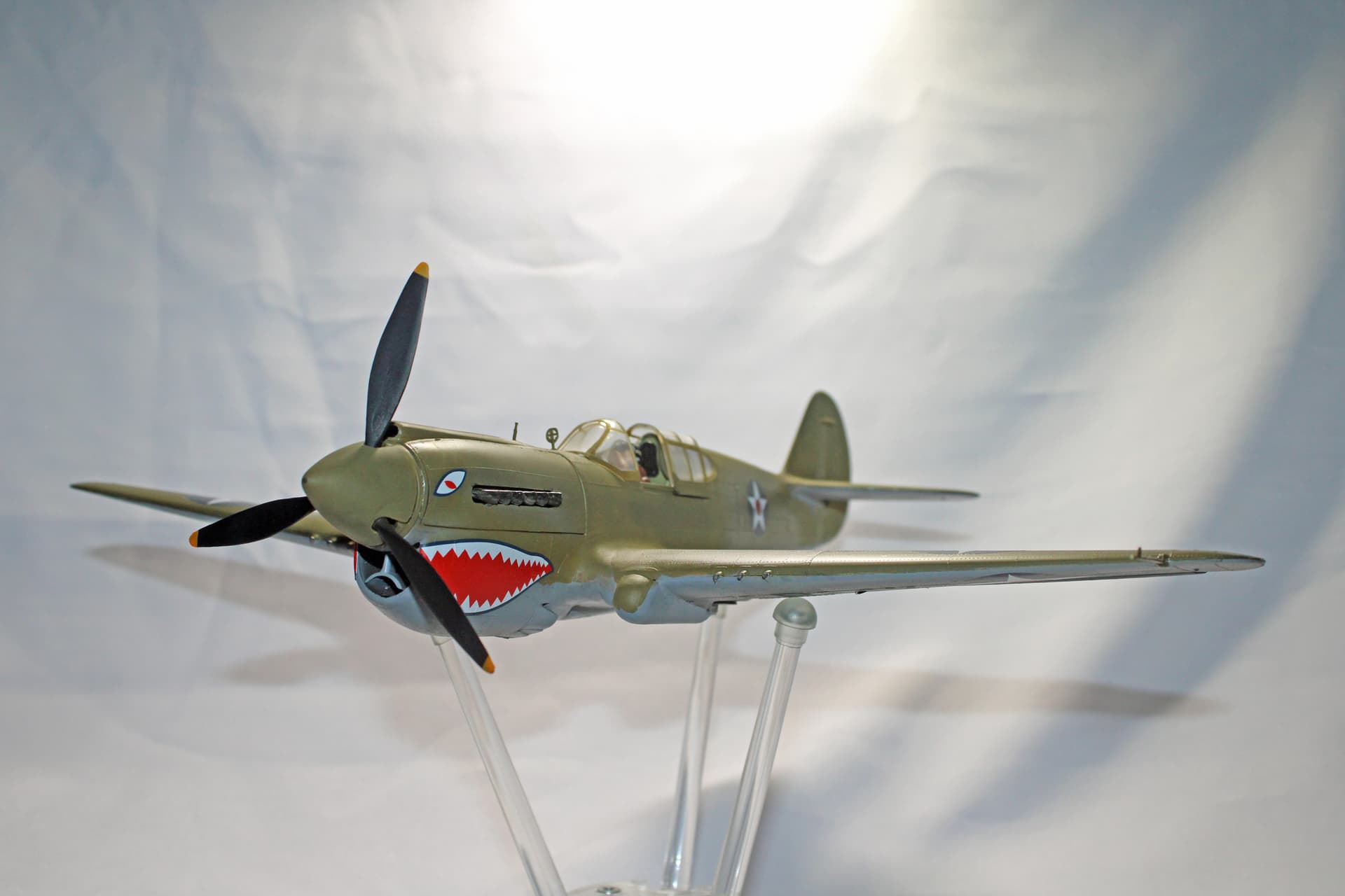

I spent the morning / early afternoon completing all of the paint work, which was essentially two colors - faded olive drab and neutral grey. I used some AK masking putty to form the demarcation lines and keep neutral grey off the faded olive drab. Semi-gloss black and orange-yellow for the prop blades/tips, and hand-painted the tires with rubber black, exhaust stacks with burnt metal, and gear struts with matte aluminum.
The decals are a mish-mash. The shark mouth and eyes are from the kit. For 47-year-old decals, they performed flawlessly. Yellow Wings Decals US insignia is the source for the 6 roundels (not reality accurate but film accurate). Finally, there is a US ARMY stencil along the underside of the wing. I never could determine if that was present on the filming P-40, but since I had one in my spares box, I went ahead and used it.
No weathering of any kind, mostly because I never detected much on the P-40 while watching the movie recently.
The kit didn’t live up to expectations formed decades ago, but I suppose I should not have expected it to. It fought me in a few areas, but a copious amount of putty seems to have won that particular battle. I have two more of these in the stash, but have no plans to build either any time soon.
Next up is another RAF heavy bomber, Italeri’s 1/72 Short Stirling Mk. III.

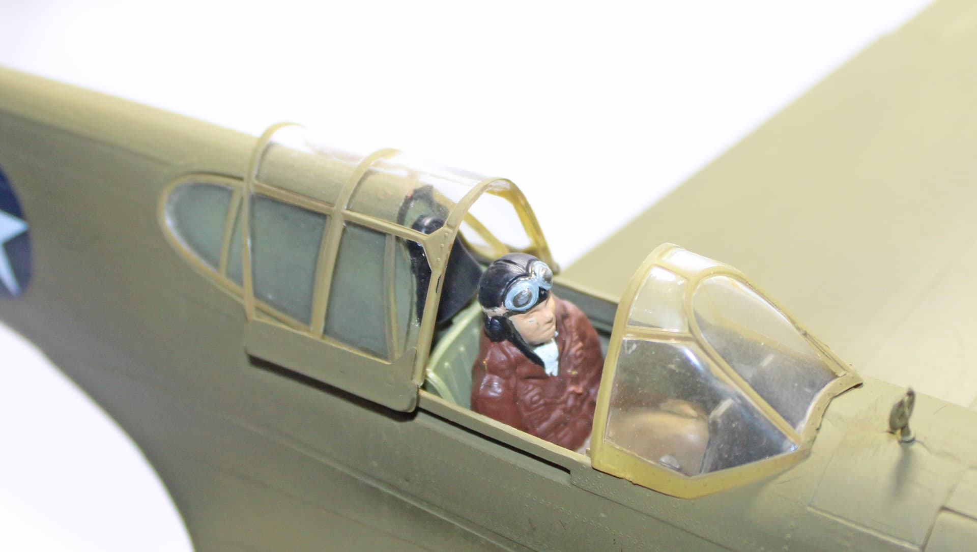

I did give that a lot of thought. I also wanted to give him the scarf that he catches in the canopy when he closes it, but that was going to require reconfiguring his position into more of a leaning forward stance. That probably wouldn’t have worked given that pilot figure is a two-piece hollow figure, so nothing would have been available to reposition against (solid insides). Then I forgot about the stoagie.
