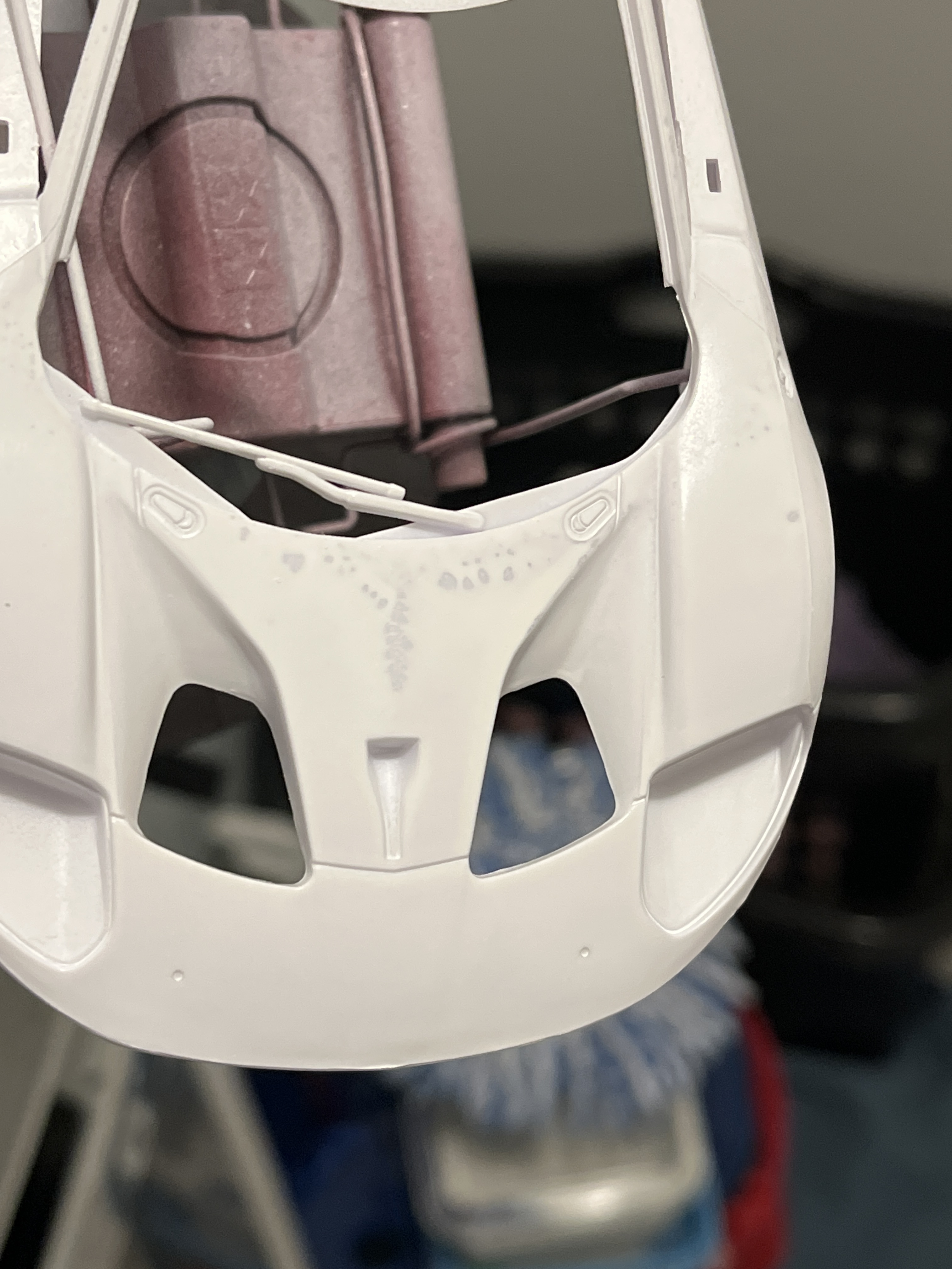

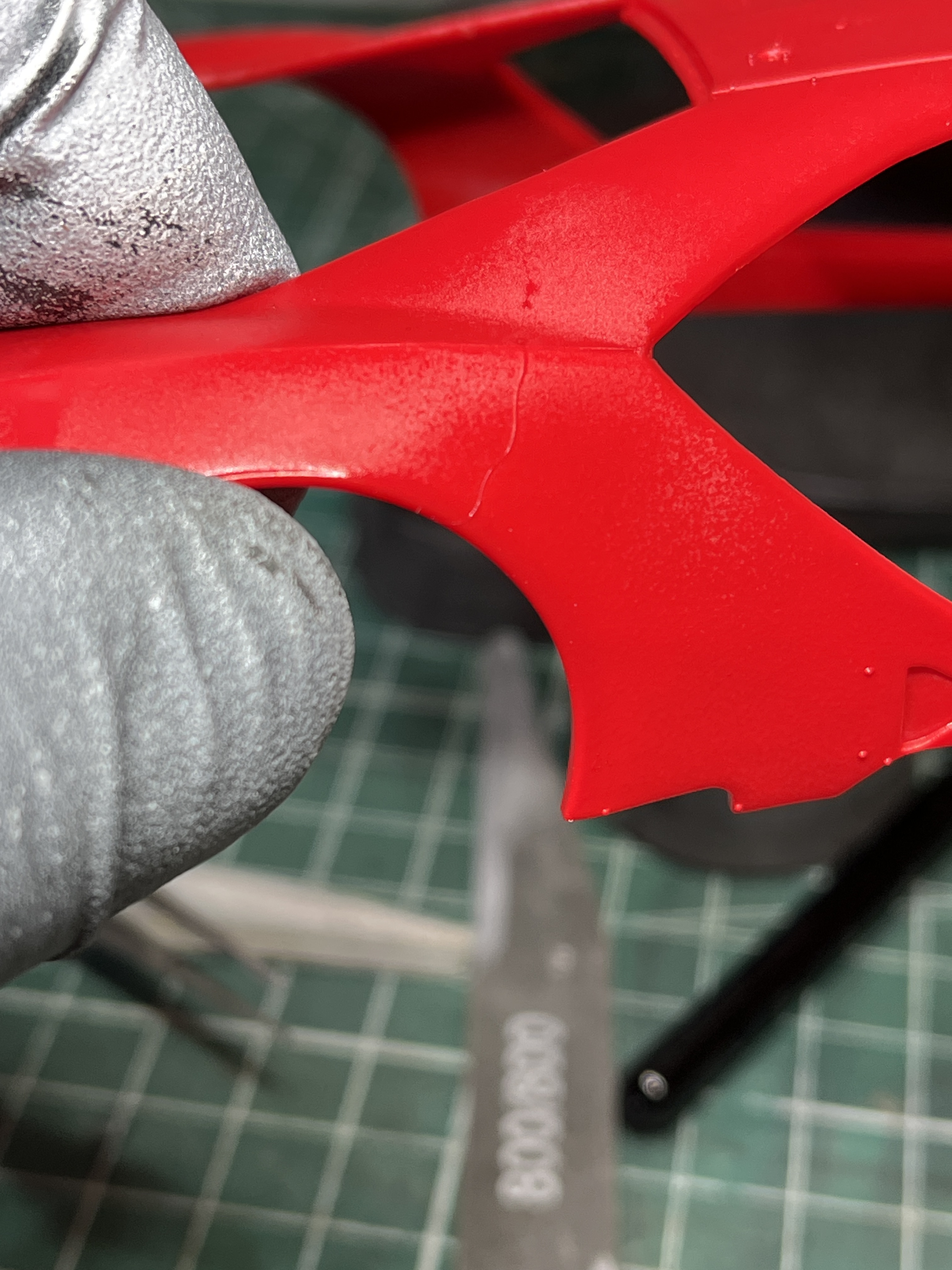

Paint finally arrived, and due to weather I had the day off, I shot the red with a few coats and looked at it a bit later, look at that!!! One of my wife’s beard hairs was stuck in the paint!!! Ok it was mine……( my wife really doesn’t have a beard…) anyways, pretty bummed out. I’m letting that sit and I’ll sand it down this weekend. But I figured I’d shoot the white as well and….well… it beaded up in a few spots. What a day. This is my second go with Polly paint and I read that priming wasn’t necessary, maybe I read that wrong, never had any issues with acrylic or enamel beading up but I always used primer. Maybe too thick of a coat?

Ok so did I bit of reading which I should have done before hand but the Tamiya polycarbonate paint is specifically for lexan bodies, well damn. Lesson learned. A bit of a setback but salvageable non the less, I’ll get the correct paint coming and work on sanding the body down. But I’m glad I started looking into it even though it was too late because I almost shot the duster body with it as well.
Oof, that is a setback. Sorry to hear of the paint issues. Persevere!
I noticed you said sand off. I assume that since it’s not an acrylic, you can’t just use alcohol or some other solvent to remove the paint without risking the plastic, eh?
That’s a good point, I’ll have to look into that. That’s what I get for venturing out from my normal acrylic and trying something new without reading up on it, anyways thanks for bringing that up I hadn’t thought about that.
I know I’ve used Pine-Sol to remove Enamels in the past. I remember seeing people using Power Purple and even oven cleaner to remove paint. Any idea of what kind of paint that stuff is?
It’s a “ solvent based lacquer “ is what I found on the web. And it’s made to bind with lexan, says it will straight up melt plastic models so I guess as of right this moment things are looking pretty good for me giving what I did :grin:

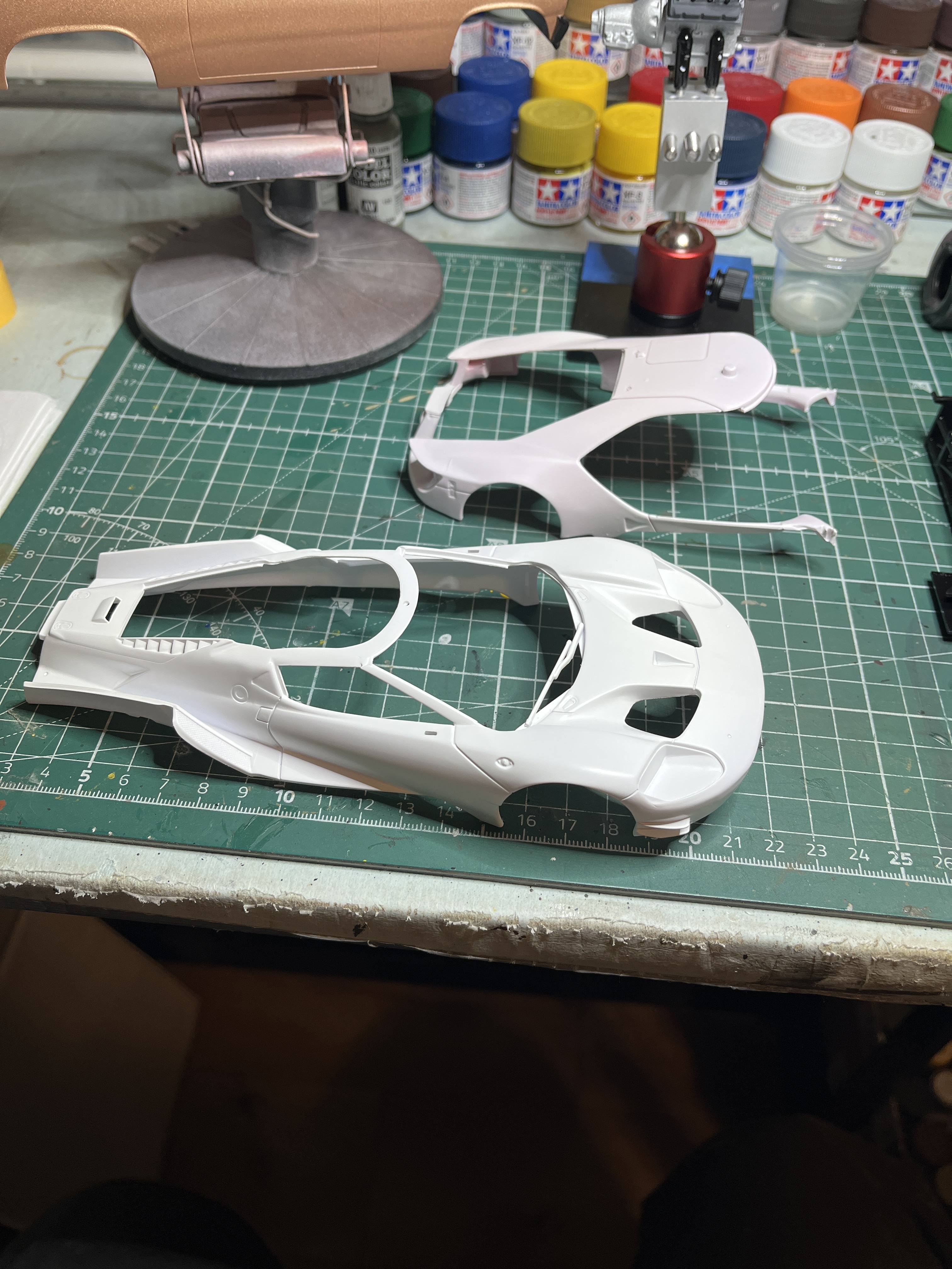

I didn’t bother trying to remove the paint, I wet sanded it starting at 1000 and down to 3000 then sprayed it with tamiya fine primer. So far so good.

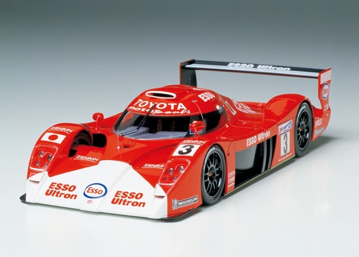

Great kit, and wonderful progress Demo… I almost purchased that kit, but went with the kit below. Looking forward to seeing the end result of your work.

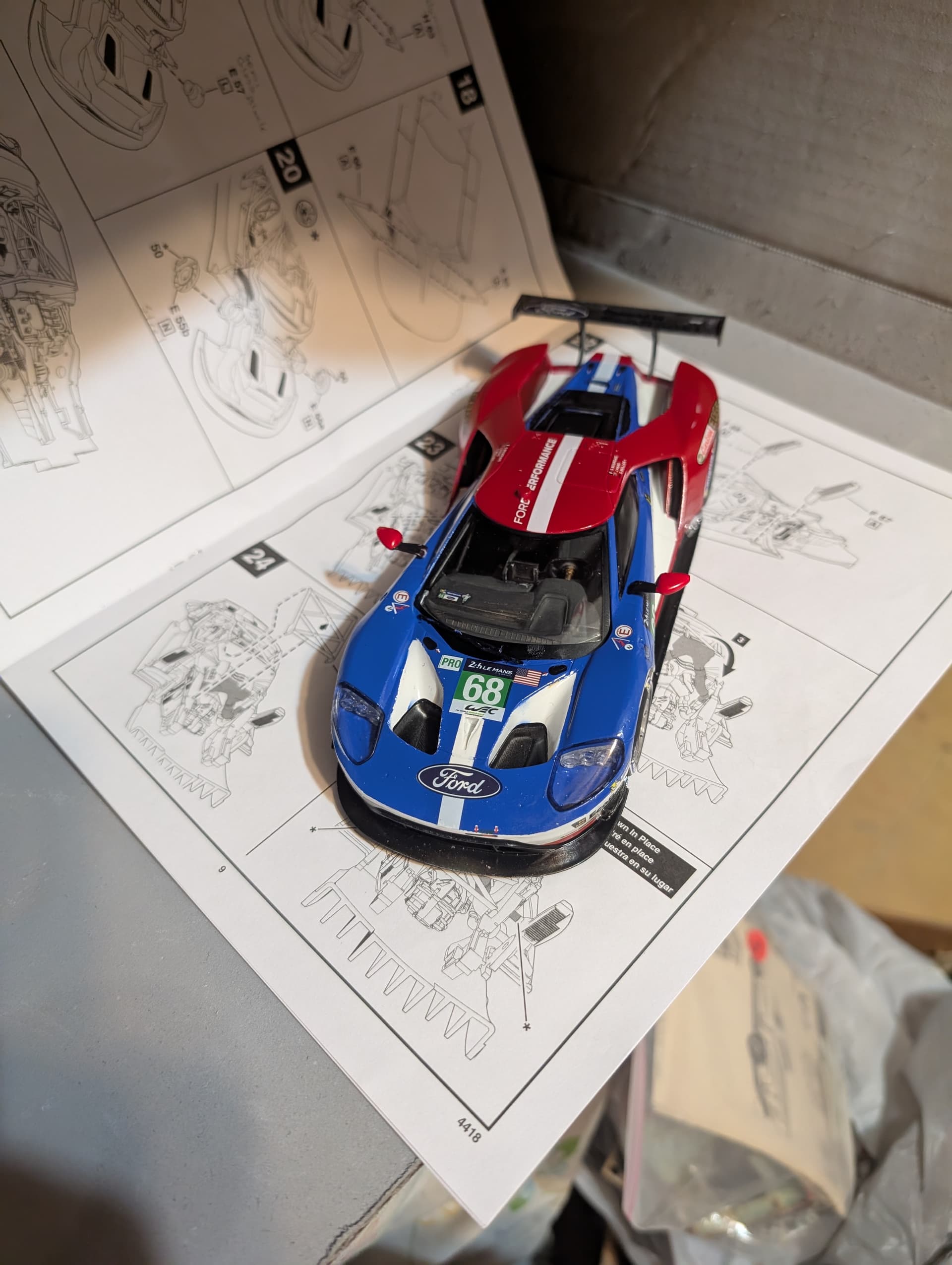

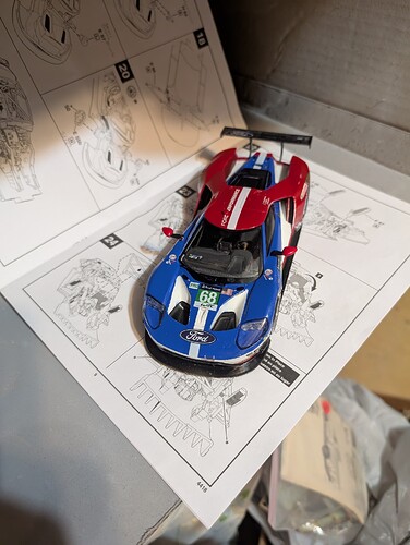

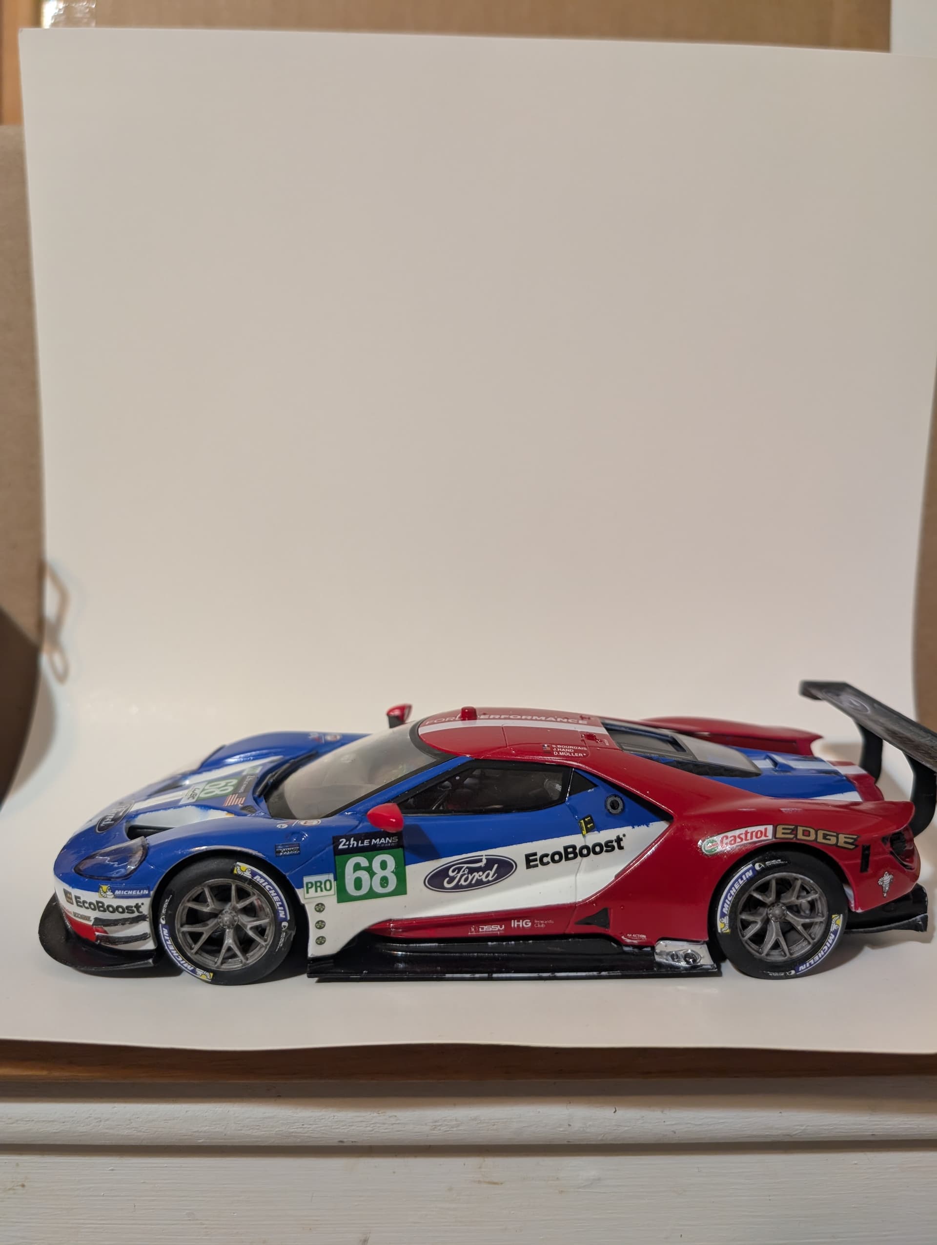

I started one about the same time for a group build on Facebook. That was before I joined here. If you haven’t finished it yet, maybe this will be some inspiration to help you finish.
