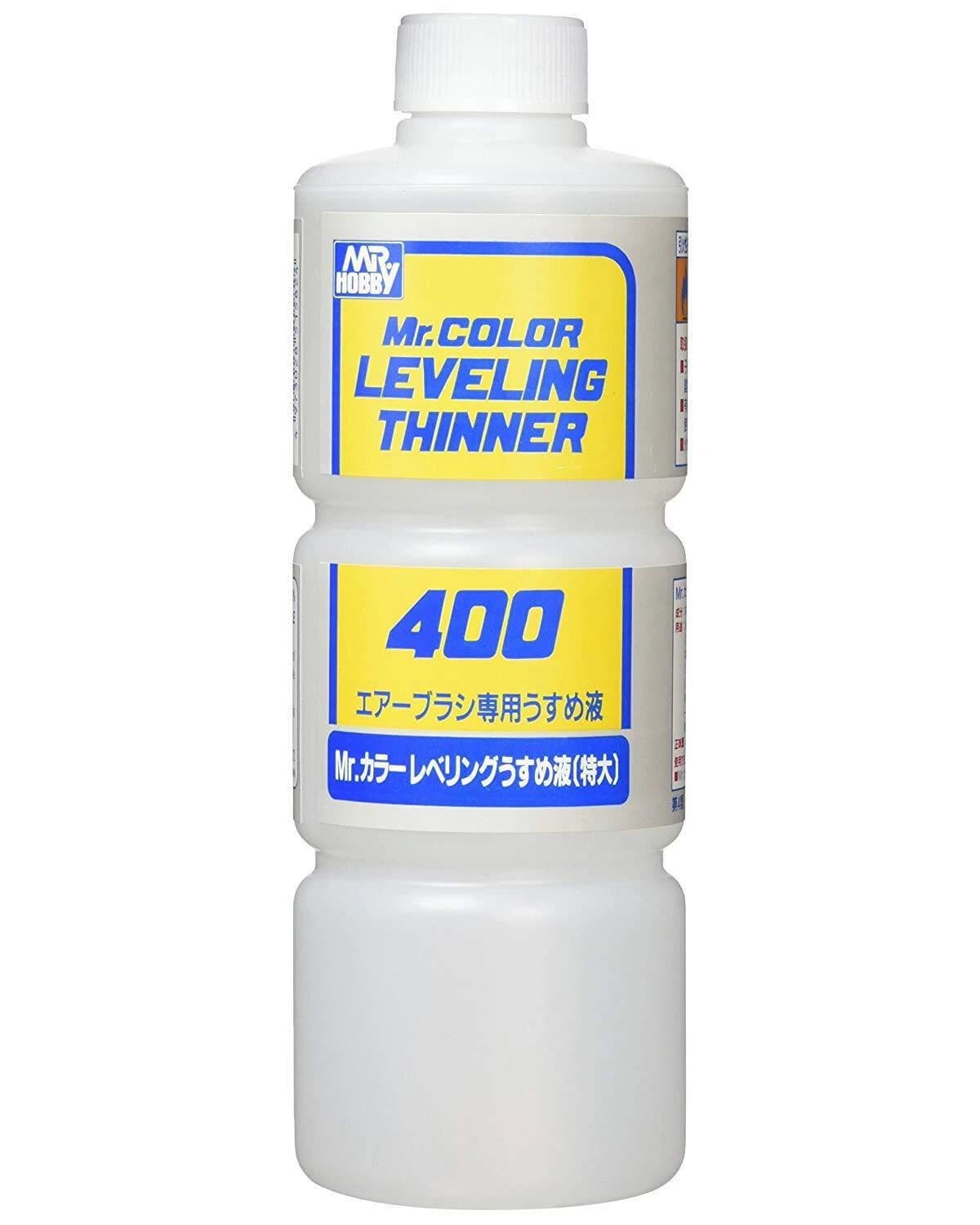

Tamiya acrylics are great for airbrushing, especially when thinned with Mr. Color Leveler.
As far as airbrushes go, I’m particular to Iwata (especially the HP-CS Eclipse) since I worked for them and TAG Team Hobbies for 20 years. :smiling_face_with_sunglasses:
Thank you … no idea what a “Color Leveler” is?
It’s a thinner with additives that make your paint go on nice and smooth.
Ah … nice.

I like the leveling thinner quite a bit for Mr Color paints, but I’ve been thinning Tamiya with isopropyl alcohol (70%).

As far as paint I’d recommend getting their recommended thinner with whatever brand you go with as well. I use the “cheap hardware” stuff to clean, but I use the branded stuff to paint…just in case. Hate to ruin something you’ve spent weeks on because you didn’t get $10 worth of thinner. Although as mentioned earlier the Mr. Color Leveling Thinner does work well and I’ve used it from time to time with lacquers and enamels when I wanted an extra glossy finish.
Some examples from my recommendations above.
